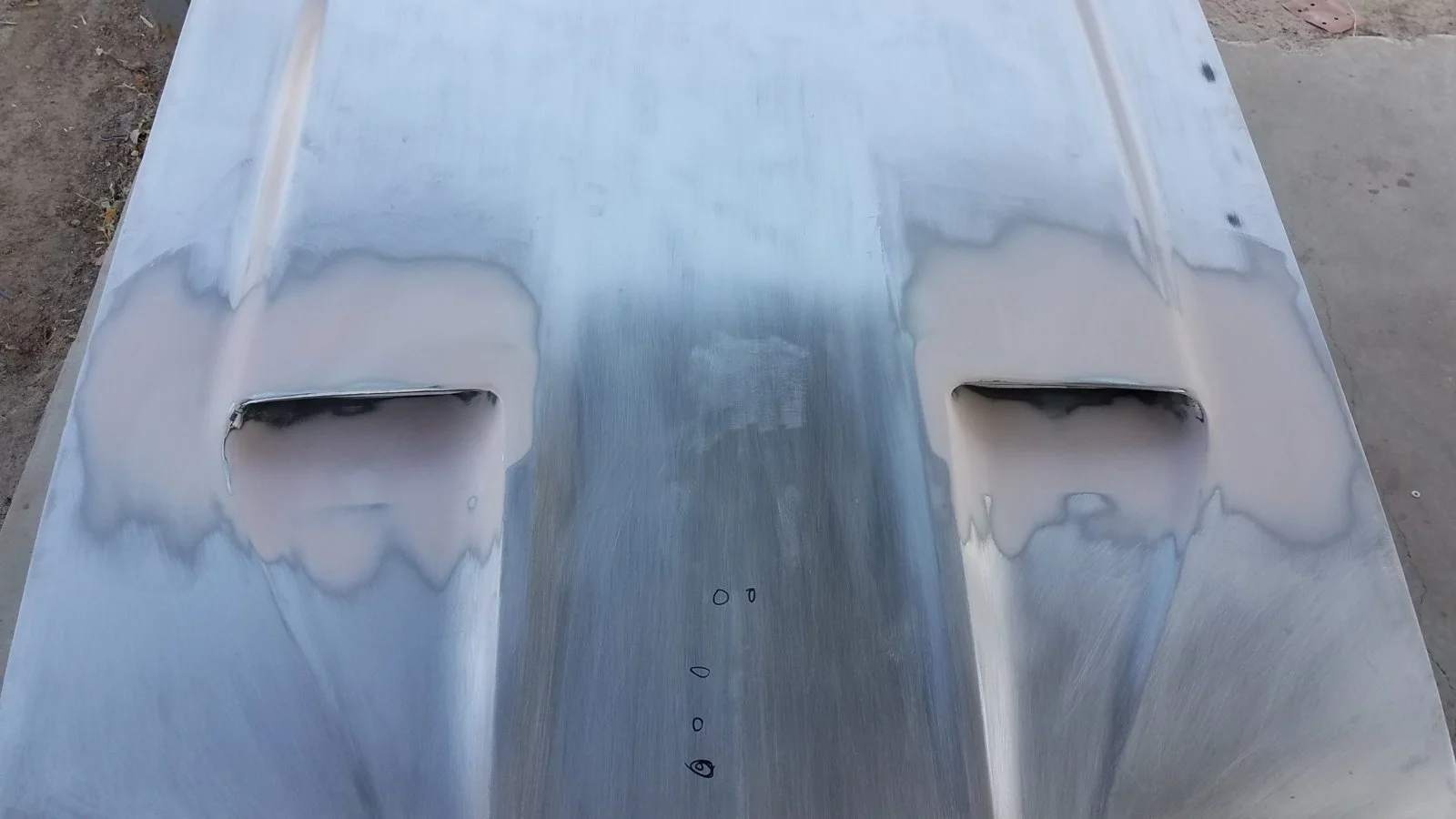

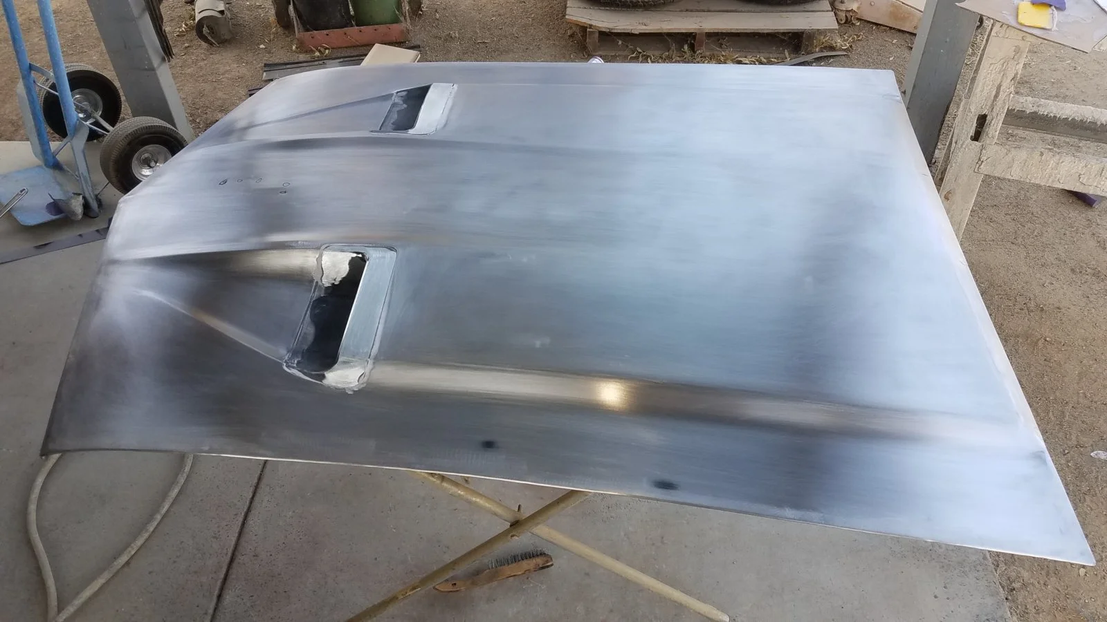

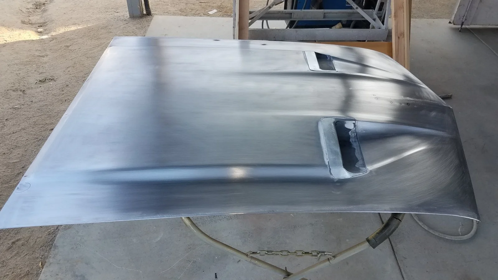

Scoops are bonded in . I sanded the driver side to bare metal ,so far only a couple of very light dings in the peak and a pucker on each side of the rise at the rear ,see how pretty bare metal can be
I’m surprised no company ever made a version of this hood before. It doesn’t make any sense considering they make ‘71-‘73 Mach 1-style hoods for late model cars.

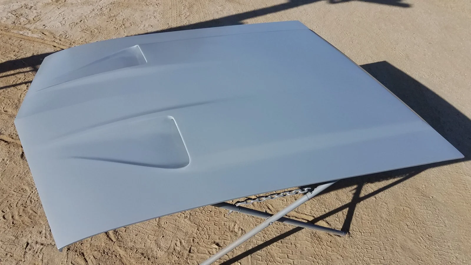

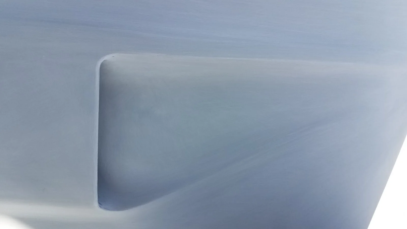

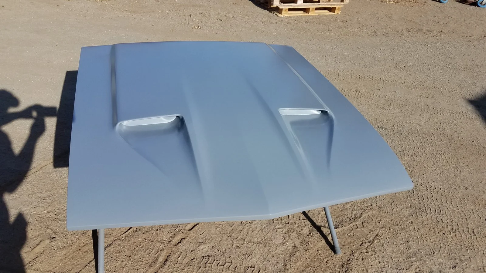

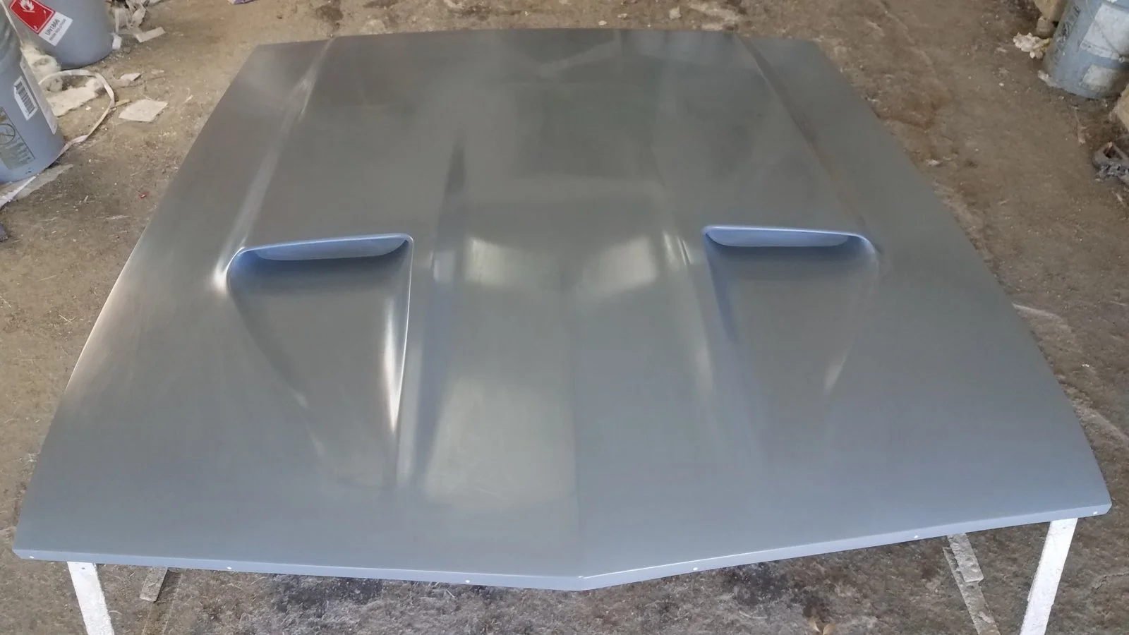

The epoxy is dry . I will let it set acouple of days before i block sand ,i have a couple of places to fix ,one of the ribs running along the inside edge of the driver side scoop is a bit narrower than
the other side and i didnt quite bring the center of the V in the peak high enough so it has a flat spot ,other than that it should block out the first coat .

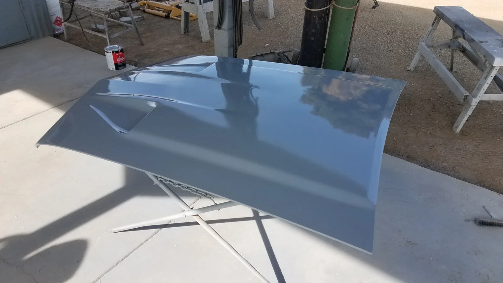

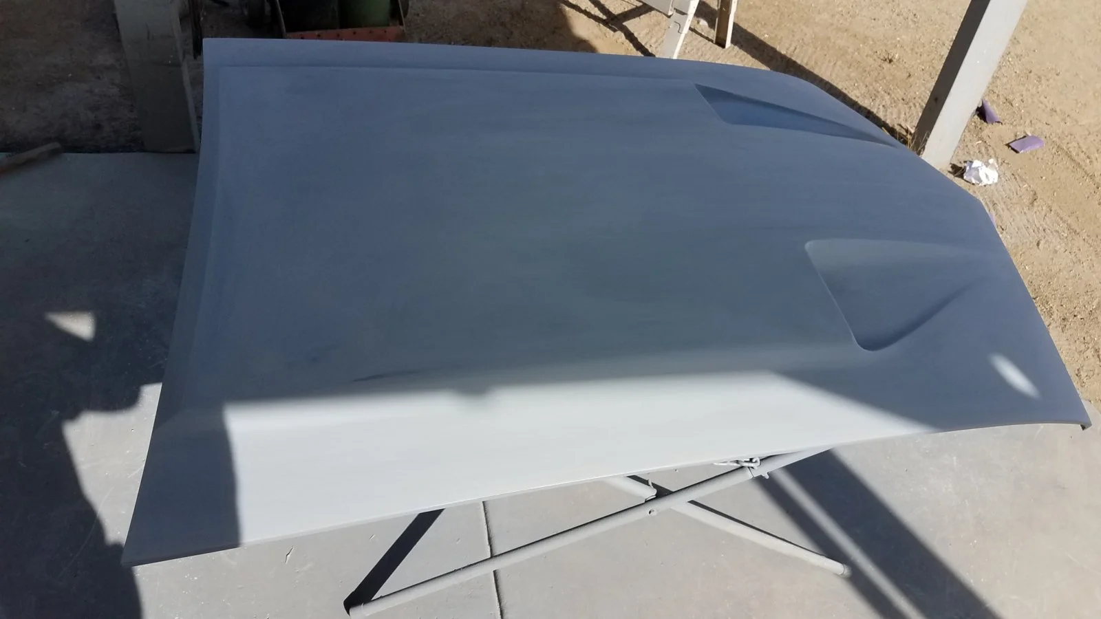

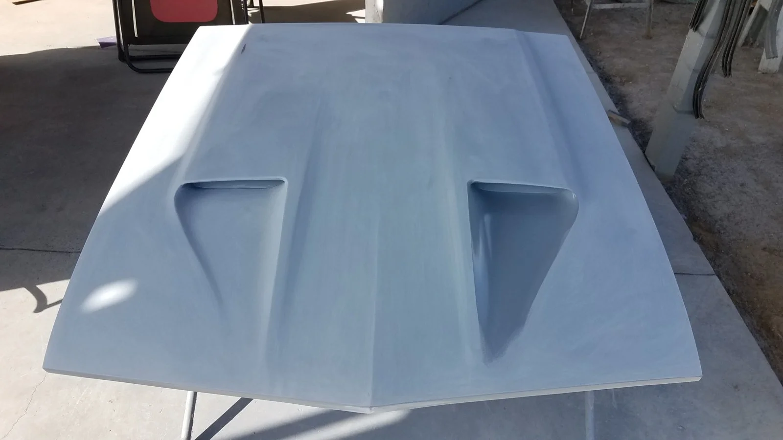

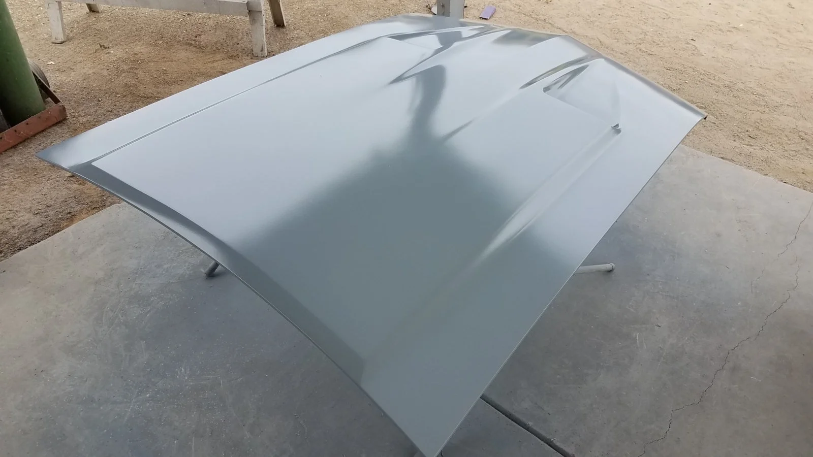

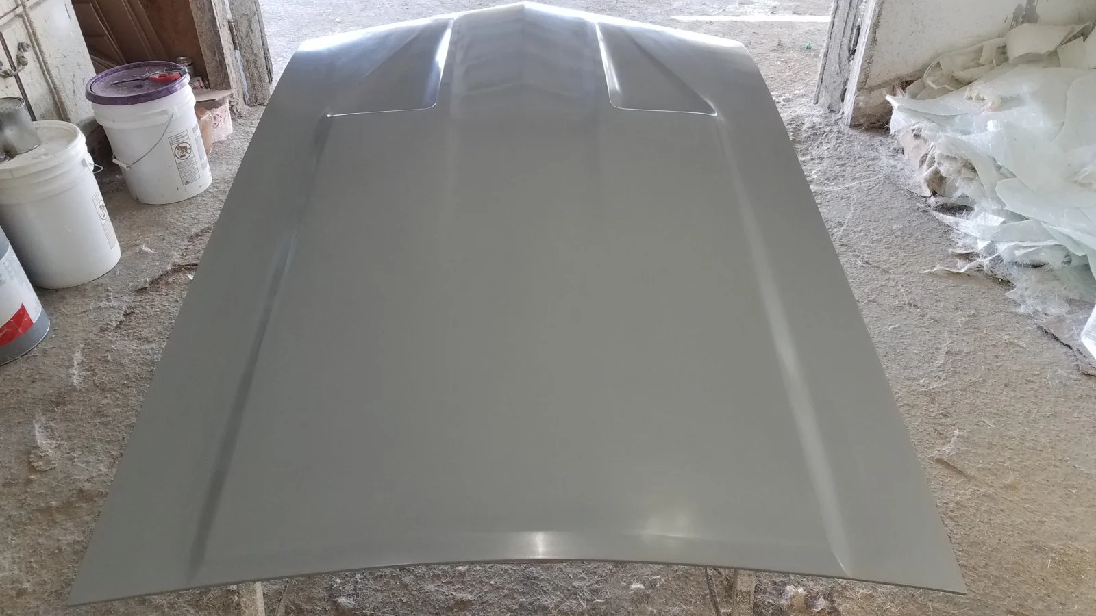

First block sanding with 180 grit ,everything is good and flat except two what looks like thumb prints at each corner in the rear. I got the lines straight in both scoops and the peak of the hood . It will primer one more time and then it will be wet sanded starting with 400 ,then 600 then 1000 and the top will be done ,still have one scoop to block out

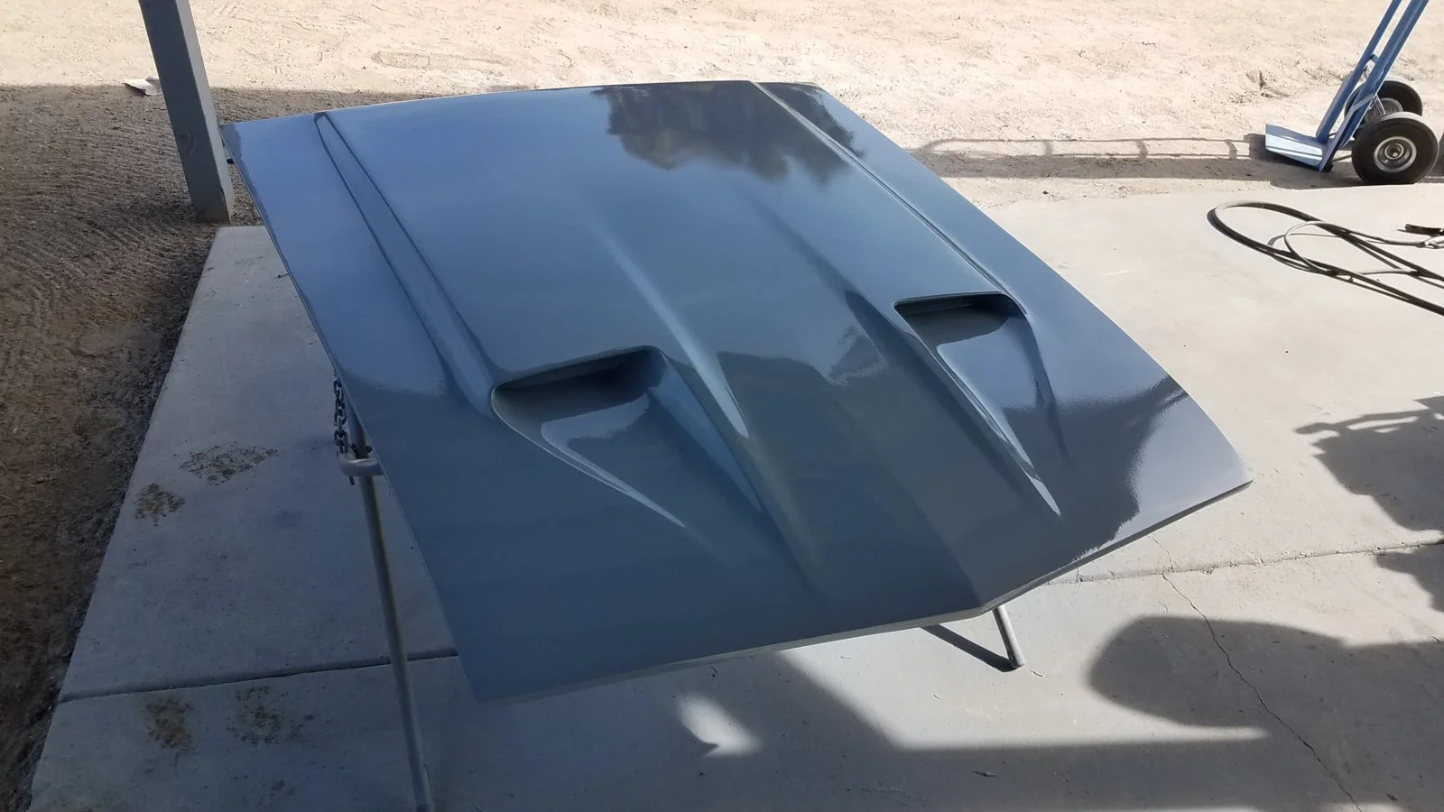

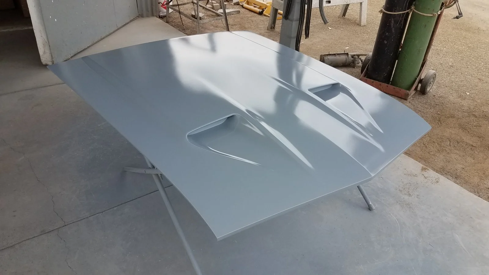

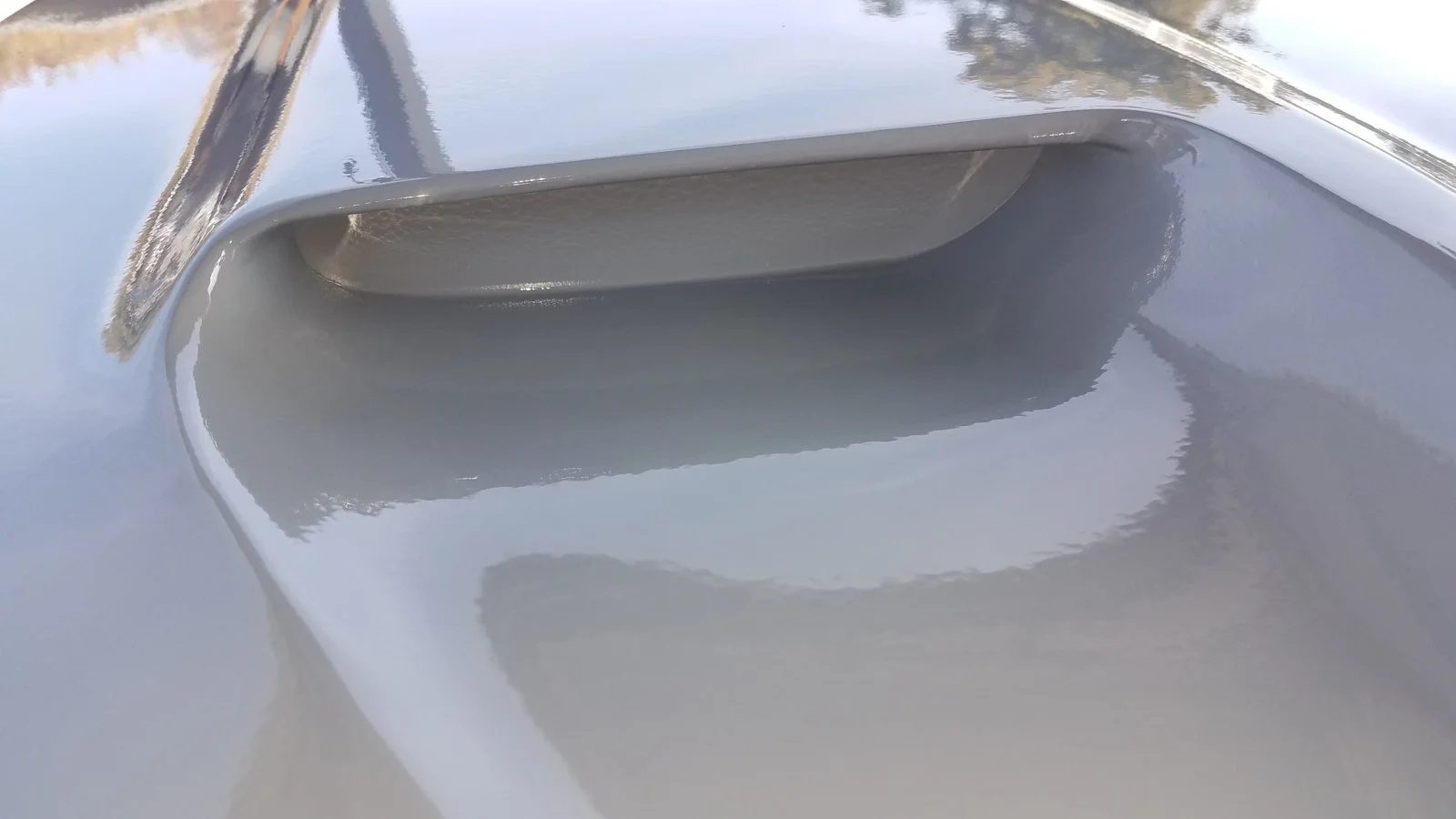

Wet sanded and mold waxed ,this is not the same wax as car wax ,much thicker and harder to remove swirls . I gave it two coats of wax ,i dont want it sticking in the scoops . A little prep work in the morning and spray the liquid mold release and around noon i should be ready for gel coat ,since i mainly use white and somtimes black on my parts ,i think this mold will be gray
