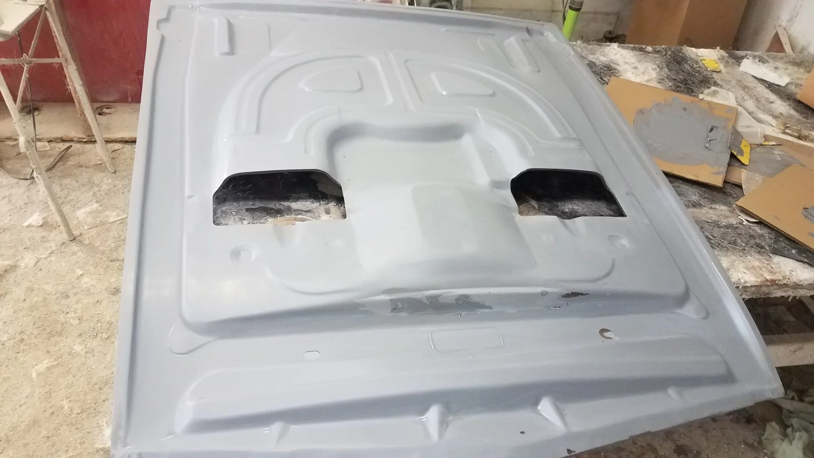

Paint and Body New project ,hood for 69 -70 Mustang

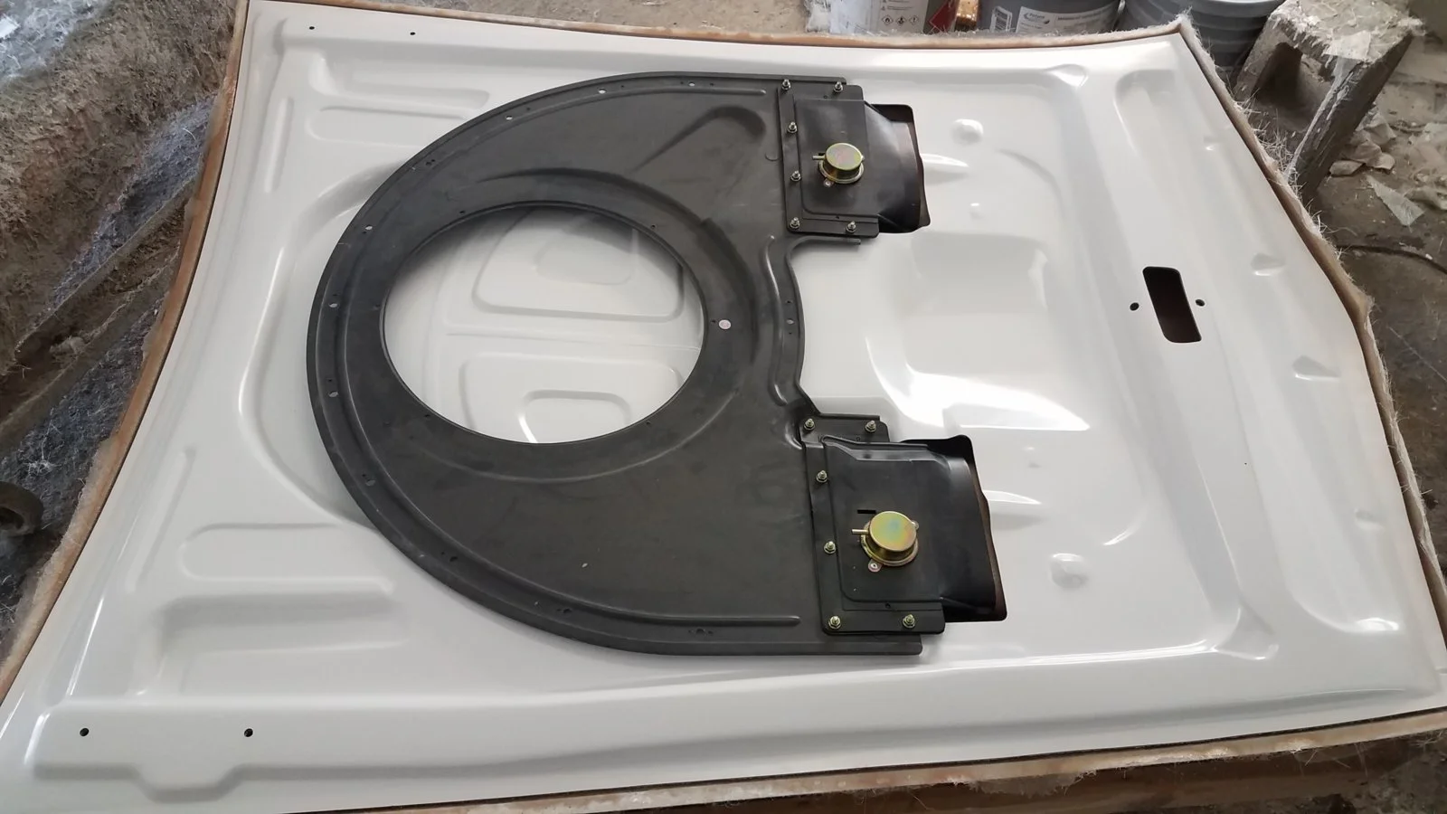

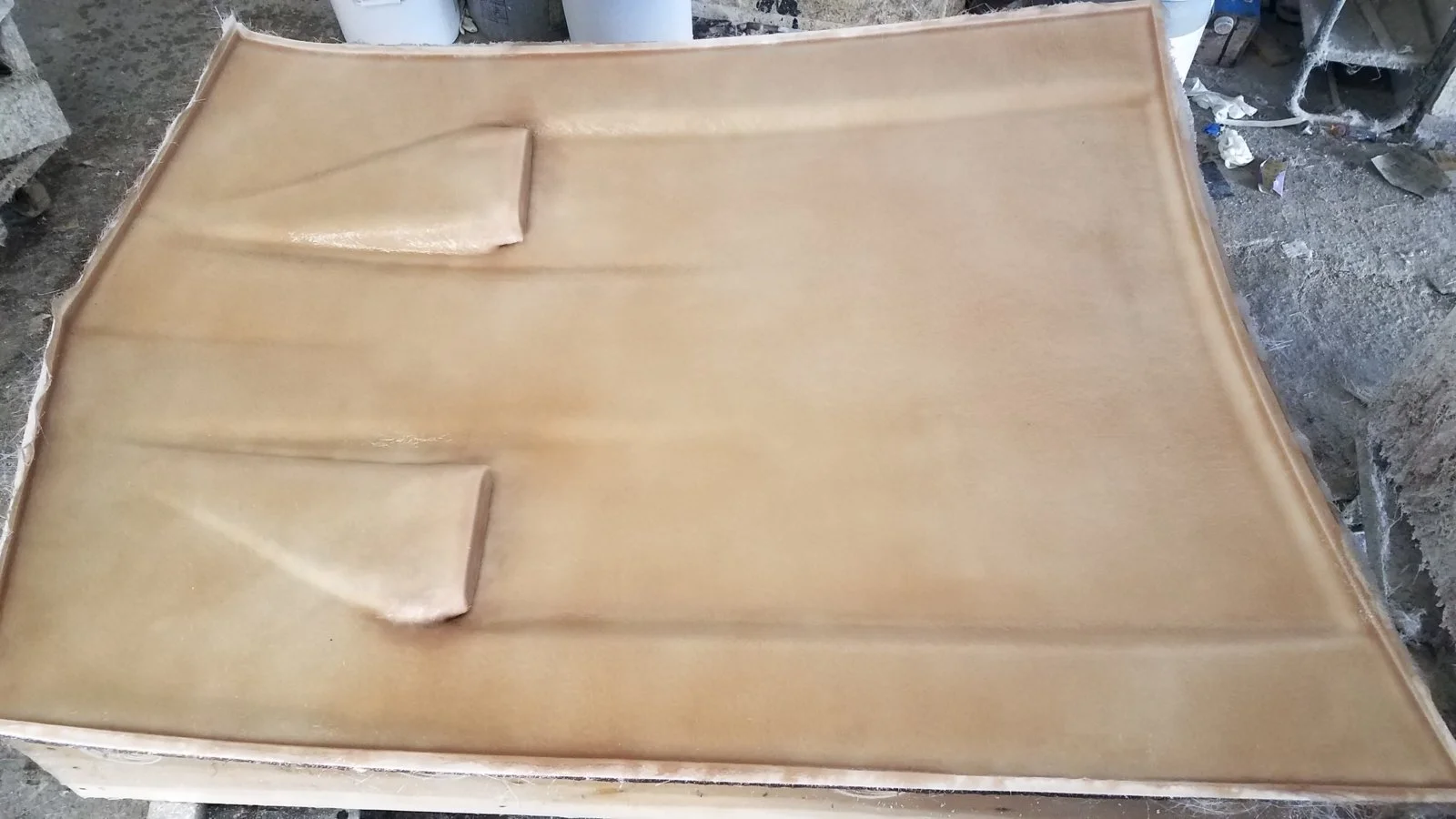

Took it down to 2000 and then two coats of mold wax ,it is soooo slick ! Did you know this stuff can build up enough static charge to light your eyes haha ,it can jump a spark 6 inches

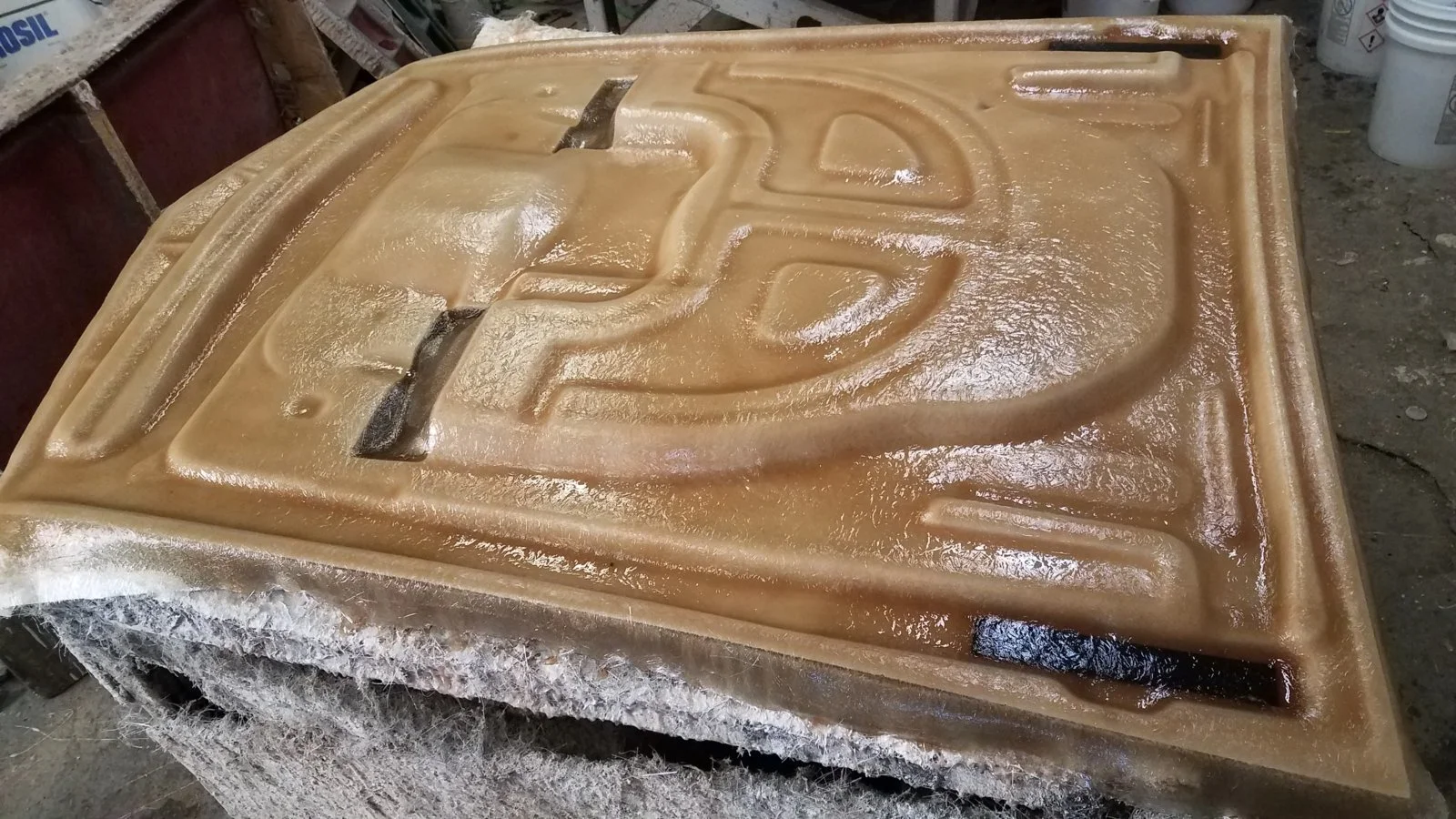

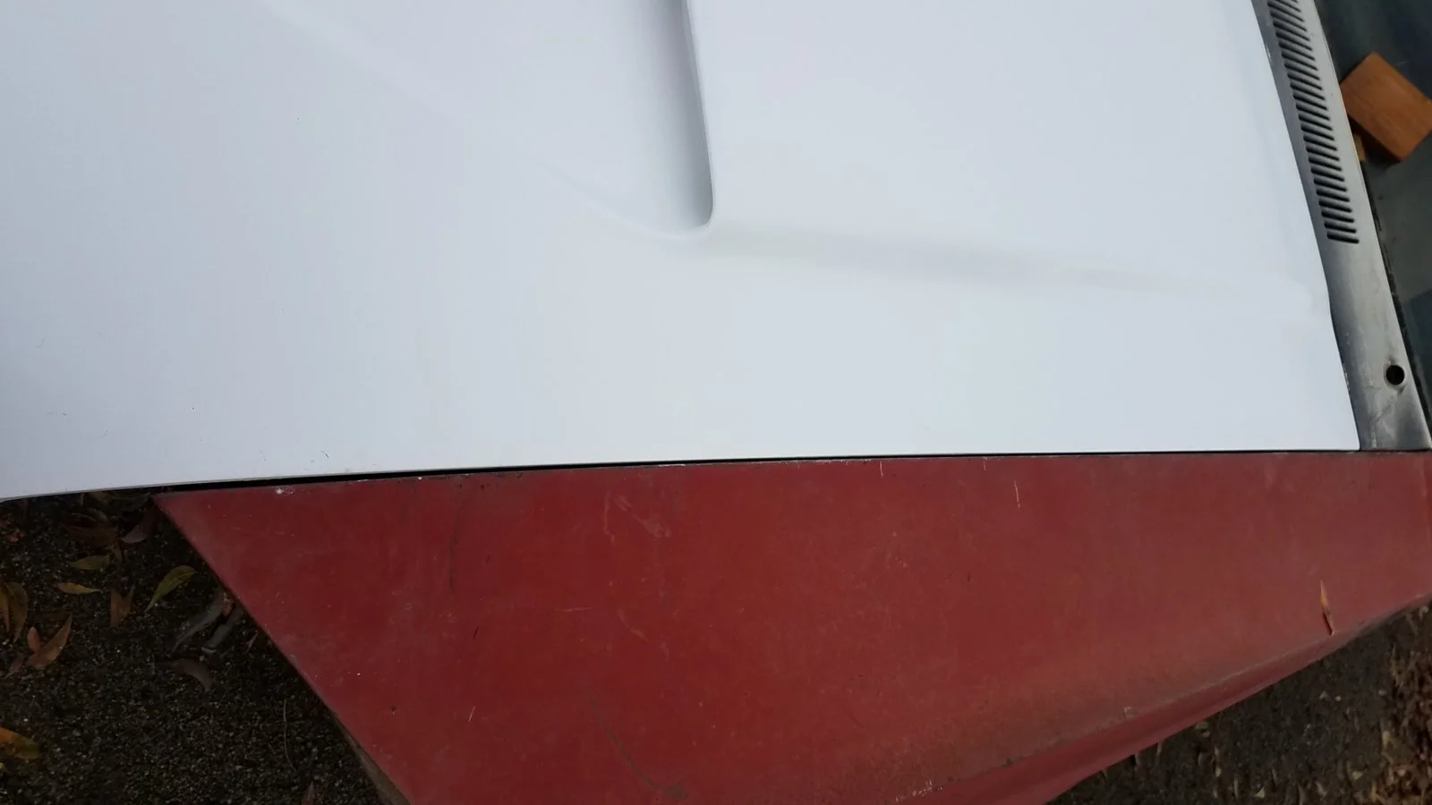

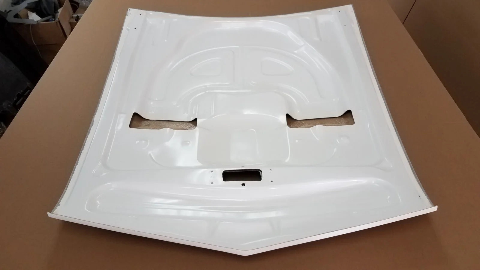

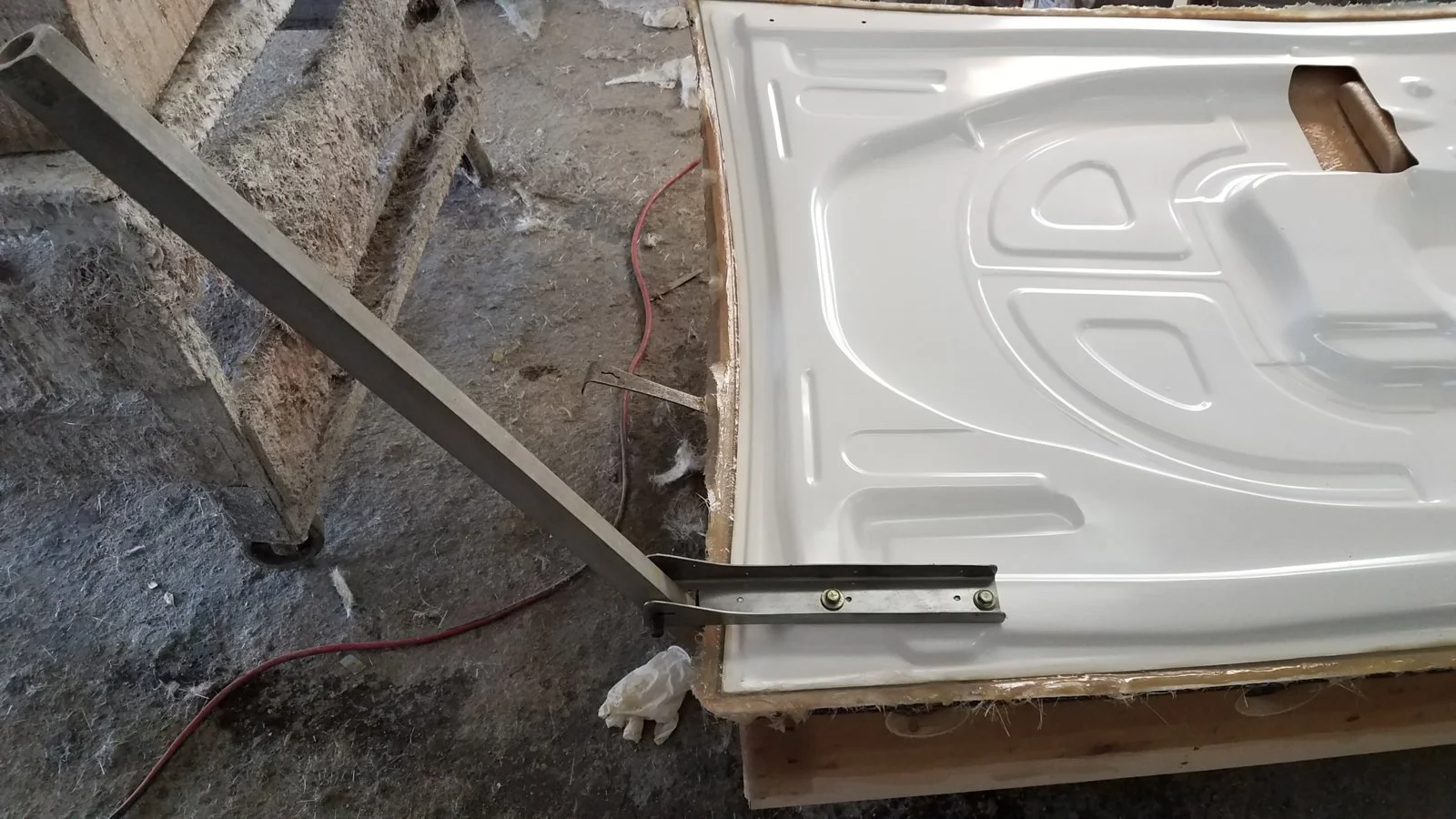

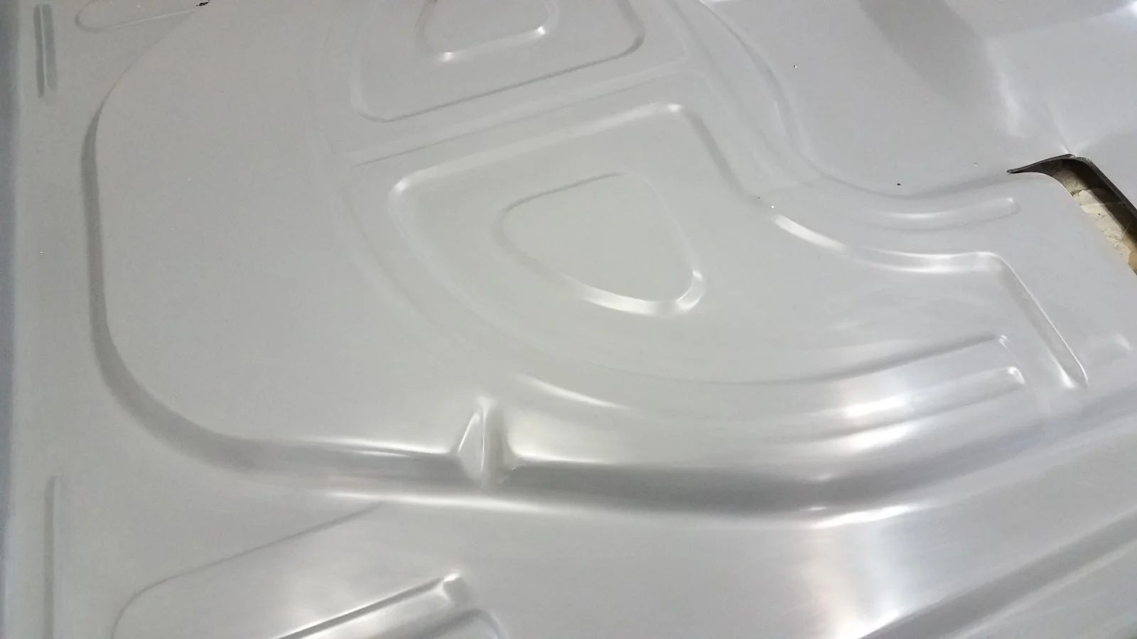

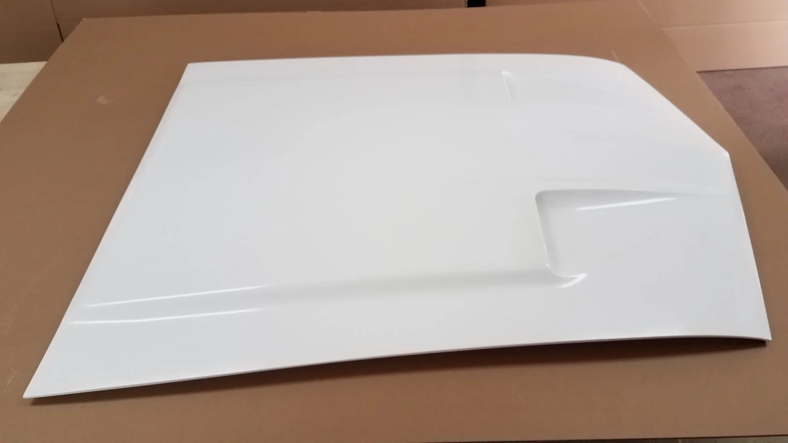

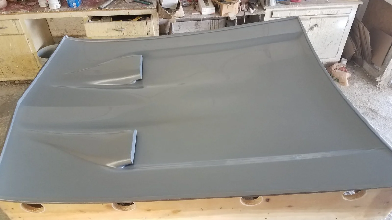

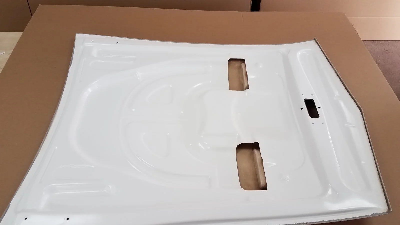

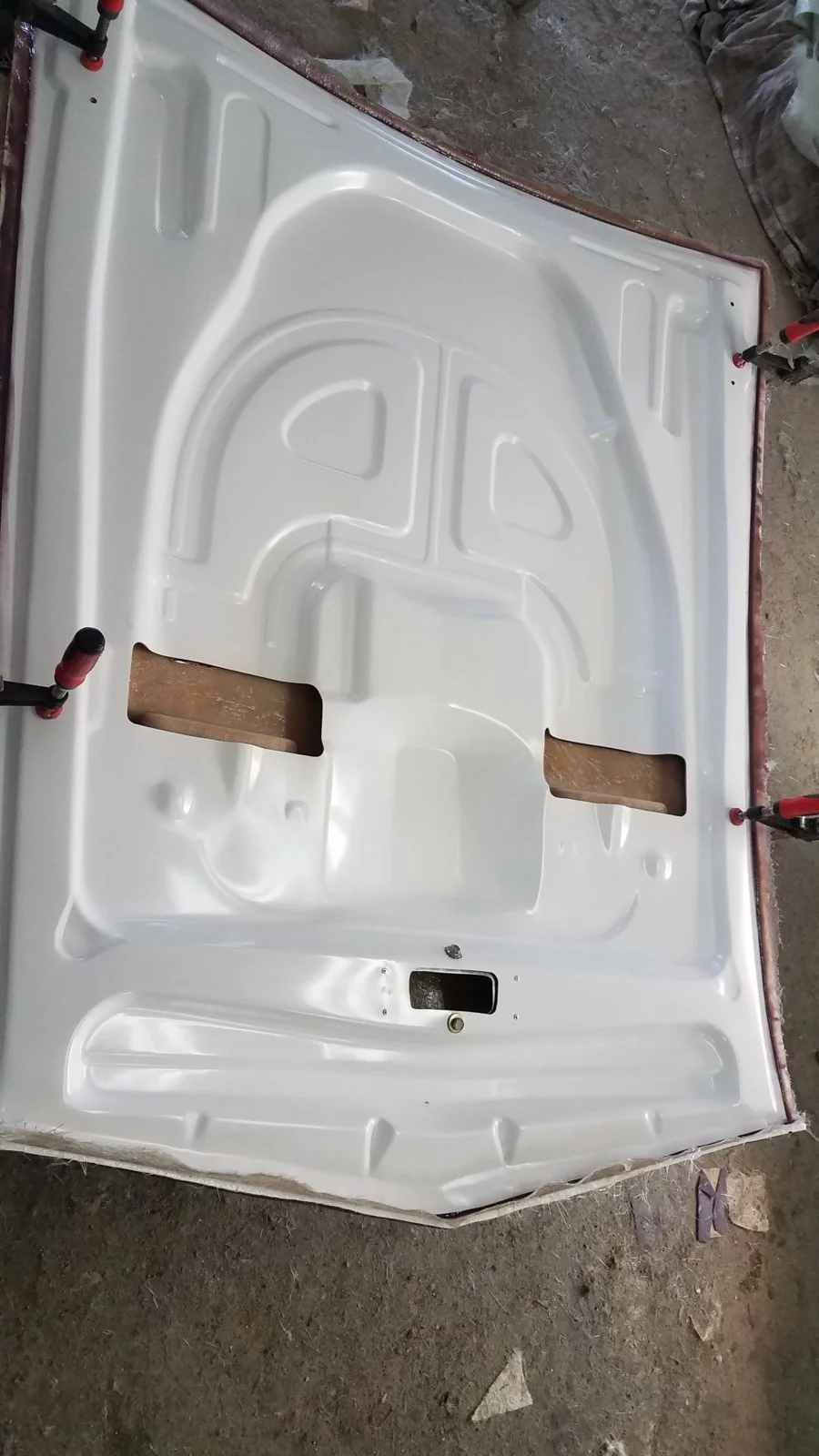

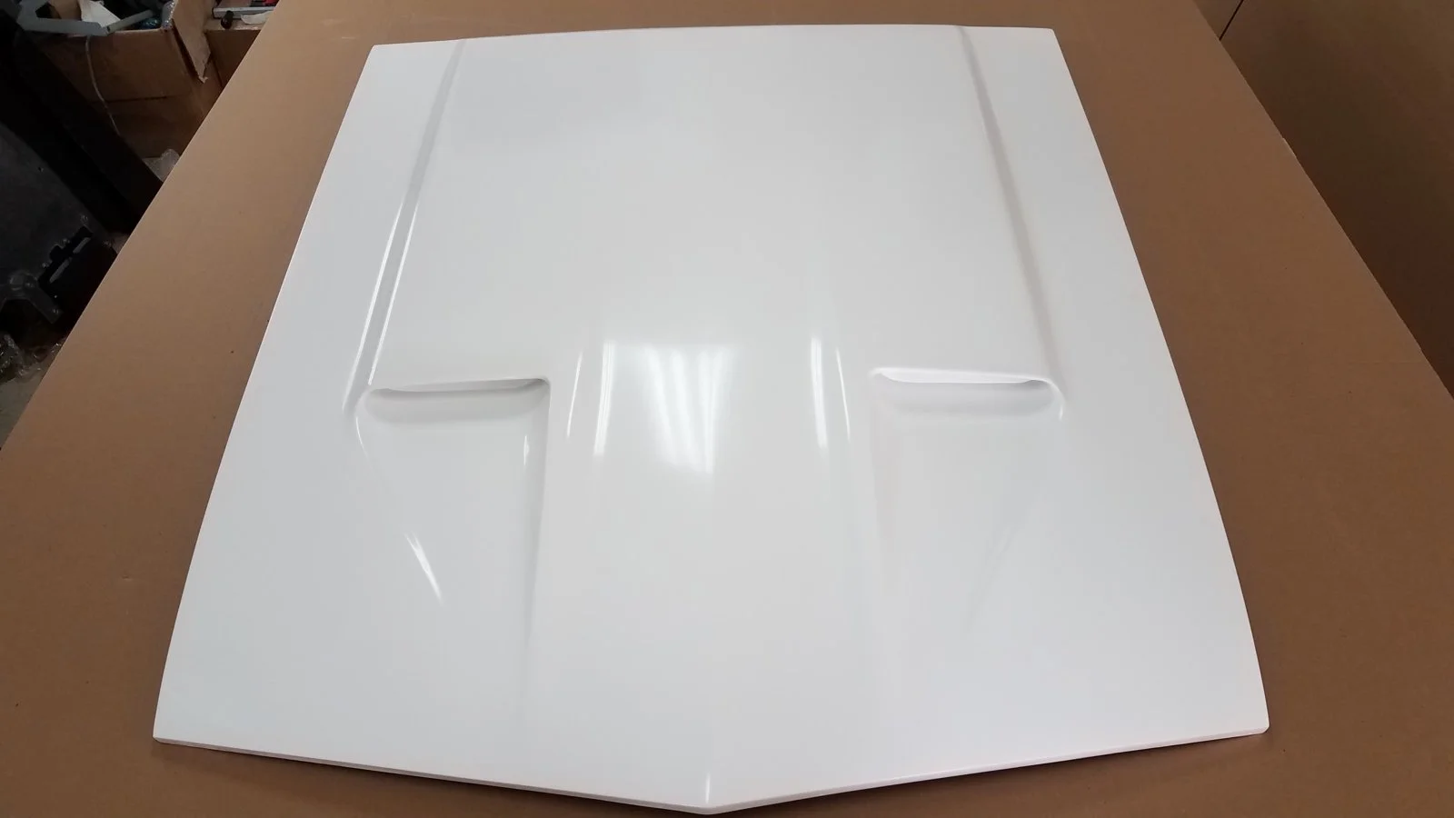

Its out ! I made a tool to pull the hood from the mold ,it worked perfect . The only thing i see wrong with the hood is i was a bit light on one of the scoops

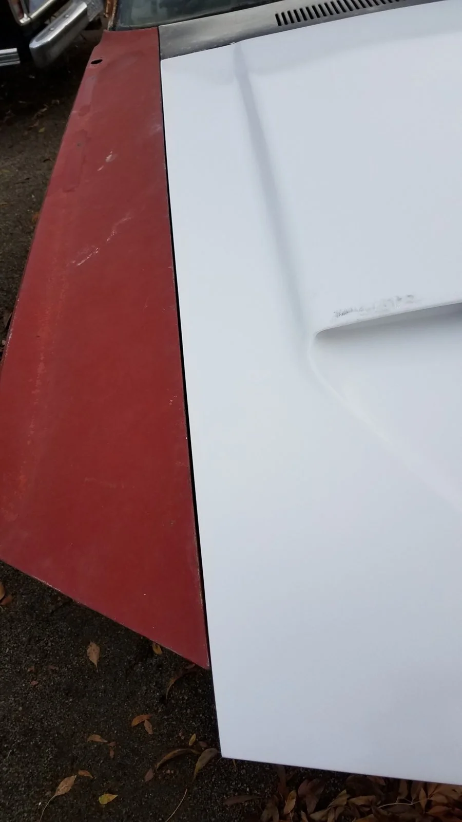

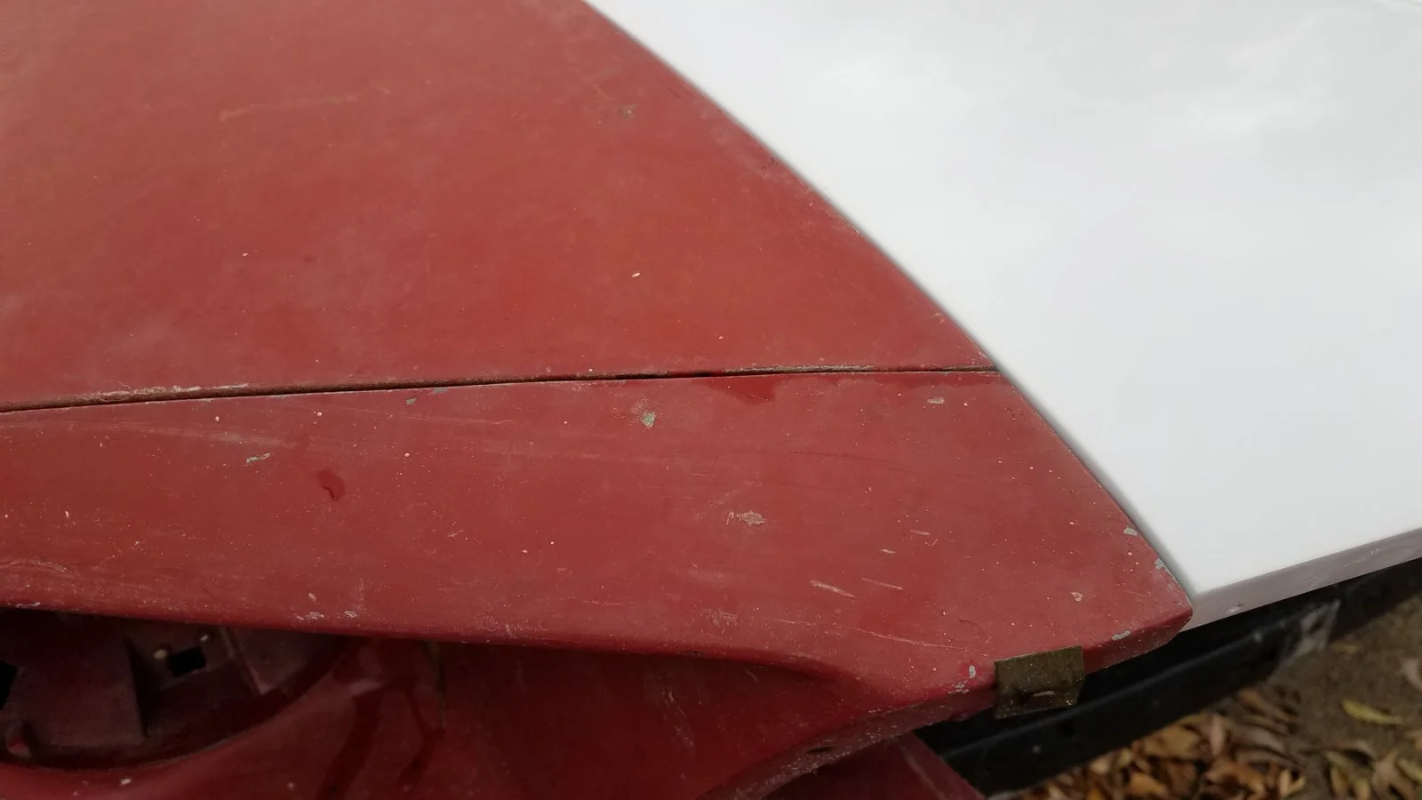

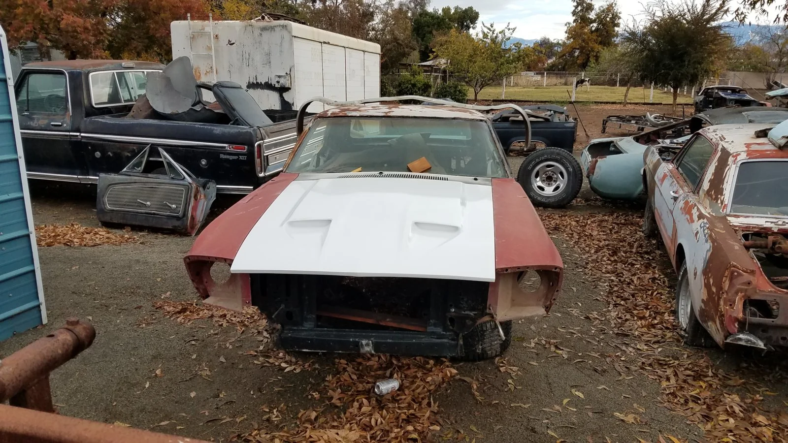

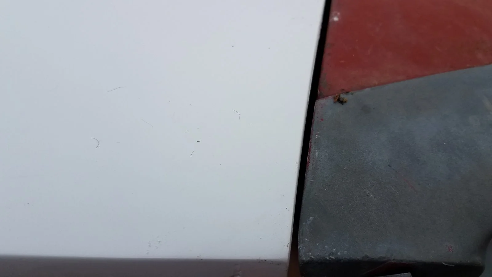

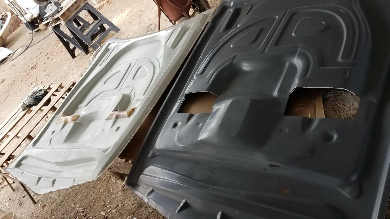

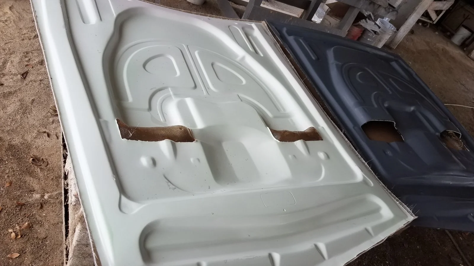

after i trimmed it out i sat it on my old junker 70 coupe ,nothing bolted down and it fits great ,i held the headlight buckets in place . I will have to get out one of my 69s and bolt it all together for some good pics
