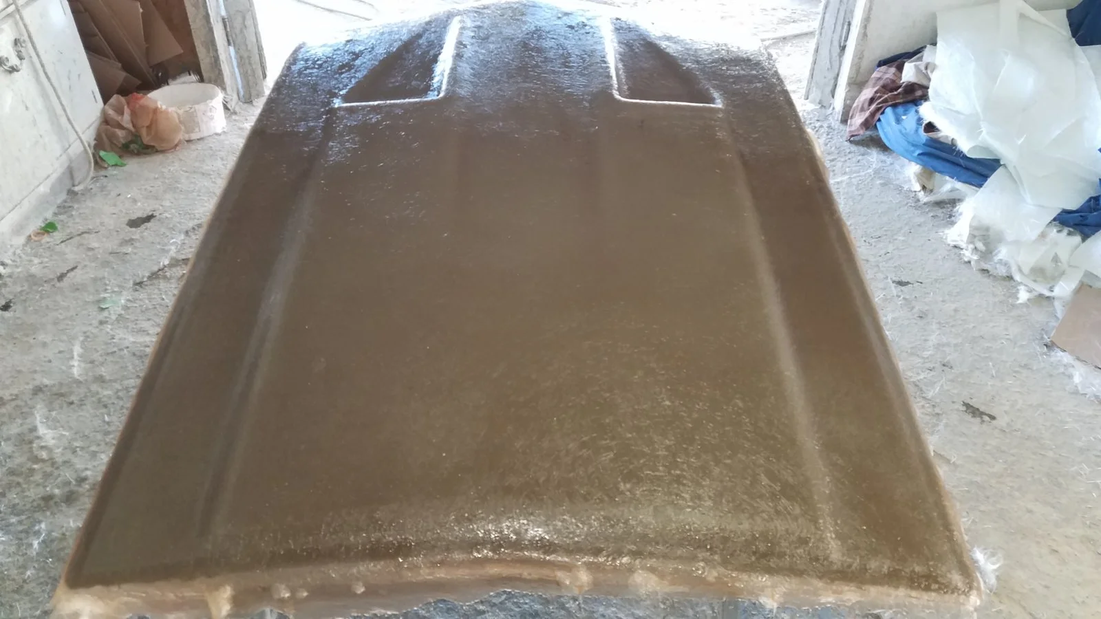

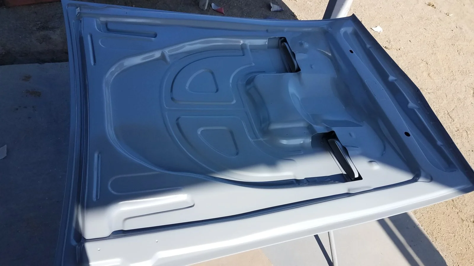

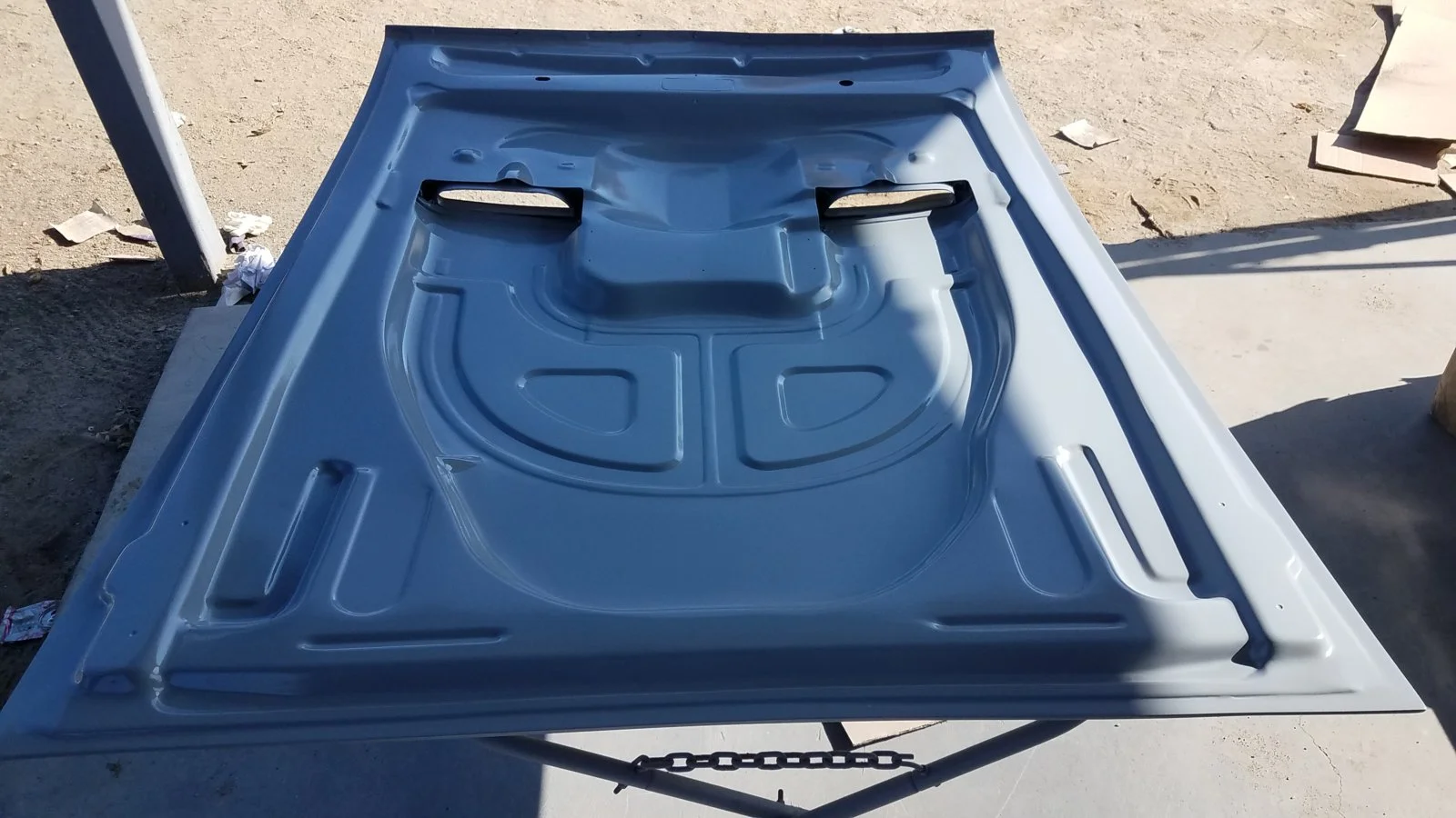

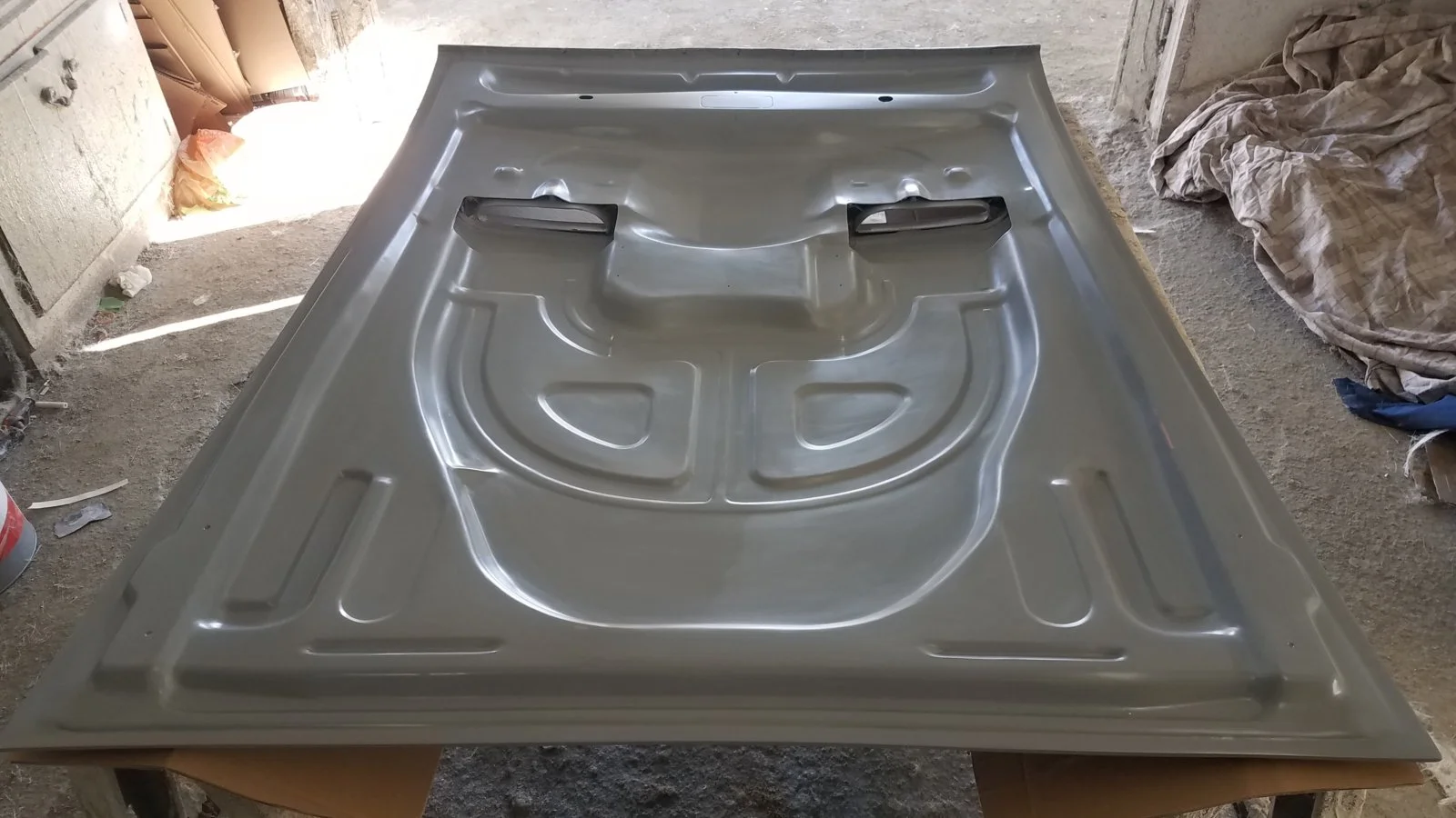

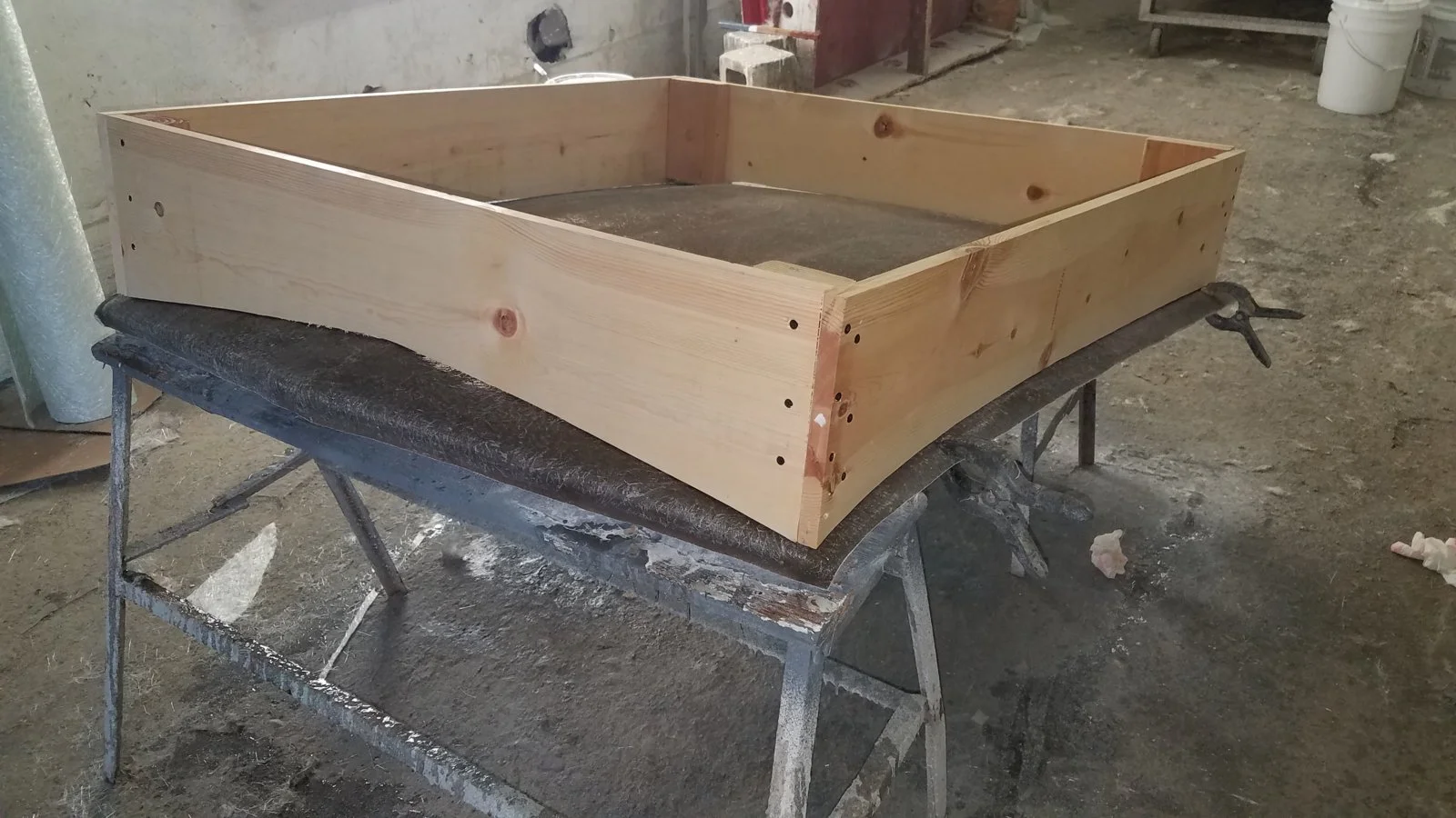

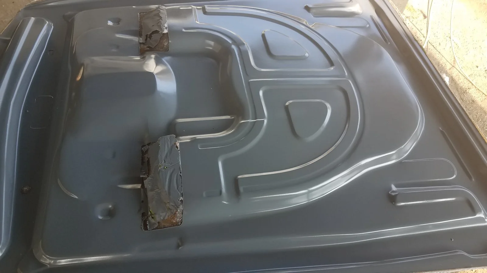

Paint and Body New project ,hood for 69 -70 Mustang

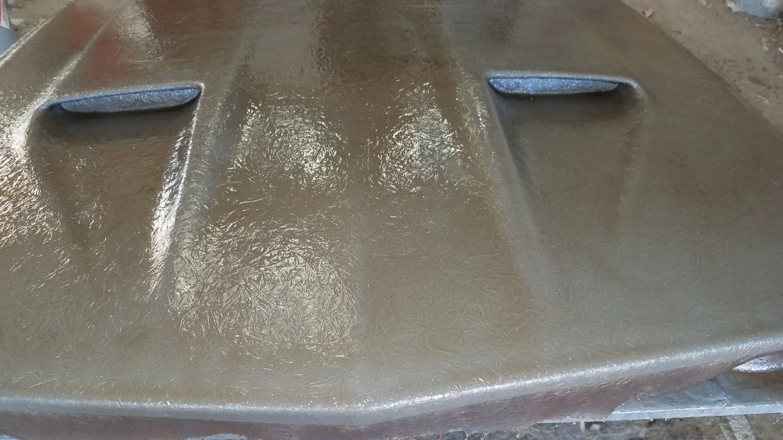

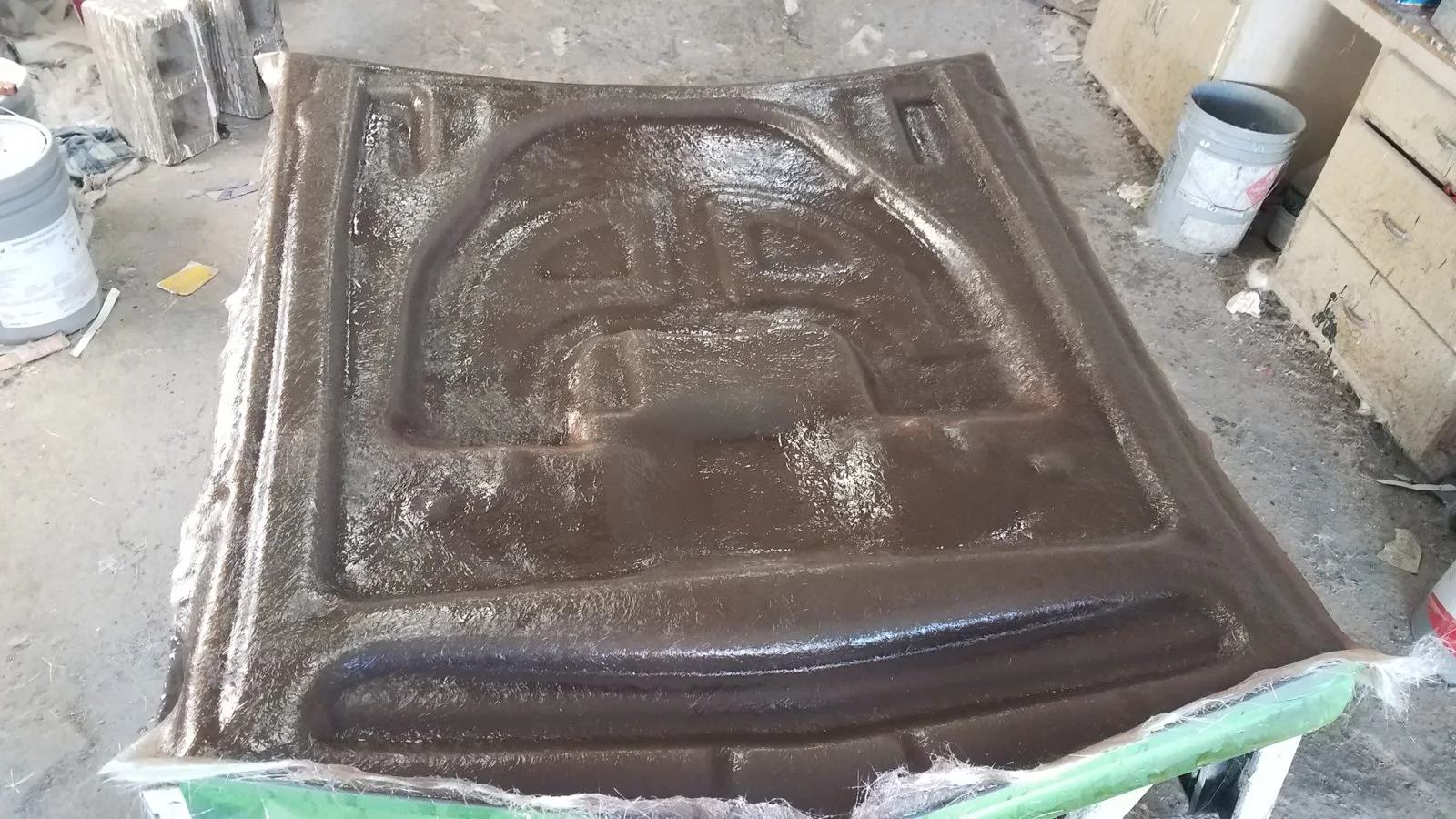

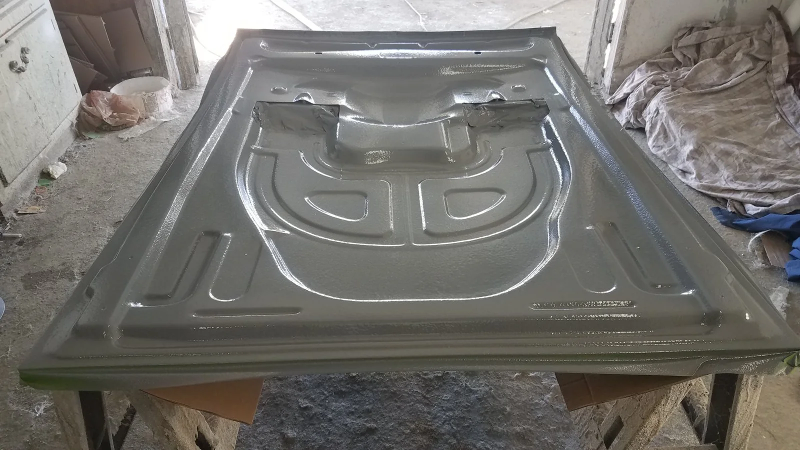

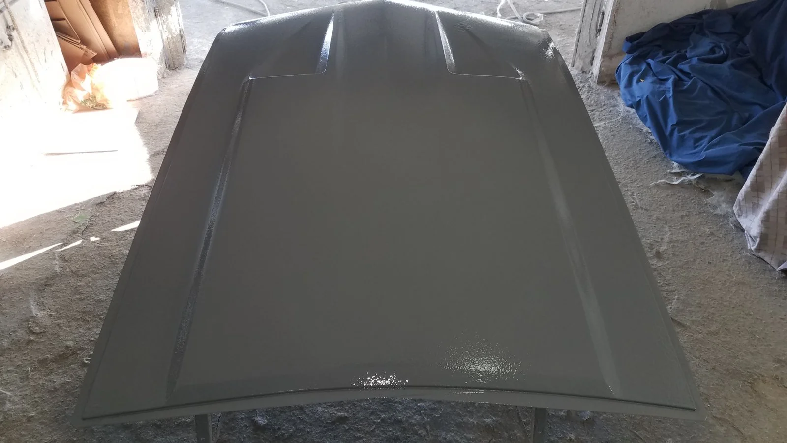

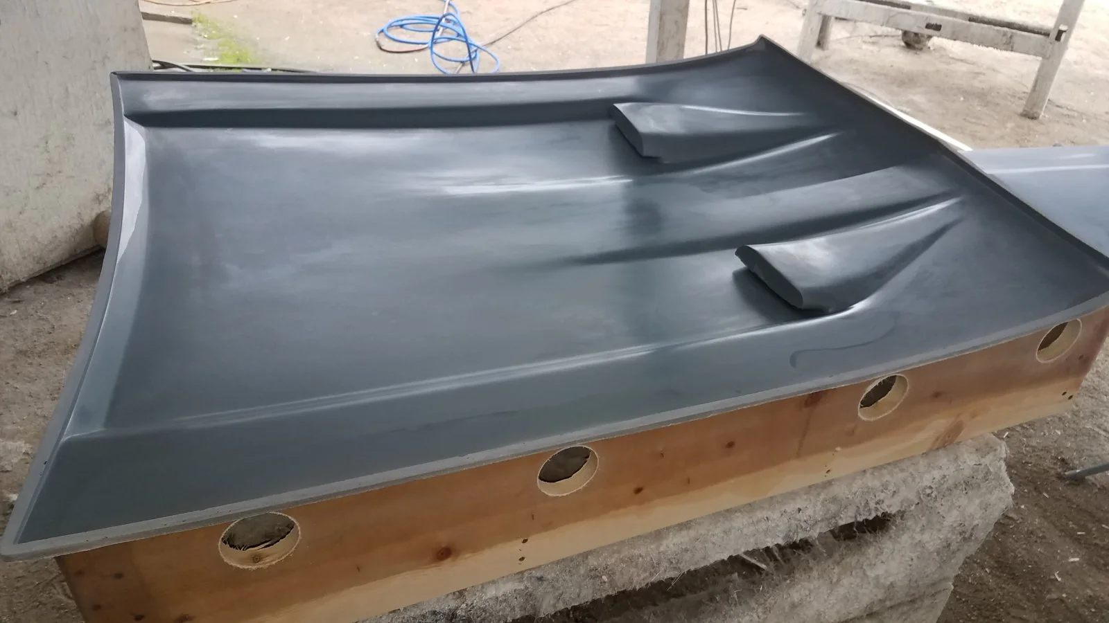

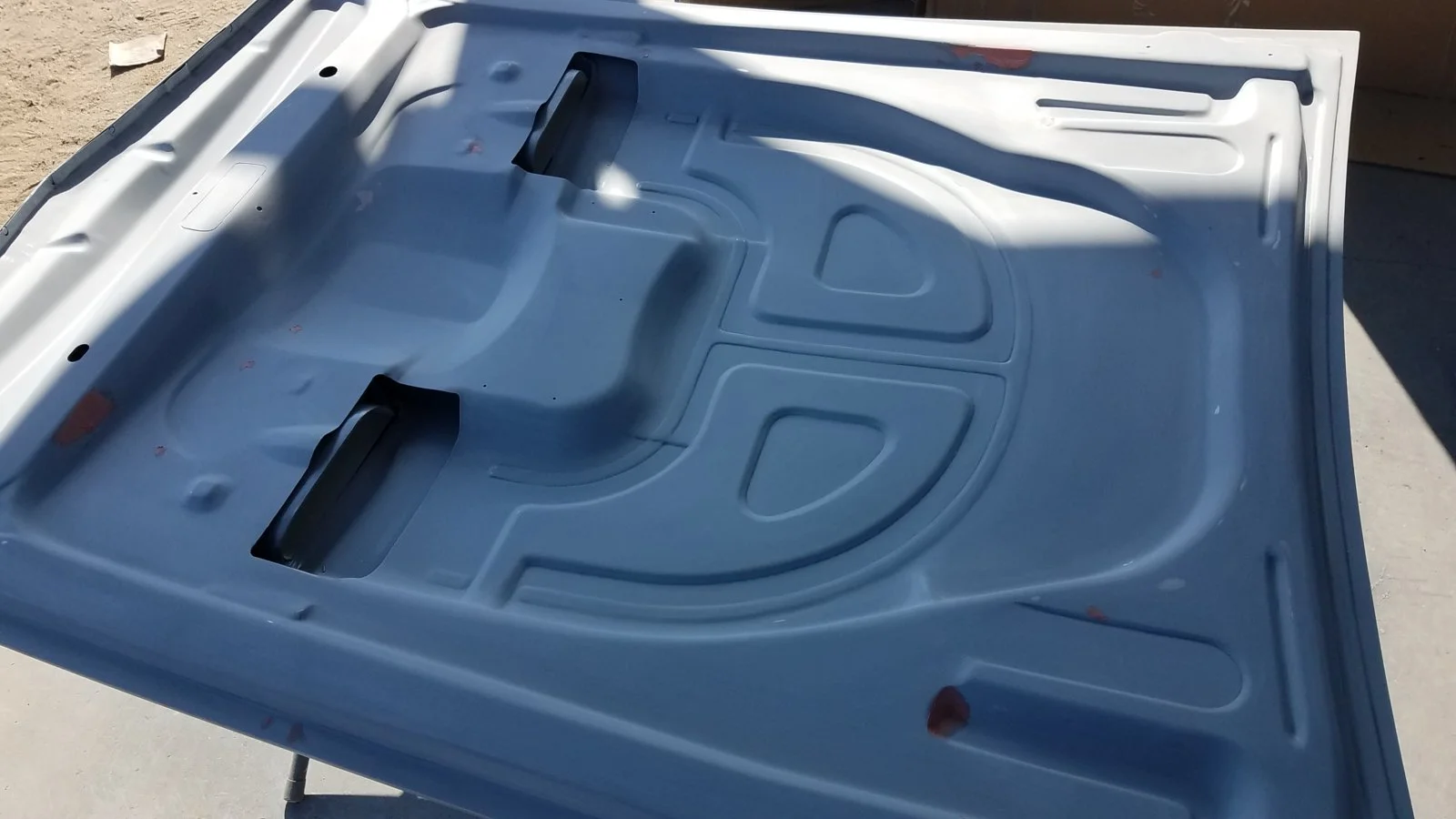

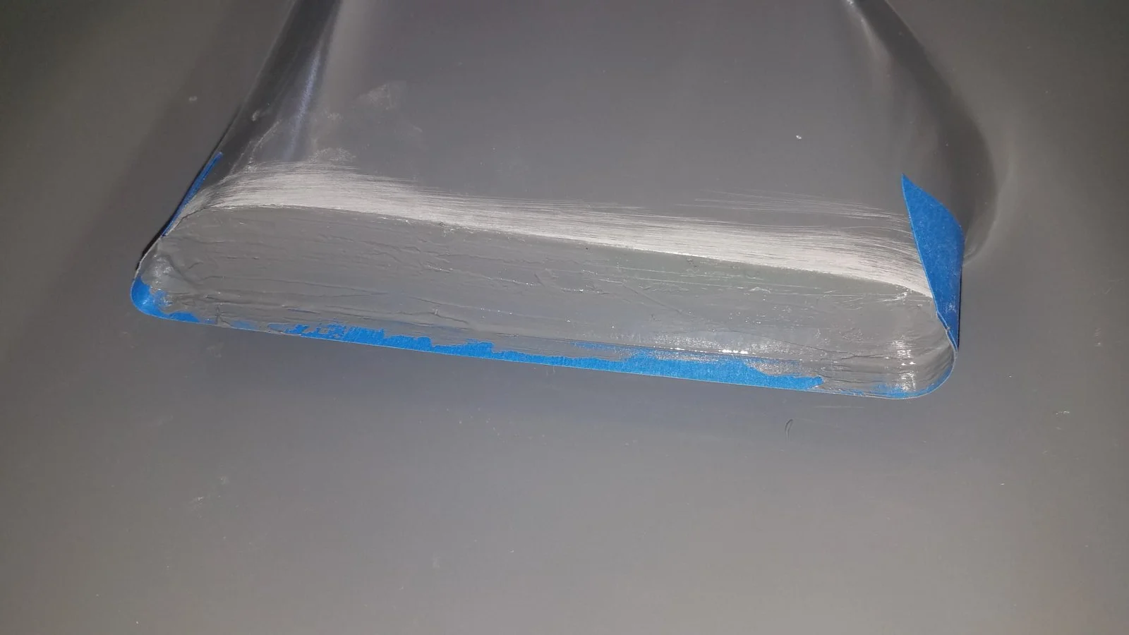

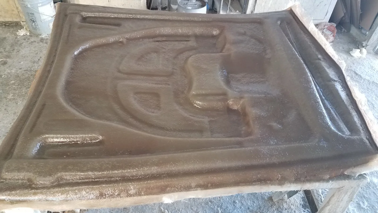

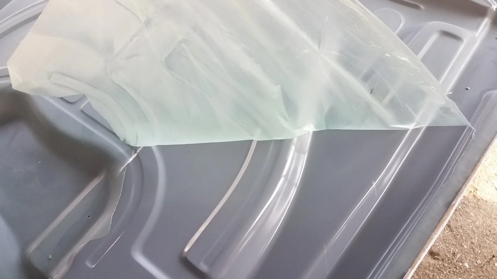

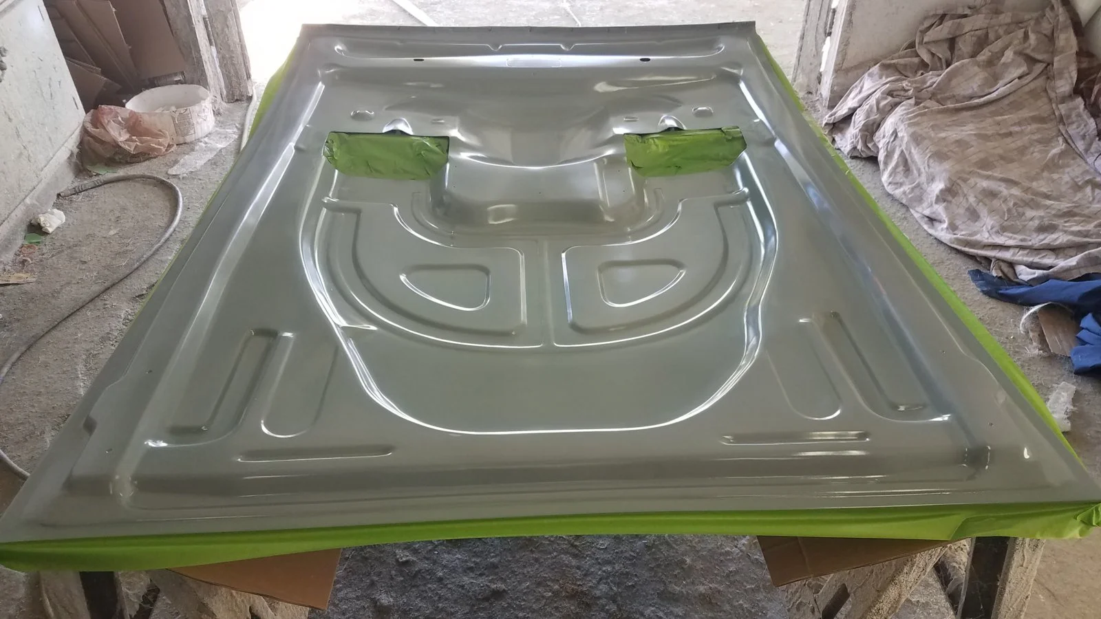

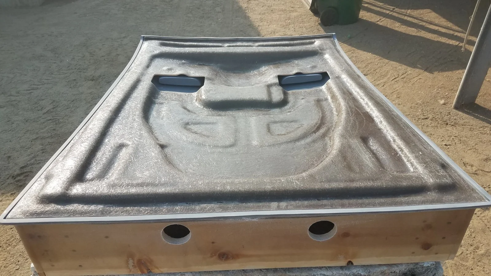

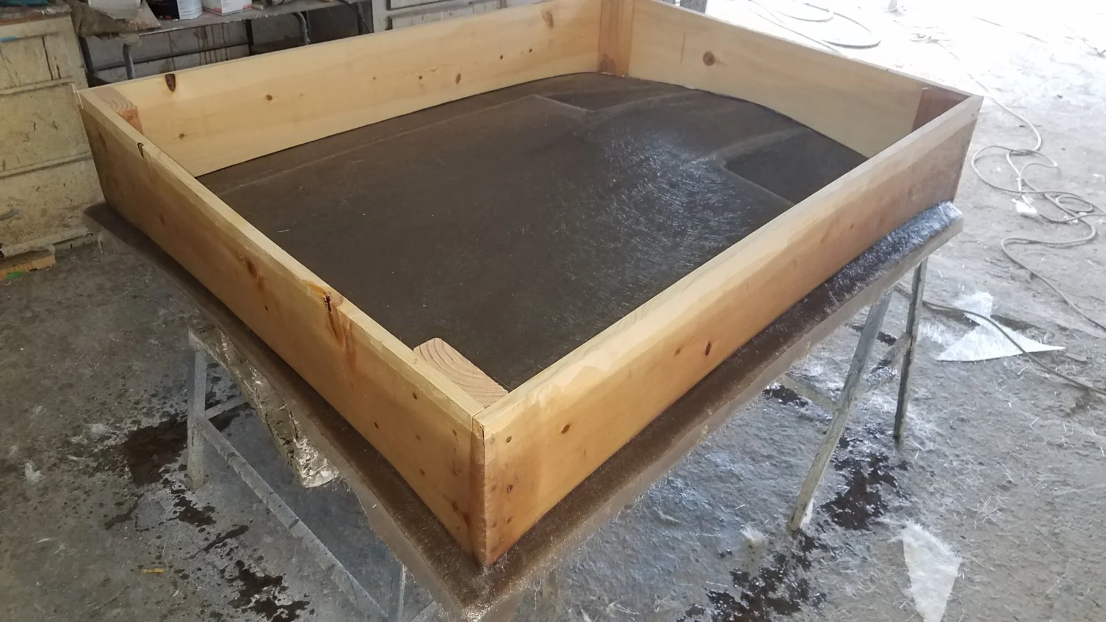

Made the flange so it will have a finished edge ,sprayed 3 coats of liquid mold realease and two coats of dark grey tooling gel coat ...now we wait !

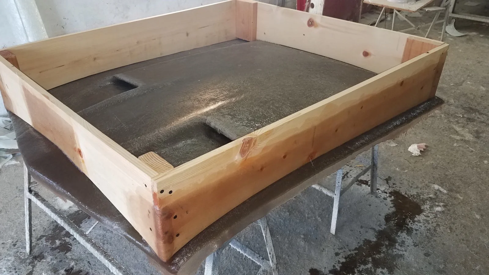

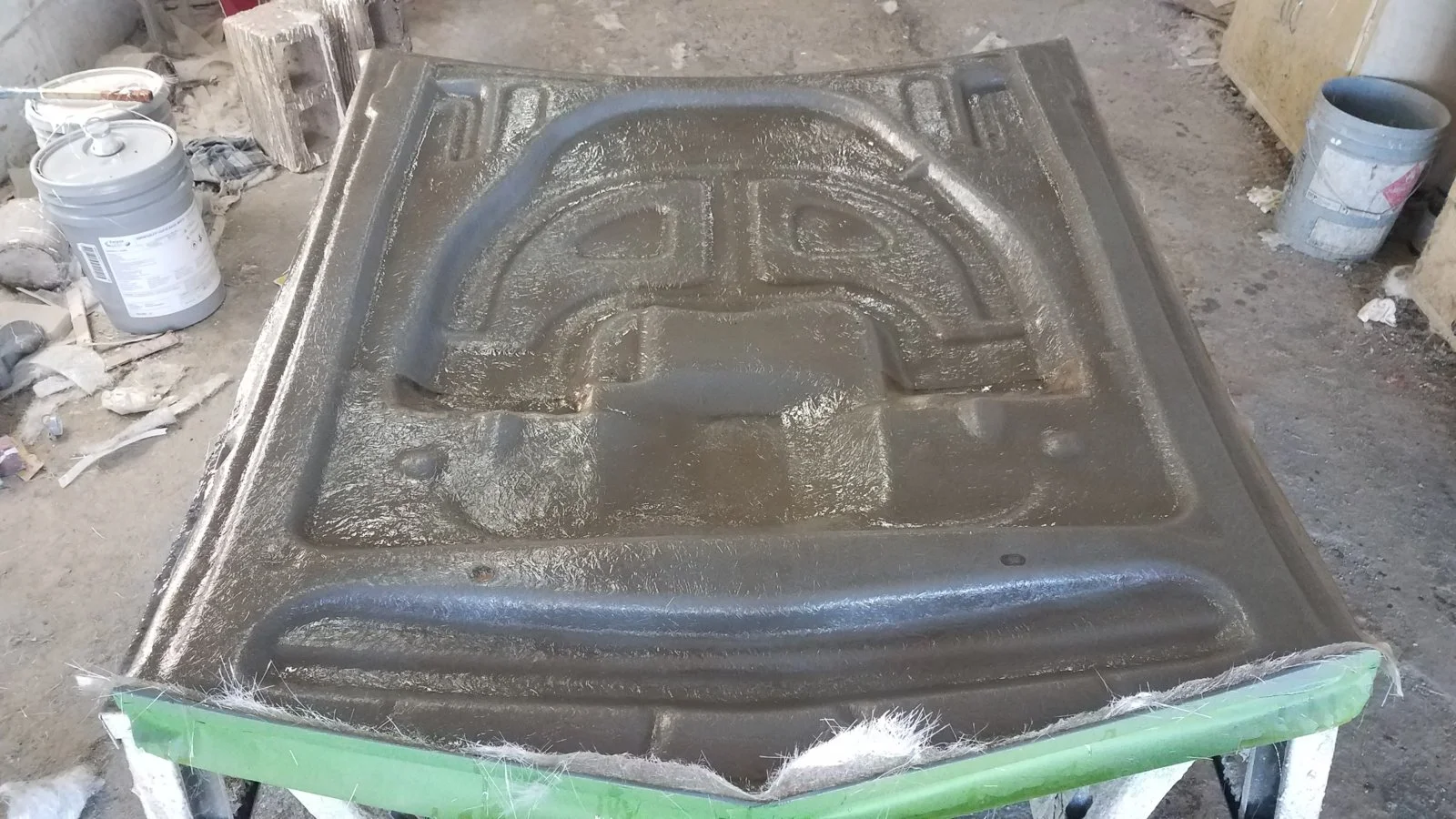

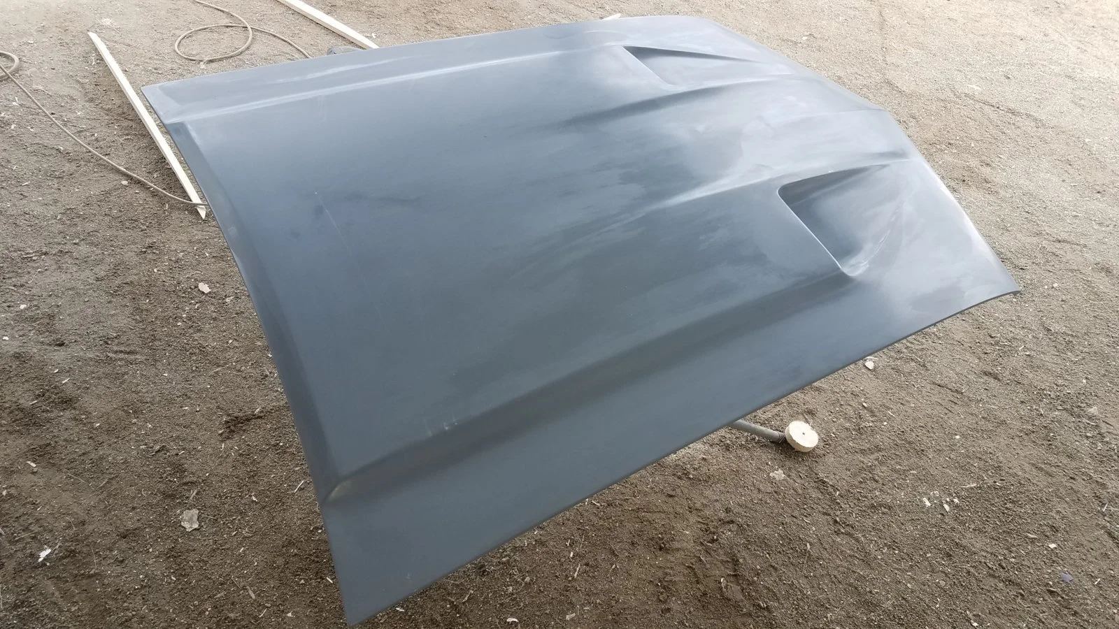

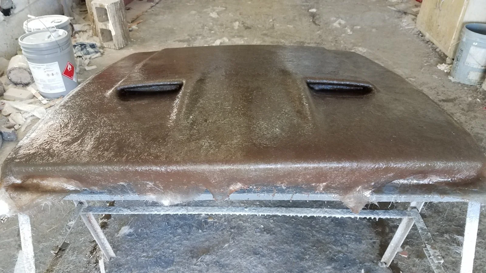

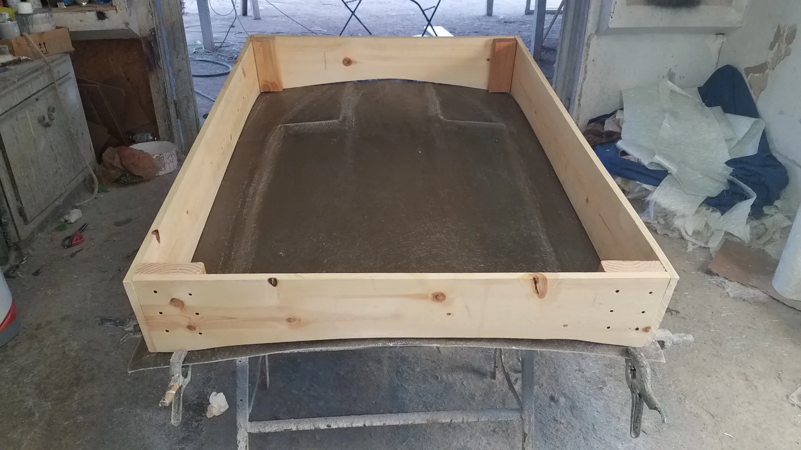

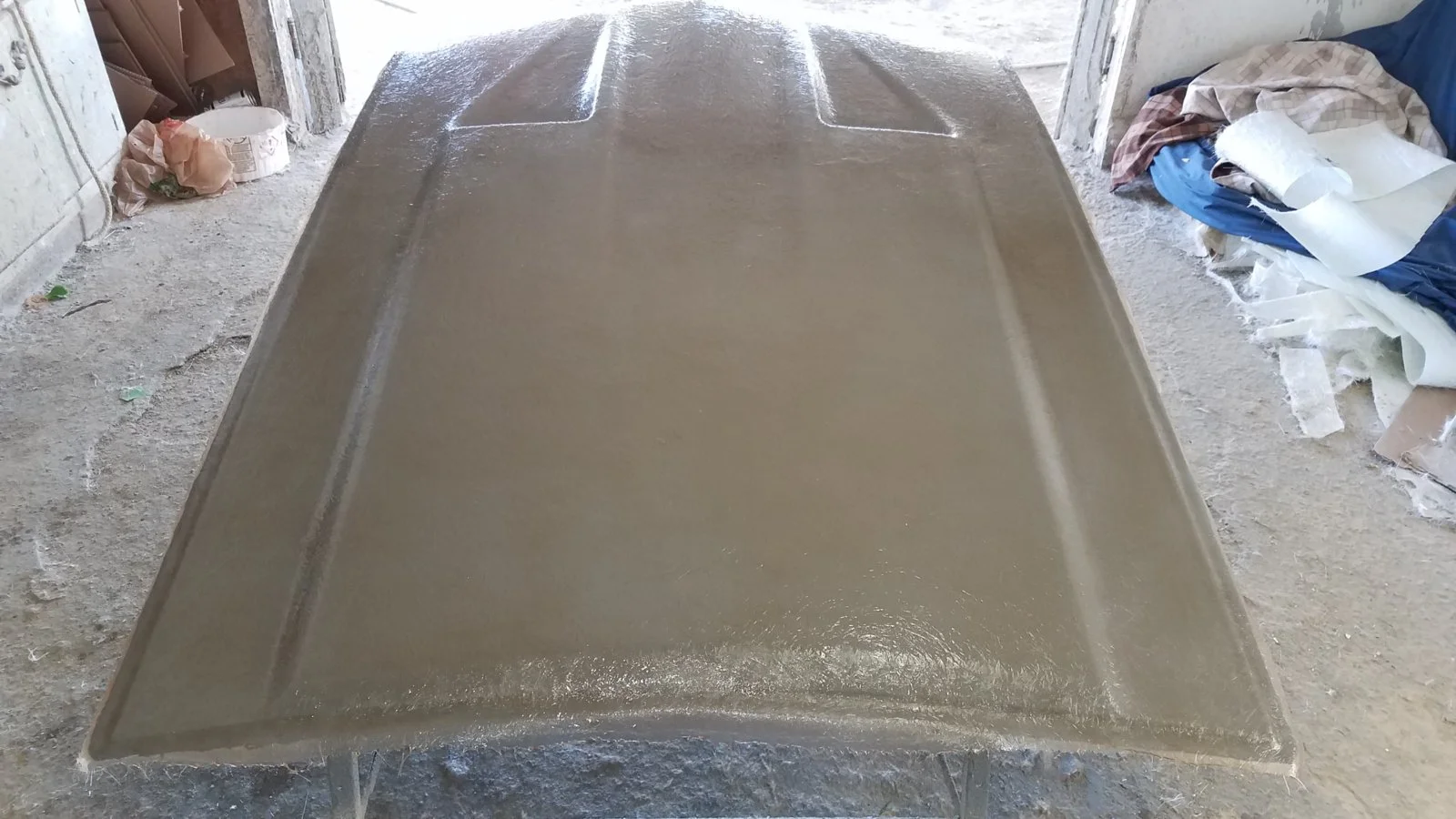

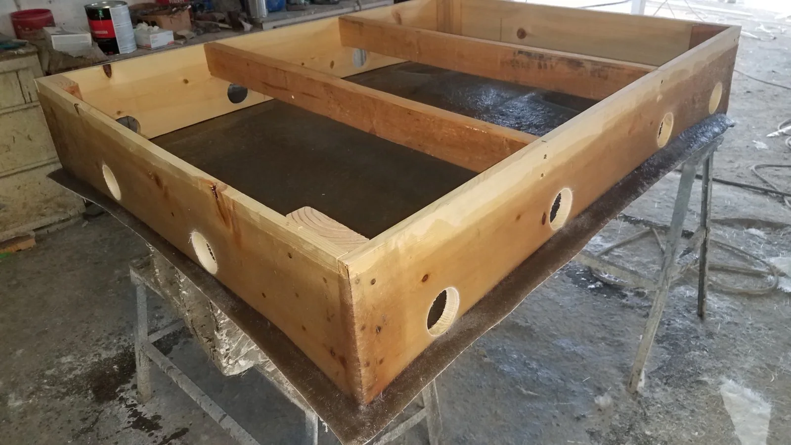

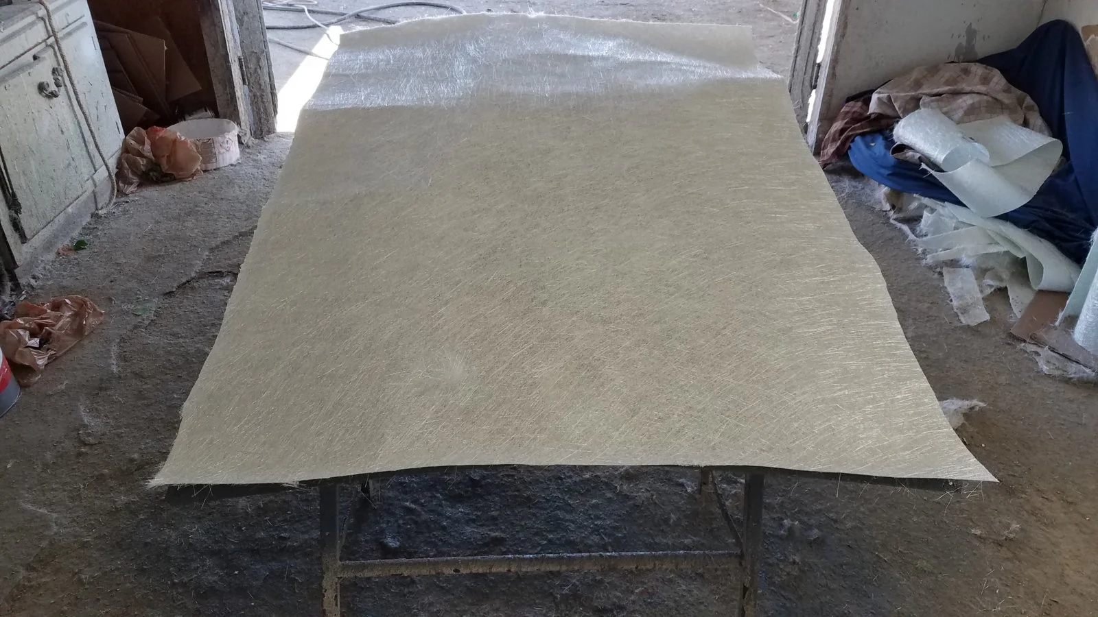

Does that get more support across the middle? or is 6 layers enough for not to sag?
How many of these "Molds" you got lying around?
I saw the fast back interior stuff.
and you were talking other hoods and stuff
