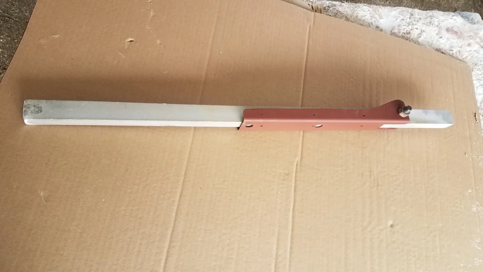

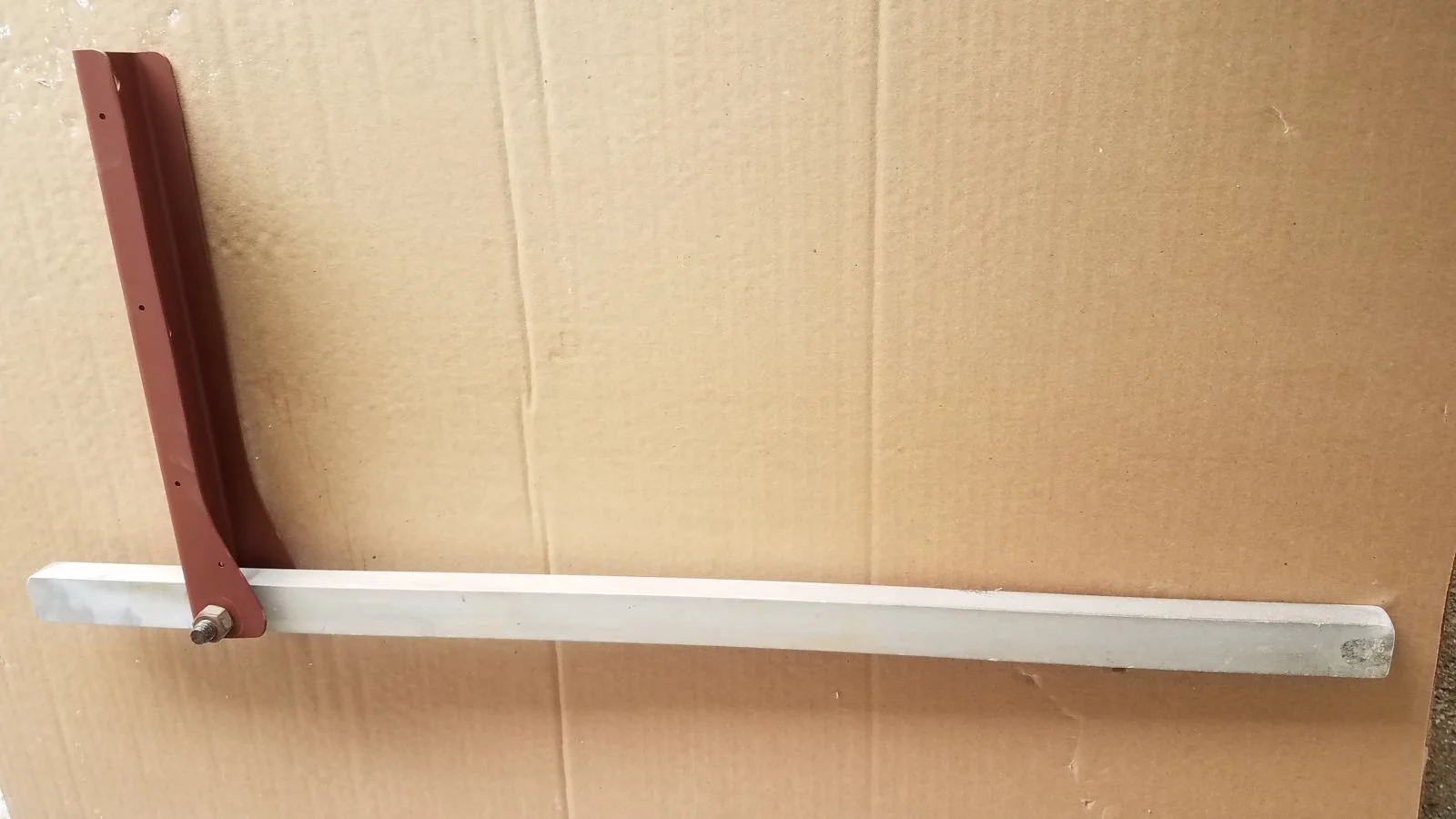

This is one of those made cause i need it tools haha ,it even folds up . It popped that hood right out

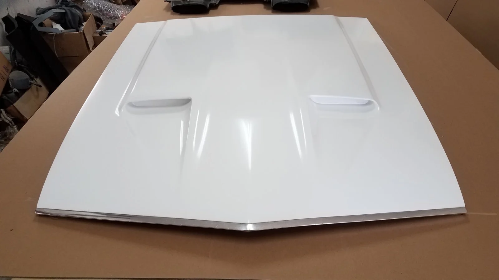

The hood molding fits ,its not even tight

Oh crap ,10 orders ,i may have to make another mold ,good thing i didnt damage the original hood

Ten orders already? You could probably sell that mold to a manufacturer for a pretty penny. Can you patent or copyright a hood mold? If you can, I would, if I were you.
I dont think you can ,it will get copied sooner or later

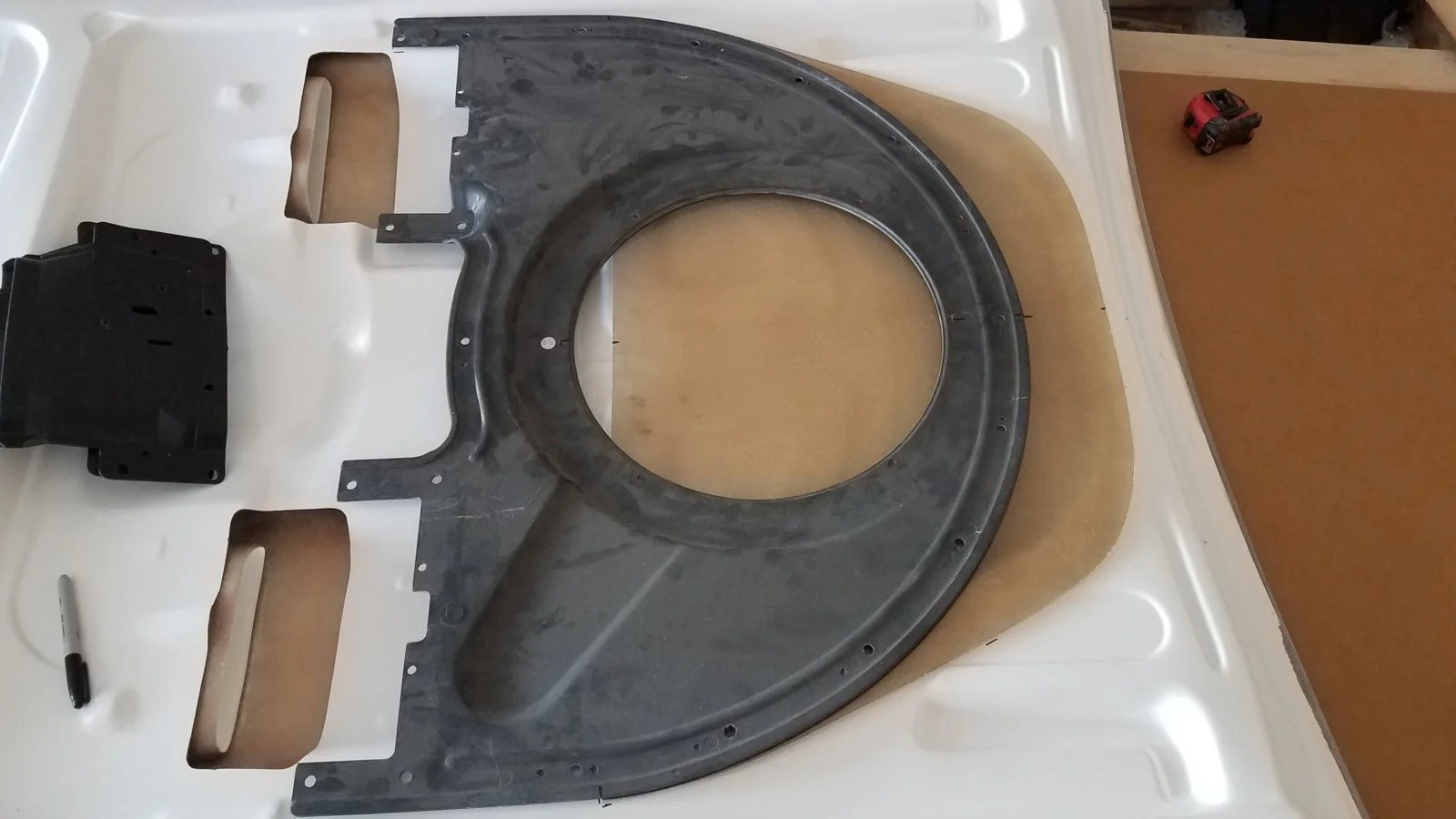

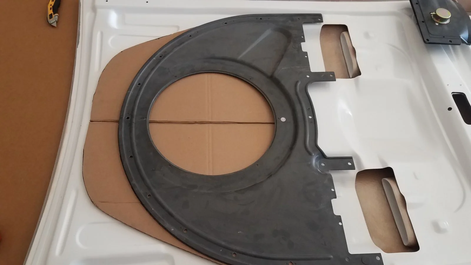

Ready for the air chamber . I made a card board pattern of the shape i need .the opening will be filled and can be cut to fit any motor and any motor location . I also need a sheet of fiber glass to make the extension and fill the air cleaner opening ,turns out an old 67 trunk lid has the right curvature both directions i need for my fillers .4 layers of mat ,when dry it will be cut and blended together to make the new chamber ,i still need to make a quick one time mold of the 71 chamber so i can make a piece to cut up and blend together

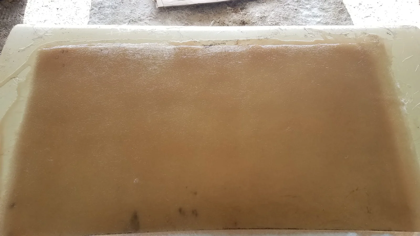

My sheet of fiberglass trimmed , set in place and marked in several places for reference

So you're going to make the ram air chamber in fiberglass as well?
Yes ,the original is also fiberglass . I have to do some modifying first
