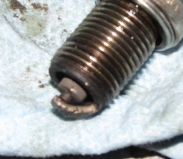

Here's the plug from cyl #8. :(
Car's done for the year, maybe two. I can't afford to put any more money into it for a while.
Yeah it should have been fine at 6800. I know I've hit that rpm numerous times with no problems, other than one time a rocker came loose. :shrug:
Somebody mentioned that running it lean could have damaged the rings. I had it at 18:1 at WOT for a while due to a junk wideband. I didn't beat on it like that, but I didn't exactly go easy on it either. Somebody else suggested it could have jumped time and smacked a valve. I'm going to pull the engine and tear it apart probably early next month.
Ouch..looks liike it floated and all hell broke loose, unfortunatly been there, done that. Just depends how much damage it did to the heads and cylinders.
Shame, I agreee with Paul there was a good bit left in that combo, if I can help let me know ;)
Hold on. 6800 rpms is a lot on a factory style block. Is that a 2 bolt main or a 4 bolt main, and do you run a girdle on it? The reason I don't think it's the valvetrain is because the AFR 225 is a big race head. Thsoe heads are naturally going to be setup with decent hardware that's built to exceed 8000 rpms. There's no reason you should ever have to turn that engine that fast.
Kurt
'69 block 351W, 2 bolt main no girdle. Forged crank, Scat H-beam rods, forged Probe pistons. I agree the heads should be good for 7000+ easy. They're listed at 4500-8500 RPM on AFR's website.
