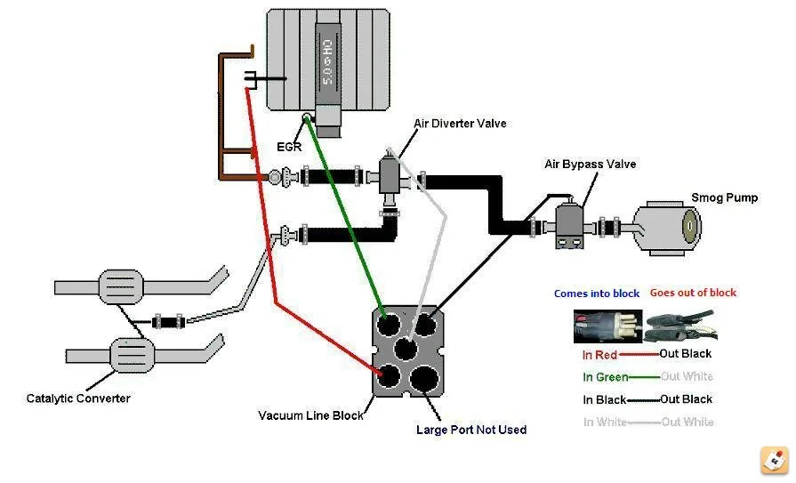

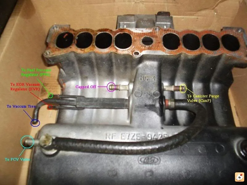

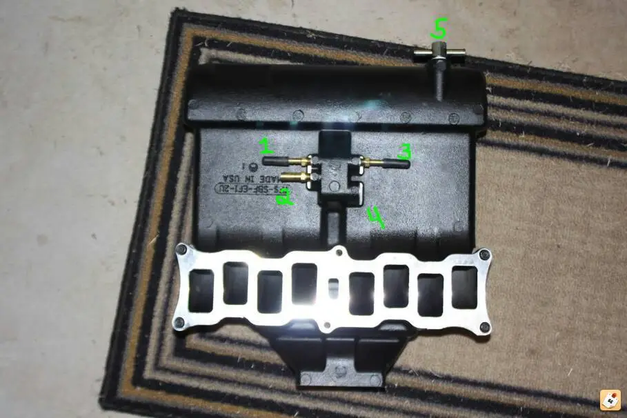

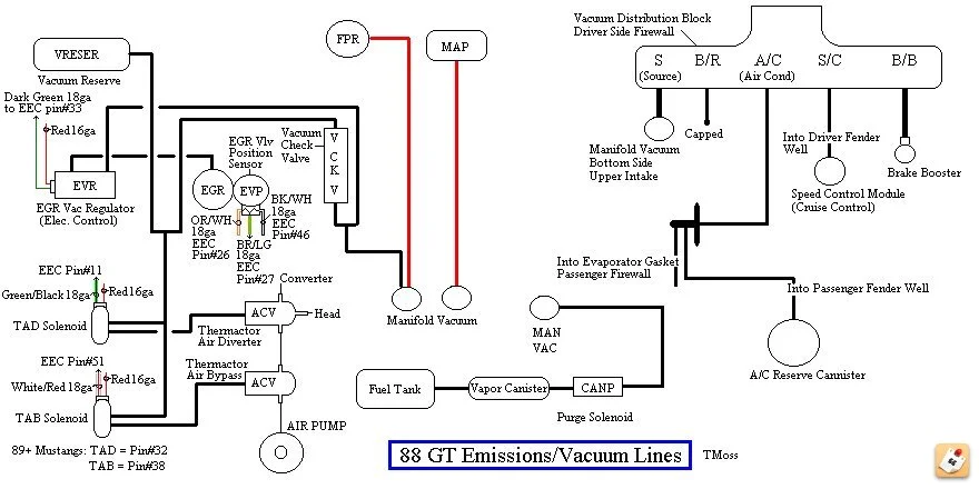

hey guys ..one more thing... Does anyone have a picture of the hose routing of the original 1989 5.0 intake vacuum lines... Or even better, a vacuum routing pic of the track heat setup? I had the super charger on so long I cant rember the routing of the lines.
