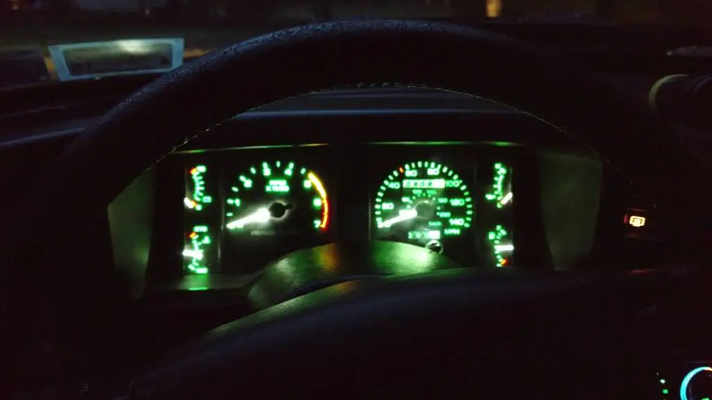

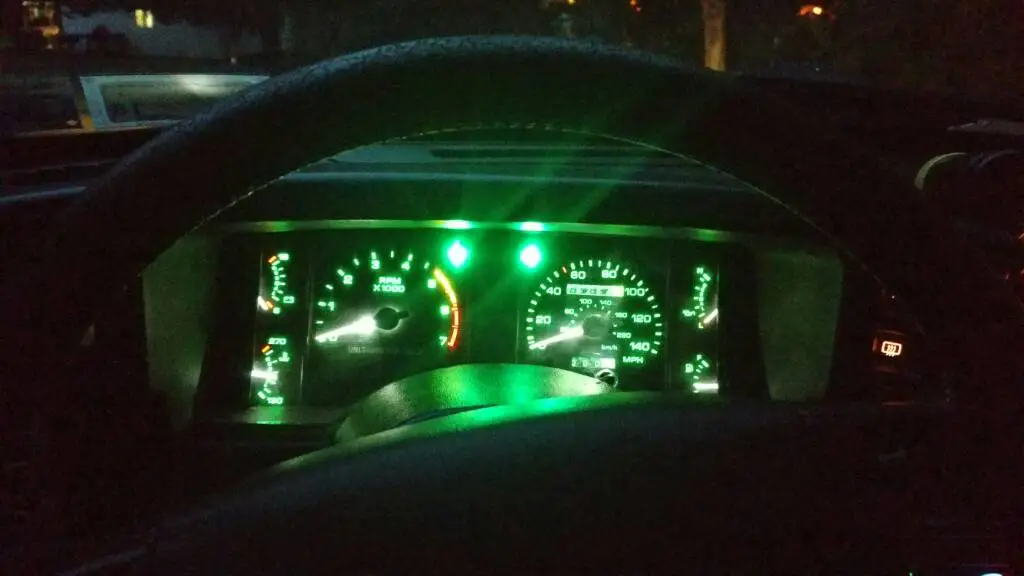

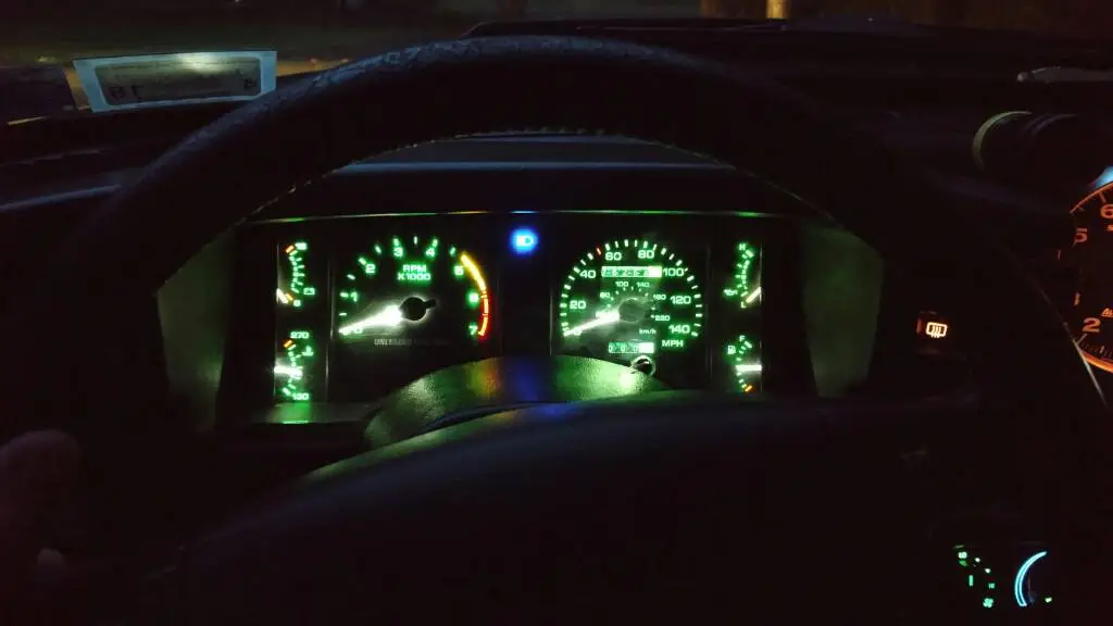

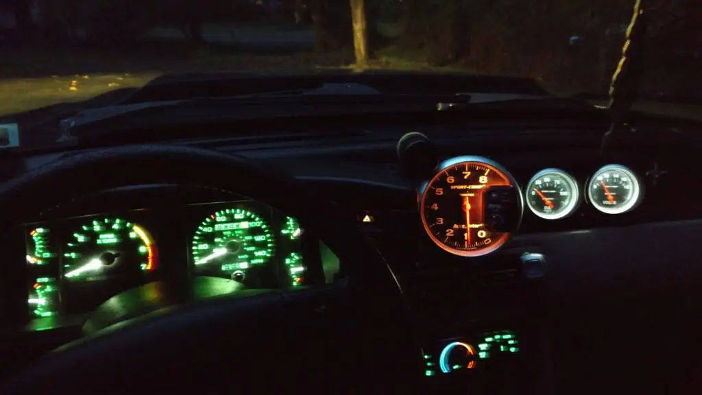

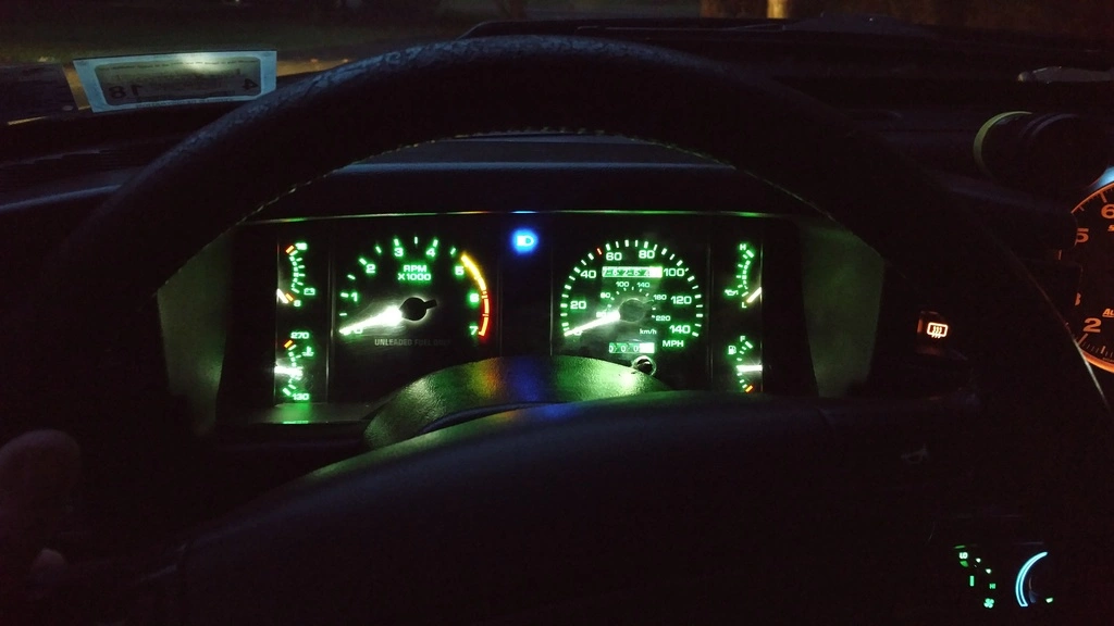

Finally pulled my cluster out and went over the boards. Cleaned them up and re-soldered it. Even though I have the auto meter tach it's nice to have the one in the cluster working again. Also put LEDs in the illumination locations as well as the blinkers and high beam indicators. I already did the HVAC controls and my smaller auto meter gauges Much nicer look to it now. Just got to get one that fits for the auto meter tach and the hazard/defrost switches.
A little trick that may help out anyone using the 5 led bulbs in the cluster. I found the lighting slightly uneven. So I added foil tape all around the sides and on the back of the enclosure to help reflect the light. Some of the bulbs fired right at the side of the enclosure so I figured that would throw some light back out. It worked out nicely as in person the gauges have NO hot spots and it's very evenly lit. Definitely made a difference.
Very nice man, clean and bright as can be now!
Thanks! Less amp draw is always nice too.
Forget to mention I also did the 4 gauge upgrade kit on the PA Performance alternator that the PO installed on the OEM wiring. It actually made a big difference. Volt gauges read higher and much less dip when adding load. Very happy for such a simple little upgrade. I was actually surprised. Even being an electrician I didn't expect to see such a difference.

I'll need to try adding foil. My aftermarket white face guages are very uneven. Even with LED.
I got LED bulbs for the Hazard switch, but the headlight one requires solder. Did you find a good led that will work here?

Hope the foil works for u. I know it made a difference for me but I am not running an overlay.
Oh forgot about that. No, I haven't found a solution for the headlight switch yet.

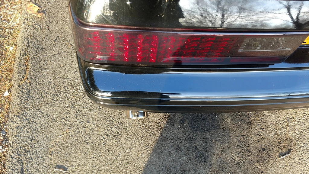

took advantage of the sales. ordered a new catback to get rid of the flowmaster system that was welded in crooked by PO. cant wait to get rid of the drone and the rubbing it was doing. also got a bunch of little stuff, trans exhaust hanger(mine was missing), door to body seals, pedal pads, hatch latch, door pins, and some other stuff that i cant think of at the moment(coffee hasnt fully kicked in)

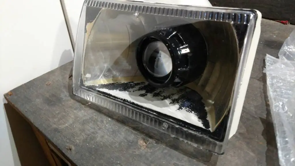

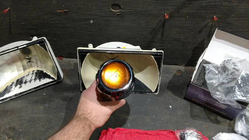

started working on the projector headlights.got them opened up and the chrome stripped. it will be a slow moving project since the car is parked till at least march so i am in no rush with my first retrofit.

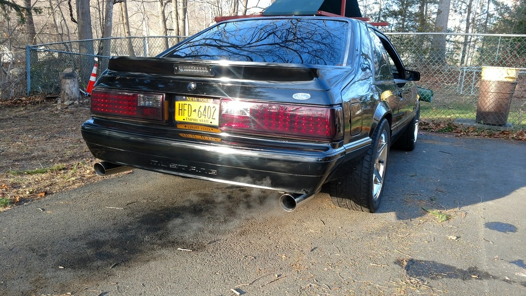

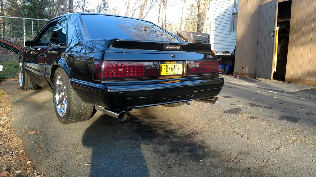

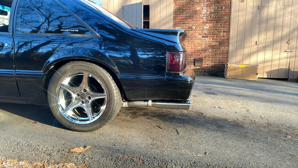

exhaust is installed. i know the SLP system is either loved or hated. i love it. its quieter in the car while cruising than the flowmasters and its louder in and out when WOT which i like. it has a deep sound and almost sounds like a modular motor when your in it. i have a warm start rev video but it doesnt do it justice. it sounds way better under load too. fitment was good and the tips look amazing!
View: https://www.youtube.com/watch?v=KX6KDh1YXV4
dont mind the exhaust leak, i found it and tightened that up
its pretty damn close to straight. ii got some more tweaking to do but i ordered a couple new hangers that i need so ill wait till they come in

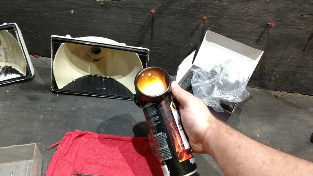

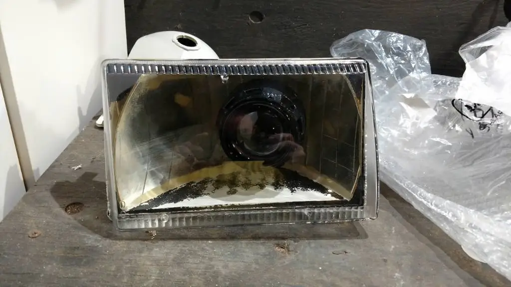

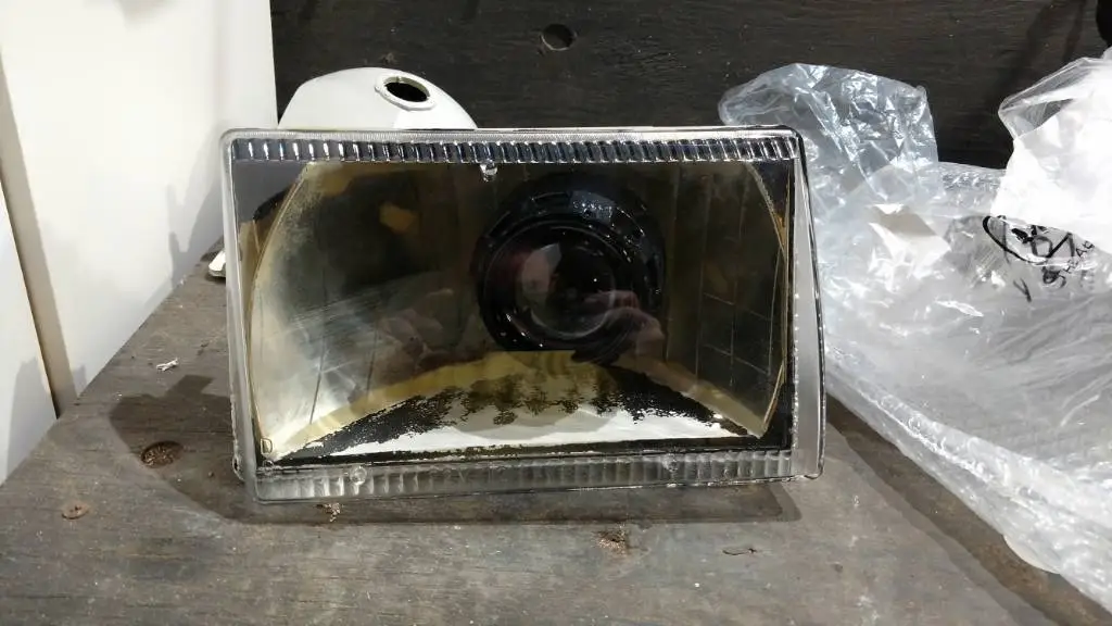

Little bit of progress on headlights. Started mock up and paint prep and final trimming(hopefully)
Going to go with passive demon eyes. Going to paint the shields and it should show thru with the lights off. Here is just an example of the look I am going for
Going to go with passive demon eyes. Going to paint the shields and it should show thru with the lights off. Hear is just an example of the look I am going for

I don't see how many you'll get that can to fit in the headlight.:p
