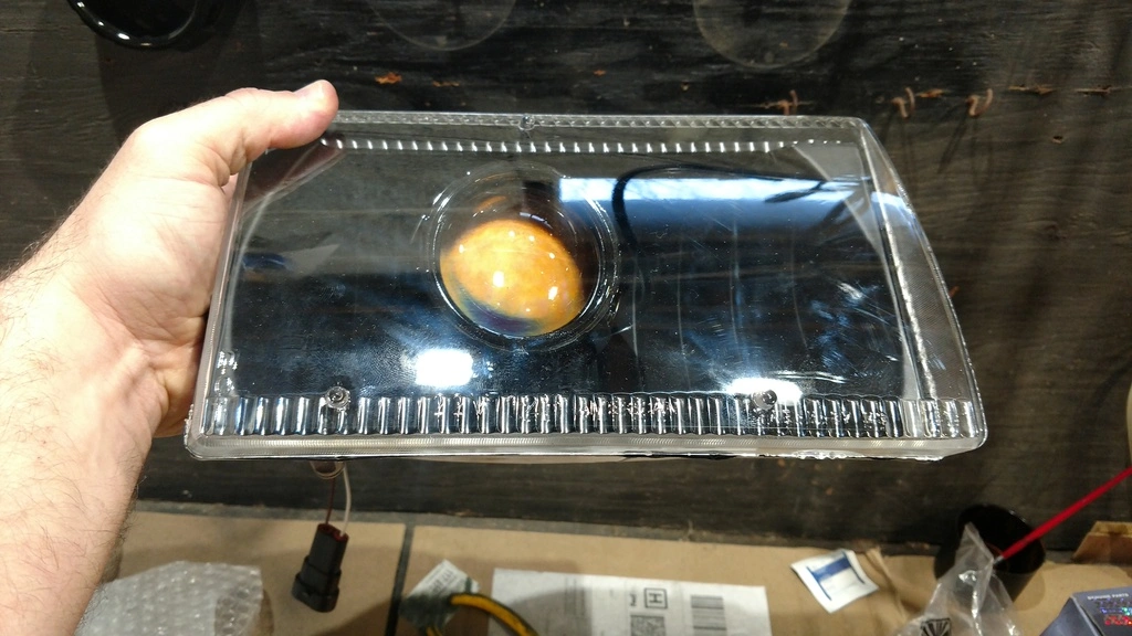

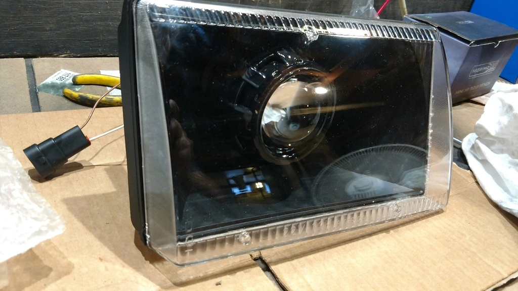

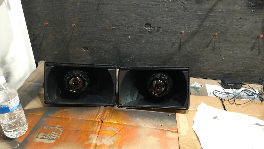

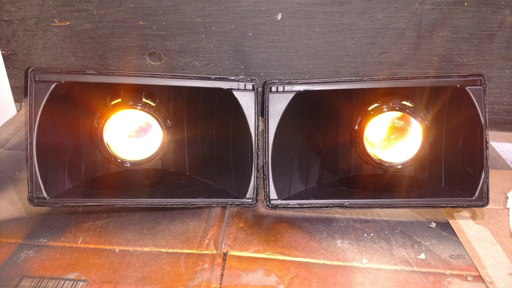

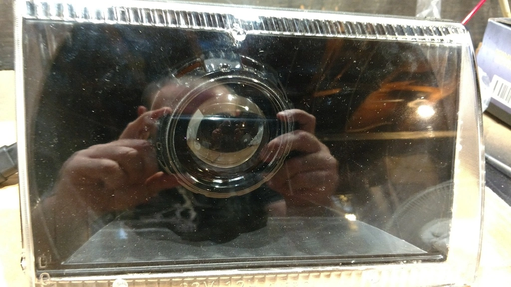

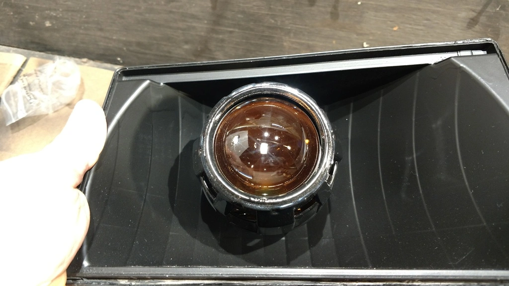

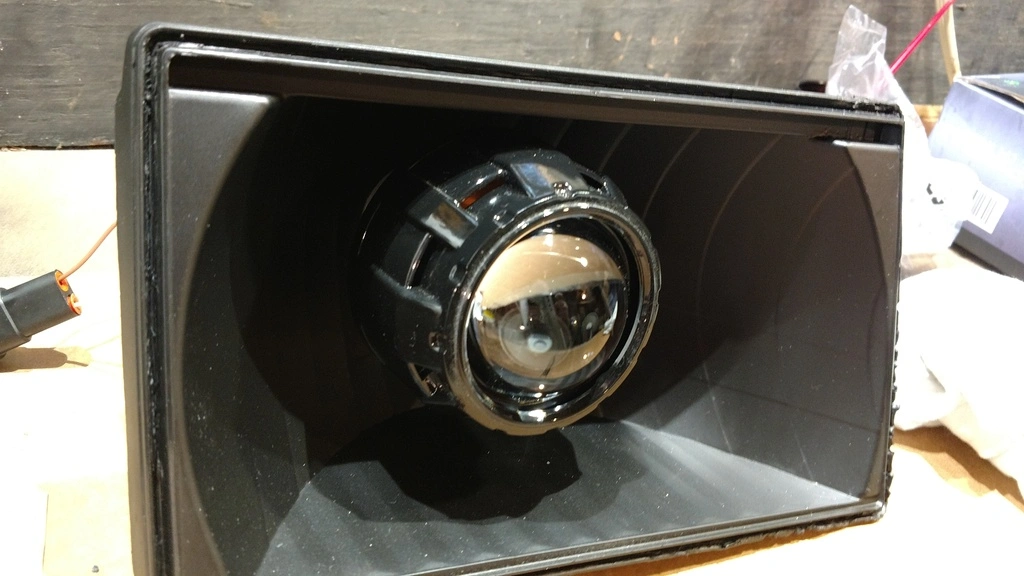

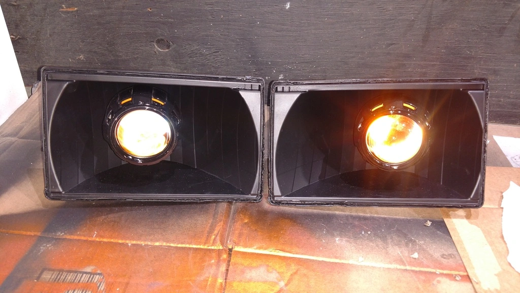

ok so here are some progress pics. please excuse the lint and dust on anything. this is not finished product at all. still need to make final adjustments after test fitting them in car. i only put the lens on temp with no butyl so its just stuck on there. after final adjustments they will be cleaned and then sealed up.
i did flat black on the headlight buckets and gloss black on the shrouds with a copper shield to give the passive demon eye look.
there are no scratches on the lens its just dirty
lighting isnt the best in my basement to show off the demon eye look so here are a couple pics with flash. the light inside the headlights is just the flash reflecting off the painted shields. in daylight the passive demon eyes will not be as pronounced but will show a lot more than the previous pics
let me know what u guys think and if u have any questions please feel free to ask.

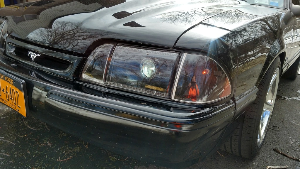

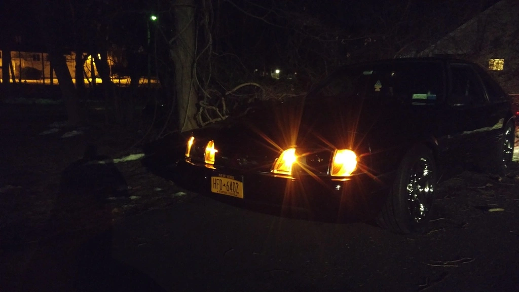

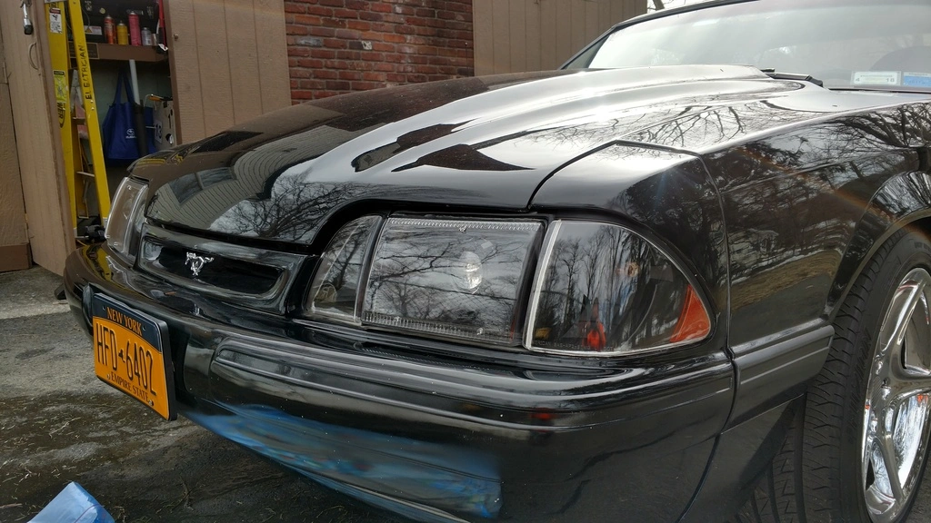

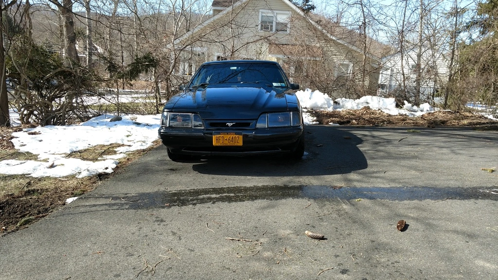

finally finished the head lights. so they are in but just need some fine tuning to get the cutoff perfectly level and even. other than that they are in and working. light output on low is very good and the high beam is great. to me they look good and im happy with how they turned out. again this is flat black buckets with gloss shrouds and a copper metallic passive demon eye. its the MH1 7.0 projector with Moromito 35w 5500k HID's all from TRS. here are the pics, i didnt post any with the HID's on at night as the pics arent coming out good. ill get output shots posted later on once they are dialed in.(please excuse the dirty car)
Reactions: mark007, General karthief, FoxMustangLvr and 3 others
