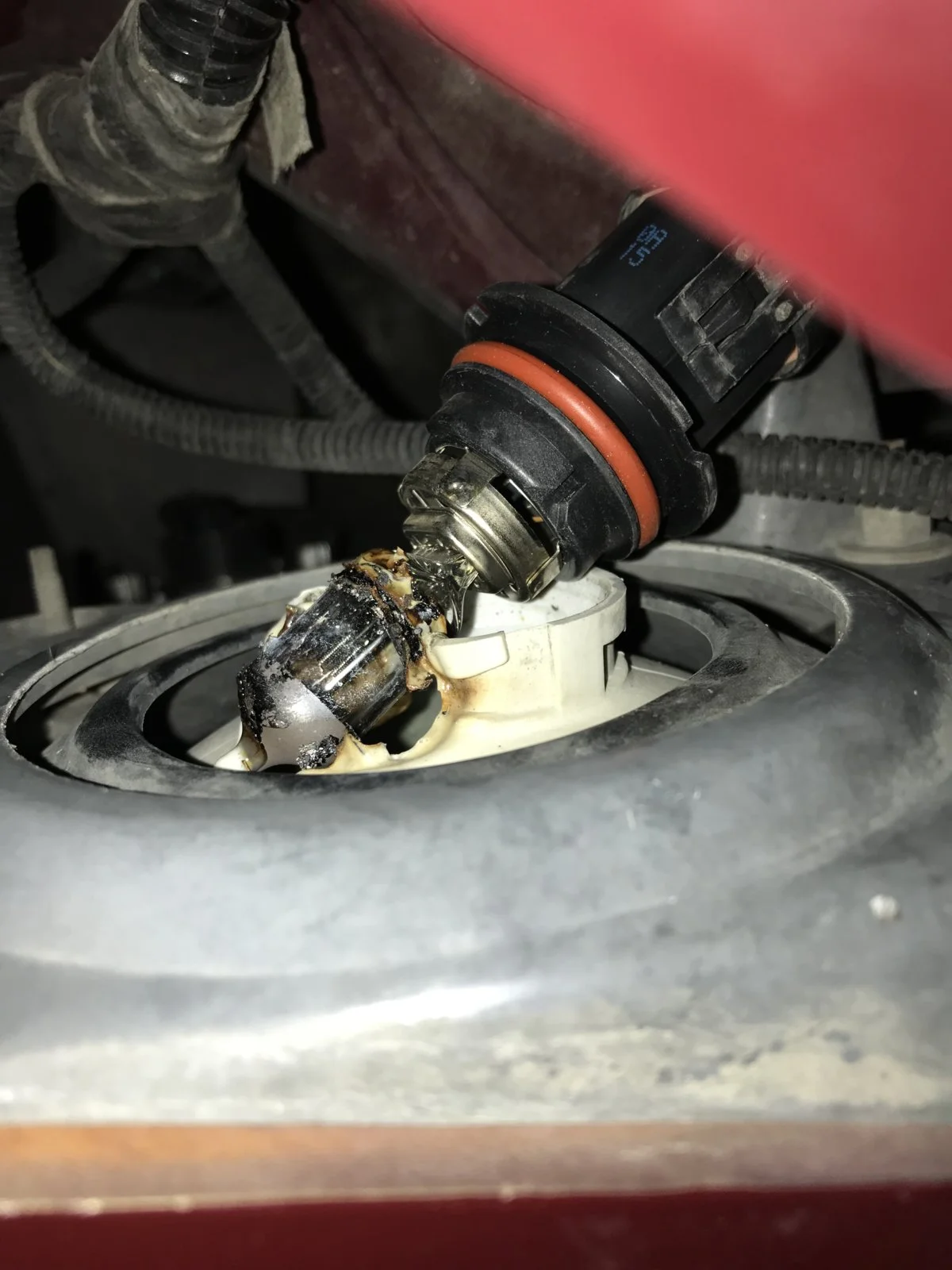

This update is for my dear friend Mike @CarMichael Angelo. I give him a fair amount of crap, and so Karma always comes around when one does that.
When pulling out of my tuner’s house Monday, his oldest son comes running to tell me I have a headlight out. My tuner had a 9007 bulb laying around, which doesn’t fit properly, but I needed something to keep from getting pulled over (Worked, but got pulled over anyway). We wedged it in and it seemed to be tight enough to stay for my drive home.
Last night I bought a pair of 9004’s. Drivers side took 3 seconds, passenger side...

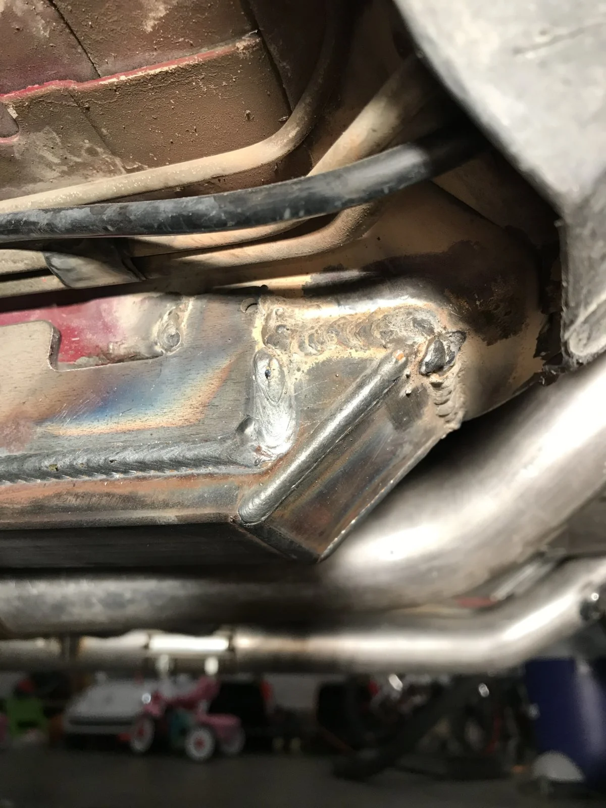

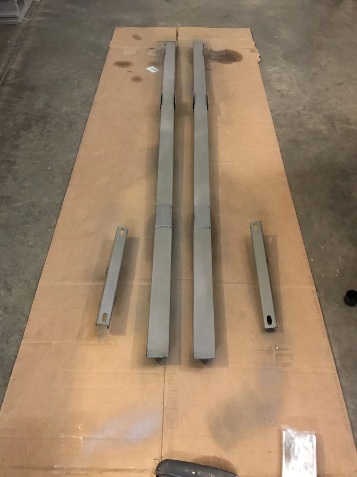

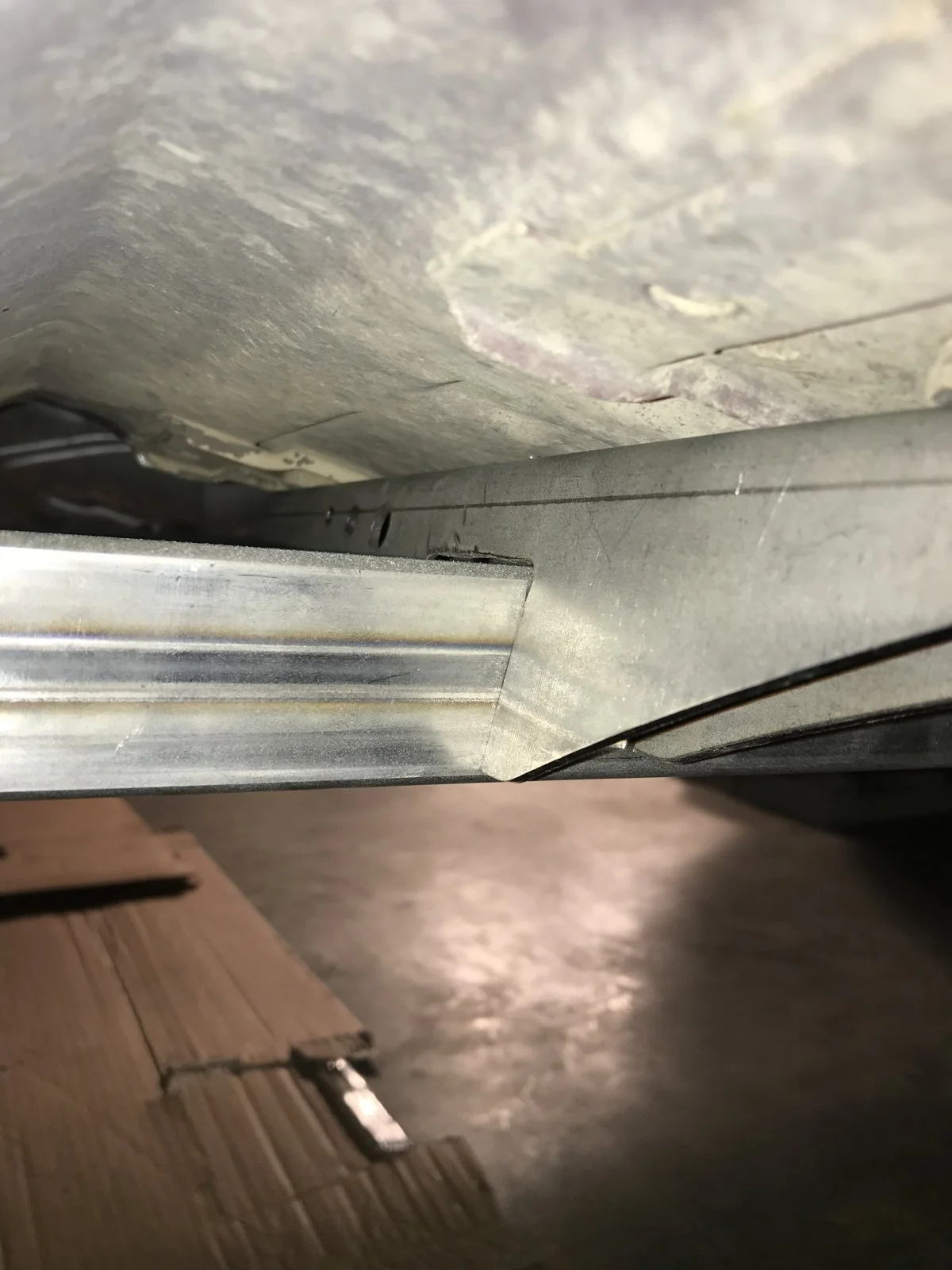

Today was subframe connector day.
First I etch primed the top sides
Then I started to fit them. The one piece seat braces are nice, except they didn’t fit. I had to cut the notches deeper to allow the SFCs to sit flush against the car.
Only managed to knick one of my thumbs in the process.

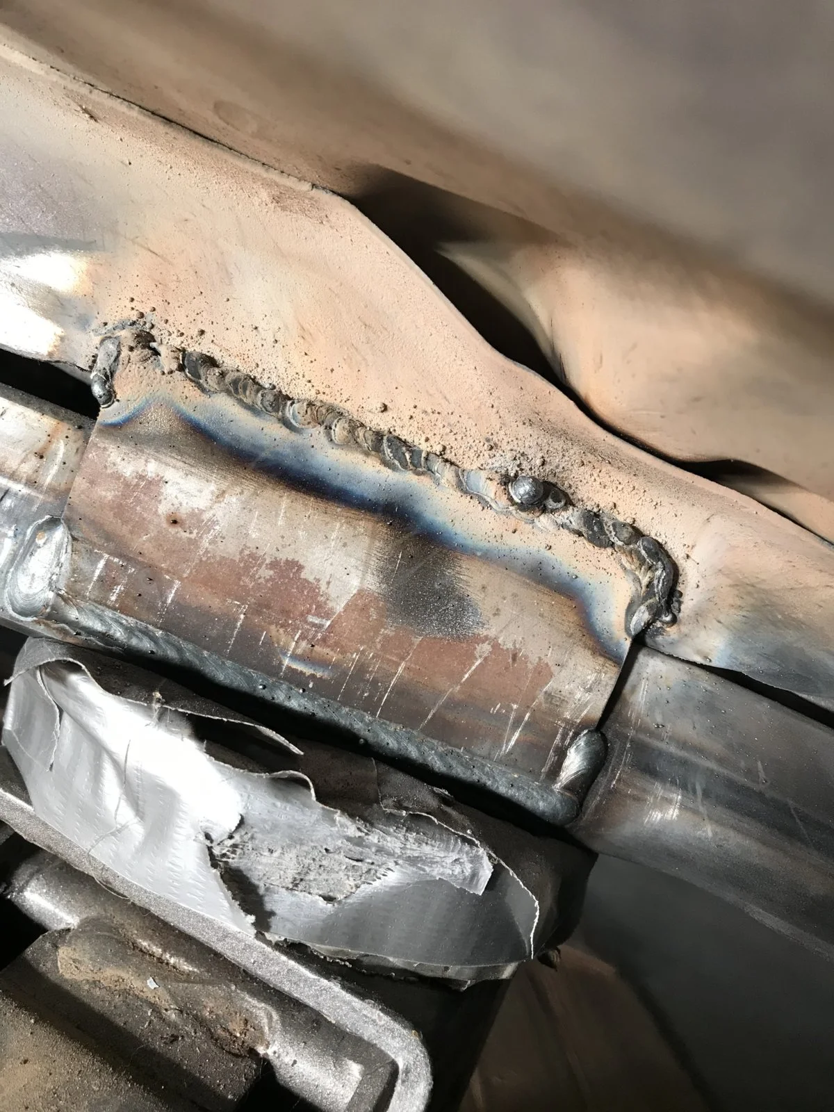

My first welds were a little weak. Had to play with the machine to get them better.
They aren’t going anywhere now though. With that done, I can finish grinding and painting the underside of the car.

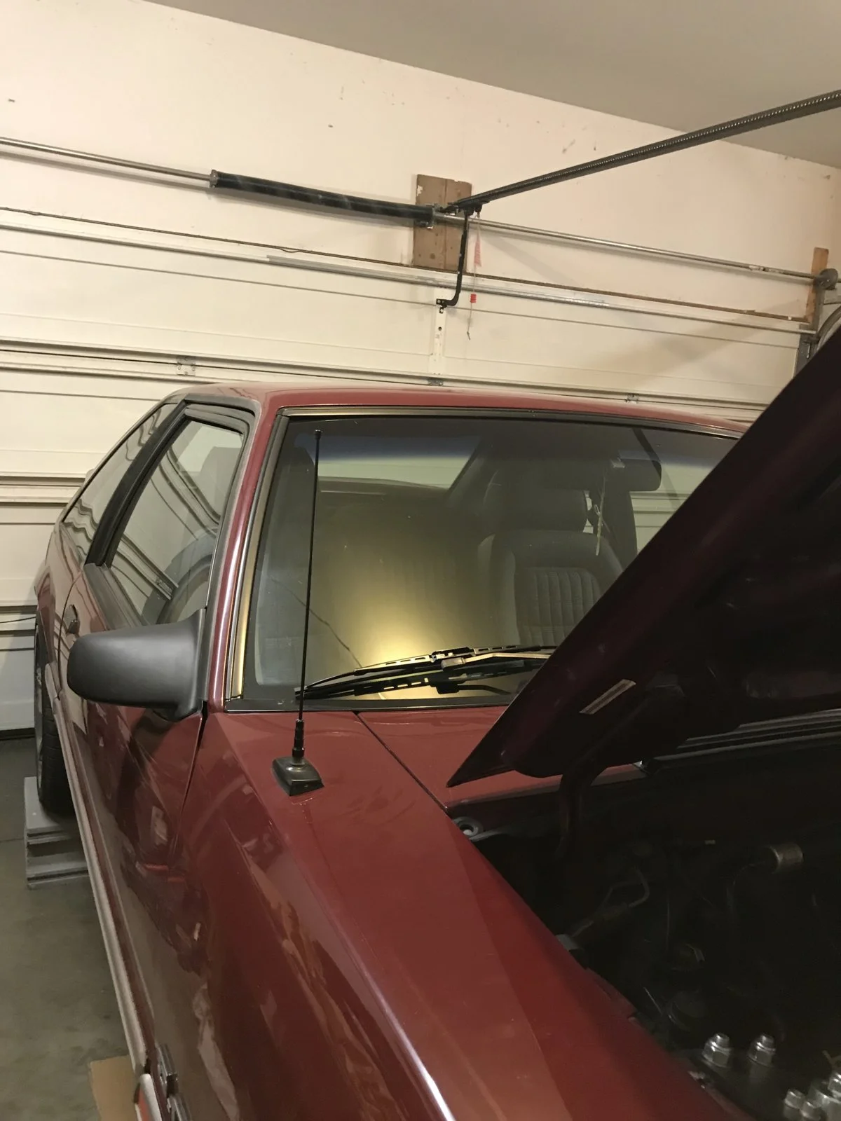

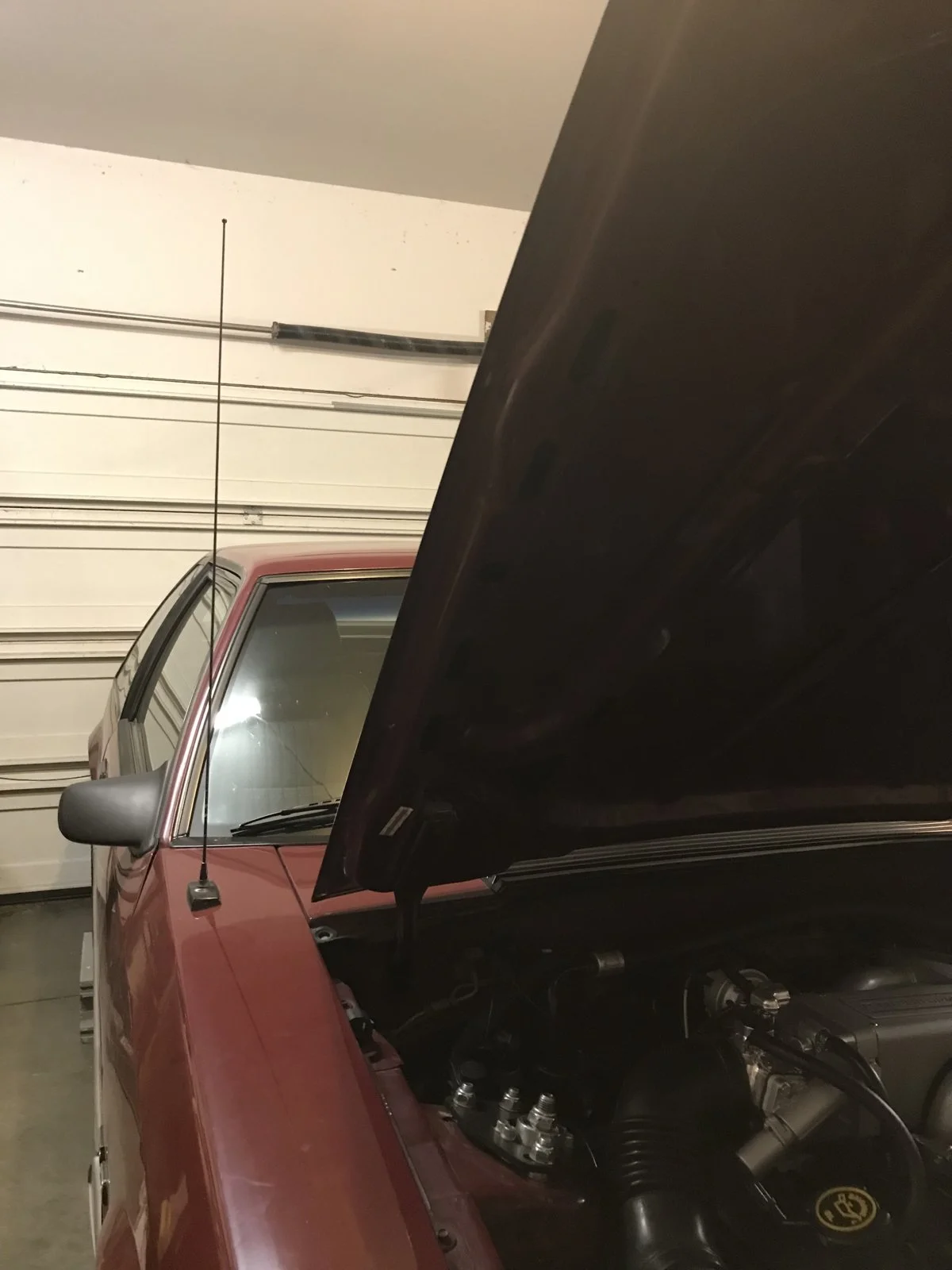

More piddly stuff. I like to think all the little things add up to a nicer over all product... At least that’s what I tell myself.
Before:
After:

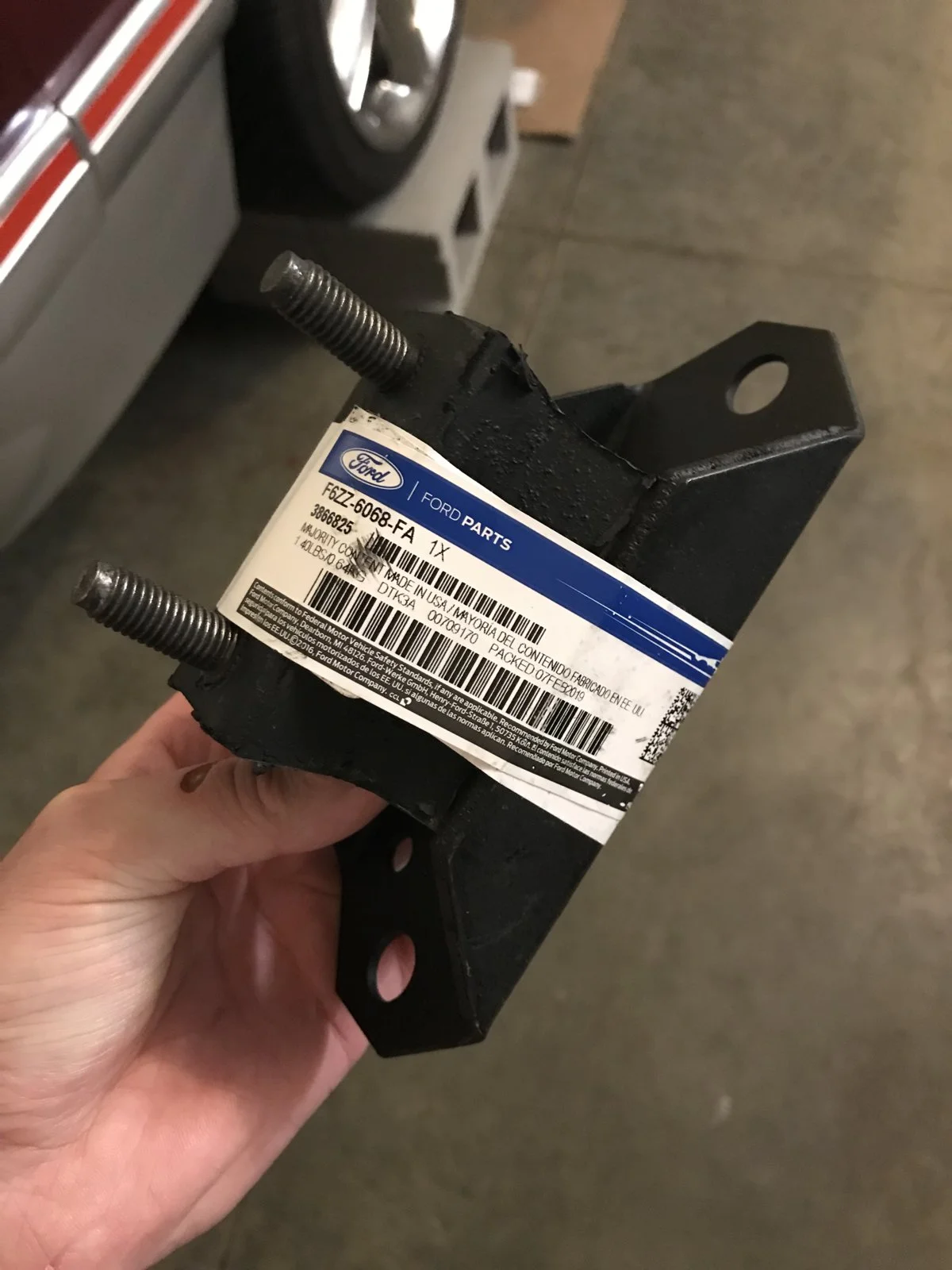

And this guy is going in when my wife gets home. If anyone wants an Energy Suspension poly trans mount, PM me. Too harsh for my delicate tastes.

Stop being a wuss.. A poly trans mount is too harsh..?
If you ever ride in the monster, at ANY point in the future,......I'll make this commitment...
I'm not putting salve on your owies...and I'm not kissing your boo boos.
Now I understand why you'd want an antenna with a shorter shaft.

Of course I got the poly mount out easily enough and thought, “wait, I should find the nuts that go on the rubber mount while it’s in my hand.” I always thought I was good about keeping random nuts and bolts. That was until tonight when the stock ones are no where to be found of course. So much for installing it tonight.

Will leaving the poly engine mounts in and changing the trans mount to a stock rubber mount cause the trans to become the weak point and put more stress on the trans mount? I'm in the process of changing all my stuff out to poly, and read somewhere that mixing poly mounts and rubber mounts could cause issues. I have no personal experience with it so who knows!
It’s exactly the opposite. If you have rubber engine mounts and a poly trans mount, you will hurt your trans because the engine can flex and the trans can’t. A rubber trans mount is fine with poly engine mounts because the engine’s twist is limited.
