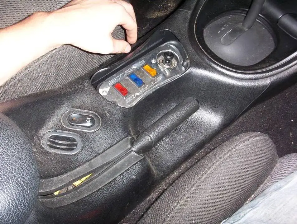

My switch panel to power my tuning box

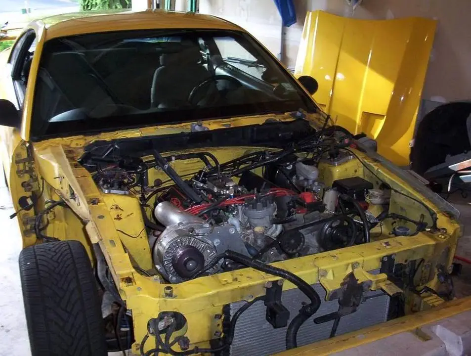

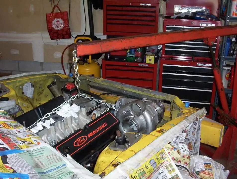

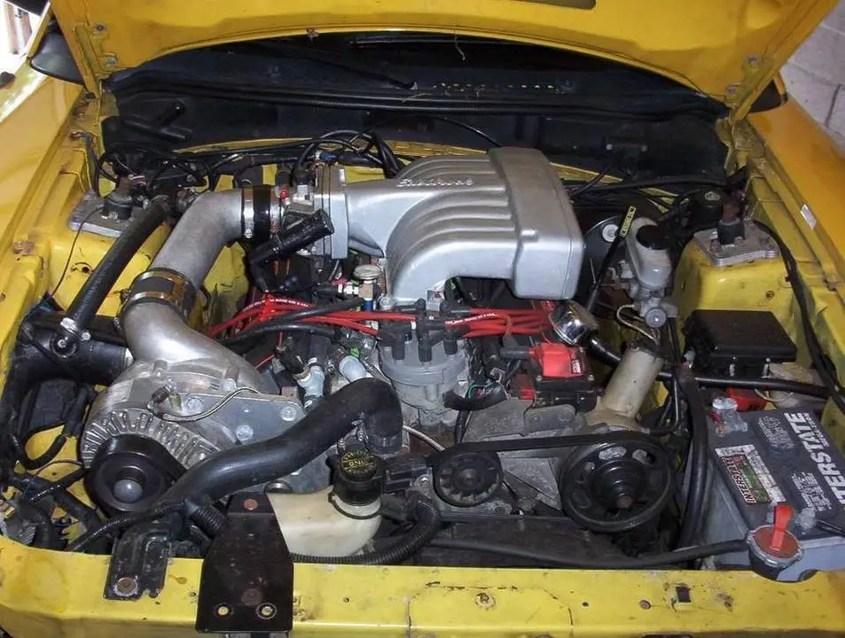

And part 2....

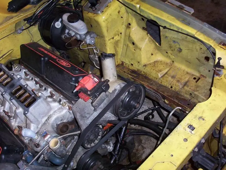

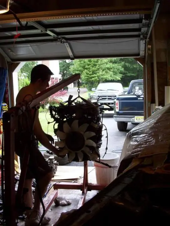

Me being excited
Its out
My happy co-worker

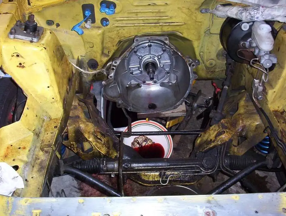

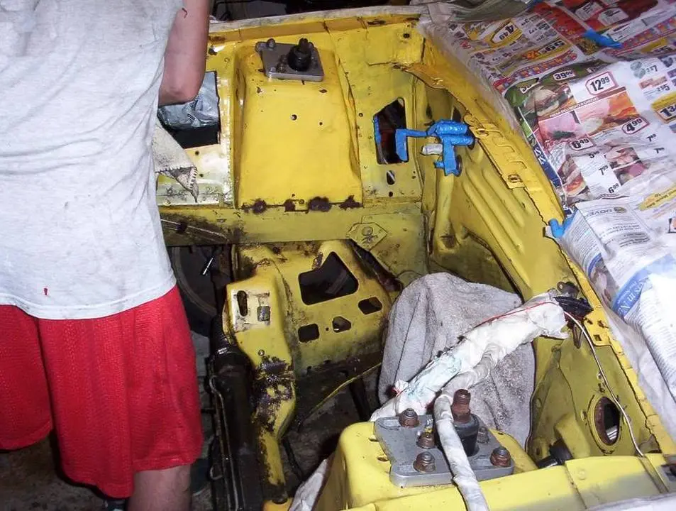

Empty bay
This is why you should take your seats out when you pull the brake booster
Cleaning up the bay
Yellow302
Mar 2, 2003
789
NJ
Jul 9, 2008
  • Jul 9, 2008

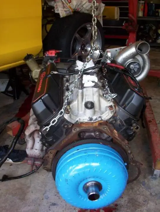

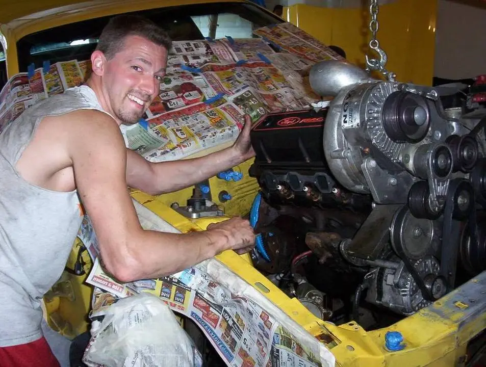

Part 3 now...

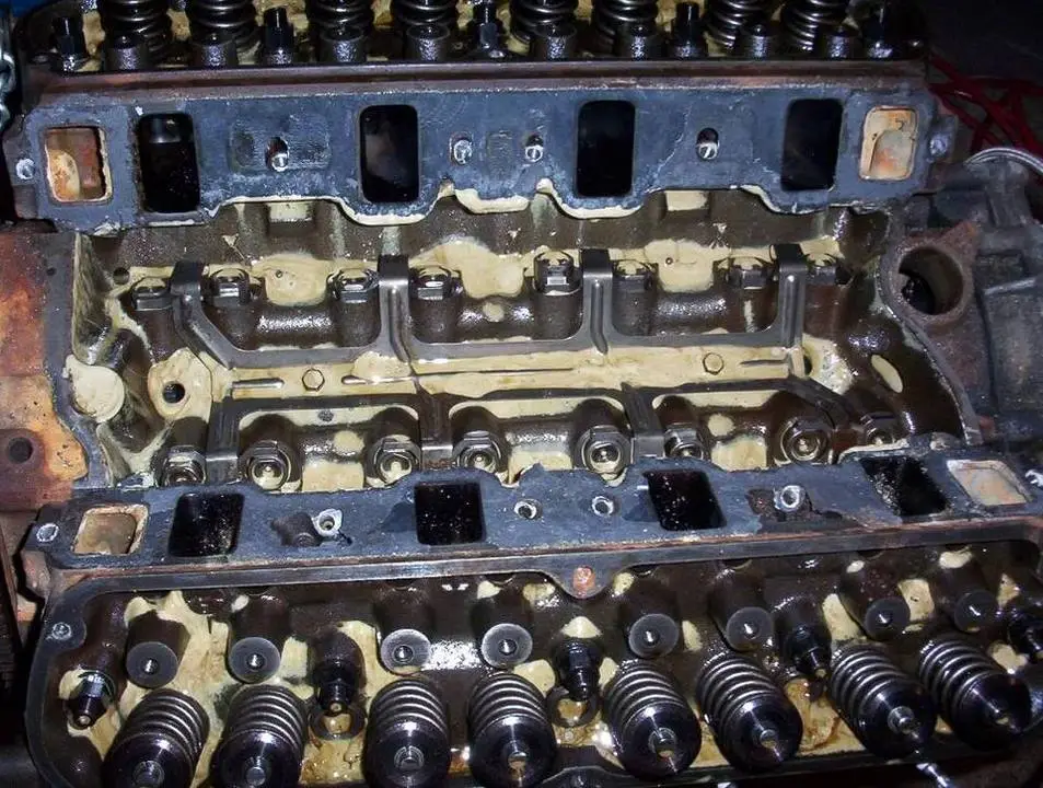

Reason to pull an engine
Very sexy oil

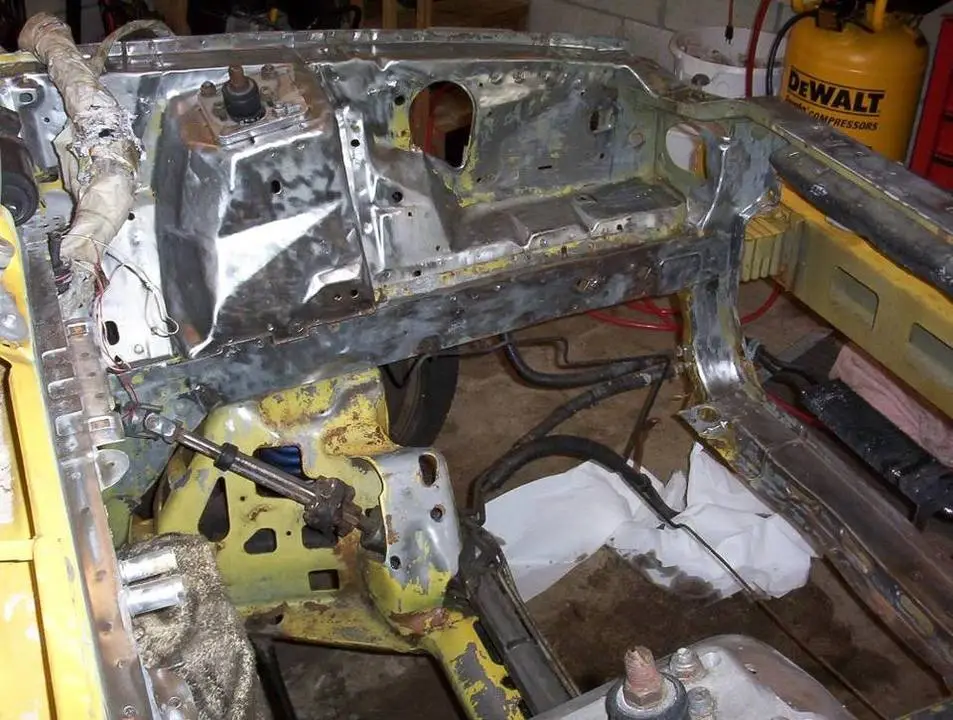

Some bay work
more bay work
more...

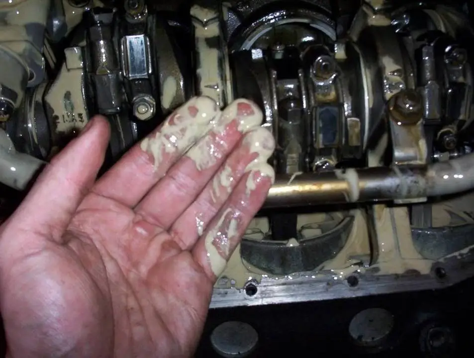

valley

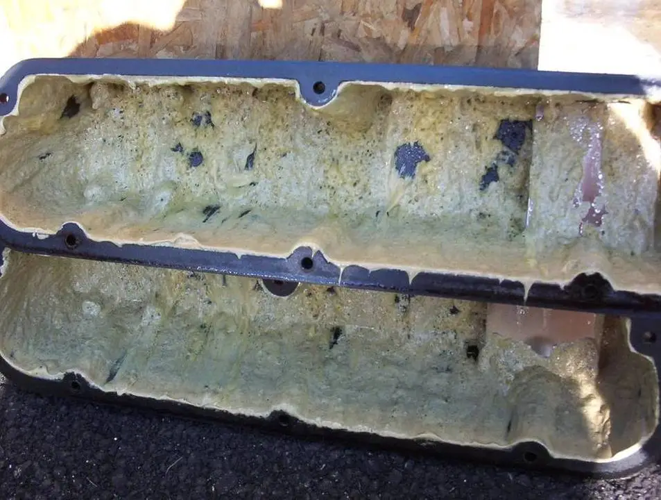

Don't let this happen to you!

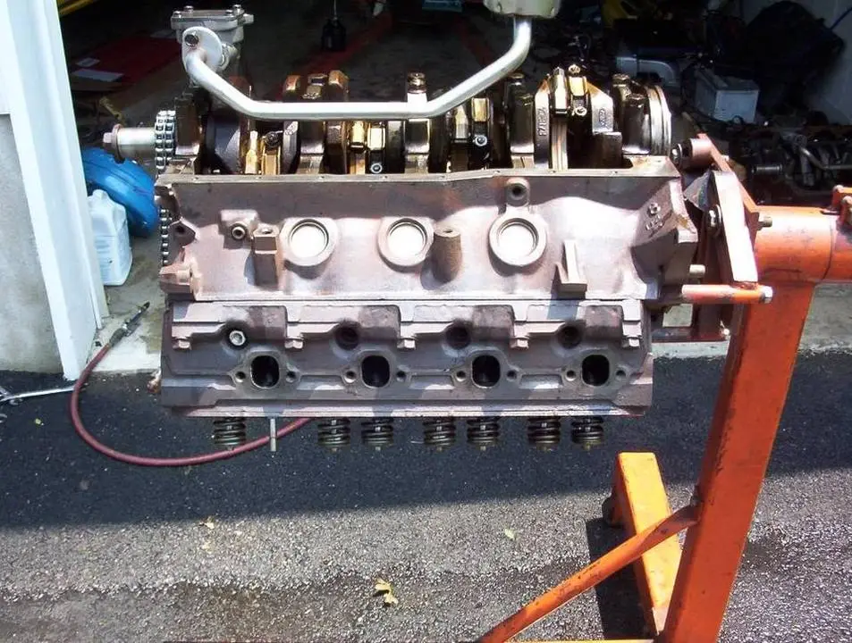

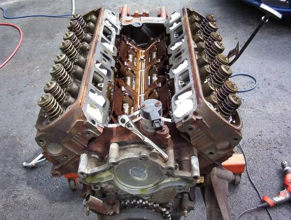

NEW ENGINE FROM THE JUNK YARD

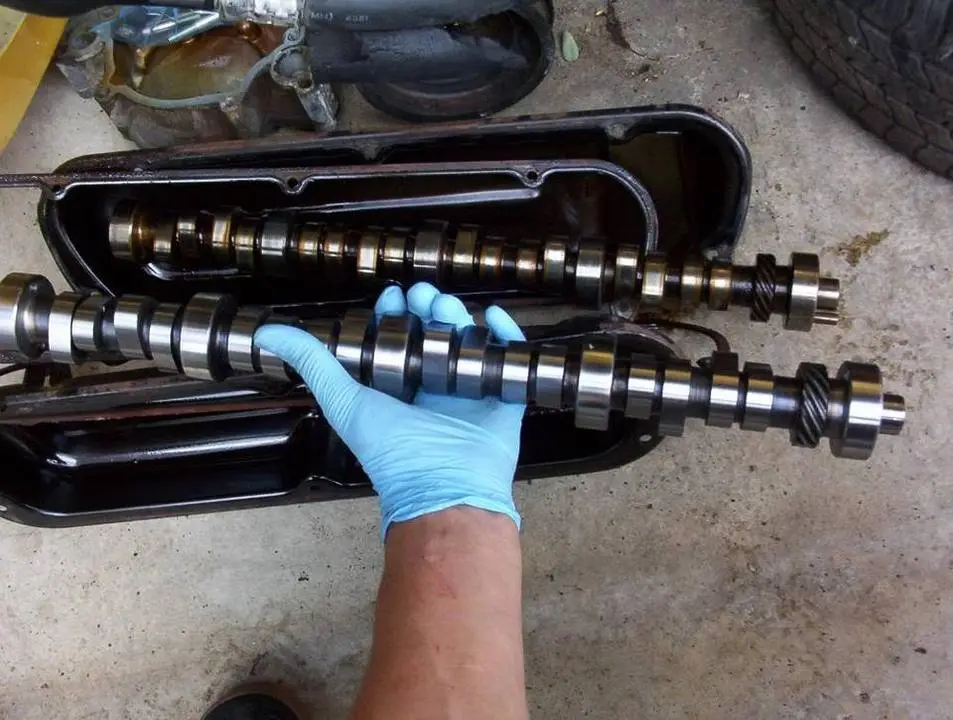

Old Cam and New
Yellow302
Mar 2, 2003
789
NJ
Jul 9, 2008
  • Jul 9, 2008

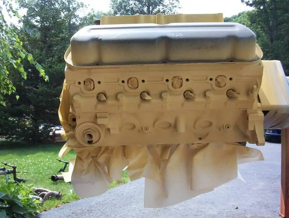

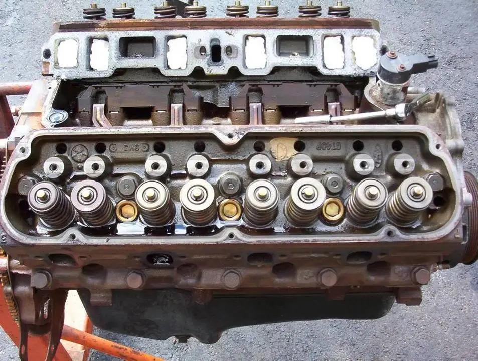

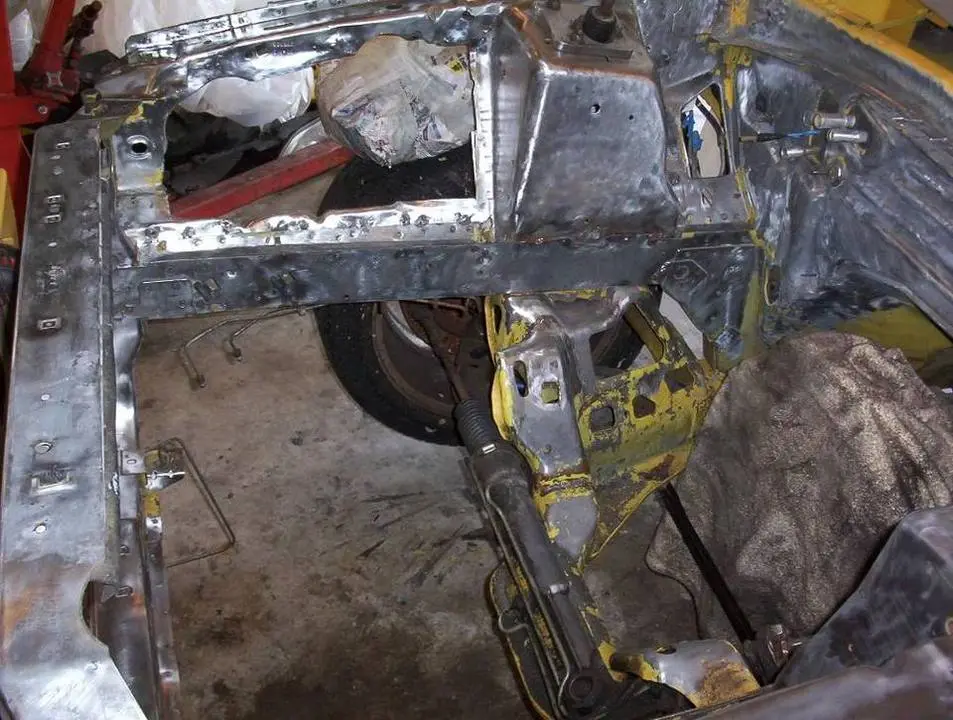

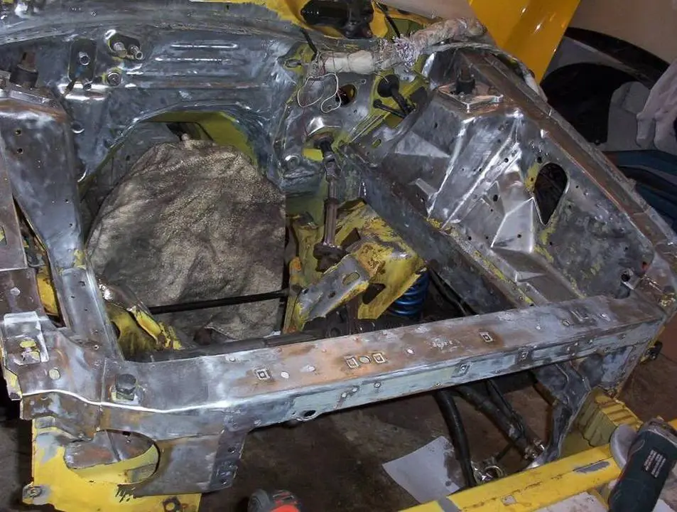

Part 4 - Current status... Need 2 goats of grey on the block and we are ready to re-assemble the new engine. Still waiting for a friend to weld the bay.

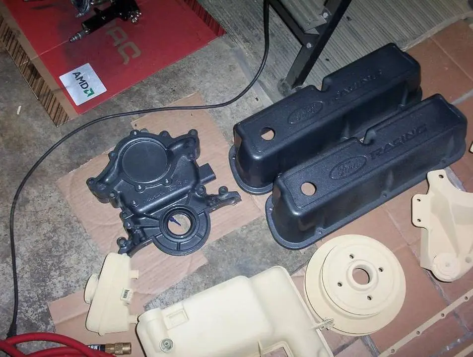

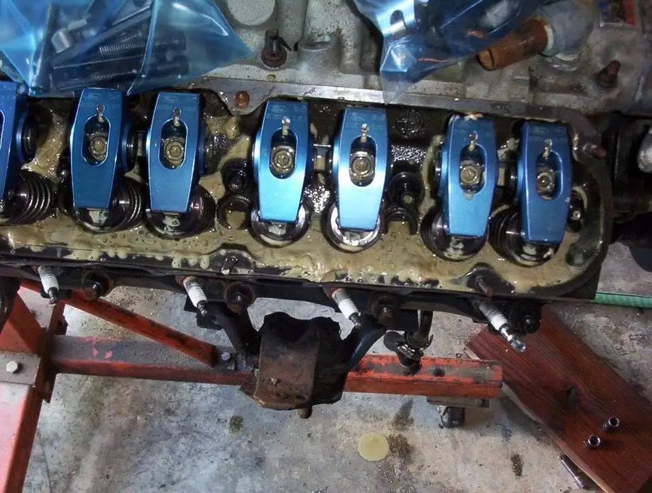

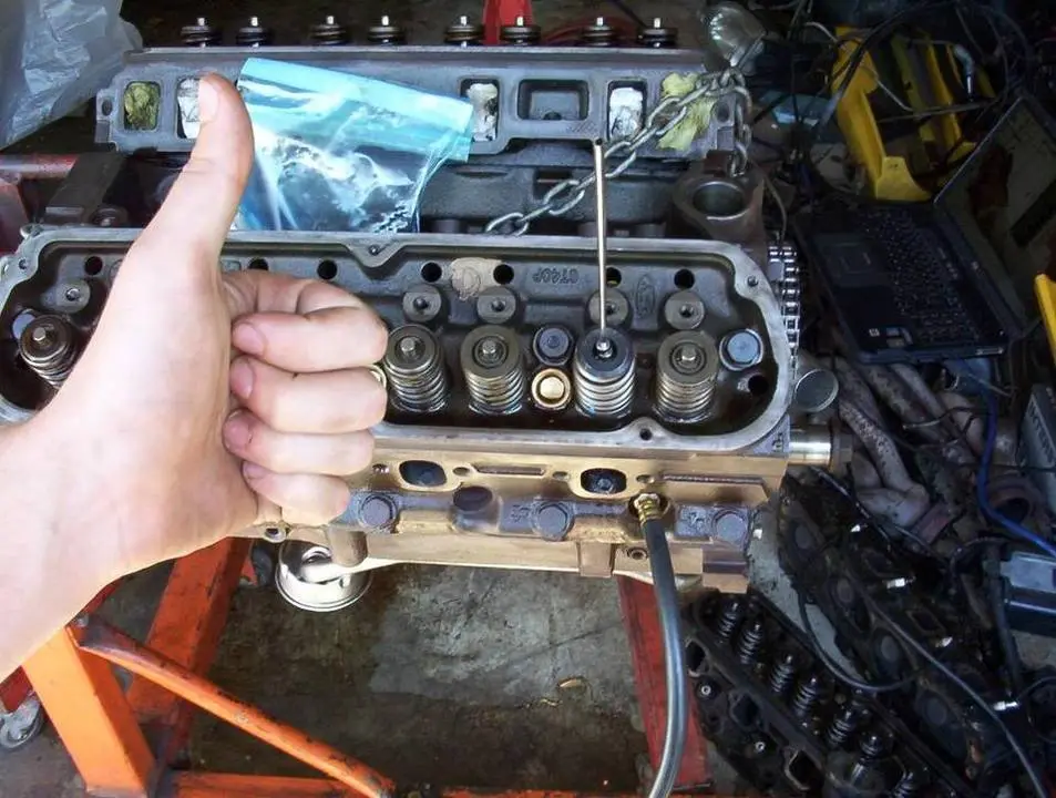

Installing new valve springs for the old heads

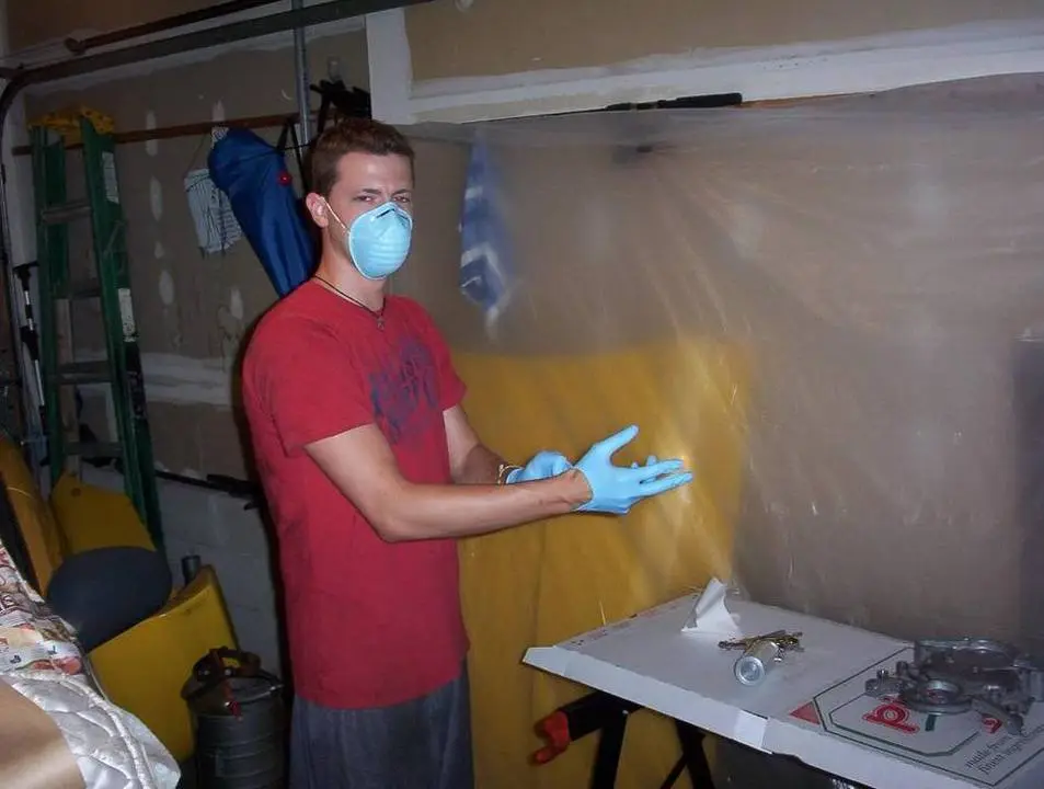

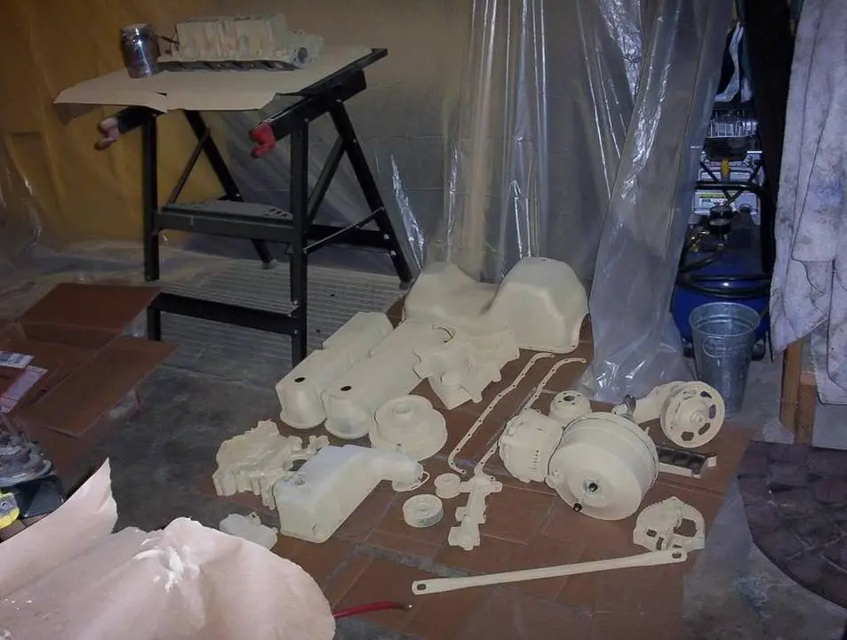

Opening up my own make shift paint shop
Prime time

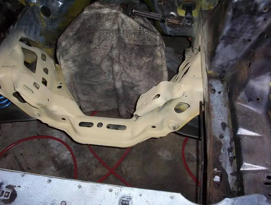

Decided not to pull the k-member, going to pray it in there.

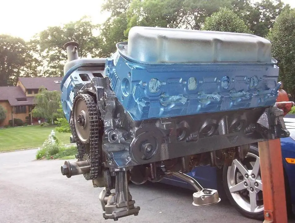

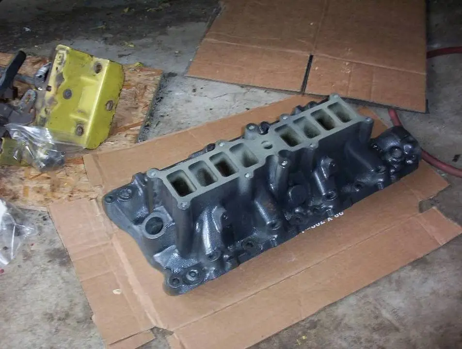

New engine all cleaned up
Engine primed
Just 1 coat... doing at least 2 before clear
1 coat... don't mind that rust its gone... looks a lot better in person
1 coat
DON'T MAKE MY MISTAKE... PAINT THE HEADS FIRST AT LEAST 2 COATS... LET SIT OVER NIGHT. TAPE IT OFF AND SPRAY THE BLOCK 2ND!!!

i'm confused by your valve covers.
how did you get one for the passenger side that had the hole towards the rear of the car.
did you get two drivers side ones?
i was buying those at the swap meet, then i realized the fill tube would hit on the throttlebody with the sn95 elbow.
i have no fill tube, i run 2 breathers piped out the fenders, im going to re-route the 2 lines into a T and run them into the old egr pipe fitting, if my new long tubes have it.

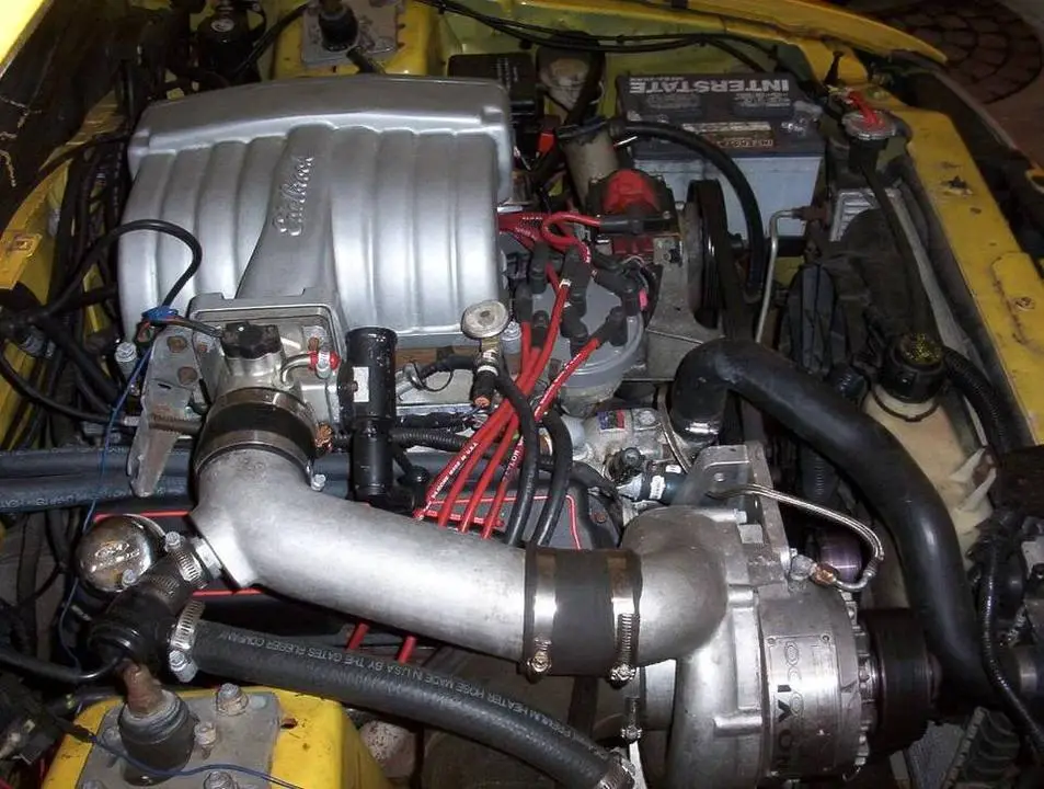

Tomorrow (sat) is 8 weeks since we started. Been about 2 weeks since the last major day, but Ive been working on some small things.
Just spent about $75 in chrome bolts/nuts/washers that will be in highly visible places....C/C plates, Vortech Alt. bracket, TB to Intake bolts, and a few more.

so today i installed the oil pan, timing cover, cleaned the water pump. installed lifters the last of the new valve springs, pushrods, rockers...
i then moved on to priming the water pump, and then spraying the rest of the block, valve covers coat #2 and lower intake... the paint gun was clogged so i have it soaking in paint thinner... i wasted 2 hours... but got a decent amount accomplished. The new valve springs are beefy as hell.
O a side question, 2 of the valves arent seating all the way... they have some serious carbon build up. Any way of cleaning them up, even after the car is up and running or before hand.

yellow,
I have a novi 2k and was windering if you clocked the blower housing to get that pipe to work, and if so, how would I go about that, and where did you get that pipe.
Secondly... How well do those valve covers fit with the novi and such. I've always wanted those covers, but even the cheap ebay chrome ones I have, have problems with the novi hitting them and almost being too tall for the throttle linkage...

95Mustang302 said:
yellow,
All very good questions. I have done them all.
clocking the blower goes too far and it doesn't line up at all. im using a fox body vortec pipe which i cut off the end to fit. honestly go get a custom pipe bent to fit, its on my list of things to do the pipe doesn't fit that nice at all.
Valve covers required a 1 inch intake spacer to clear everything.
You can't take the pass side valve cover off without removing the blower.
So... stick to stock hight valve covers, get a pipe made.

I'm still waiting on the welding to be done. then i have to support underneath and take the plates off. So i am planning on doing it.
