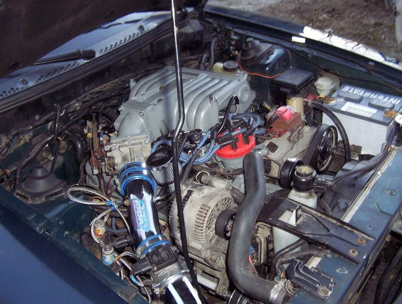

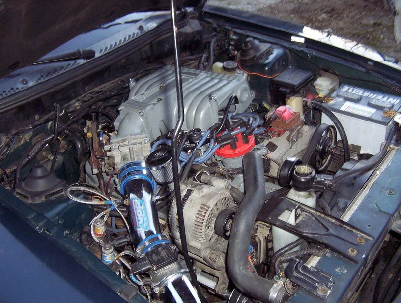

I cleaned up my explorer intake a bit its not so ugly
the front hard line has been removed.
Nice! I see that you smoothed out the side castings before you painted it. Wait until you see mine. I've been working on it forever now. All I can tell you is that it will look NOTHING like that one.
