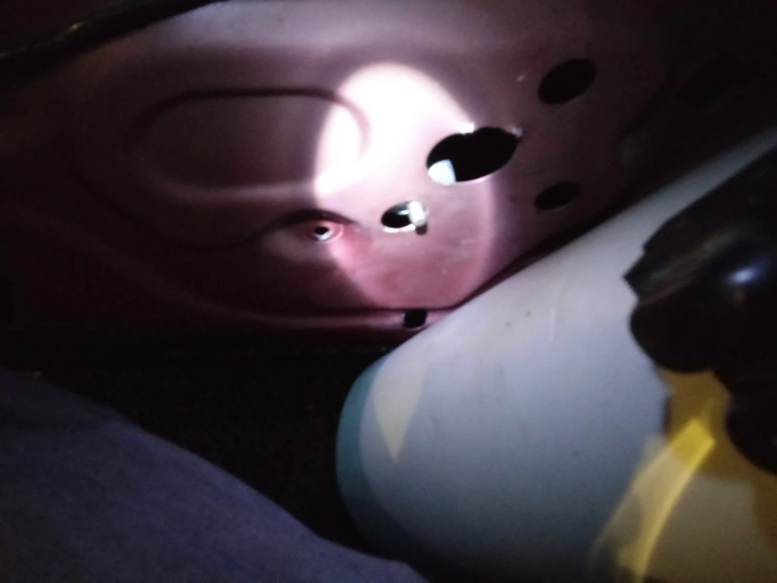

Can you take a picture of the location that the coolant was coming through the firewall? From the information it sounds like the heater core. If that is the case the floor on the passenger side might be wet and the smell of maple syrup present inside the car.

The car had low transmission fluid because I removed the dipstick tube. And the floor inside got watered both driver and passenger. The hole is made of rubber , its on bottom of the heater hoses near the exhaust manifold nearest to the headers. It leaks yellow fluid . And my coolant resivior is the same. I had removed some parts just to change an o2 sensor.

The fluid sounds like a coolant, the pass through on the firewall hole sounds like the heater core. If the two lines right there are leaking where the metal meets the rubber you will be in luck and just need to swap hoses. If they are leaking further up, then it may be the core itself and then your into the dash and a little bit of labor.

The hole looks like one of the holes in the pictur but instead on the firewall. . On the passenger side. And the car would start. It would just turn off after a few seconds. Because I drove it to much without draining the oil. Im gonna get a bypass for the heater hoses. And a oil drain. Would the a/c still work?
