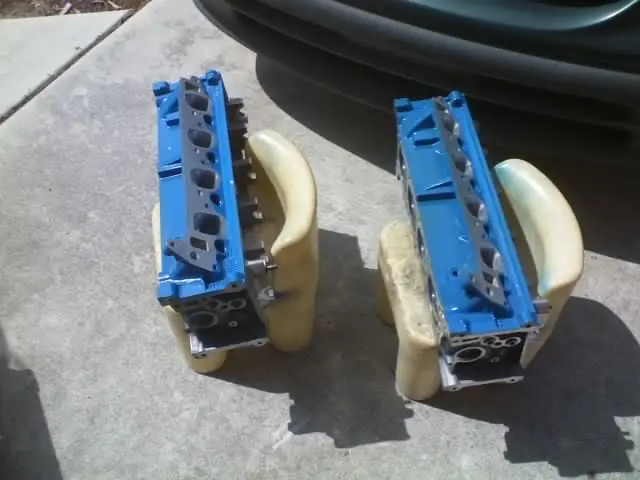

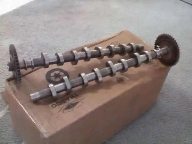

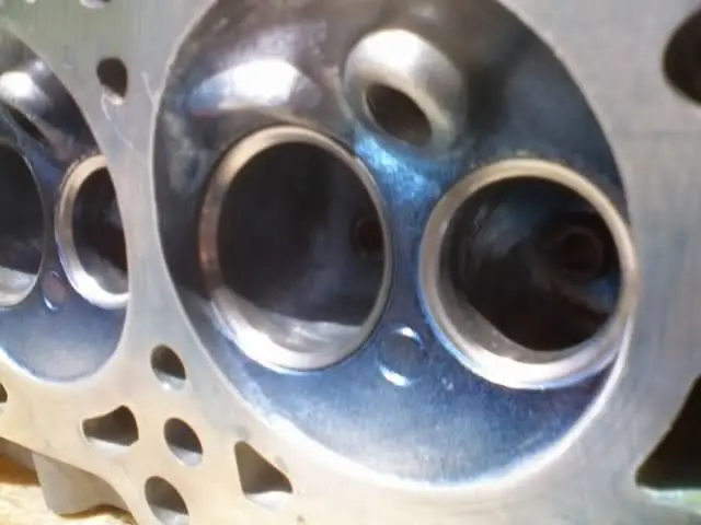

i just got the heads back today, i had a 3 angle valve job done, and had all the guides checked out, i am painting the motor ford blue so i painted the heads, now i have to install all the valves, spings, ect, and all i have to order is the frpp head changing kit, and the lt's
& the powerheads hot street cams
