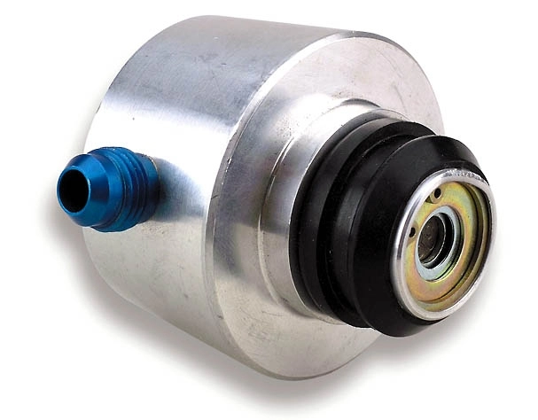

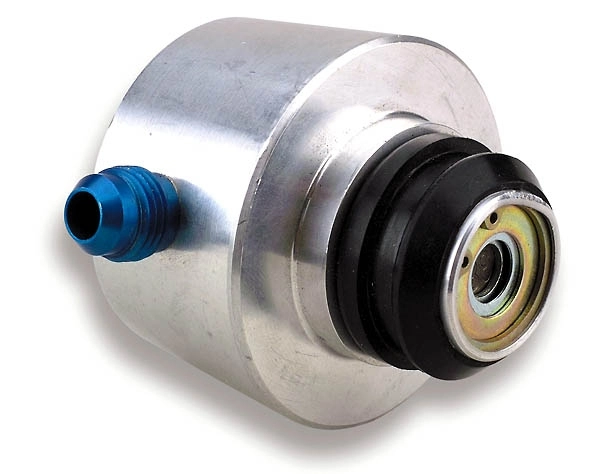

I'd say you should get the right valve covers and run the system as it is designed to be run. Just make sure what ever valve covers you get clear your roller rockers. Although, I wonder if you'd be able to adapt this.
Trick Flow® Billet Oil Fill Kits: TFS-51400800 - trickflow.com
Probably could. I've looked into something like this as well...but can't tell if that is a PCV valve in there or not. The last thing I want is that opening to be a one way opening since my understanding of the crank ventilation is that it relies on that opening to be capable of two way air flow. Obviously something baffled would be nice to slow down oil splash.
