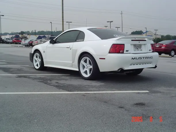

if you go 17's get 315's on the rear/255's on the front.

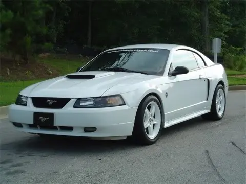

If you go 18's go 295's on the rear/265's on the front.
Both look great and ride nice.
Here are a few example on mine:
17's:
18's:
