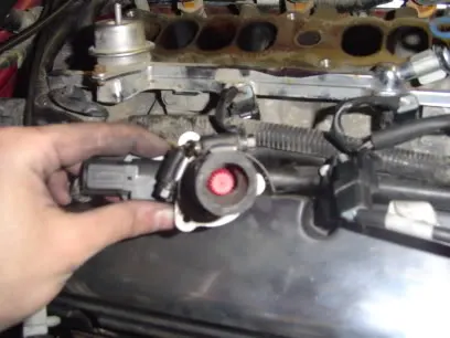

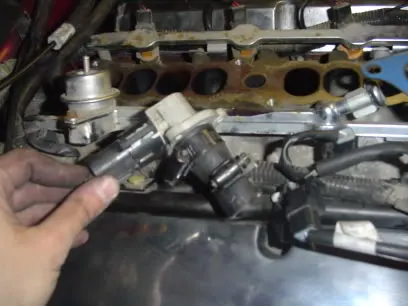

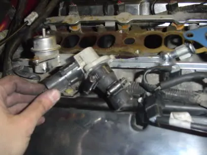

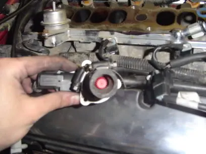

To keep your Check Engine Light from showing you will need to keep your EGR sensor attached to the harness AND push the plunger in half way.
I've heard of some Zip Tieing the plunger, but I tried to find a better way. First find a Toy Vending machine lid. Don't laugh yet, you will be amazed at how well the small ones fit. :D And a hose clamp.
At first I just rigged the sensor with a hose clamp like this:
The above method is adjustable. You can tighten down the hose clamp where you want to make sure you get it half way.
As you can see over the course of 1.5 years the pressure from the plunger and the heat got to the lid. :bang: Time for reinforcements!
In this last pic I added a little Plastic Weld in the top and placed a penny on top of it. Plastic Weld (VERSACHEM CHEMICALS - PLASTIC WELD) is like $4 and is very useful, stinky, but very useful stuff.

As for the sensor side I used a wire nut for home wiring (yellow one I beleive) I pressed it on with a vise and threw a small hose clamp on jsut for reinforcements... I had those lying around...

cool idea with the freeze plug.
i used the homedepot 5/8's cap for a few months then i installed some fox unequal headers. no egr bung.
i did the rio5.0 trick for the egr sensor.
