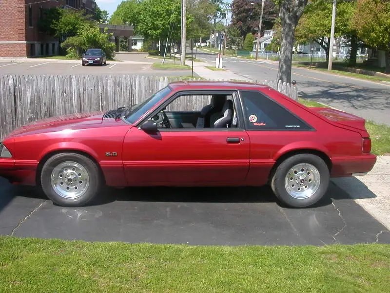

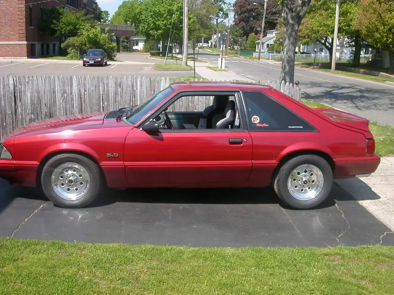

* pics *Got my welds and M/T DRs on!

They hook like crazy! Thet rub the fender only if I hit a big ass bump.

they are 3.5 in the front with 165 tires on them. The rear are 15x8 with 275/50/15 M/T drag radials.Fender is not rolled. I put airbags in the springs to telp traction and to raise the rear a bit. My car is lowerd so I had to use airbags. The quads are gone. MM arms take care of the wheel hop. I think I make over 500 to the wheels. The motor made on the engine dyno 564 hp. I never dynoed it. The tail pipes are red. The jerk who painted the car did that. Its comming off soon trust me.

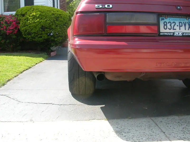

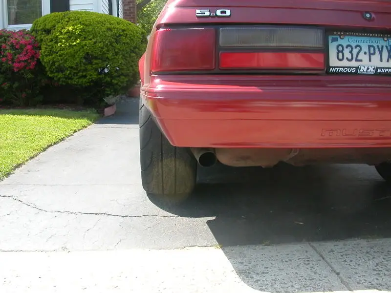

Here is a pic from the rear. The tires dont stick out at all.
