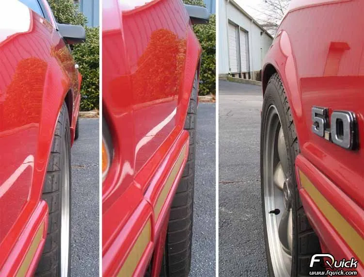

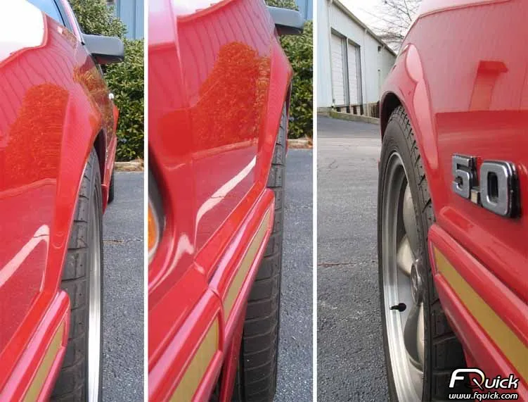

Here's the pics I mentioned I'd take today. ACtually I think the factory 17x8 bullitt wheels are 27mm offset. Adain we're talkin' a couple mils but either way they fit very well. Here's some up close pics that really help illustrate this.
BTW, I test fit a 17x9 Cobra wheel out back today and it fit awesome. The backspacing is 6.125" (6 1/8") and if the backspacing is the same on the 17x9 bullitts I'm going to look at saturday I'll be getting 2 for the rear and mounting up some 275/40/17s on 'em. Then the wheels and tires will fill up the rear to match the look up front.

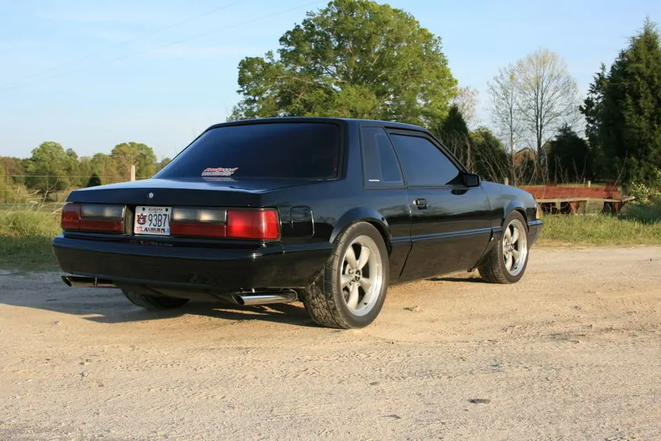

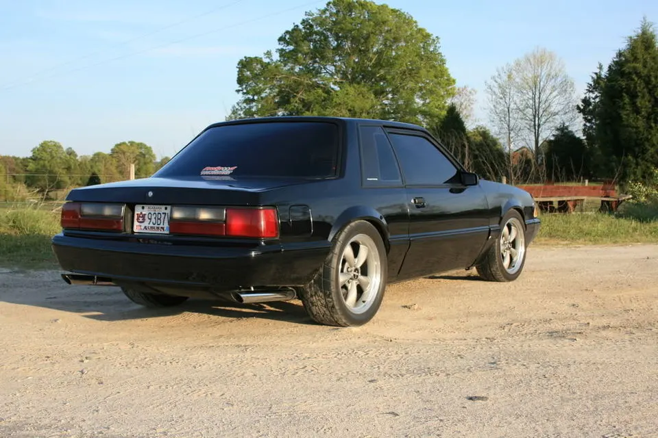

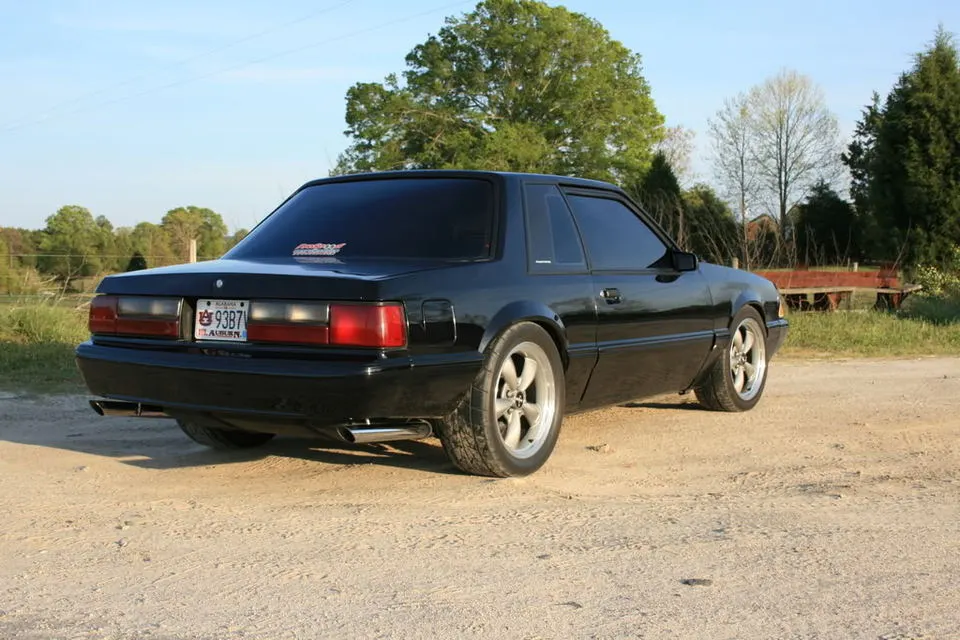

I put this same post of on Corral talk and this guy posted a few pics of his stang,
In this pics he's running 17x9 Cobra R wheels with a 24mm offset on all 4 with 96+ spindles and SN95 lenght axles.
This is a side profile pic of the rear of the same specs as above except Saleen wheels

I posted this because I am doing the 5 lug conversion right now myself, but I also have an eBay business and sell junk yard 5 lug conversions on eBay. I constantly get people telling me "it is impossible to run 96+ spindles and SN axles without rubbing or tires sticking out like mexican ride" and I can never convince them otherwise when I know it's possible to work around. That said, Would you mind if you used the pics of your cars in some of my eBay auctions?

Hey Woodrow - Bad a$$ notch - wheels look awesome on that car! I also liked seeing that pic of the notch in the Nitto ad! Nice!

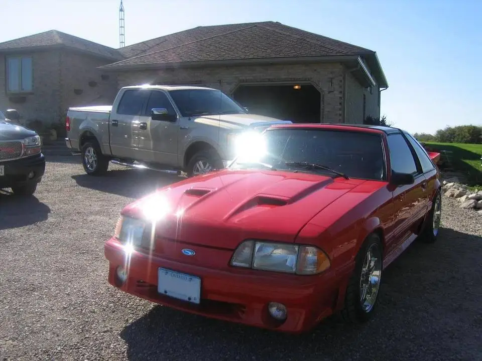

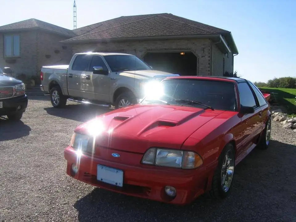

Caseywan, I'd be willing to send you all the high resolution pics you want of my 88 GT using the 96+ spindles, and 17x8 bullitts with the 5.62" B.S. These are the FACTORY OEM Bullitts which I think pretty much share the same exact B.S. and offset as many of the other 17x8 OEM factory wheels from 1994-2004. I just did a picture shoot on the car at many angles this past Friday on my way home from work at a neat location. Will post pics monday. These guys are crazy that don't think those spindles don't work!!! I love 'em! I know guys are trying to put the 9" wide wheels up front on these fox cars but you still can't run more than a 245 width up front without some major modifications and even then i don't know. I think an 8" wide wheel is plenty on a fox with a 245. Just my 2 cents.
