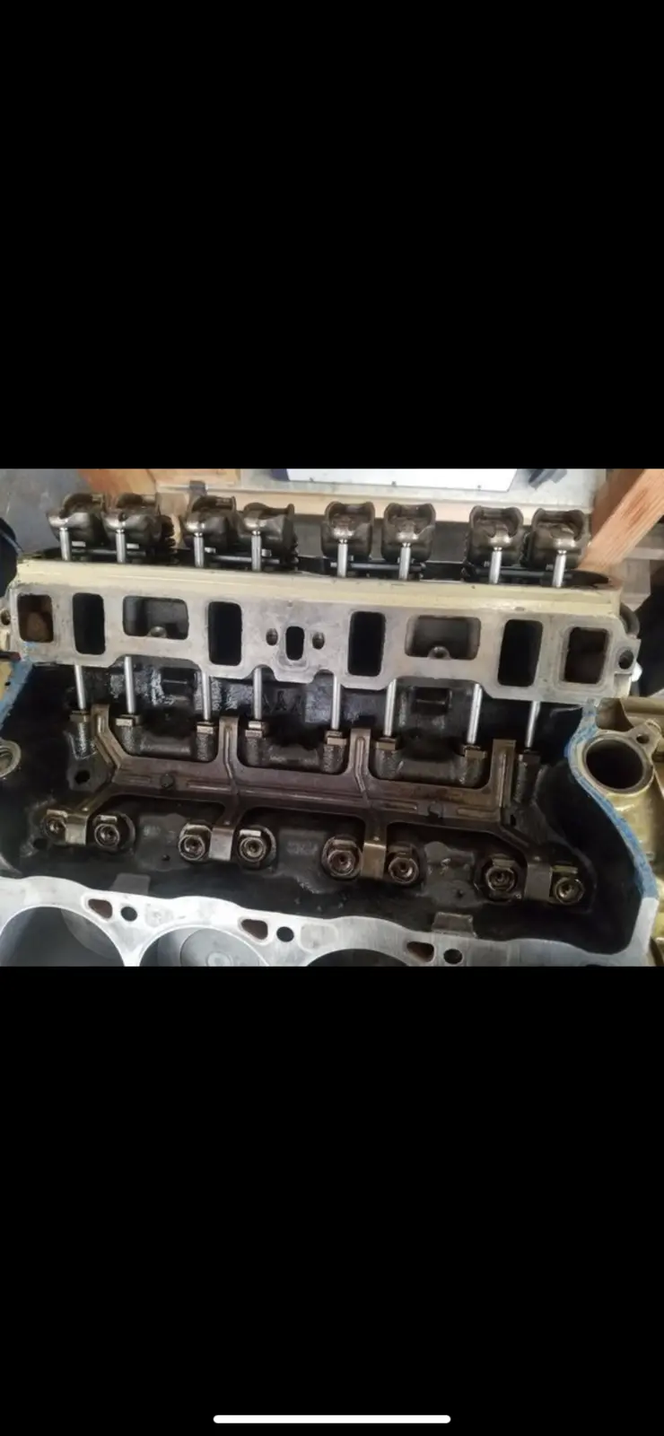

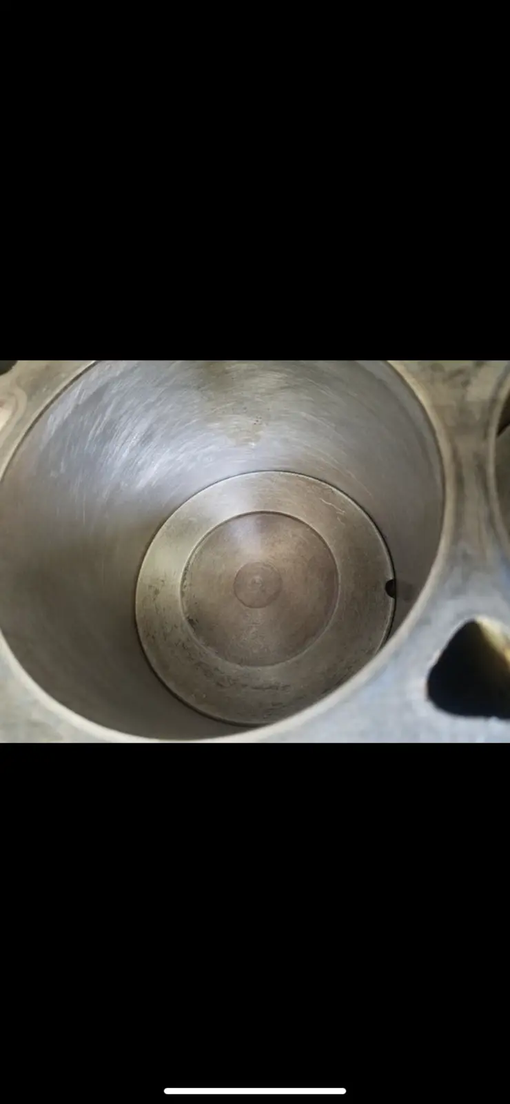

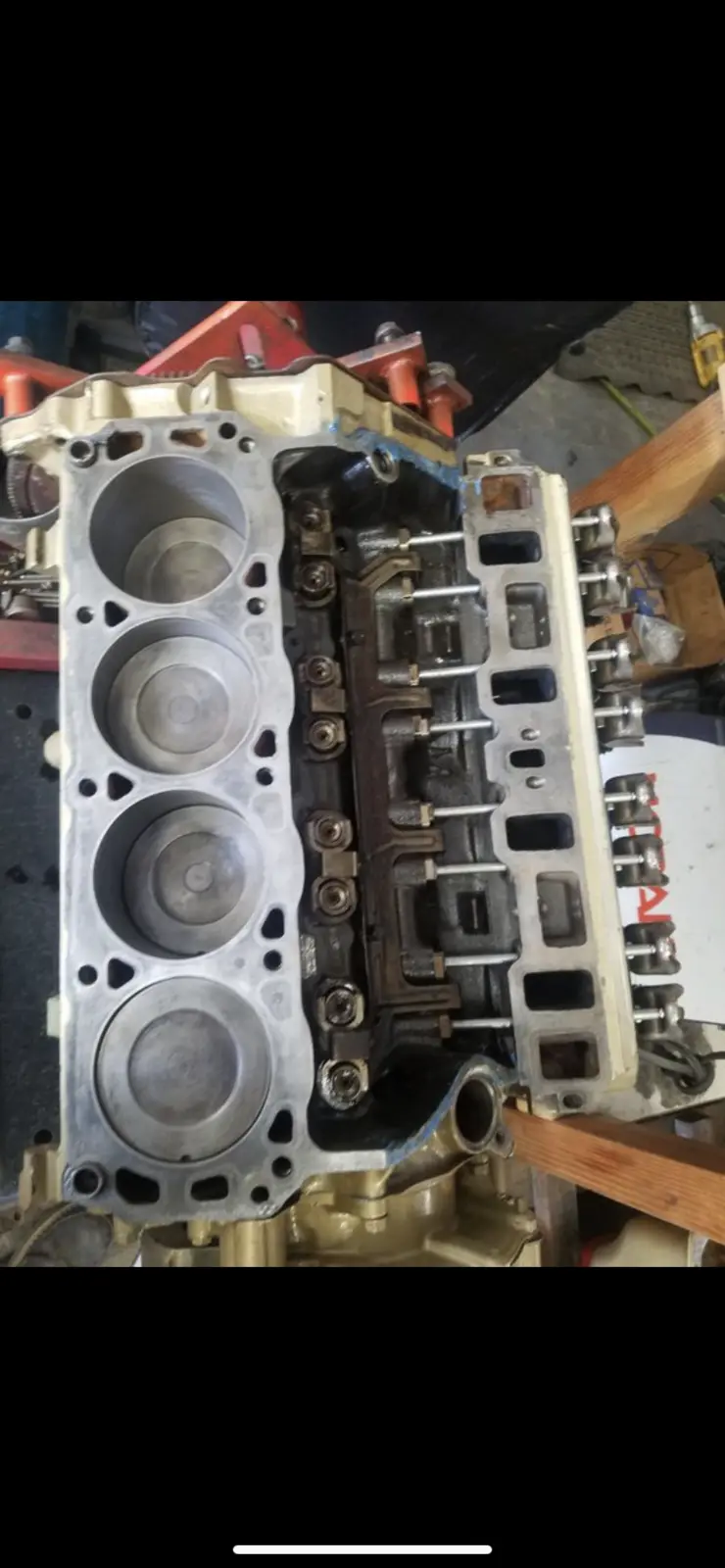

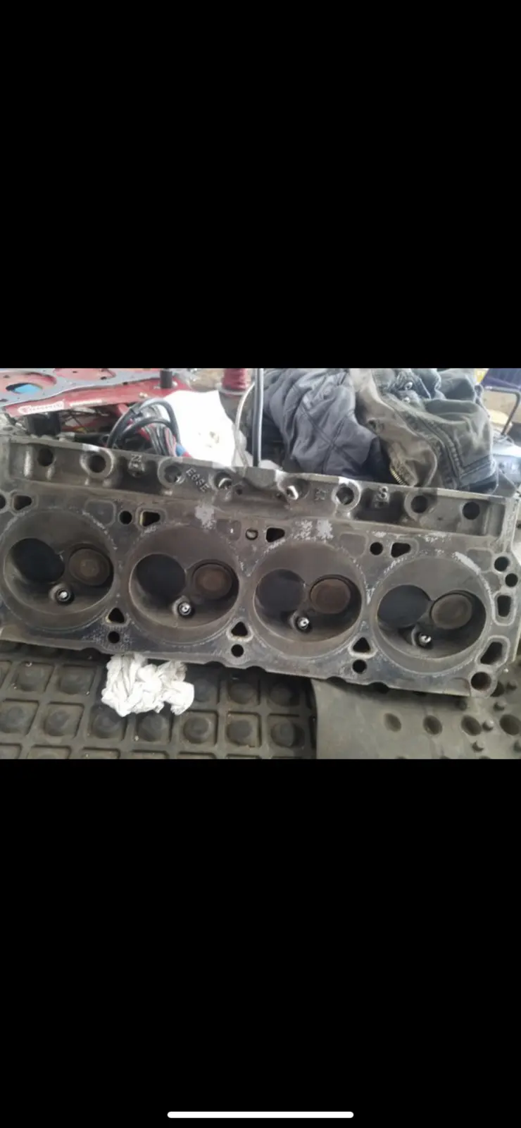

I have a 1983 convertible 5.0 4 speed. I bought the car about 9 months ago. Drove it 50 miles and the engine became off balance and insisted on dying unless under heavy throttle. Did my first engine tear down and saw damage on the outside of piston #4 and several scratch’s inside the block as well as a snapped oil pump shaft that connects to the distributor.
After reading about roller and non roller blocks and builds I came to realization that instead of rebuilding the block I had I was better off trying to locate a roller block to rebuild and reinstall. After browsing around I came across an add on offer up and was interested but I am very confused as to the pistons currently in the block and am looking to you guys to hopefully give me a hand here.

Those are the pistons used in non-HO applications like 5.0 thunderbirds, crown Vic's, cougars, town cars.
Those pistons might have been used in the 1986 5.0 HO in the mustang. Unsure on this
Thank you for the info so far guys! I wasn’t expecting anything this soon! How awesome.
So both the pistons and heads in this motor are both undesirable? He wants 600 for the whole package. If I’m thinking this through correctly. I’m probably better off just finding a bare or close to bare roller block and building it myself? I keep seeing just the blocks from 100-250 in my area.
$600 is too much for the flat pistons and e6 heads.
I second explorer motor. Try to find an early one with the gt40 heads. A cam swap, better valve springs, and crane Cobra 1.72rrs and you basically have a 1993 cobra engine.

You really only want the explorer long block here, and try and target an early model with the GT4- heads.
Best way to ID them is to look at the front of the heads mounted on the engine. GT40 heads will feature 3 bars, vs the 4 bars on the GT40P head.
The only issue with GT40P heads is the spark plug angles. You'll need headers designed for them like the MAC gt40P headers or the now-discontinued ford racing gt40P header. If you have a set of those, then just grab whatever explorer long block you desire as the gt40P's have a slight compression bump over the 40's.

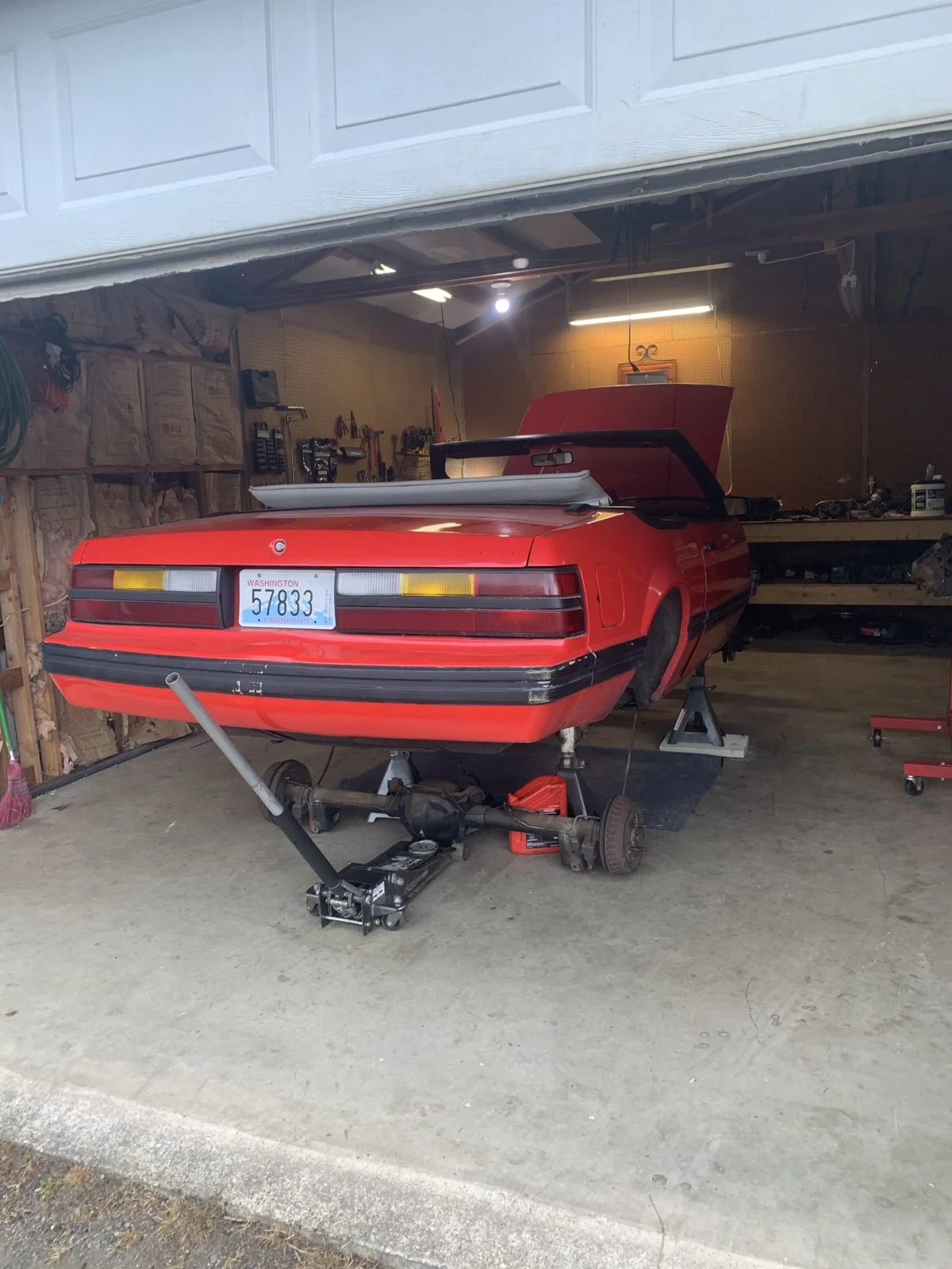

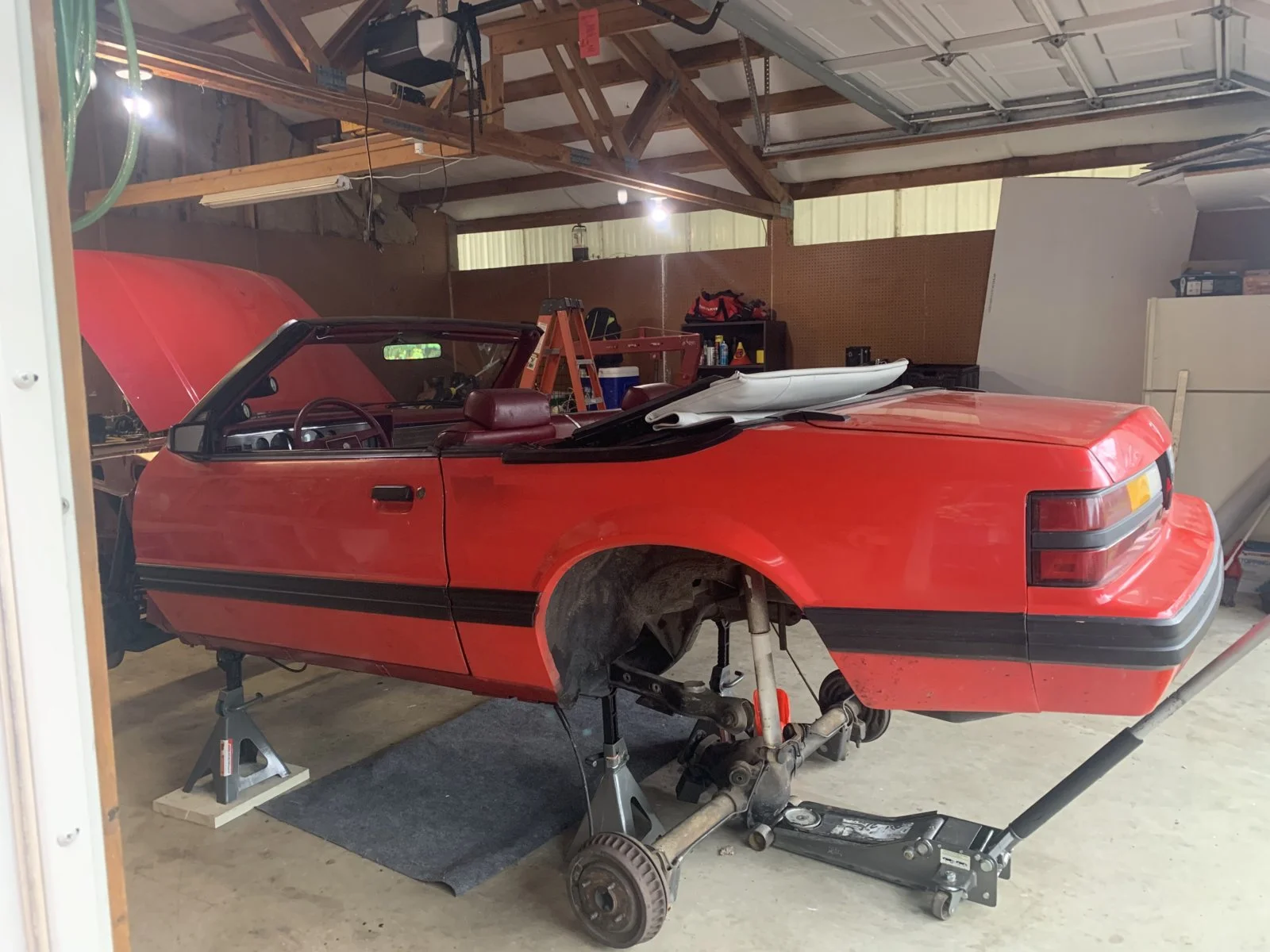

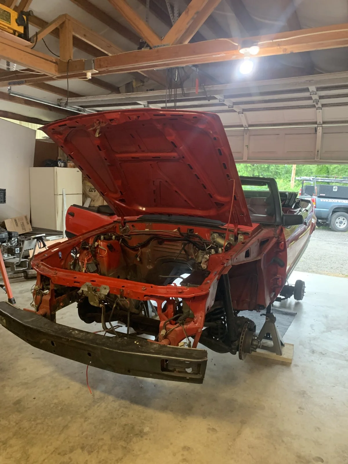

Well I went check the explorer out. As expected 5.0 HO. But the engine bay is so clustered and it was pissing rain so I didn’t get any pictures. I did however get the VIN. Not sure if that’s going to help but figured I’d run it and see how those decoder sites work. I will be towing the explorer home Saturday. When I can find some time between work and the woman I will pull the engine out and sell the explorer to pick n pull. I’ve attached some pictures of my car as well to this post.
And I guess my ultimate plan for this build is to just have it be a summer car that never does over 80 but has low end torque to light them up with “more ease”.
