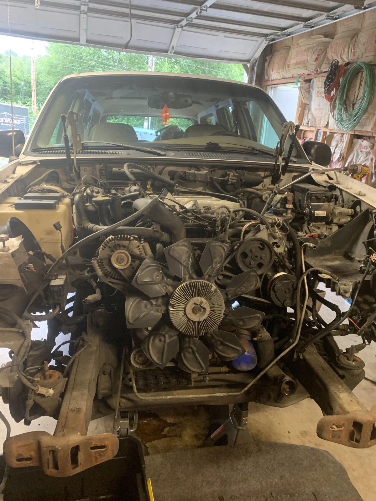

Had some time to dig into the explorer yesterday.
Took a reciprocating saw to the core support to speed things up. Hacked out all the wiring harnesses. Got the drive shafts out. 3 of 4 of the engine mount nuts. The last one is a pain due to the header, but should be able to get it today. Then work the transfer case off the trans and get a picker on the block. As for that process I’ve only pulled engines using the intake manifold plates and then hooking to that... it appears I’ll have to cradle the block to get it out as a whole with the trans. Is there any info I should be needing for this?
