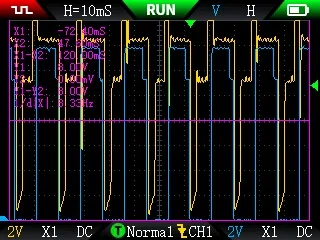

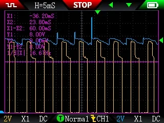

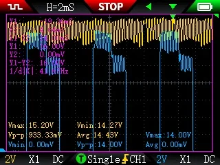

Here's some shot while idling. Yellow is 12V RAW and blue is PIP (Idle_09). We clearly see it's not always a perfect square wave?

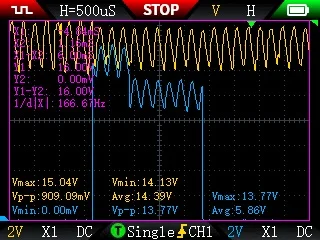

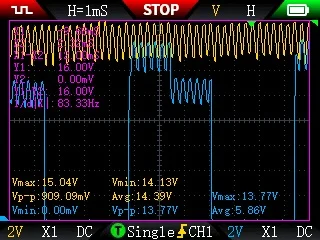

And I've capture some shot while creating a load (to get the misfire) and we clearly see noise on the line (3kRPM+blower_01 to 3kRPM+blower_03). Now, what is the right one to find it?

The last picture at idle is a good pip. That's the sample rate i would use.
PIP should never look like it soes in the other pictures. On the yellow, is that more than .5 volt oscillation?

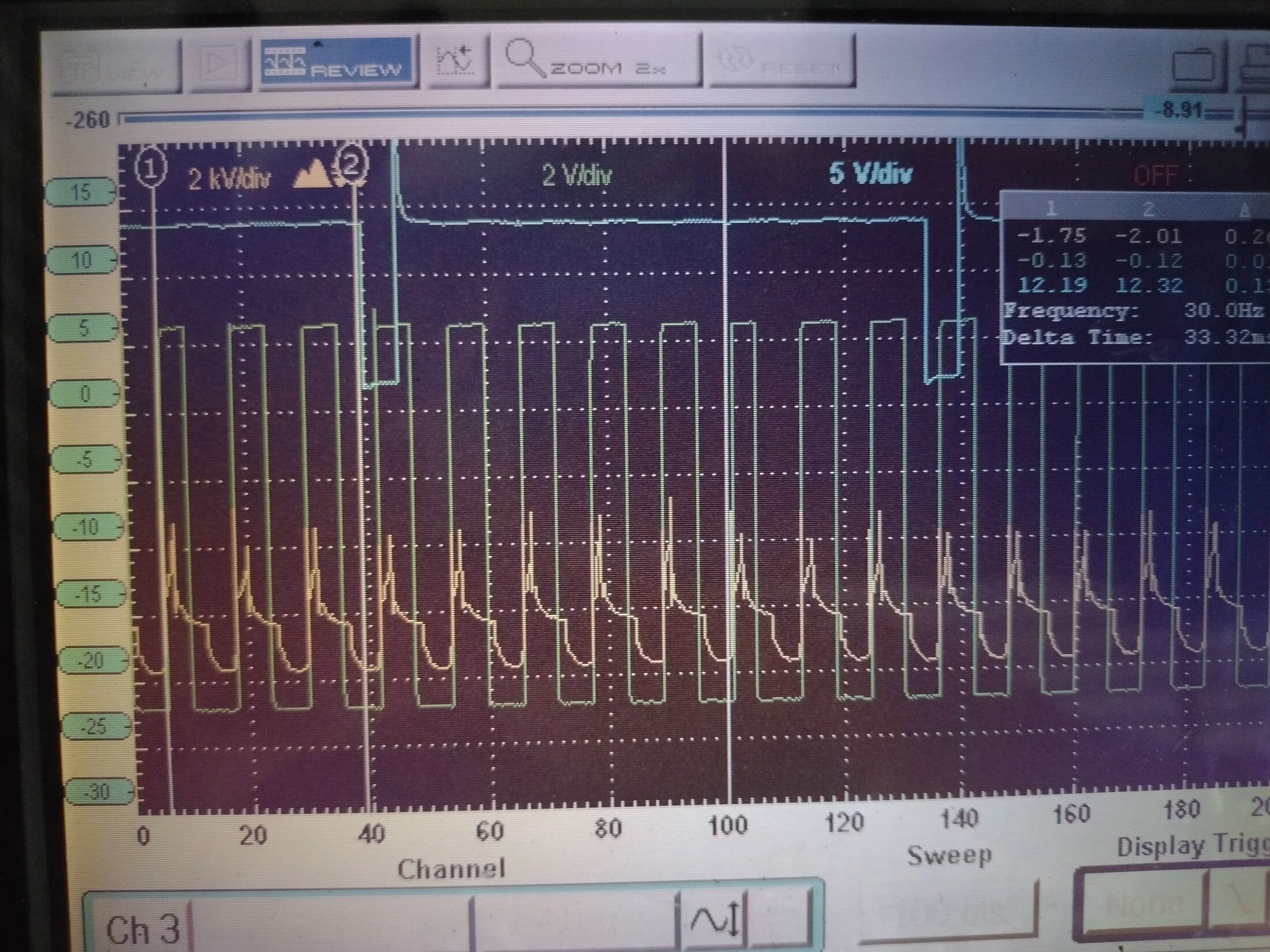

This is an example of a pip dropping out and causing multiple misfires and stalling.
This was a bad tfi module.
The yellow trace is coil control.
If you probe the coil control you'll see if you're losing it. A problem with the pickup or module will always result with an issue with coil control.

As for volt oscillation, grid is 0 to 16V (2v/div) so almost 2V oscillation and pretty sure if I had took that shot at a faster rate, that would be higher...
Yes with alternator and spout in. Misfire is capture on all 3 others pictures.

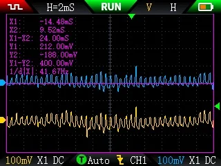

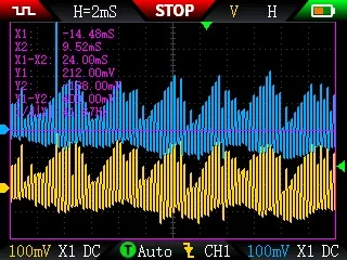

I've put scope on Ignition ground (Yellow) and Case ground (Blue) from the harness and seems OK to me, (First picture)

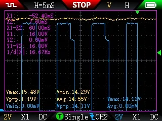

When I rev to 3K and turn on load like blower fan, pretty noisy. (Second picture). As @CassieL asked me, I've probe several things but everything seems to me irrelevant.
PIP (yellow) vs Secondary coil (Blue) (Third picture).
I've put a third alternator brand new 3G and I still can reproduce behavior while creating a load at 2k or higher so now, I think we should remove it from the equation.
I've unhook green wire from Alternator just to get better capture, PIP (yellow) vs TFI power (Blue) (Forth picture). Wondering what means blue spike like this?
