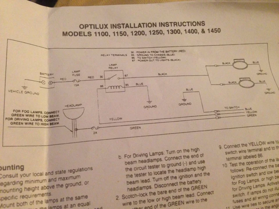

Ogbrandoncorona New Member Sep 4, 2014 1 0 1 Sep 4, 2014 #1 Sep 4, 2014 #1 Hey guys. This may, actually is noobish as heck but I'm trying to figure out if I wire these hella optilux 1100 fog lamps to the low beams will they only light up when the low beams are on even tho there is a aux switch? The wire diagram is attached Attachments image.webp 78.3 KB · Views: 193
