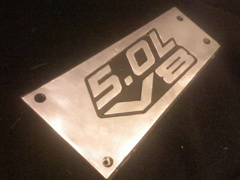

Sorry for the phone quality, I guess it could be worst, but I have been working on cleaning up my newly acquired parts, all to match the polished TB I was given lol. I polished the explorer upper intake plaque, and I am going to paint the upper intake manifold a semi gloss black, similar to the trickflow R upper color. I think it will provide for nice contrast with a few polished peices!

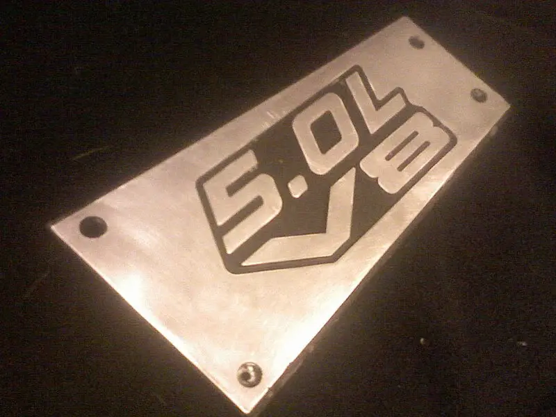

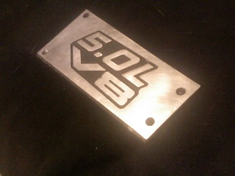

Ok so I started with an old POS explorer plaque, I hit it with 150 grit first to get down and dirty and remove all of the ugly horizontal scratches they come factory with, then hit it with some 400 to clean it up a bit, then a wetsand 600. Tomorrow I will polish it with some white rouge on a ventilated flapping disk for the extra shine, but it is looking purty I must say.
