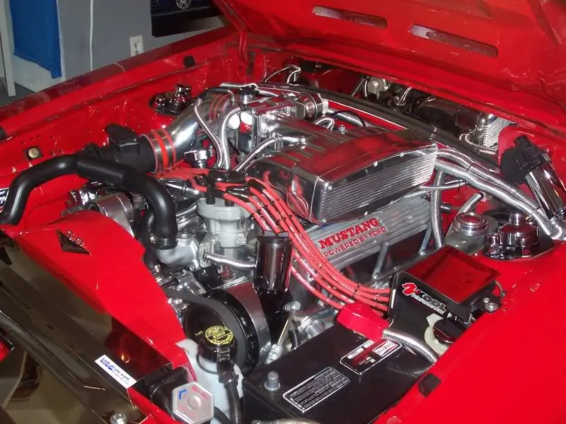

Actually it's a very popular intake for the mustang as an alt to the RPM from Eddy..I ran the Eddy intake and now the Typhoon. Initially there were quality issues but as of late the finished products have been pretty decent. Mine went on the car without any issues and the ports were really quite good..I decided to go without any portinf or grinding to the ports and had AS GOOD results as to what I had with my original Edelbrock intake. Remember the intake is not ideal for a stock headed N/A car...though I did run it in stock form some yrs ago you sacrafice some bottom end power for mid upper RPM gain. The polish finish is decent and as I can state is really quite durable and lasting..I have had zero issues with dulling or oxidization.
...as for a pic...sure I can provide a picture :)...I know you didn't ask but I had my photobucket account open :rlaugh: :SNSign: :SNSign: the picture below is 4 yrs after purchasing (this last fall) the intake and really is the only polished item under the hood that I don't really have to work to maintain the finish...again decent quality casting IMO
basically yeah...the typhoon is more a higher rpm intake better suited to a engine sporting an aftermarket cam and better flowing head...you tend to sacrafice bottom and SOME mid for better HP and TQ often found in the upper range. As I said..I ran the intake in stock form and found the car was still a great street car but I also ran 3.73 so the RPM tended to climb faster keeping me in the rpms better.
