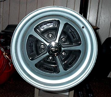

Yes, I still plan on keeping the 6, especially with gas prices as they are! You should see those old rims all cleaned up and ready for rubber, just got my new center caps (M-500 type...black background w/ running Pony) and chrome lug nuts the day.....I'll post a photo later, still have to download it.

one of my "new" rims......:
attachment.php

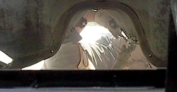

and my helper sandblasting, (19 y/o from the FD...very eager to learn, also owns '06 Mustang GT 'vert) Probie Joe, now aka "Sandy".............: :rlaugh:
attachment.php
