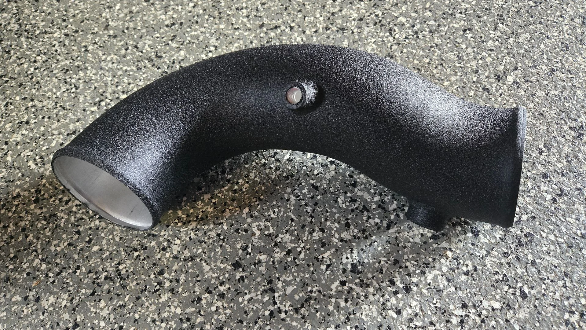

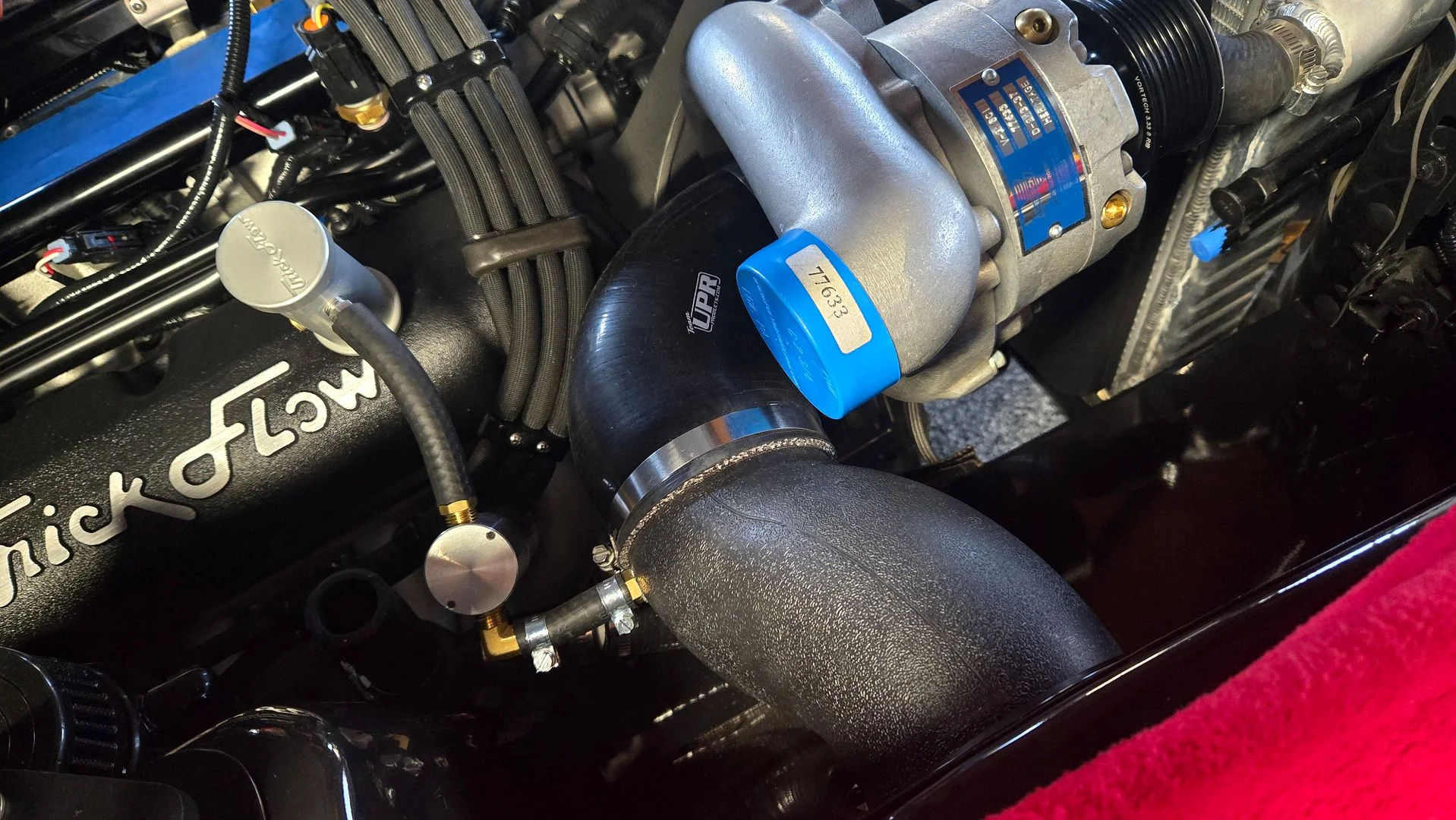

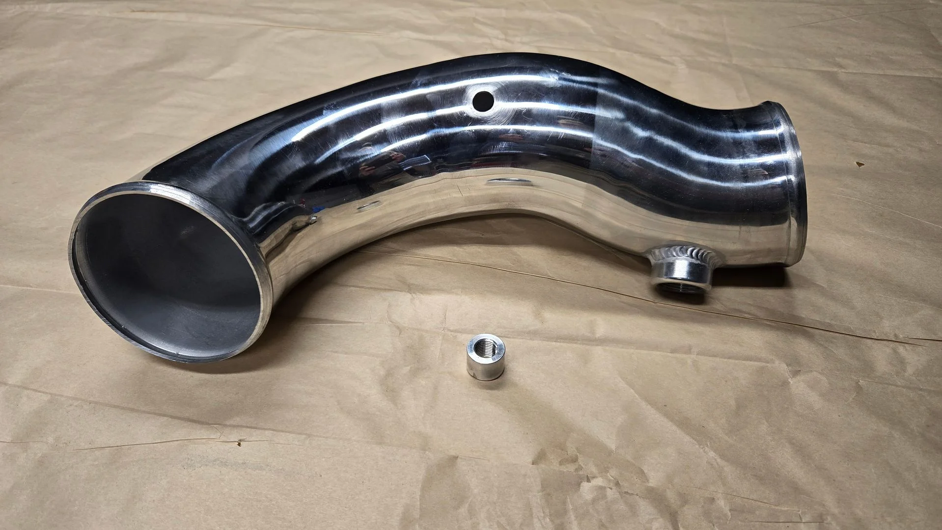

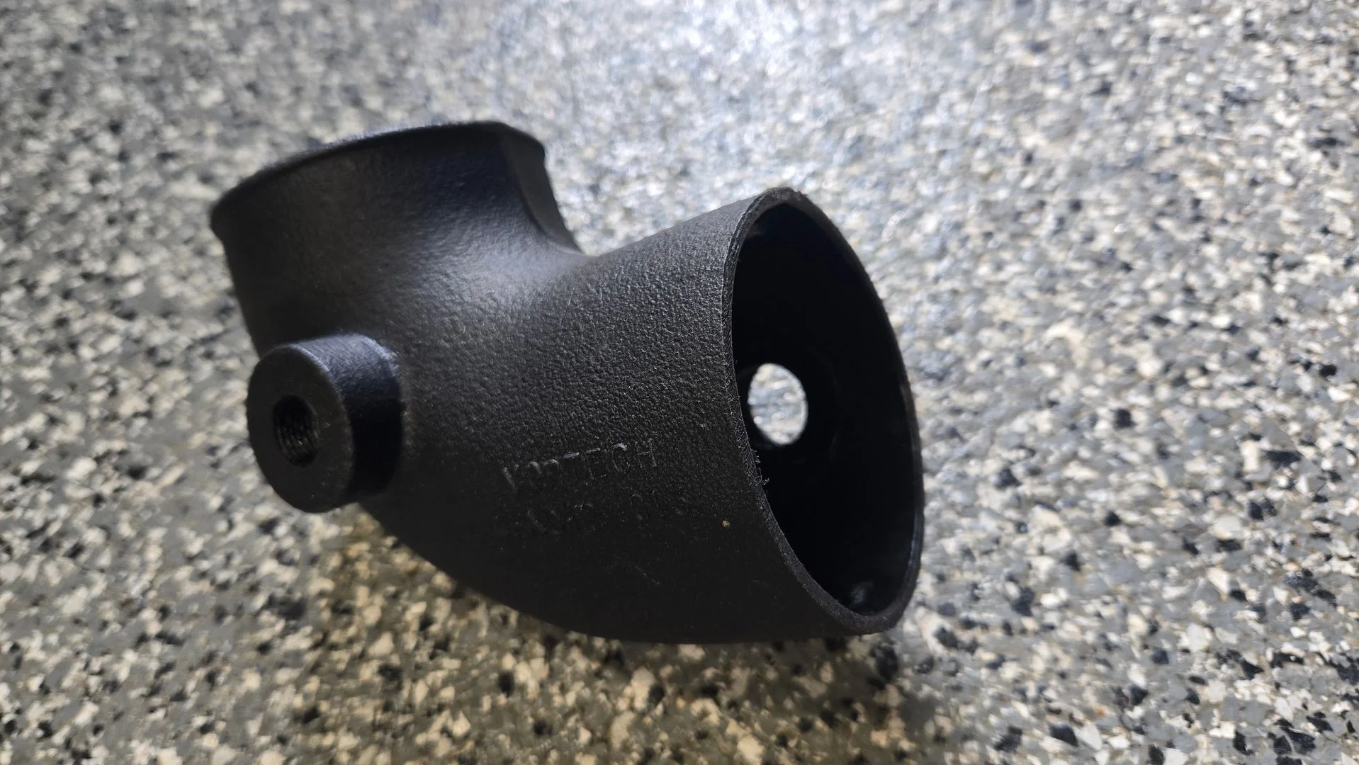

I've had mine three ways now.
First was with the entry kit. The elbow that it ships with actually has a bung you can use. I have no idea why it's not utilized. It just needs to be drilled out and a nipple threaded in.
I dont have picture of that. But I do have the elbow from the upgraded discharge pipe with bypass. The large bung on the bottom is for the bypass. The smaller one on top is threaded but sealed off. All you gotta do is drill ot out and put in a threaded hose barb there for your PCV inlet. The entry level kit was almost exactly the same except it didn't have the bypass bung.
Then the UPR. Its plastic and not great to thread into. I epoxyied several layers of thin plastic. Like a plywood construction of plastic/epoxy/plastic/epoxy and let dry to build up the thickness. Then I drilled it out and tapped it with a NPT tap.
The little silver canister is an oil seperator.
While I feel it would hold up, I really didn't like the "makeshift" bung. So i went with the Anderson Powerpipe I posted earlier and welded a bung in for the PCV let.
Then powdercoated it.
