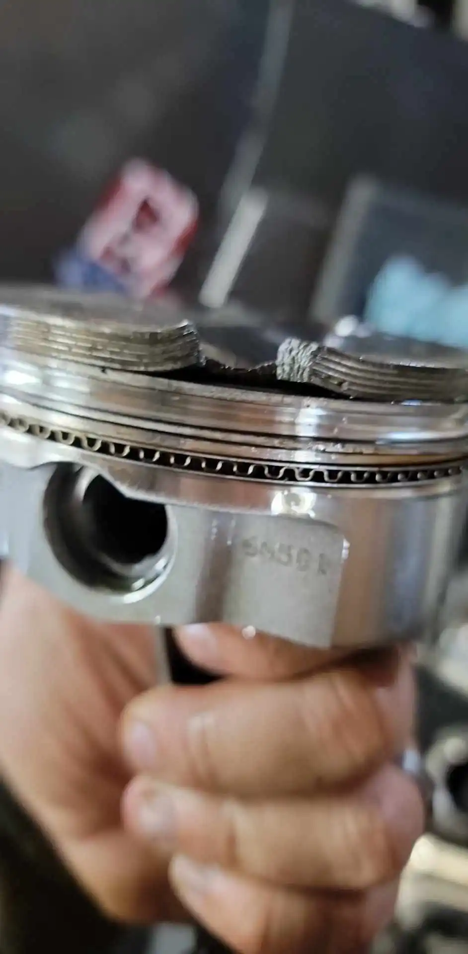

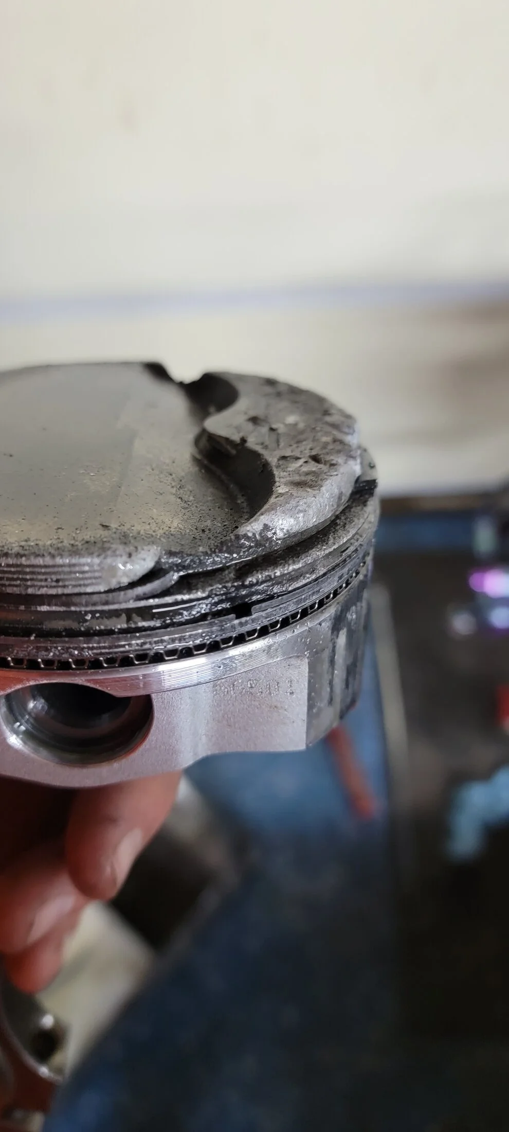

Gotta run down to talk to Roche here soon about pistons. Is the design of my current piston just not as robust as we need or did something else happen?
  • Wow
Reactions: Noobz347
Damn, rough go. Something was off. Looks like decent top ring land thickness. What brand piston, comp. height? Could the top ring be put further down? Still looks like bad hit though...
