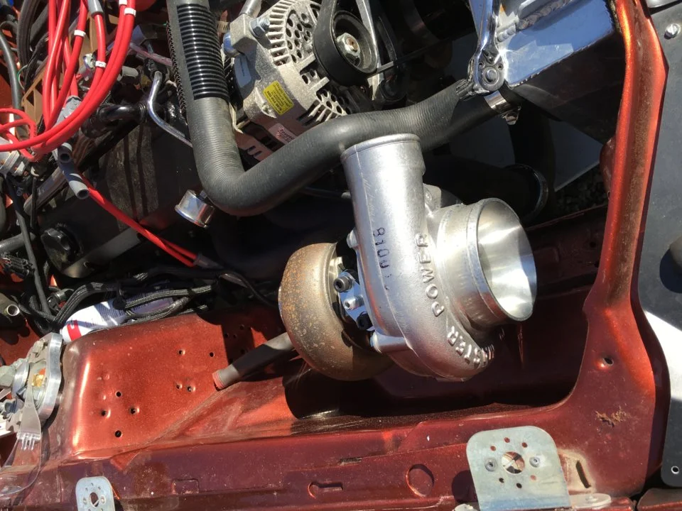

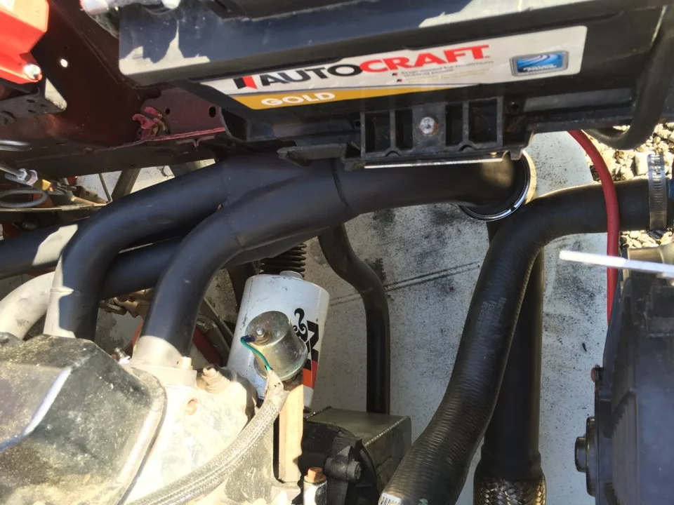

So my headers came in finally the other day and I was able to get most of the hot side installed in the car yesterday. This thing is starting to come together nicely.

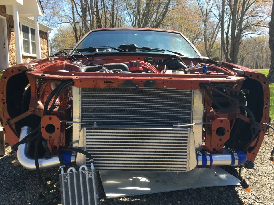

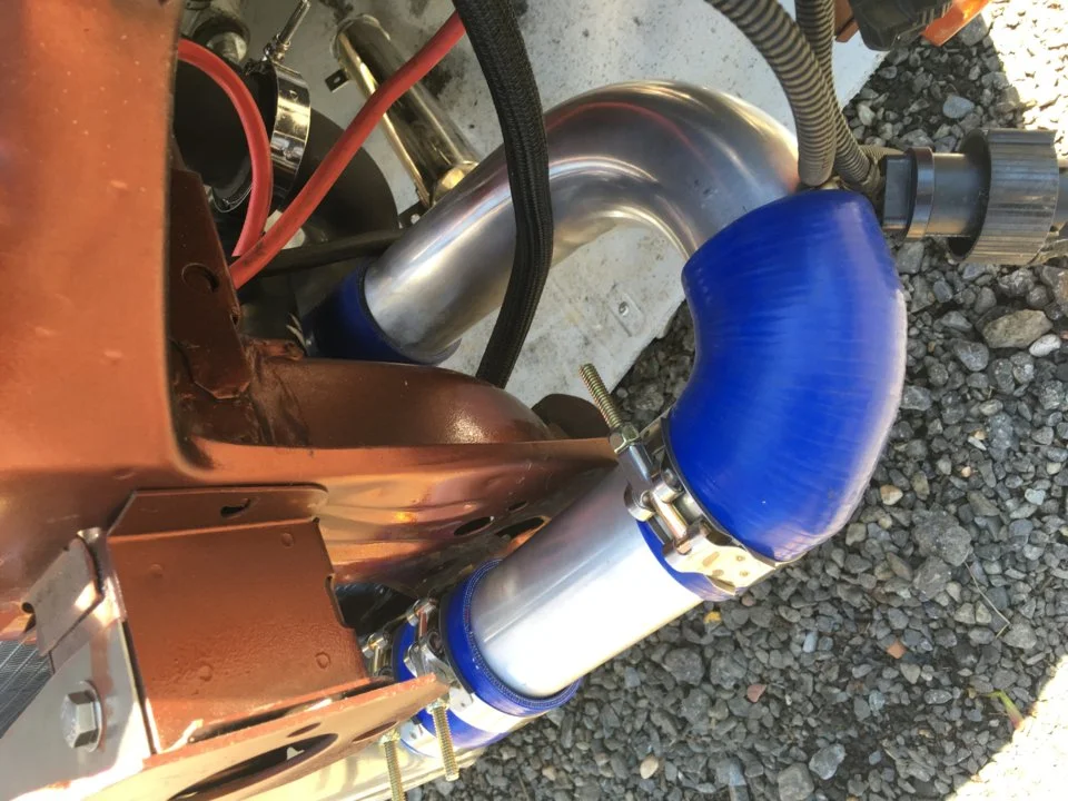

Got the inter cooler mounted and some of the piping ran from the turbo to the inter cooler. What are yalls thoughts so far?

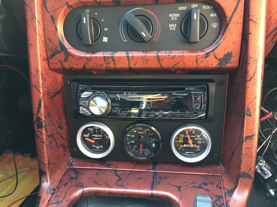

Finished today with putting the new gauges in the car I think they look great

My OCD is kicking in with the middle gauge not being silver also. I would have to tape it off and paint it. Otherwise, looks like its coming along nicely man.

Hahahha it's all good it's better then it being on one side or another ya know?

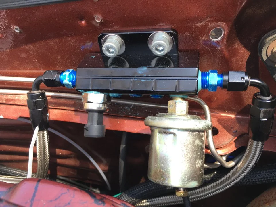

Got all the oil feed and manifold ran today ... Used a Upr vacuum manifold for the sensors and feed line.
It's got thread sealant on it that I still have to clean up but it's done at least now onto the drain

So my brain is not functioning right now. I'm trying to figure out how I wanna finish off the hole for the intake piping going through the fender. Firewall grommet? Exhaust trim ring? Help me out here guys can't find any clear pics of the passageway. @84Ttop @TOOLOW91 @srtthis @RacEoHolic330 any of yous guys know some slick tricks?

If you're referring to the hole in the apron where the pipe goes into the fender well - I have vaccum hose that I split down the middle and put around the edges to finish it off and keep the pipe from getting marred up by it and finish off the edge .

Split vacuum line here too. Gets the job done for me.

trim ring... ive designed a few
let me know your pipe size and what you want it to look like i can do one for you also

It's 2.5" and nothing fancy maybe like an octagon or something
