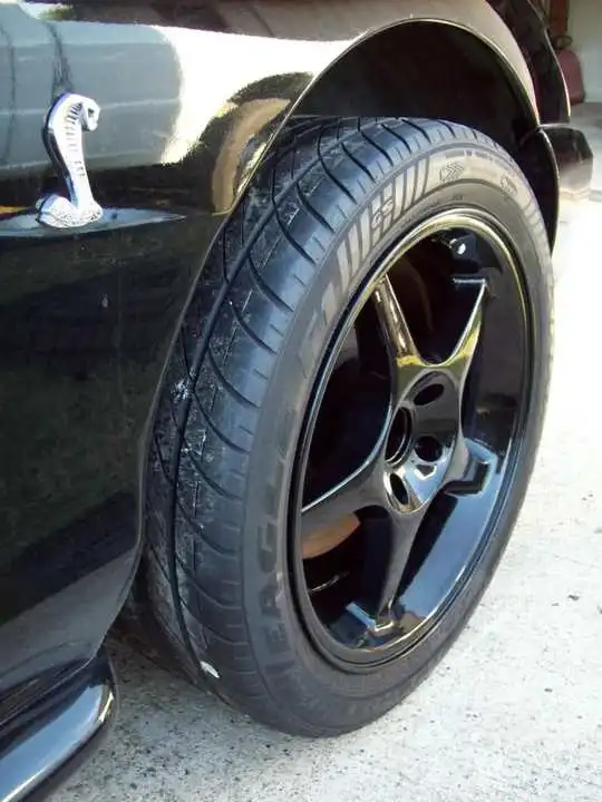

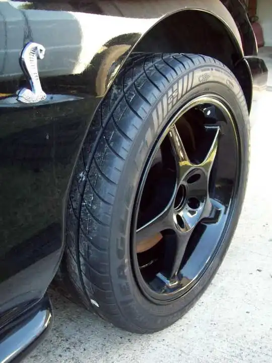

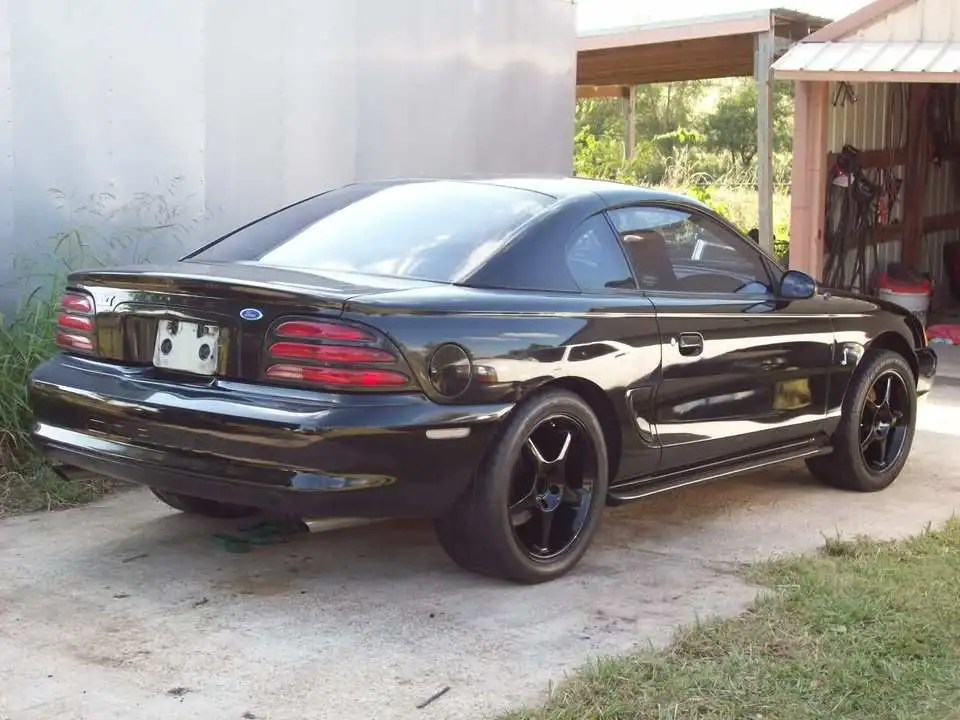

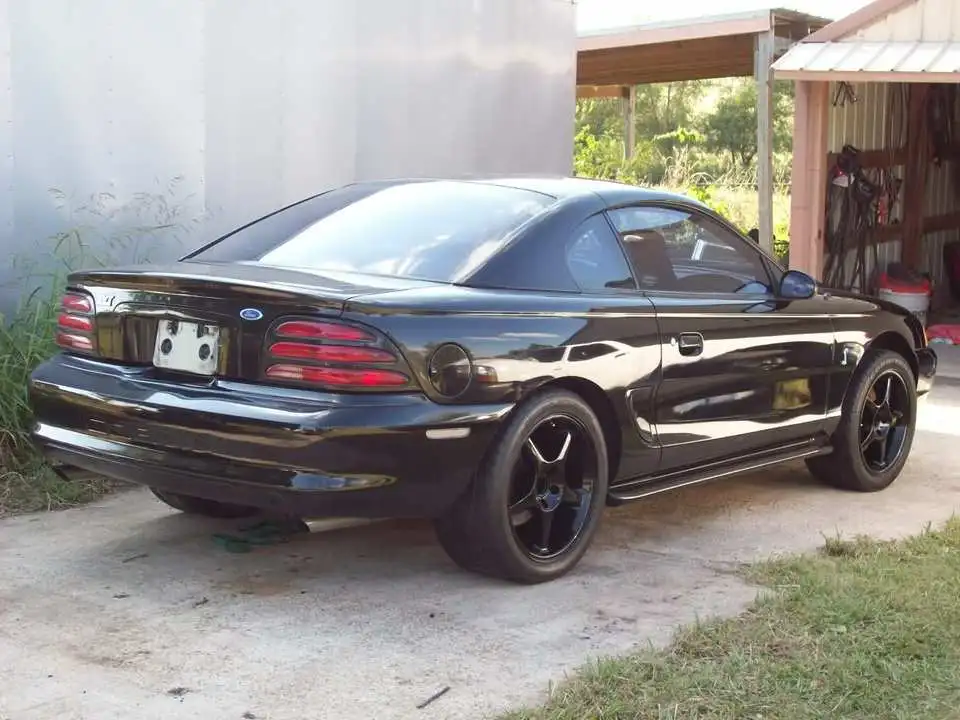

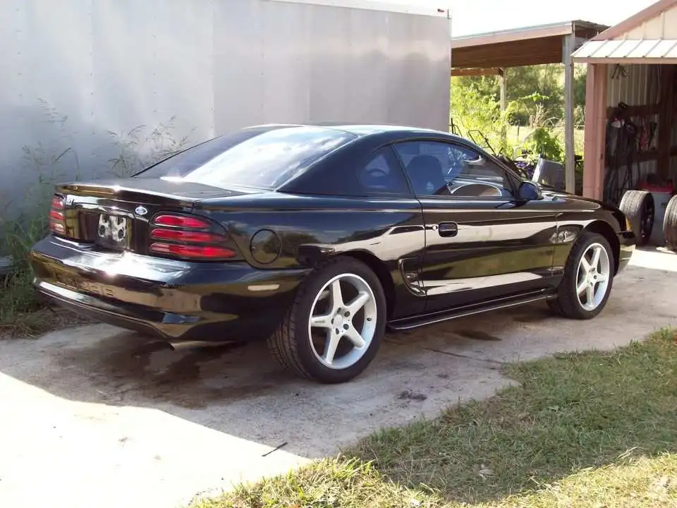

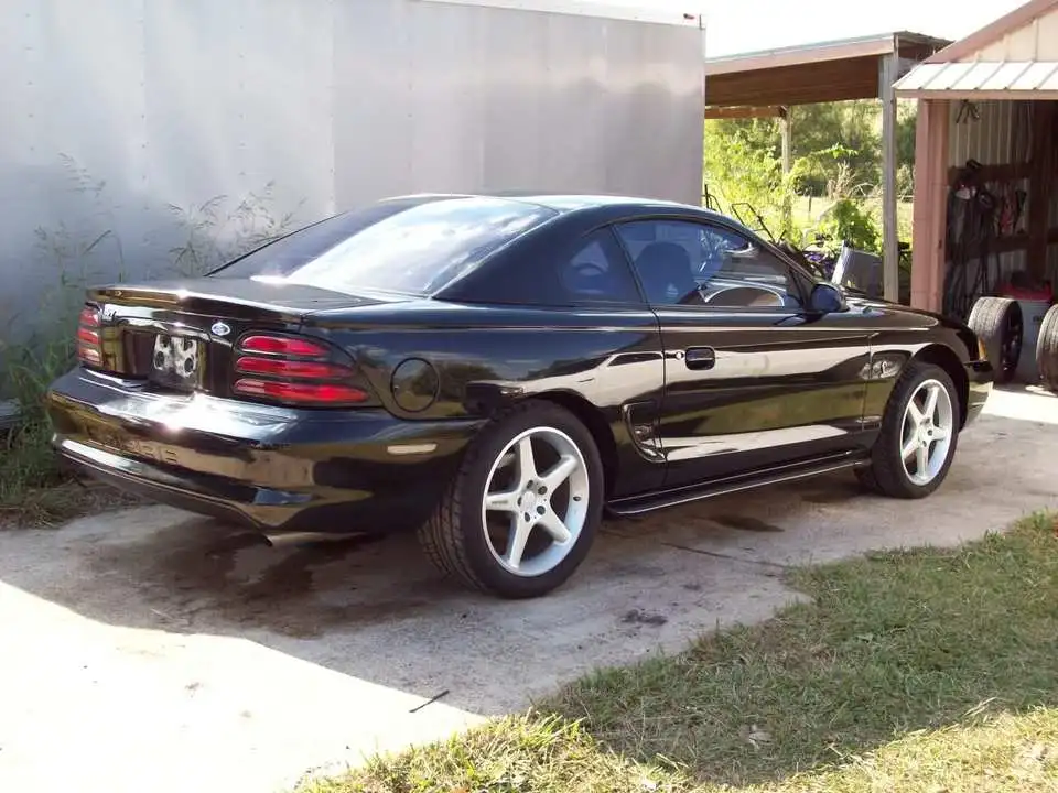

Time for a rim change.....
Before
After
Gotta track down some center caps now, and the brakes look horrible need paint pretty bad will have to wait till later.
I'm diggin the new rims, had planned to use them with a red car but still look cool on black to me.

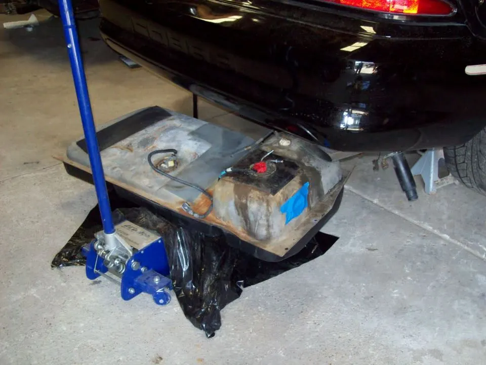

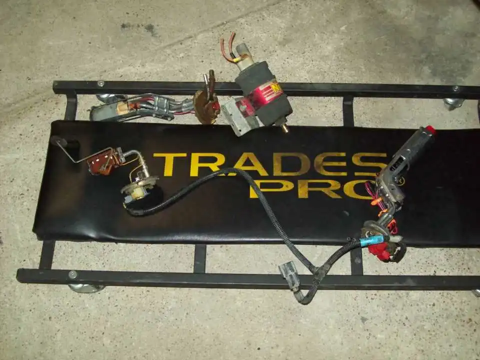

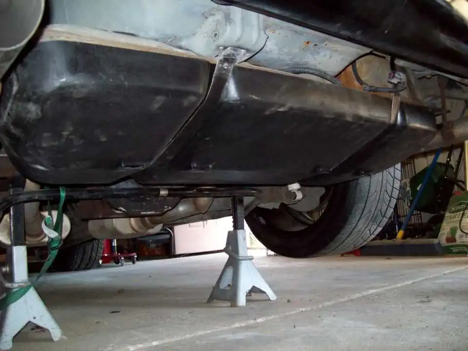

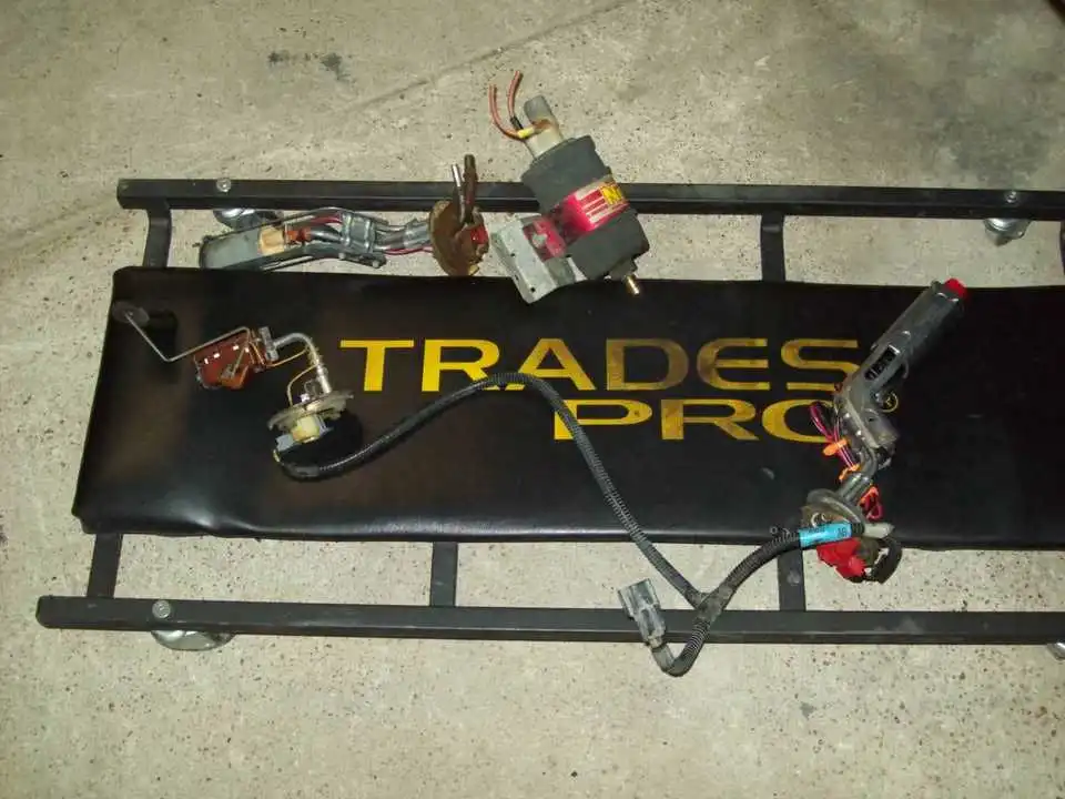

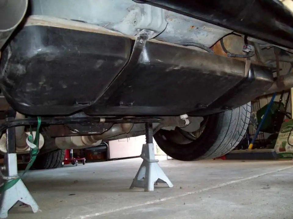

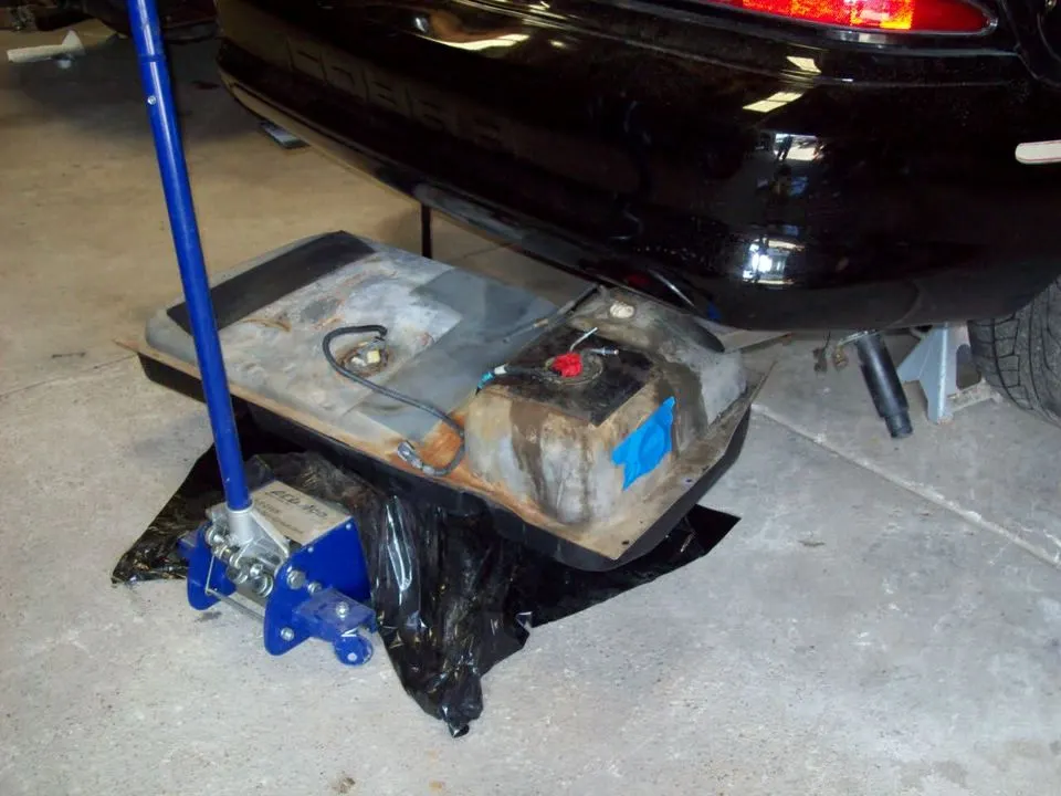

I threw a new fuel pump in the car, I've had a new 255 Walbaro setting around forever decided to ditch the external pump to make things less complicated. Also painted my old gas cover black red cover wasn't my style....

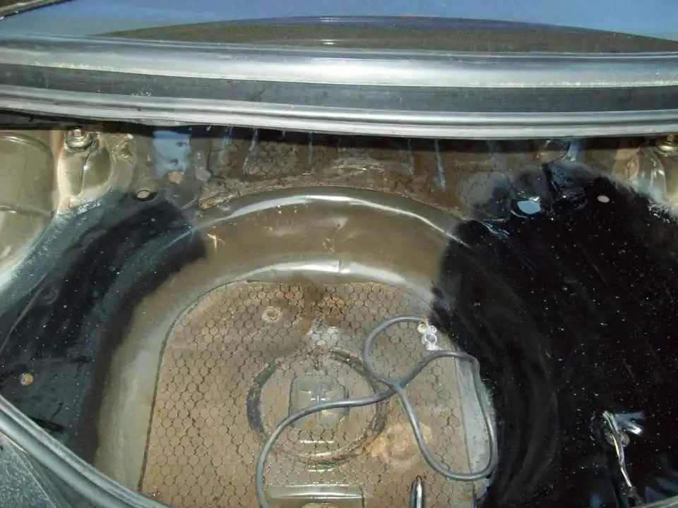

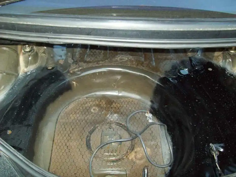

Also had to spend some time in the trunk, decided to clean it out and sand/paint to cover up some rust due to PO had a acid battery make a huge mess and it caused some surface rust. Next step is mount my optima in the trunk and put it back together more on that later....

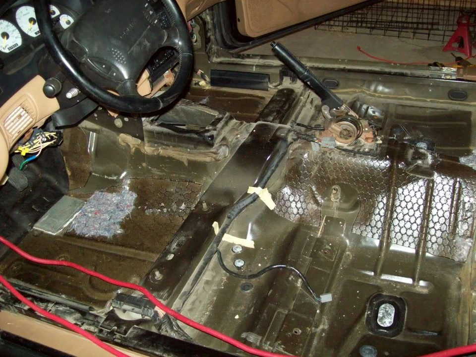

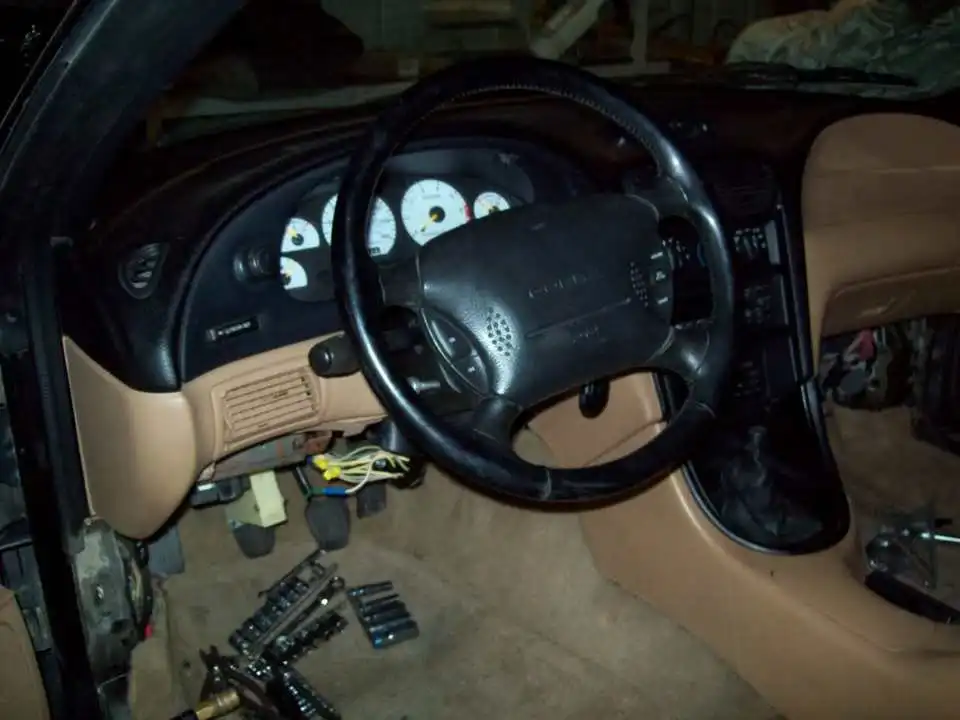

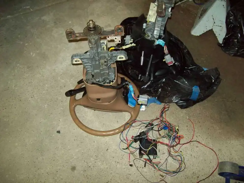

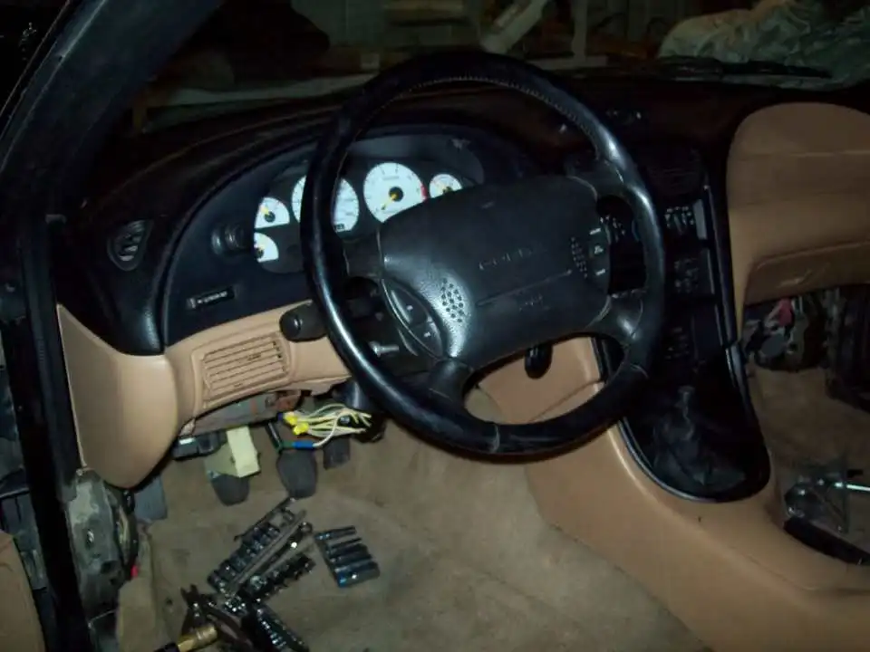

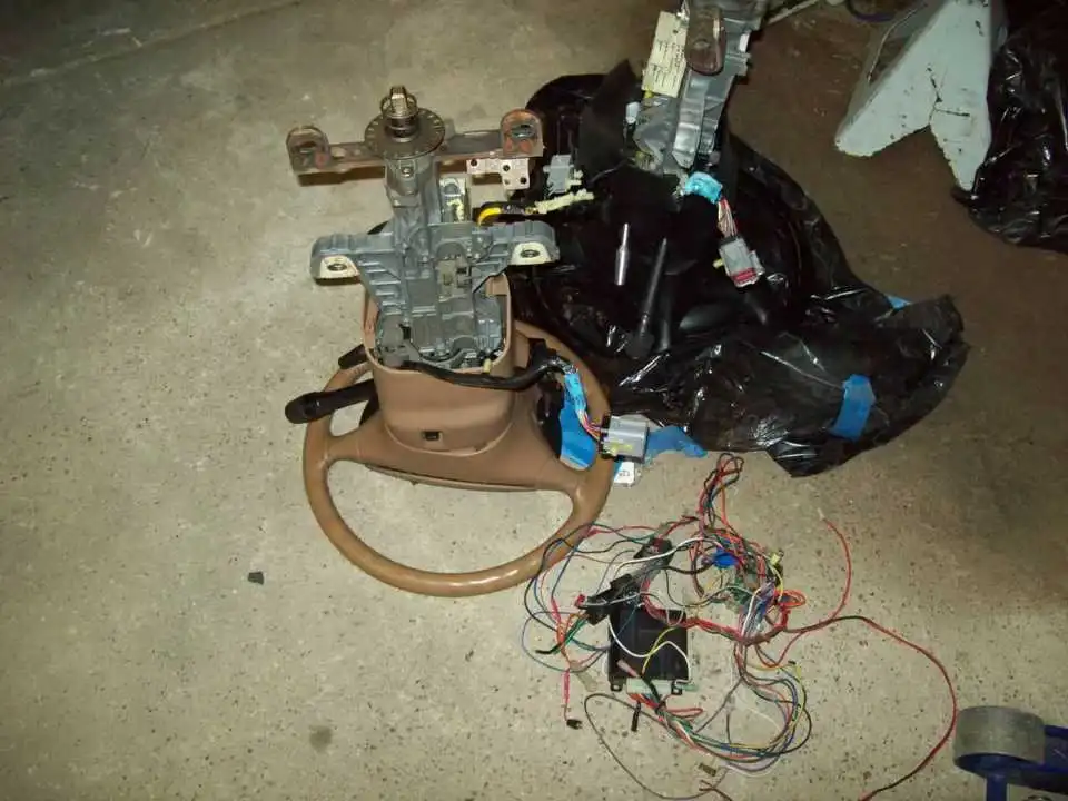

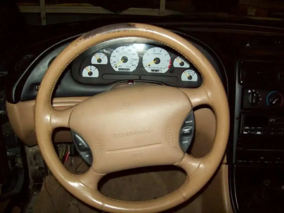

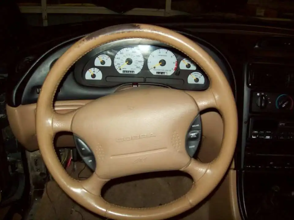

Today I went ahead and changed out the steering columns, my black wheel was in better shape and I also plan to get back to a all black interior...

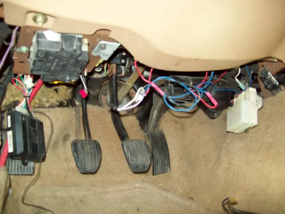

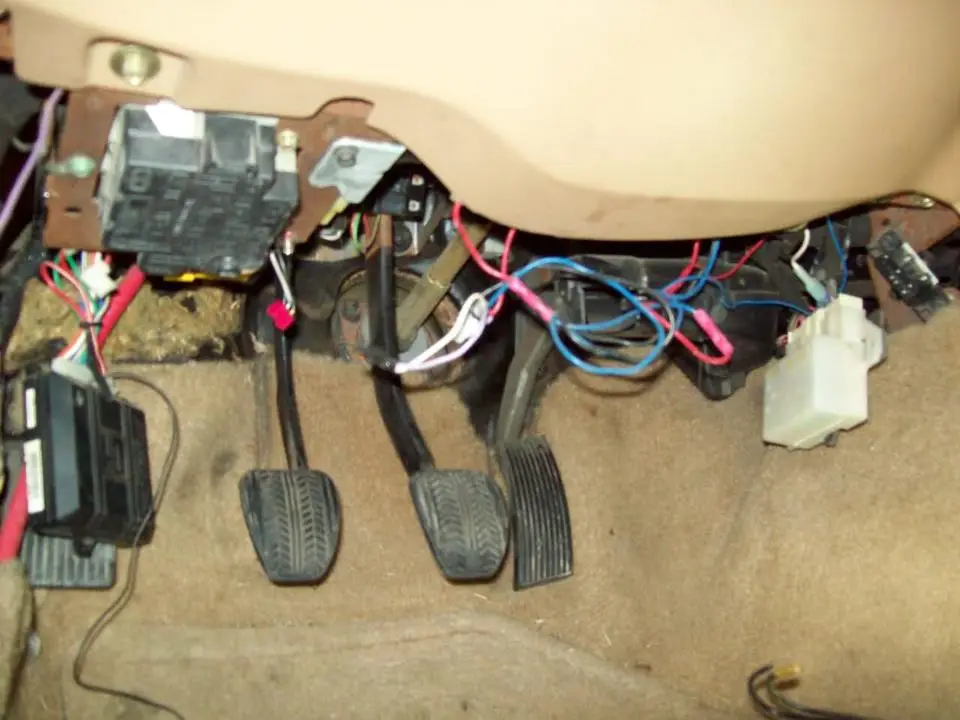

Car doesn't look to need much work wiring wise I discovered this week it had a alarm that was still semi hooked up went ahead and yanked it out (I don't have the remotes anyhow), only left one wire on the steering column harness I will have to splice back together so really not bad at all.

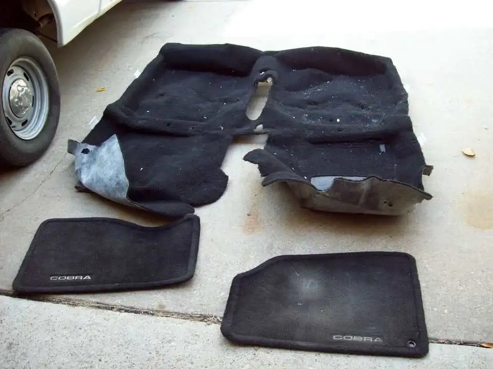

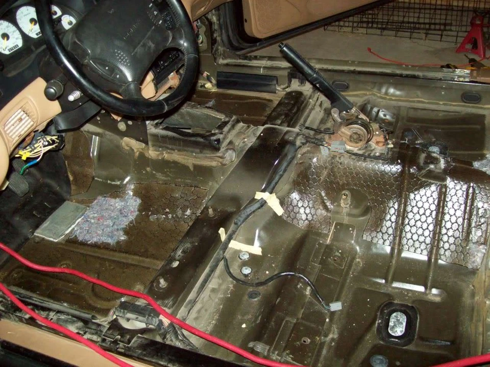

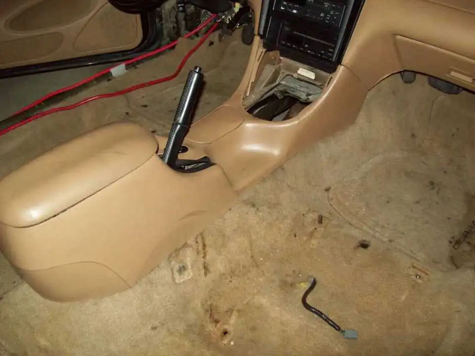

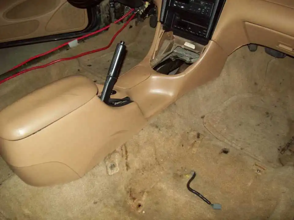

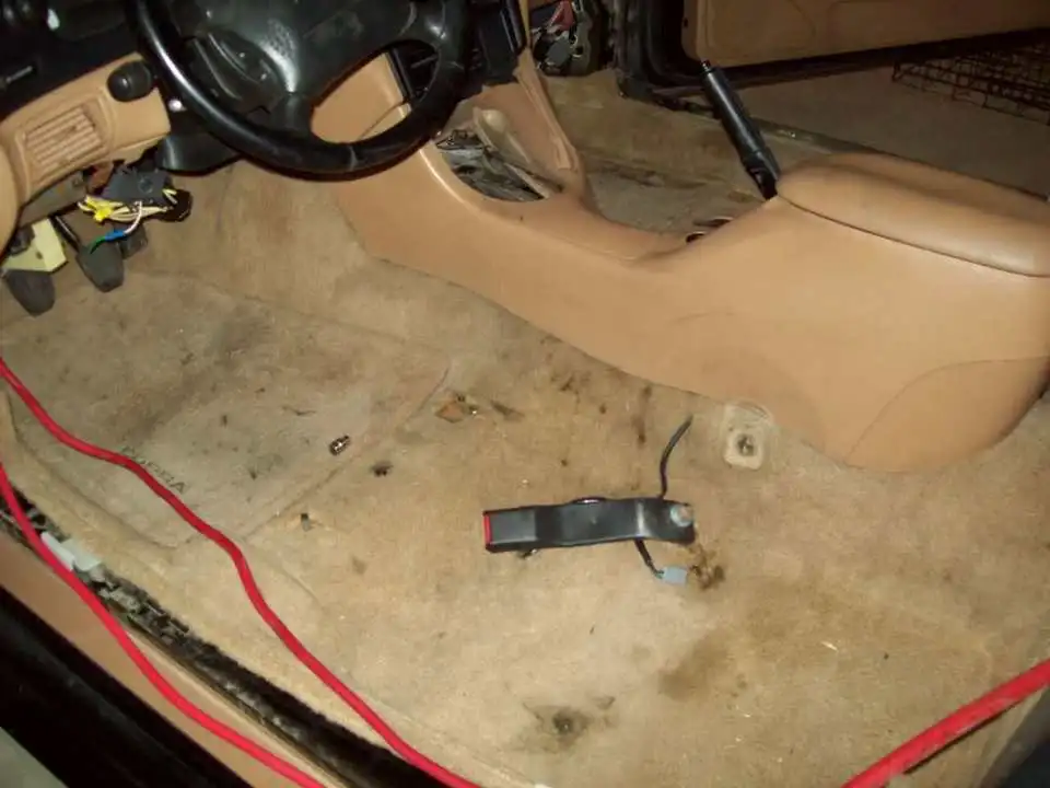

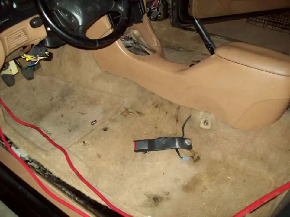

And last thing of the night I did was yank the carpet. Plan to clean up my black carpet (in really good shape) and put it in this car.
Tomorrow I will be working on getting the black carpet back in the car and interior back together, battery in the trunk and then maybe get the motor on the engine stand.

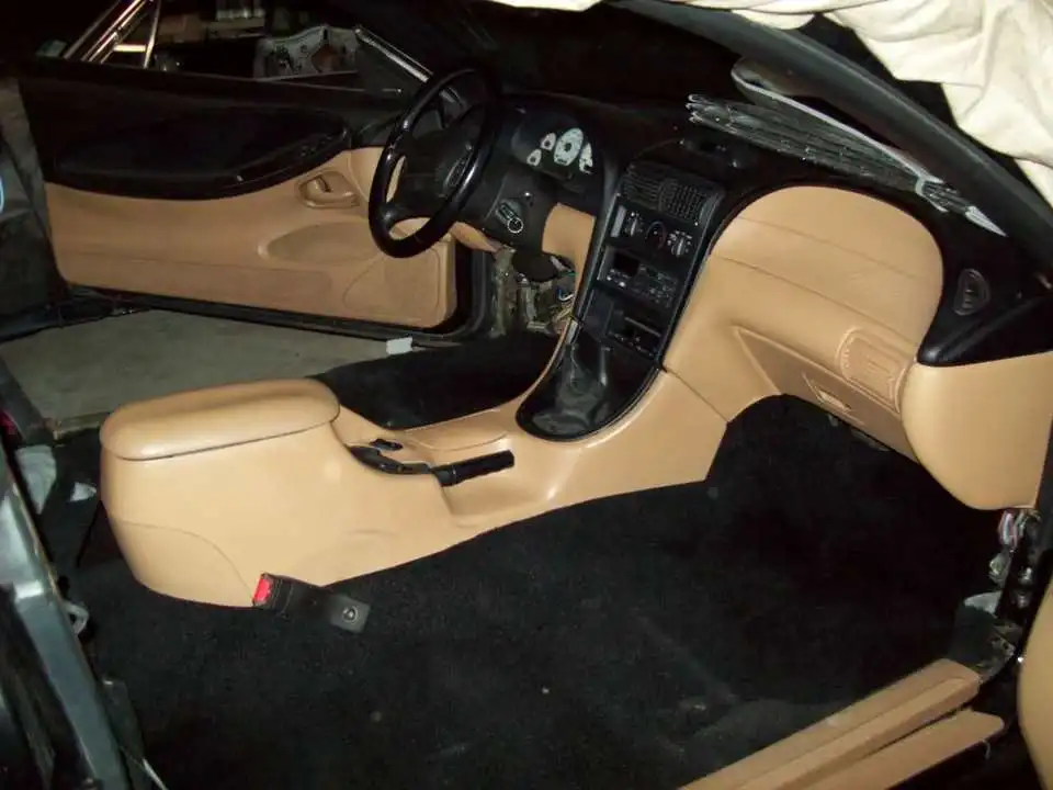

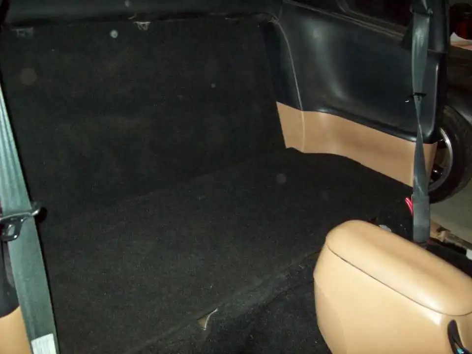

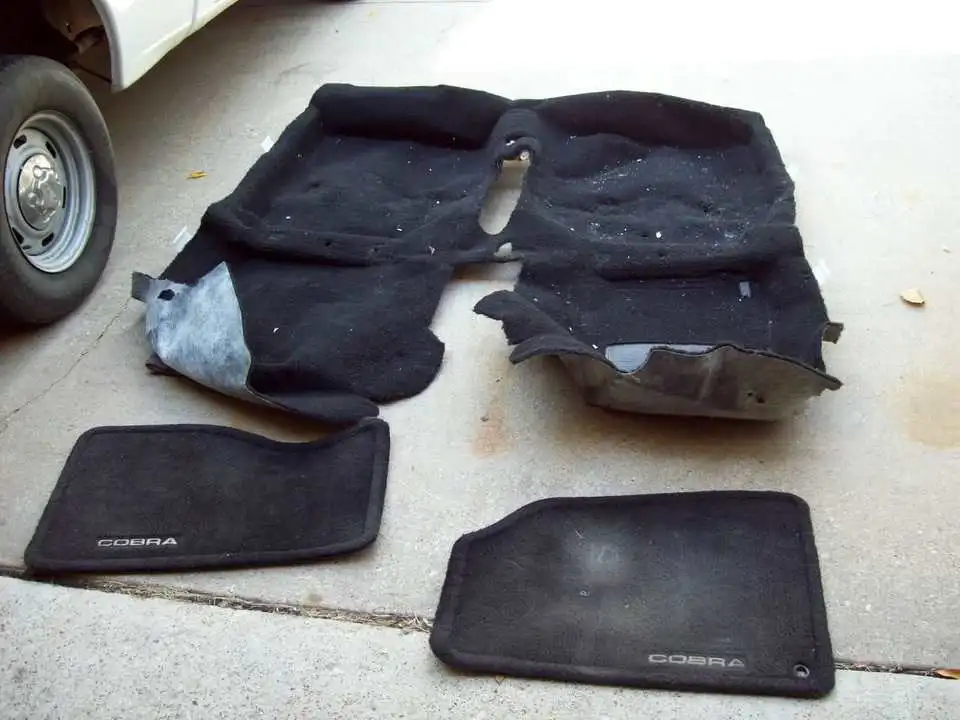

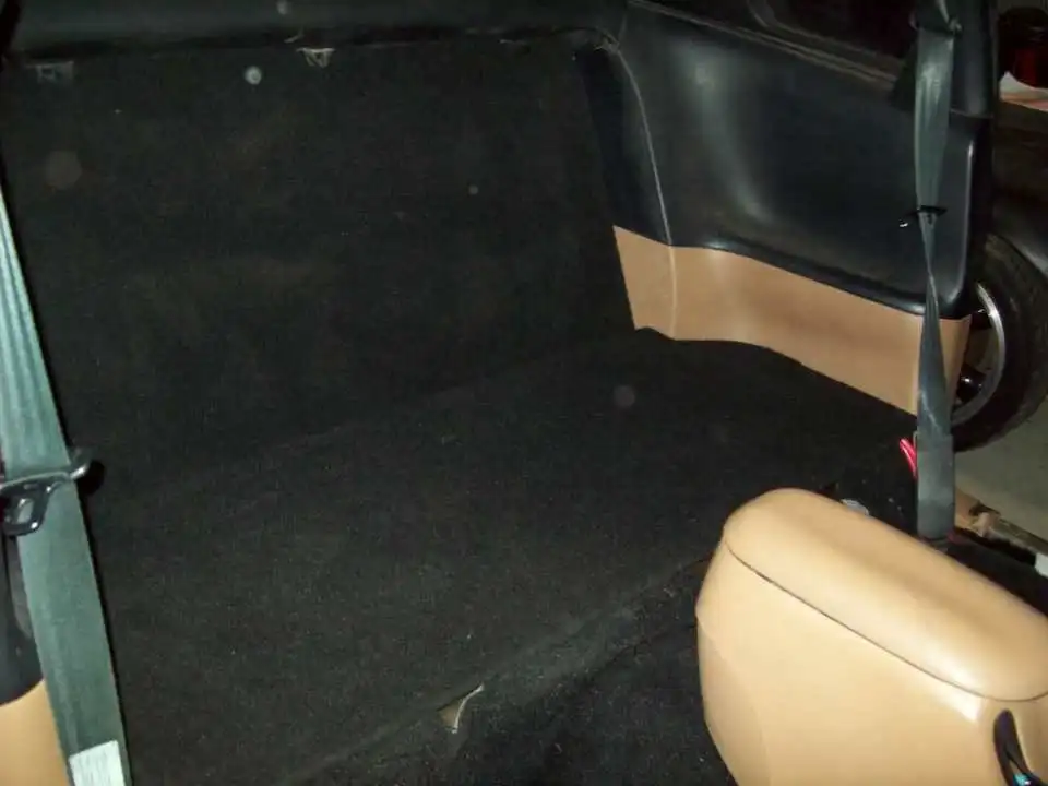

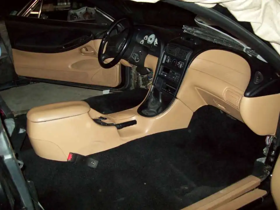

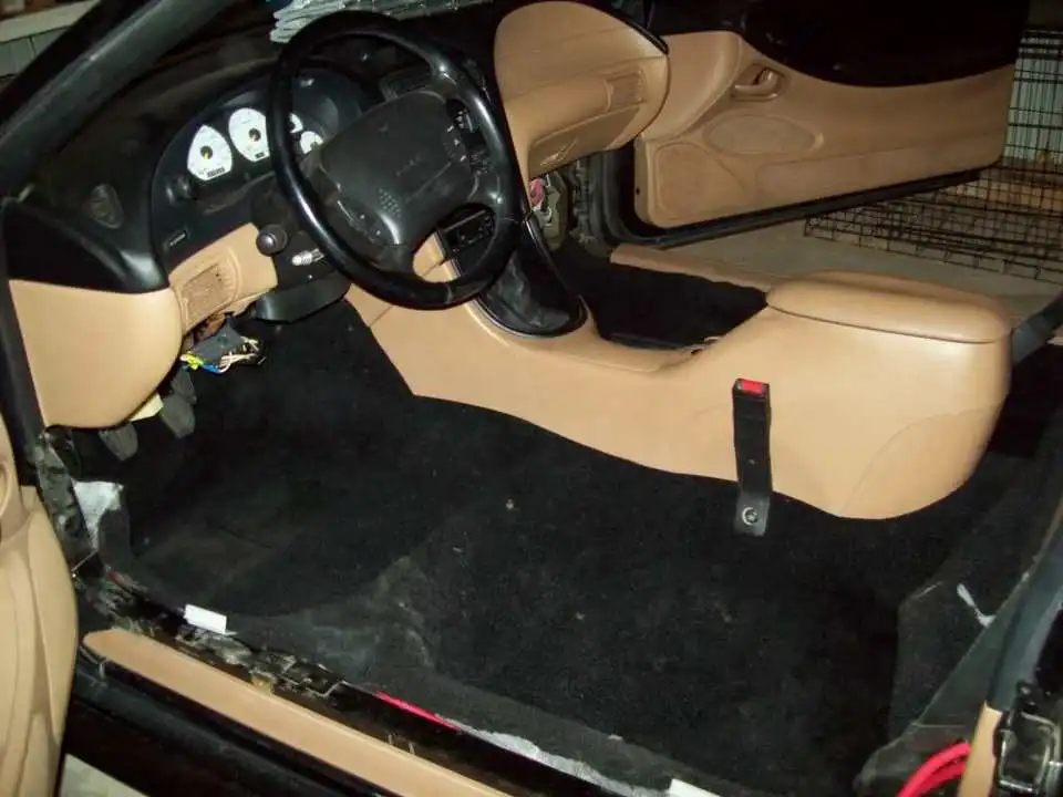

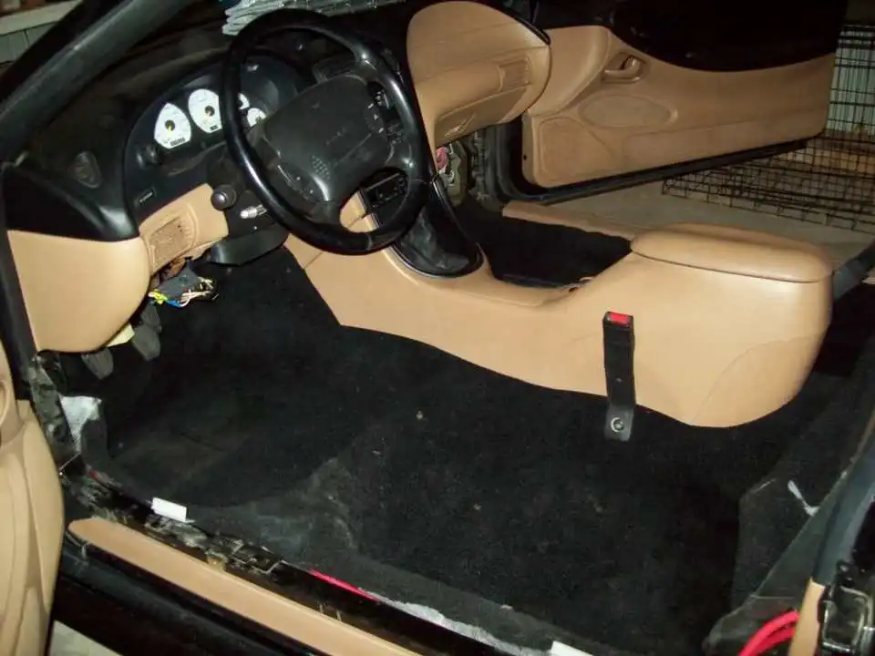

Put most of the interior back together had to clean my black carpet power sprayer and vacuum did wonders it had alot of glass/trash on it.....
(Yah I need new floor mats)
Looks way better then the tan IMO.

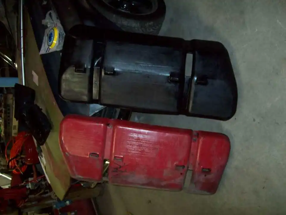

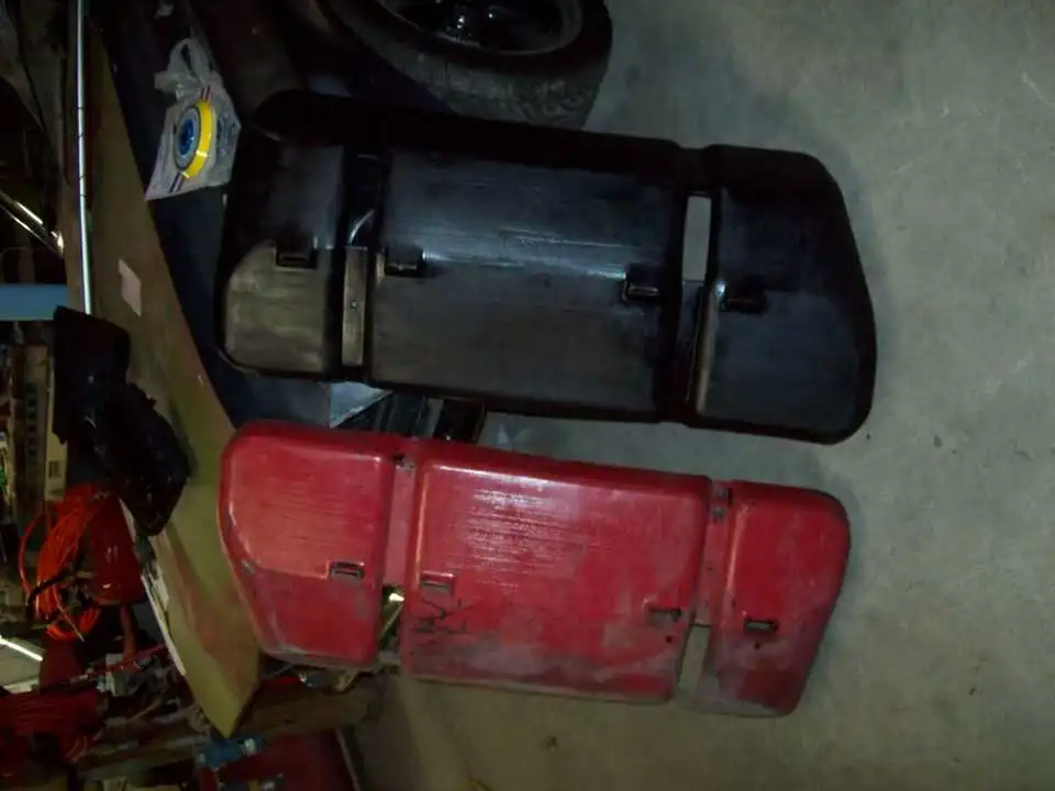

Removed the rear seat belts and put in my Rear Seat Delete.
Finished the trunk too my camera battery went dead. Have to post those later. The carpet is still loose because I didn't bolt it all down yet, still have wires to run on driver side....

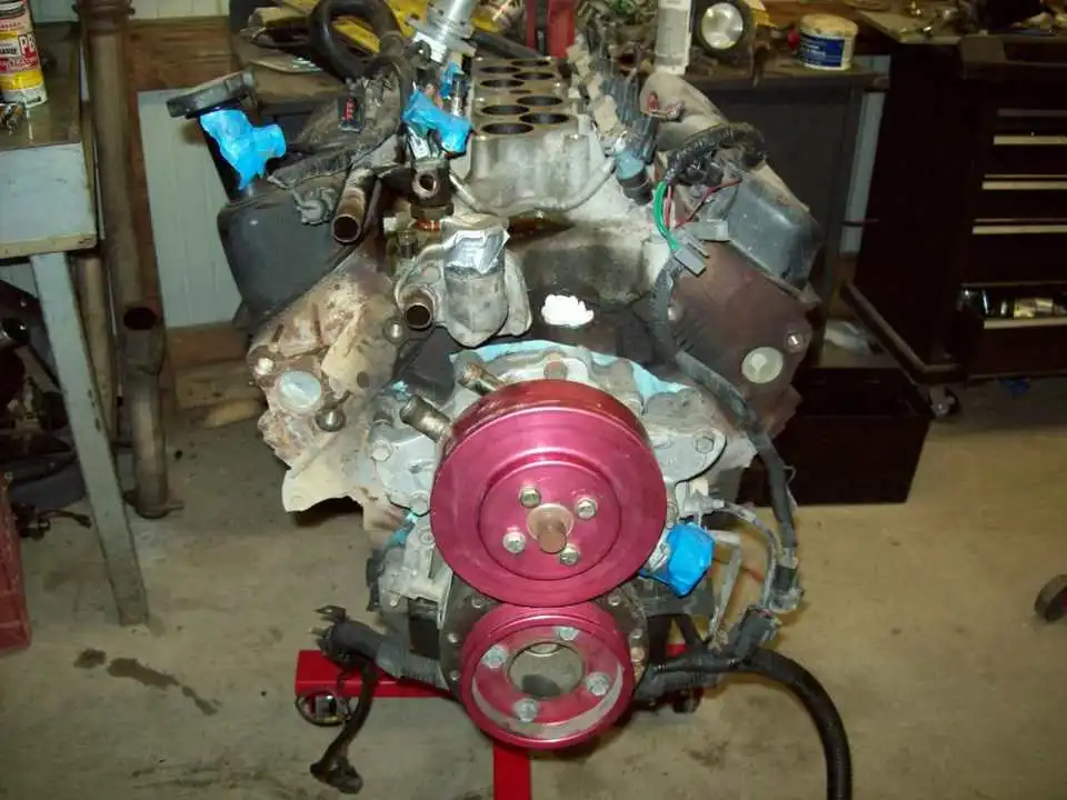

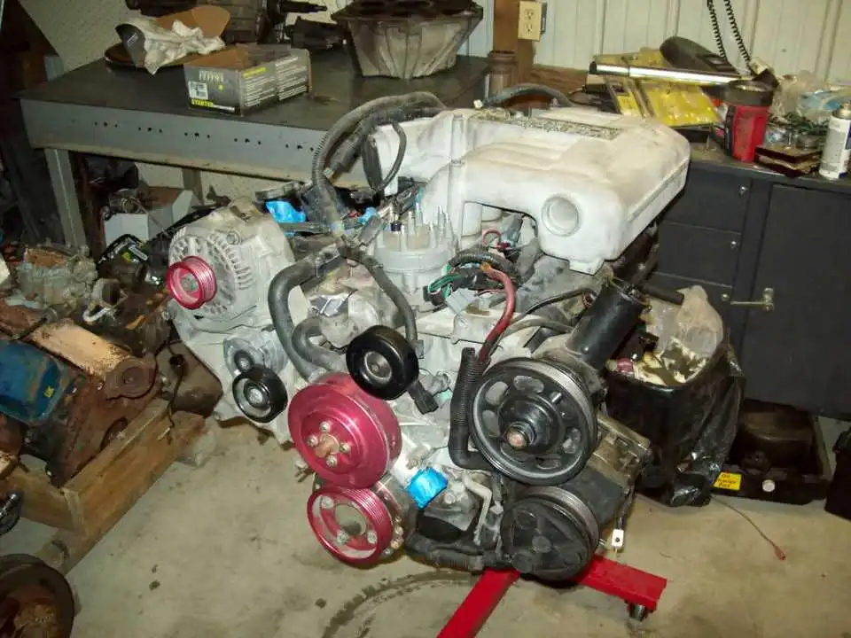

So today I left the car under wraps to attack the parts pile.

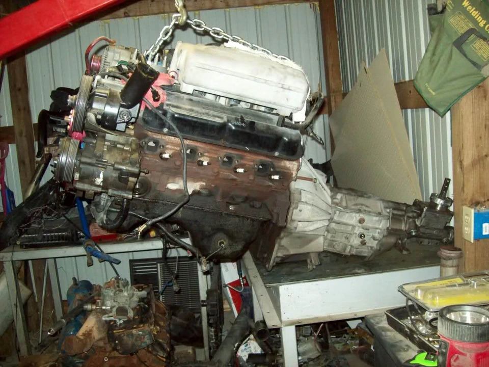

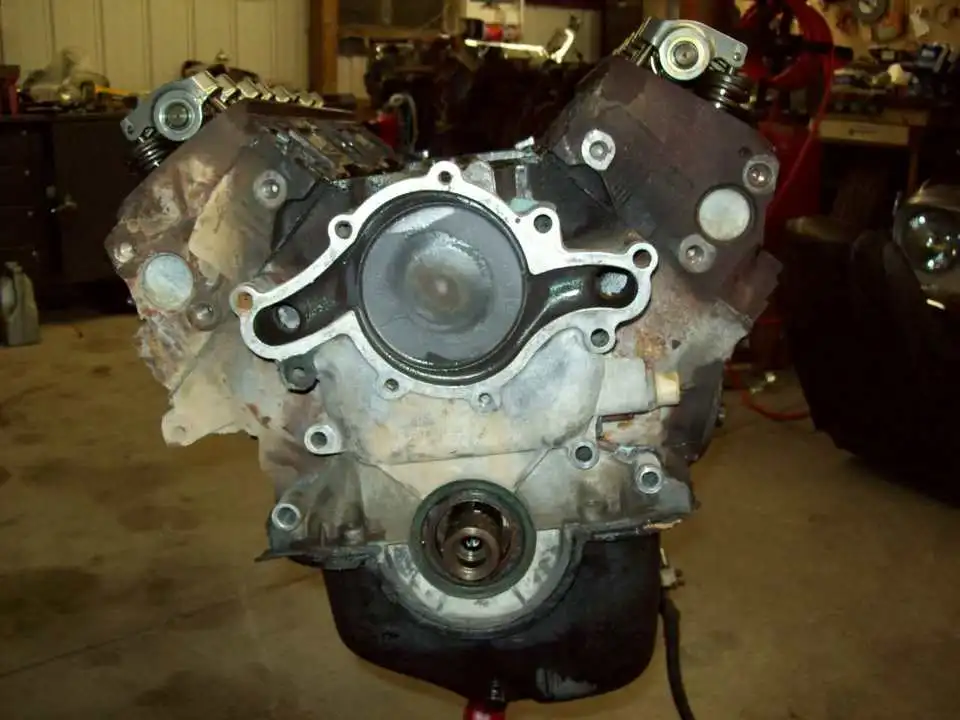

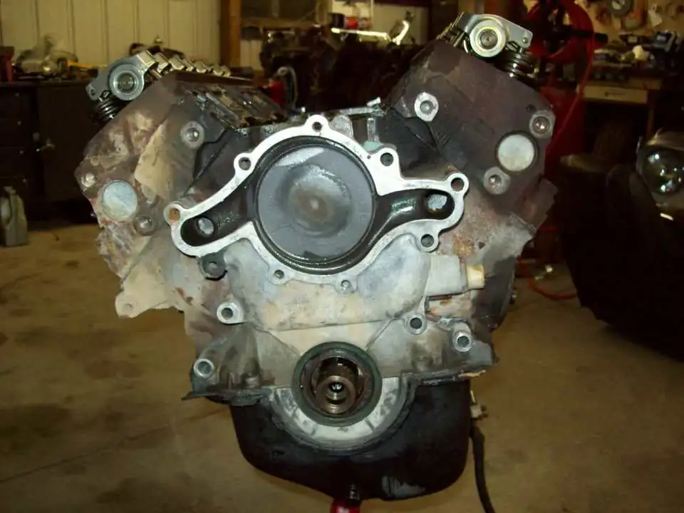

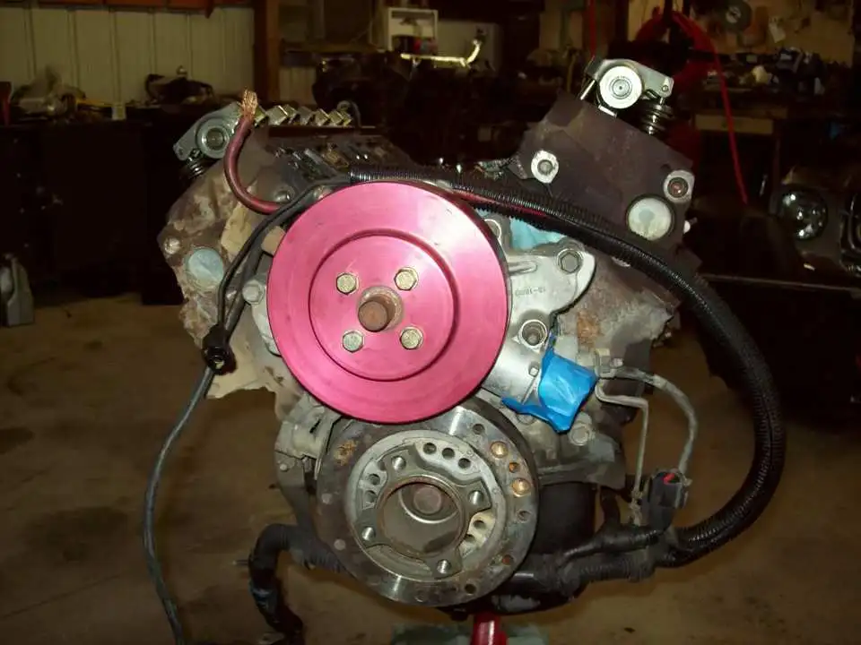

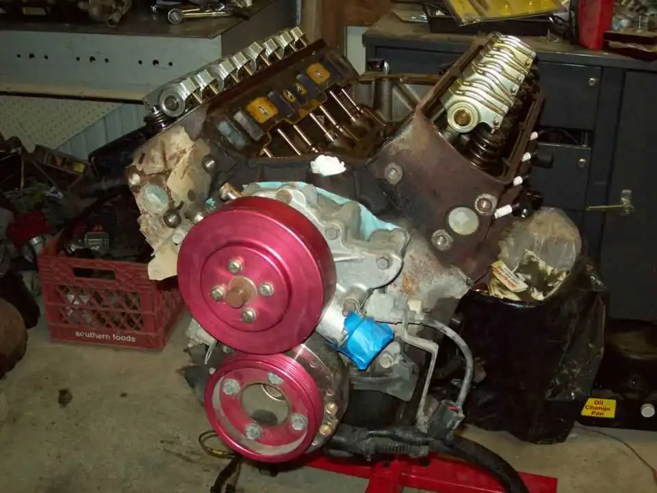

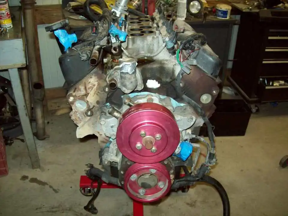

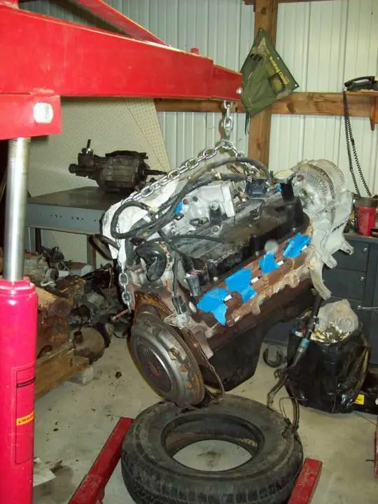

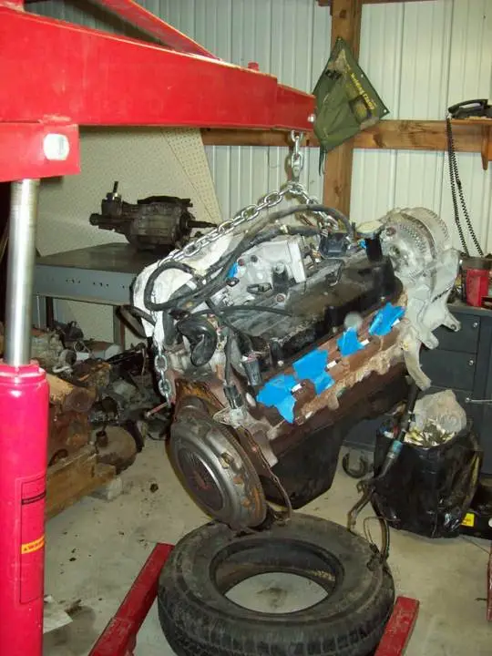

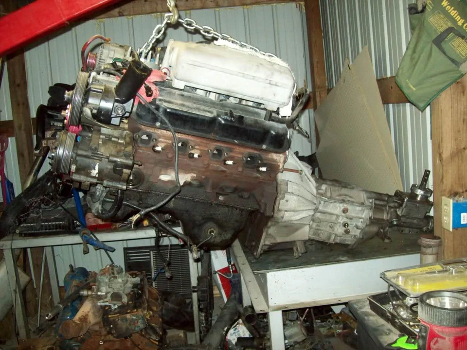

Goal today was to get the motor on a engine stand so I could start to break the motor down. Was a bit hard to do by myself but I manged anyhow went pretty smooth actually.
Once the tranny was off I had a look at the pressure plate and clutch looked to be in pretty good shape. I will probably end up putting in a new clutch anyhow thou.
After a trip to the hardware store I was able to get the motor bolted to the stand.
Then started breaking it down first upper intake and front brackets.

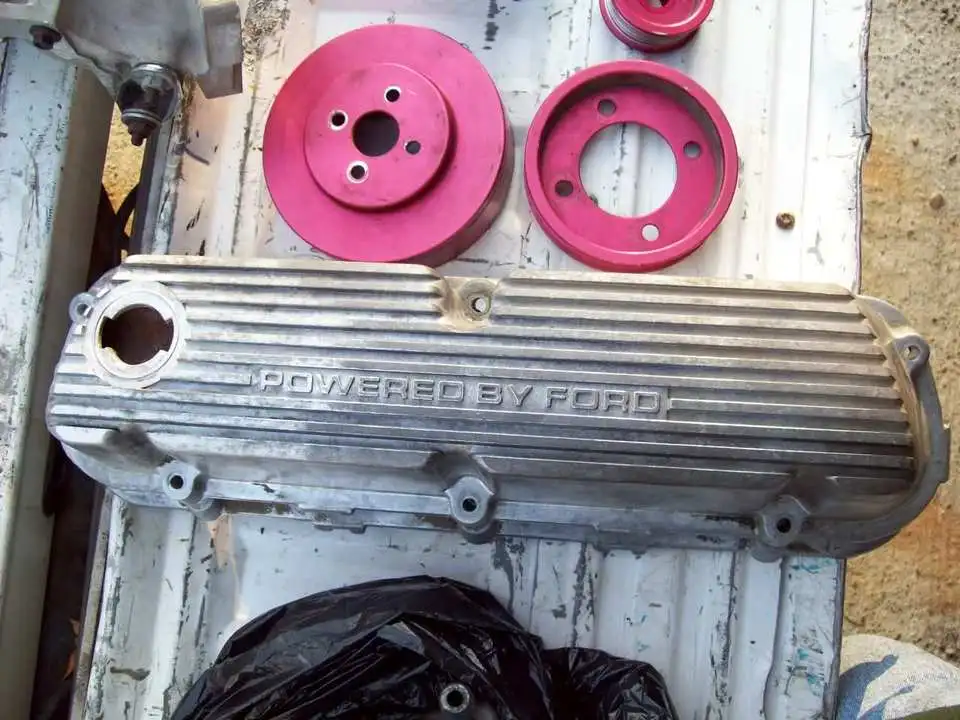

Then the lower intake and Valve Covers. (I have a new set of covers. )

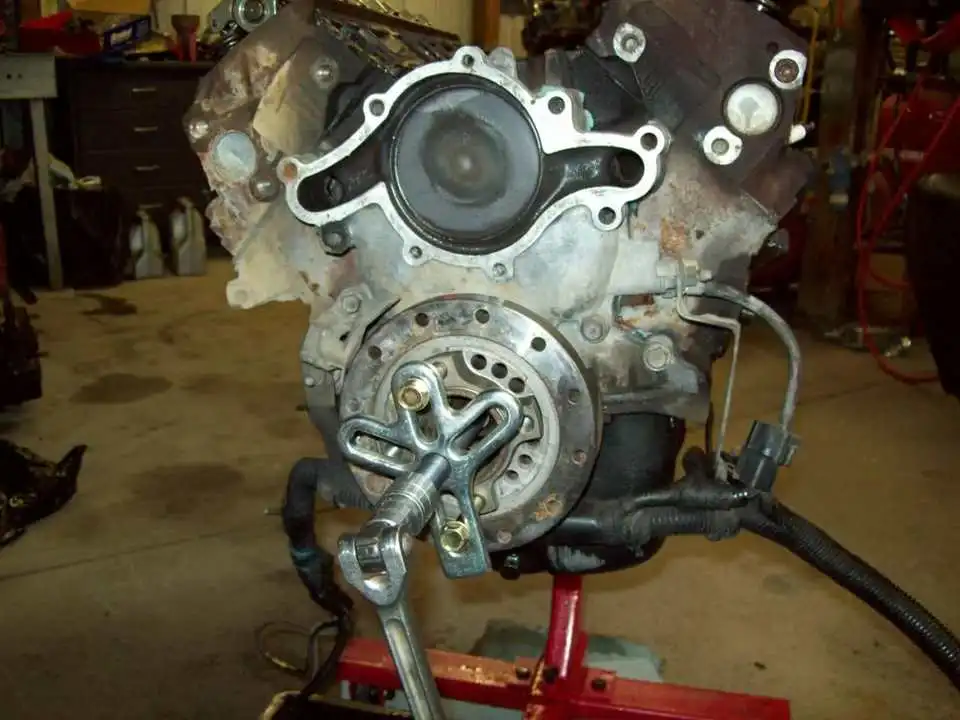

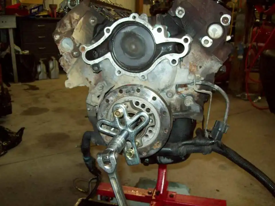

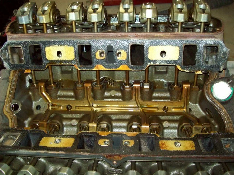

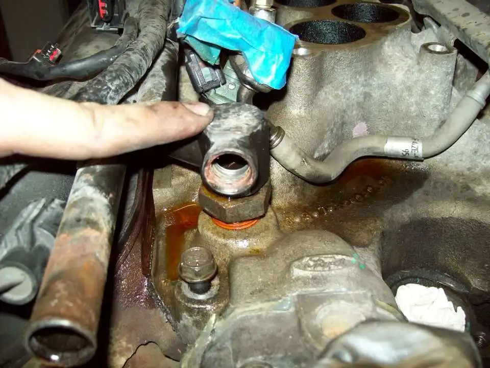

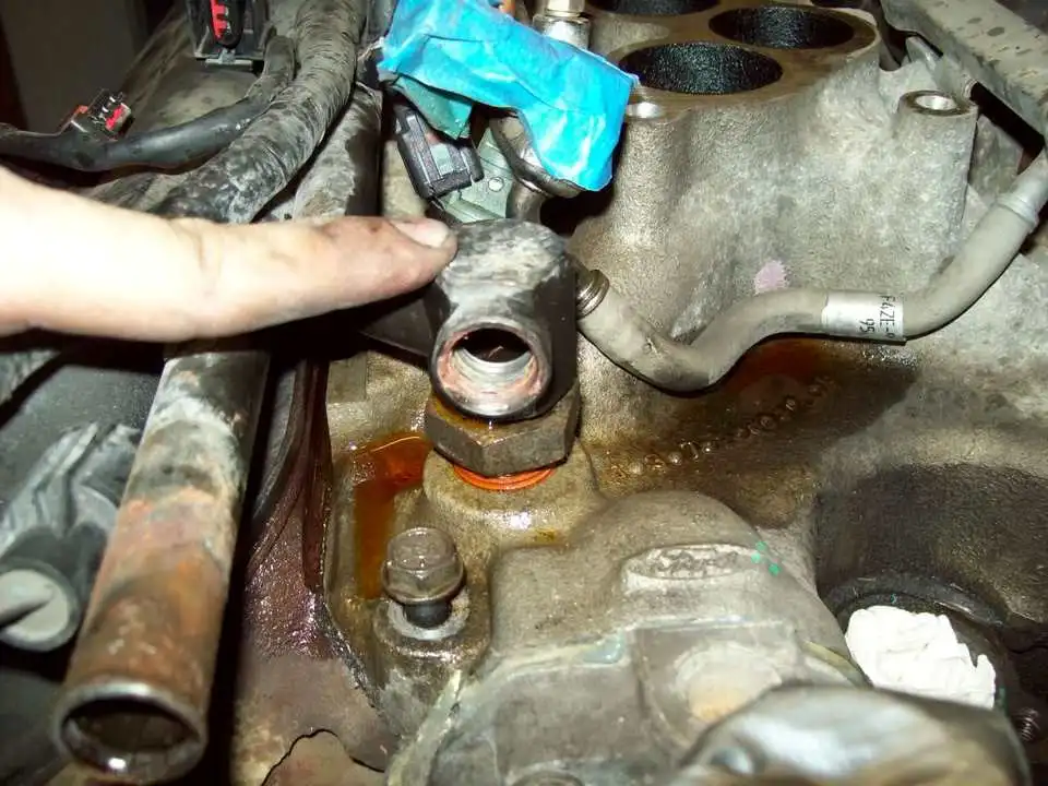

BTW this thing is a bitch. Left it soaking with oil hopefully it will break loose tomorrow I want to paint most of this stuff so gotta break it down.
Motor looks pretty clean on the inside.
Went ahead and called it quits after wrapping the motor up.
Tomorrow I will drain the oil and check out my rear main seal leak. Would have torn down the water pump/timing chain cover but left my balancer puller at home.
After I've torn it apart I'm going to order whatever I need gasket wise, then I am on the fence about a comp 2031 cam/spring kit (dunno what push rods), and maybe new king cobra clutch kit.

oh yeah, i forgot to mention, that thing you soaked in oil, whatever that sensor is, is a b*tch to get off. I've almost always bent the collant line bracket there when taking mine off. did you get it off without bending it?

And that thing came off easier after soaking overnight, I'd like to figure out a way to get rid of it all together. Would be nice to mount the sensor directly to the intake, then run soft lines around to the heater core. I think that would end up looking cleaner.
I don't remember that piece needing more than a big wrench to get off. This may be a good time to redo the rest of your gaskets! If the head gaskets were good before, I would probably just leave those. But there's no reason not to do the rest.

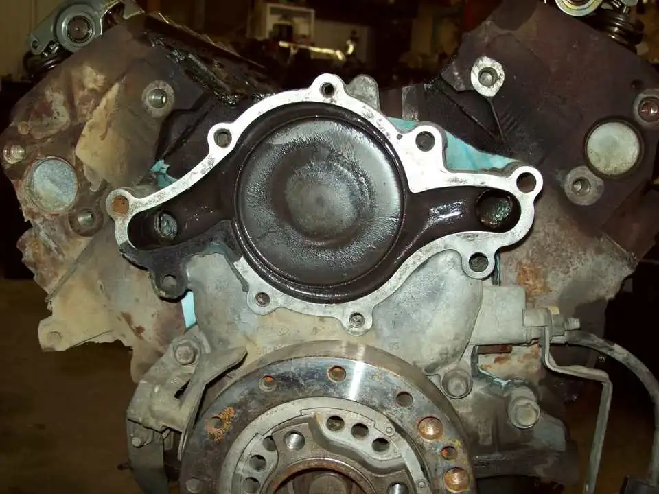

Lot of pics here to help out in another thread....

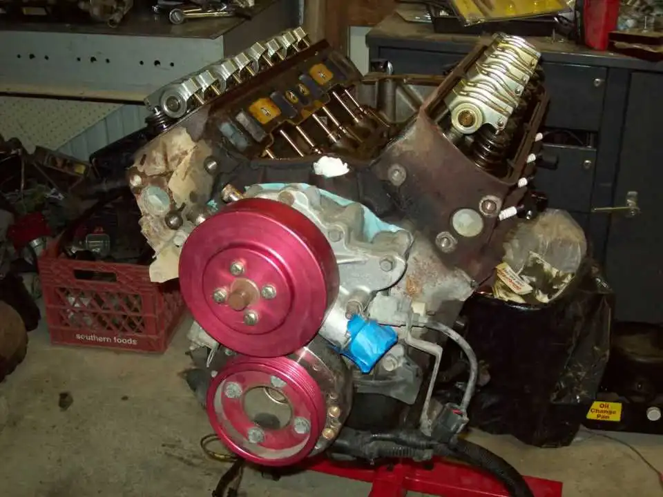

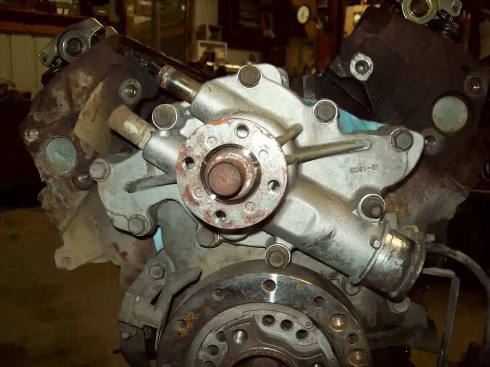

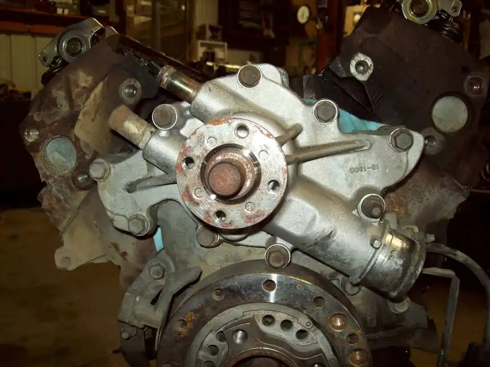

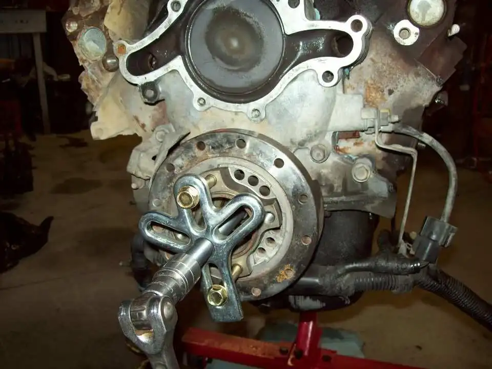

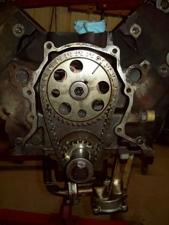

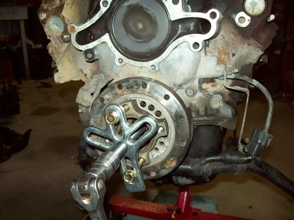

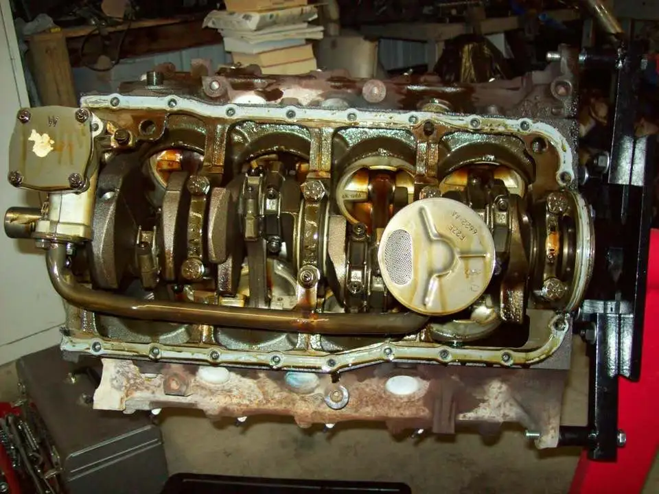

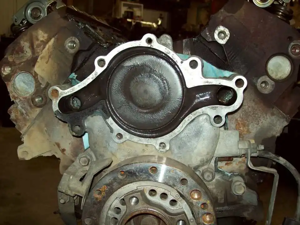

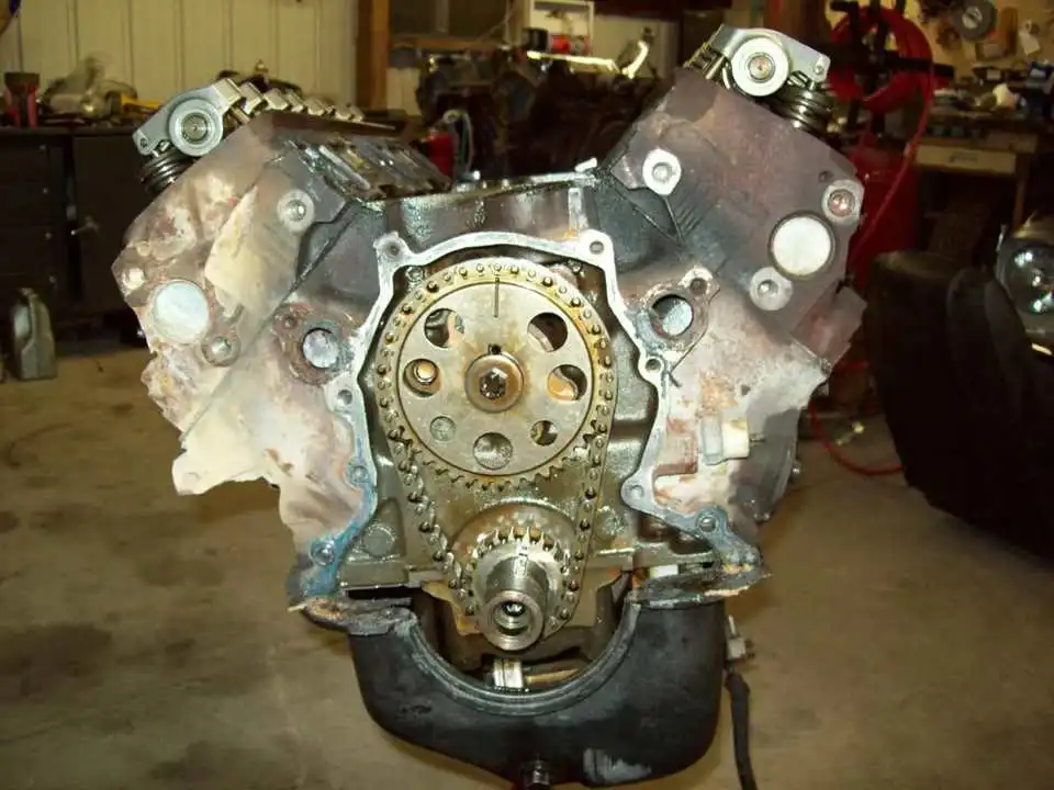

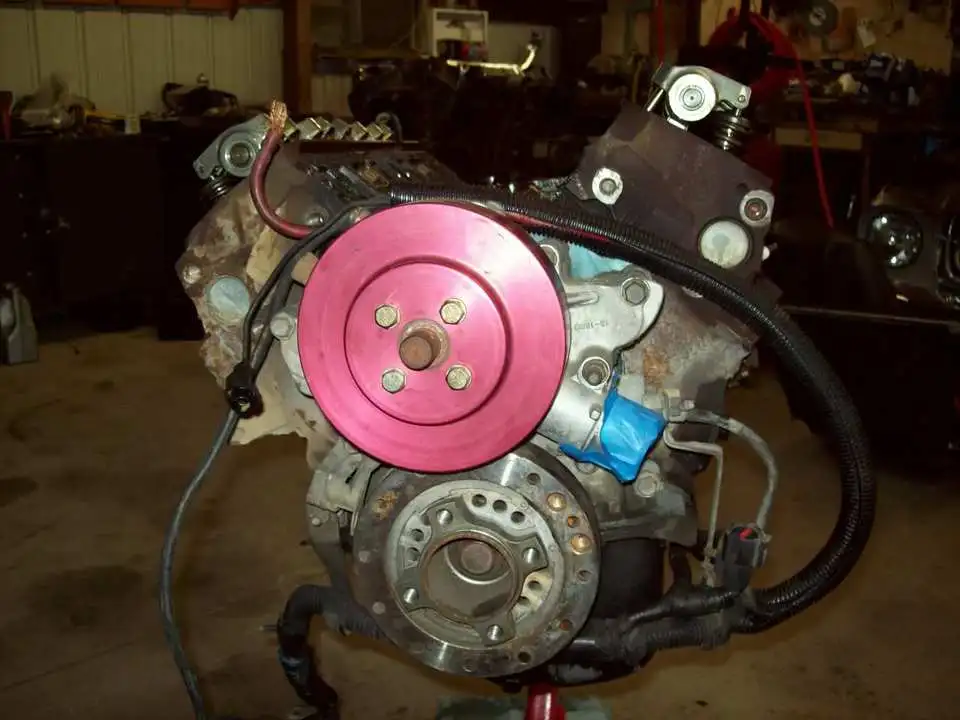

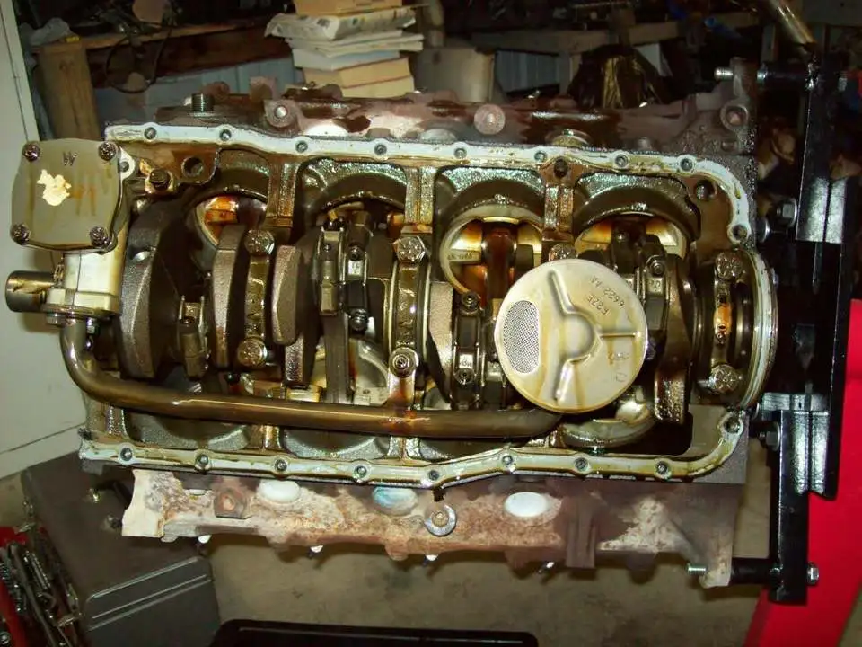

Today I removed the water pump, timing cover, balancer and oil pan.
Pretty straightforward job, if you do not have any leaks on the timing chain cover side you will not need to remove the balancer. My stock pump was actually fine 2~ years ago when I installed that one but after a long 4th gear pull I blew out the gasket between the timing cover and block so I had to do the 2nd half of these pics to replace it.
Also took off the pan, the inside of the motor looks great. I'm thinkin about taking off the oil pickup tube to hose it out but other then that don't plan to touch anything else on the motor other then the rear main seal.

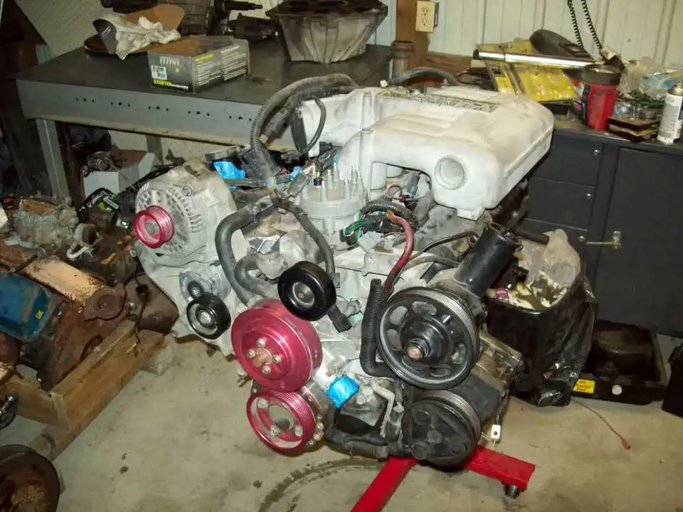

Spent the last 2~ weeks working on another car. R&Red motor on a 96 vert upgrade to PI so progress slowed down a bit, also it is getting COLD. :notnice:

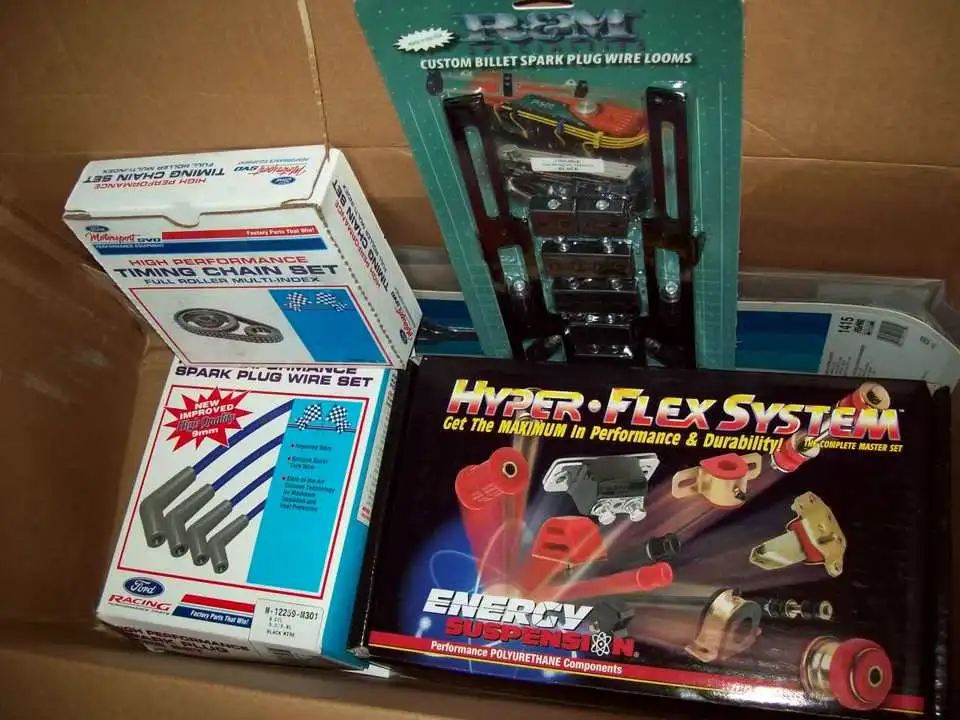

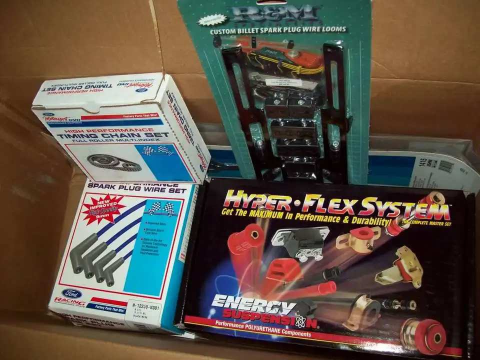

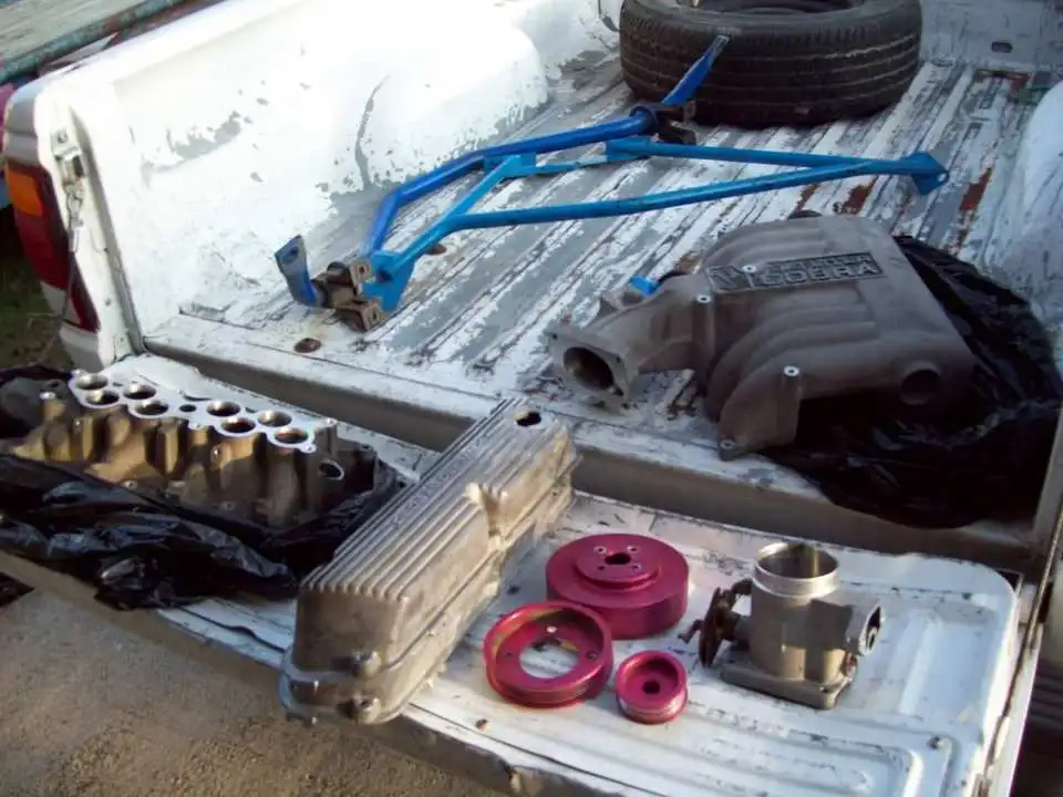

Anyhow. Got some parts in. Some new/upgrades.

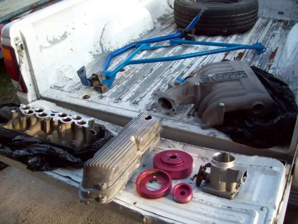

Motor mount/tranny mount. (Tranny mount broke in the wreck.) Double roller timing chain, new plug wires and some "wire looms" should clean up the engine bay with some other stuff I have planned.

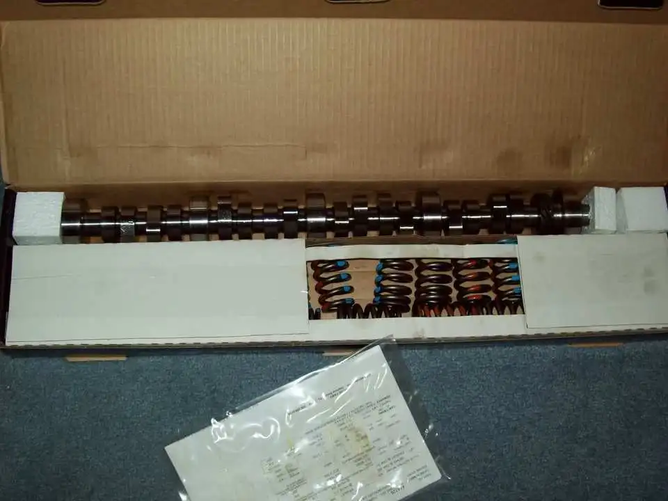

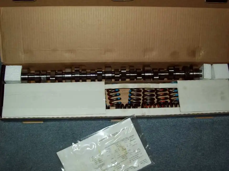

New comp 2031 cam, with springs, retainers etc.

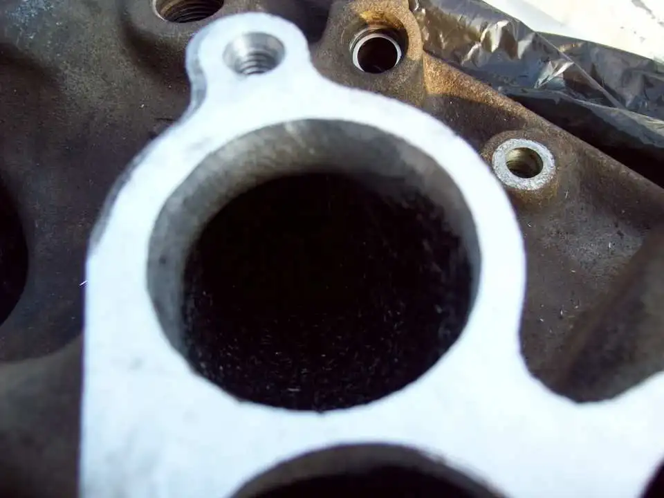

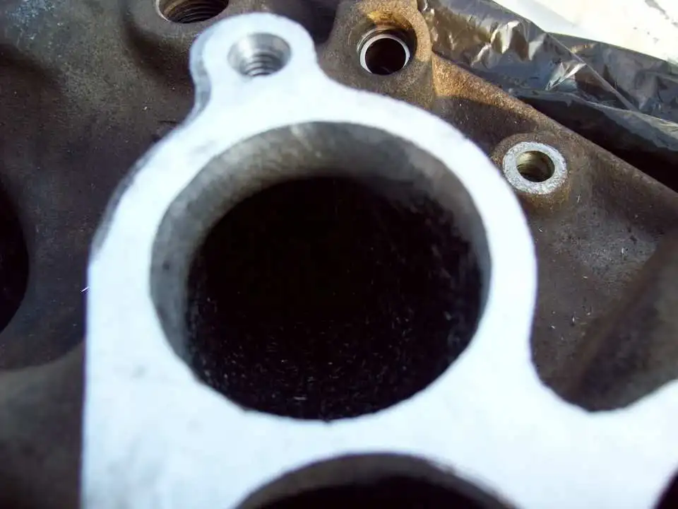

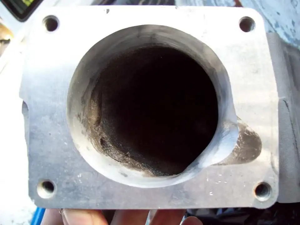

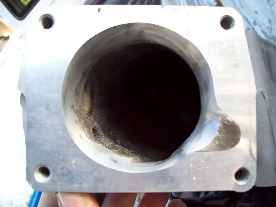

I took the intake to a friend to have him do some minor port work on. Mainly the Throttle Body opening.
When I went to pick the intake up, I was very pleased to find he had spent some extra time and port matched the upper/lower and ported the lower some also! Thanks man!
(Pic of one of the corner runners which are usually restricted by where a bolt goes in for the fuel rail.)

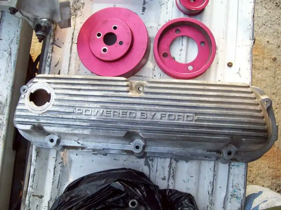

Tomorrow I will be dropping some parts off to get powder coated. Hoping these valve covers turn out good, I like them better then the stock Cobra VC the intake needs a new look BAD.

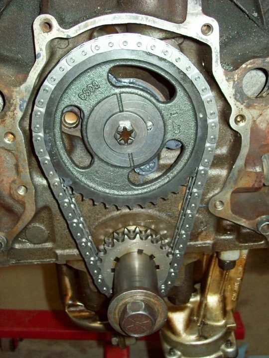

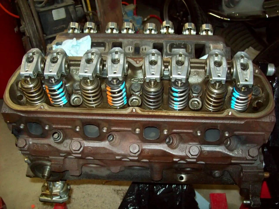

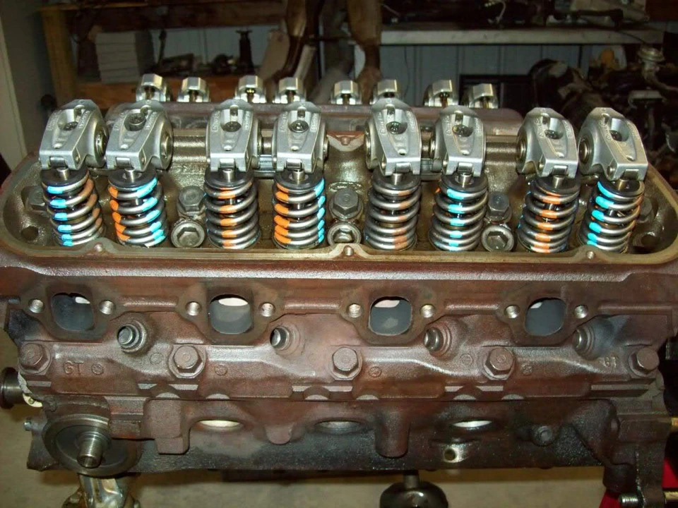

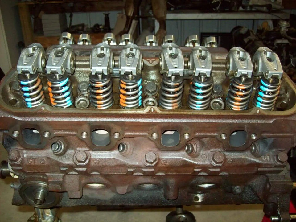

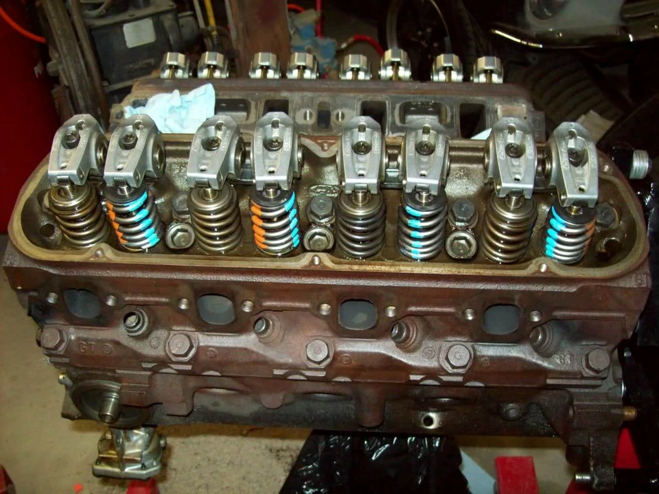

Well was finally able to do some more work.

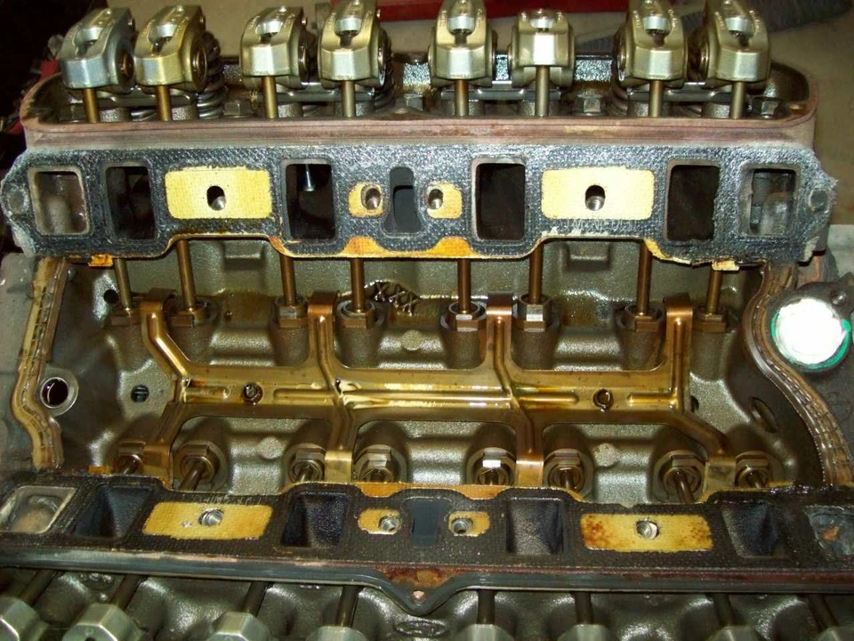

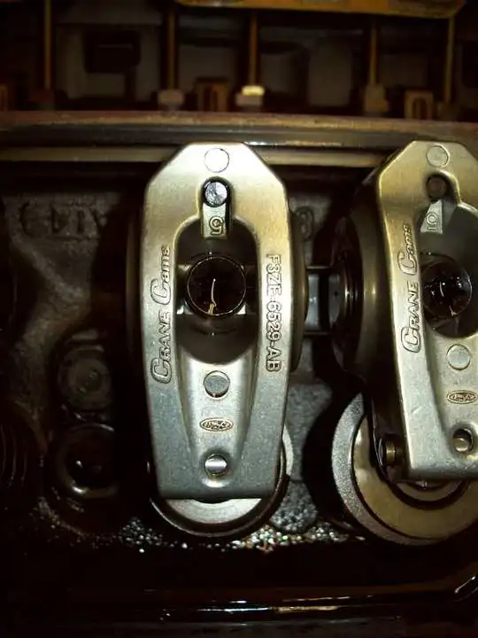

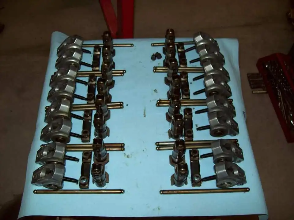

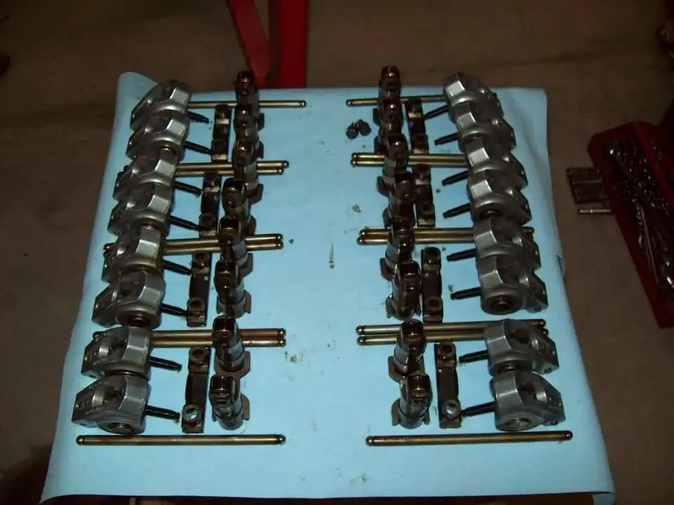

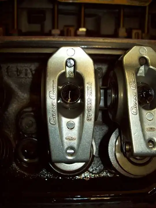

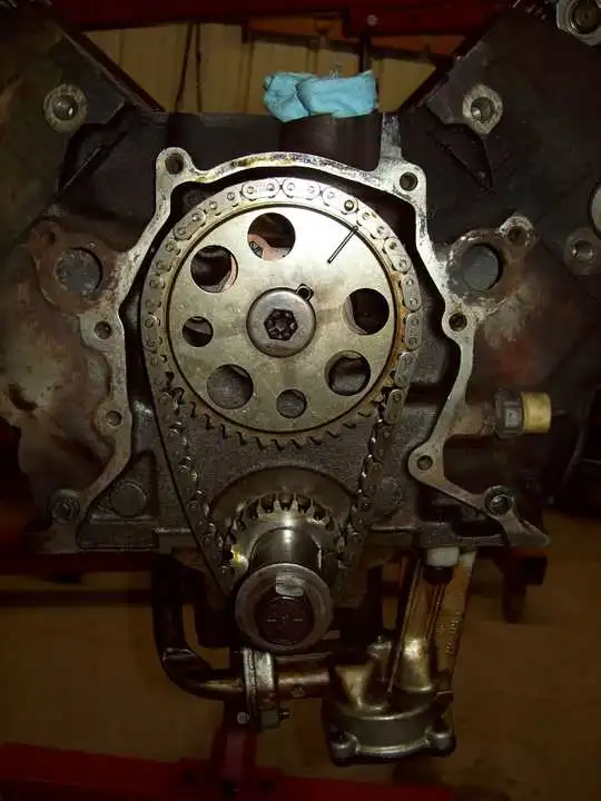

First I replaced the old valve springs, retainers and locks. The stock locks/retainers where a real PITA ended up having to use a socket to beat on the locks to loosen them up since they have been on this motor a long time. After we did the first few it went pretty smooth.
You can see the new springs are much beefier compared to stock.

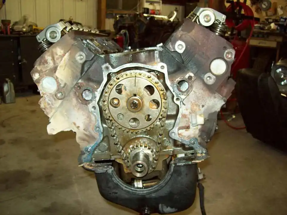

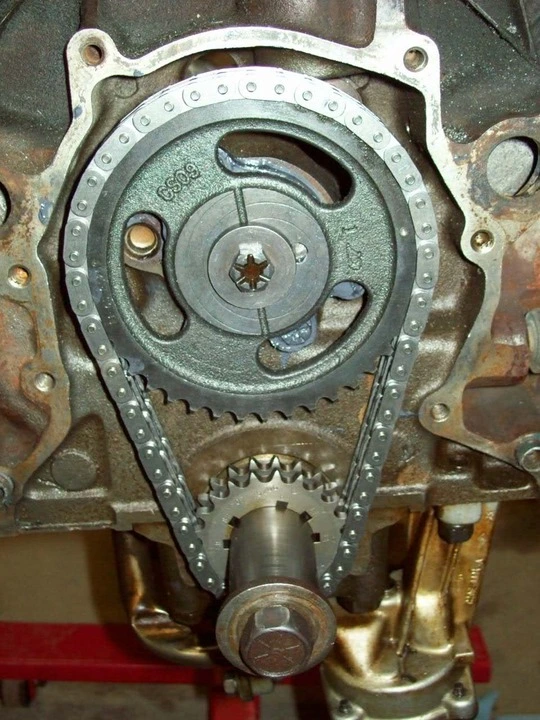

After this was done I removed all the valve train and installed the new cam and timing chain setup.
Stock chain was fine about 2 years ago but was pretty loose now so I'm glad I ordered a new one.
Next move will be to clean up the valve train bits and start putting the motor back together completely. Need to find some engine paint, also got a broken intake bolt stuck in the head. (You can barely see it in one of the pics in this post.)
