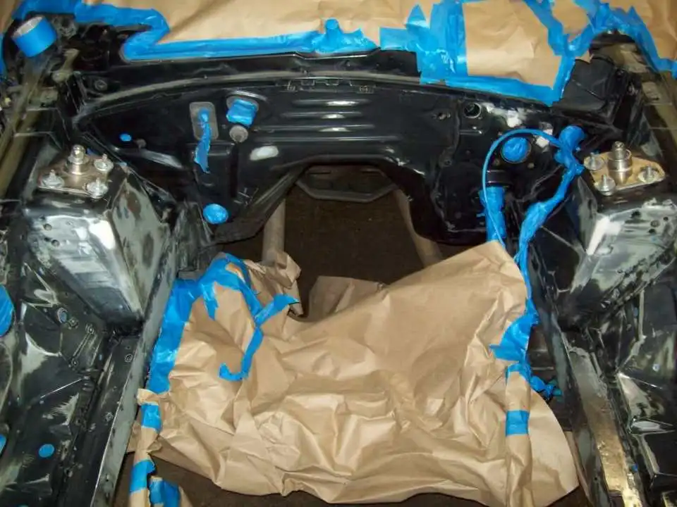

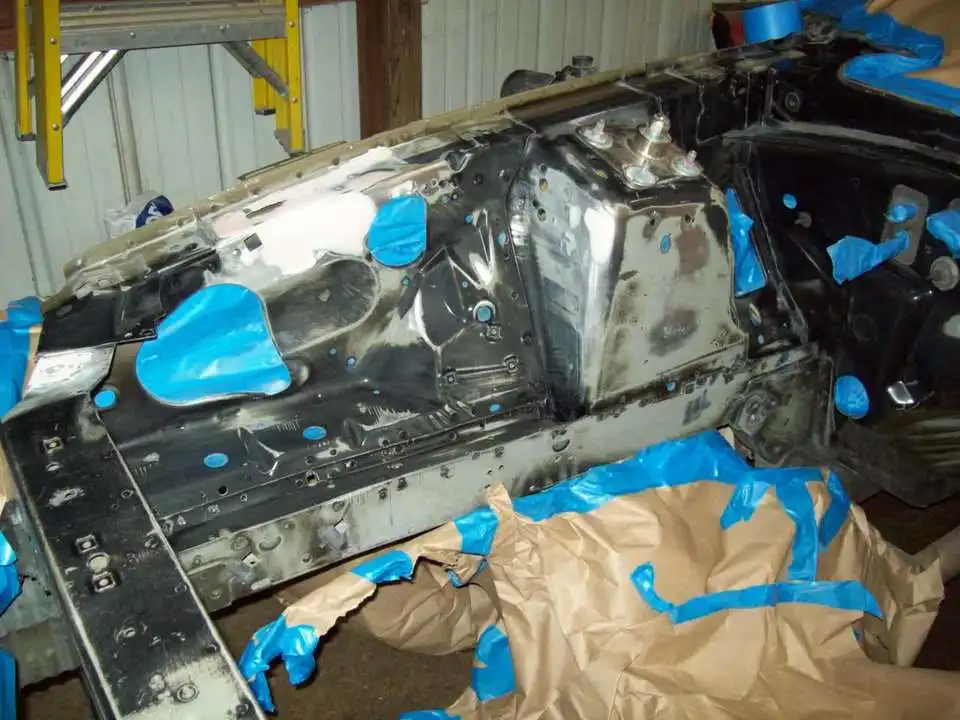

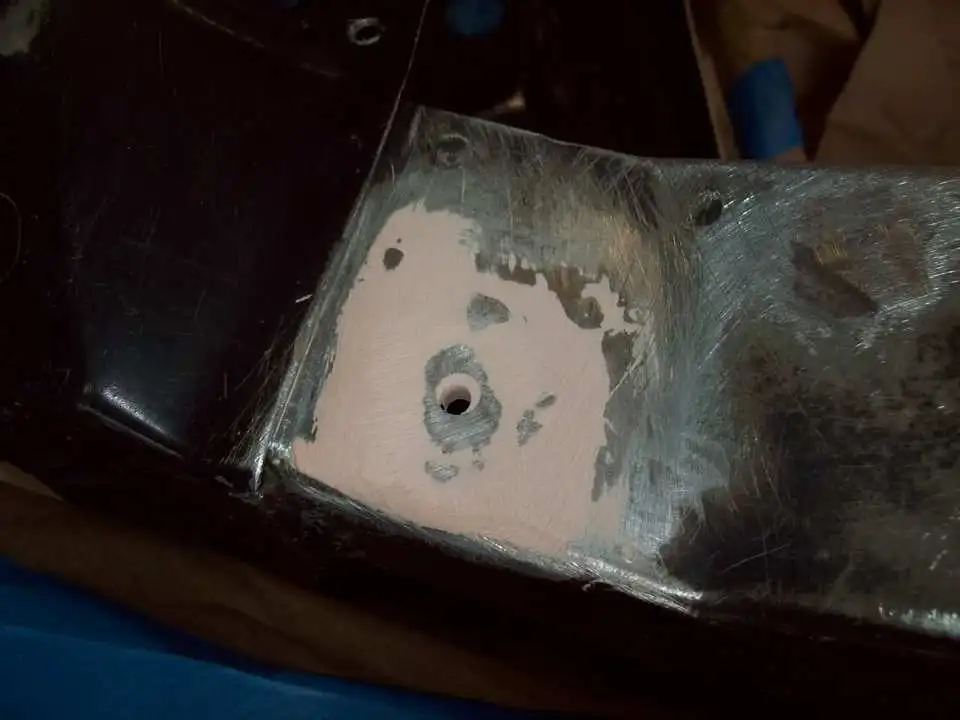

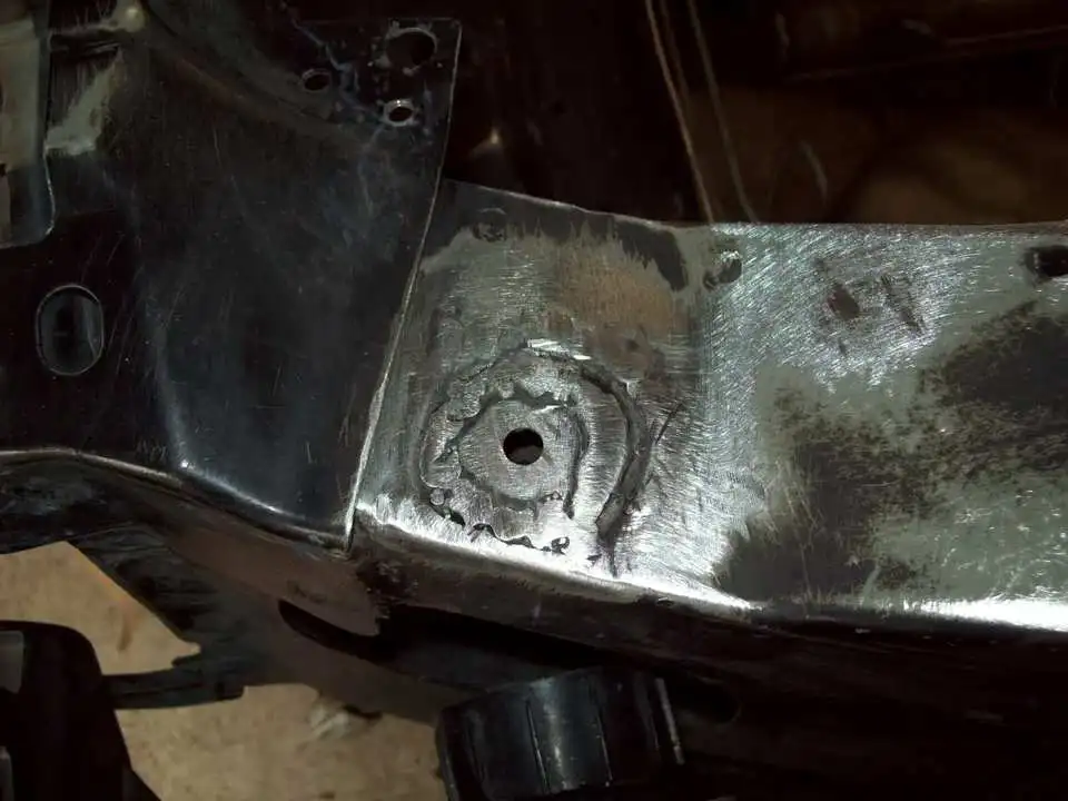

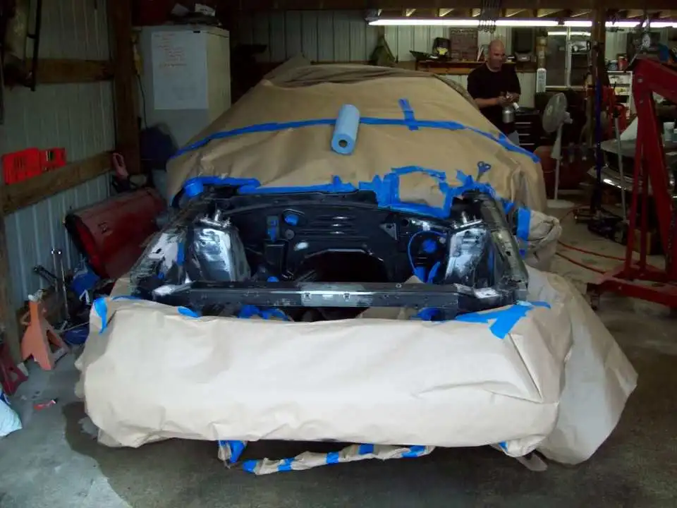

Car use to have hood pins I wanted to change it back to stock so I had do some welding work. I should be able to get the rubber adjusters in there now.

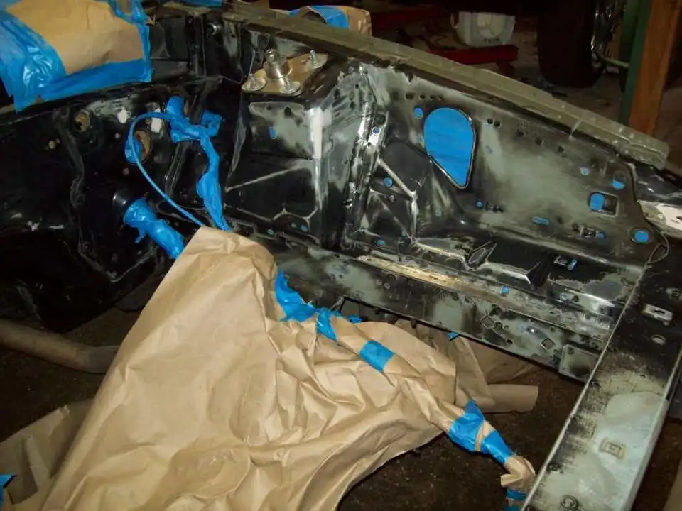

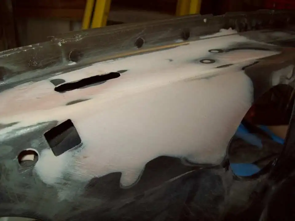

Had a decent size dent/crease here that my friend was able to get looking really good.

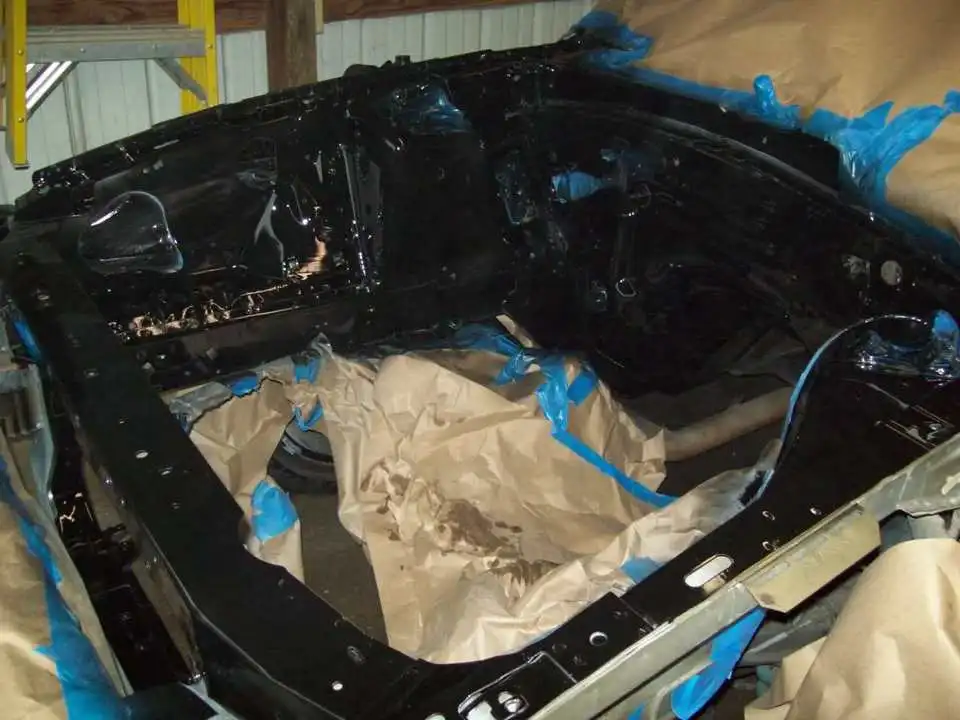

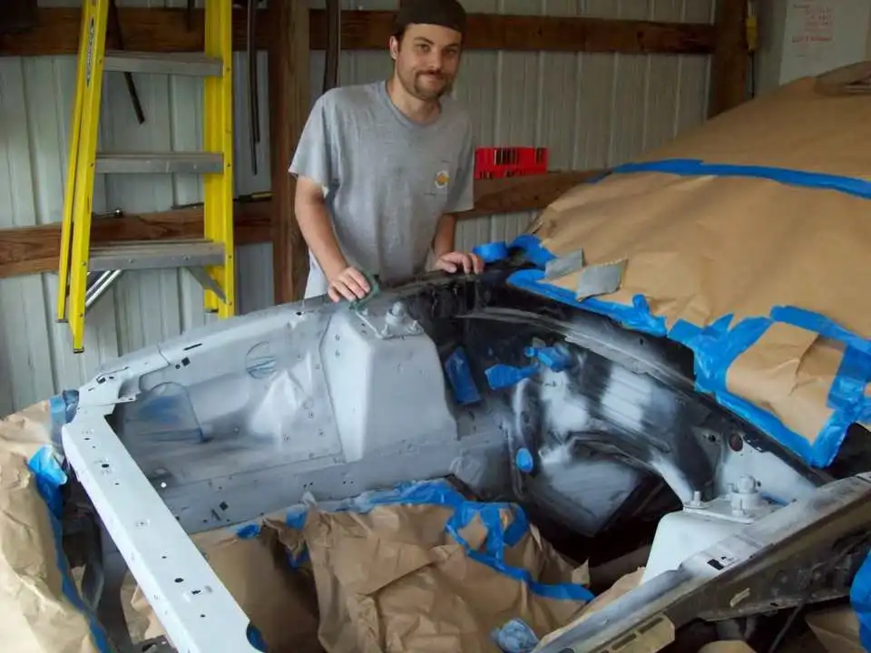

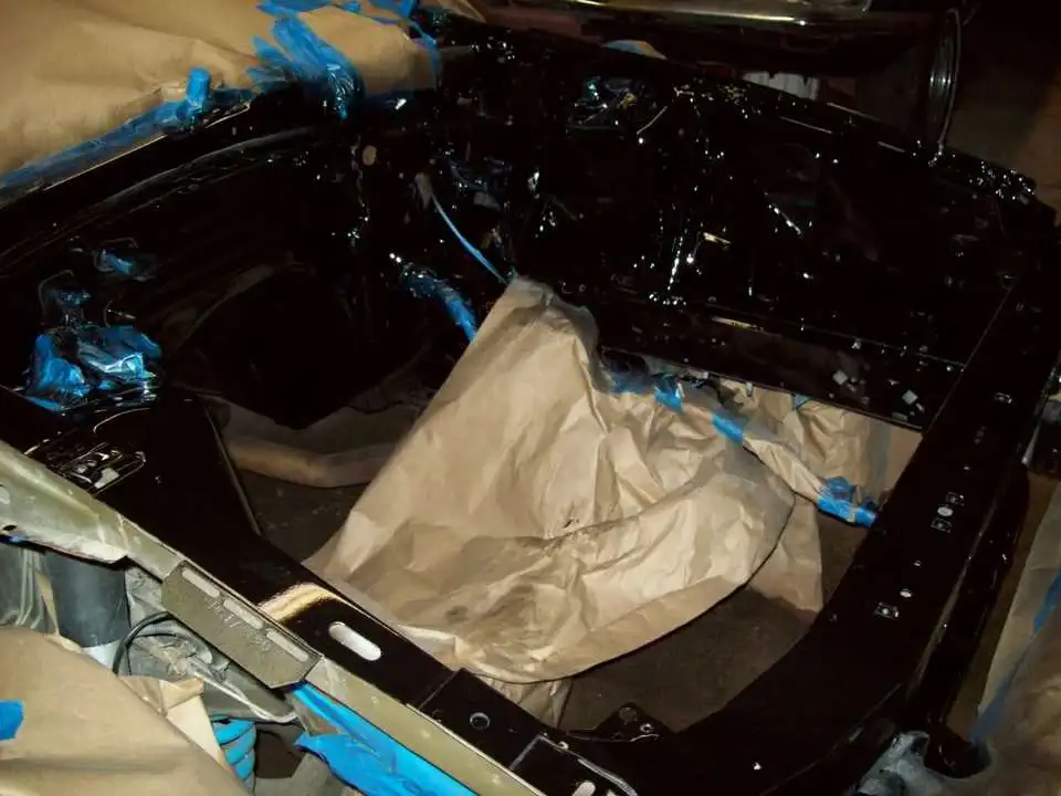

Pretty good week got a good bit of work done. Tomorrow I will get the transmission on the engine and get the harnesses put back together. Going to give the engine bay a few days to cure and possibly wetsand it if it needs it, sort of hard to tell at this time since when I left it was still very soft.

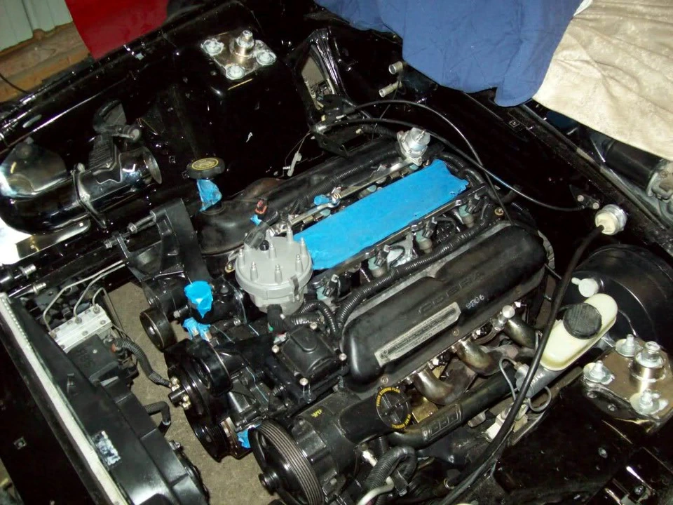

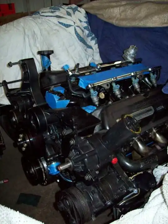

The engine/transmission are now in the car, took me a few days to sort out a issue with the transmission mount, but I ended up finding the missing piece and everything is in and looks good.
Only thing missing from that pic is the upper intake which is freshly powder coated and looks sick (will bolt it on once I get the injector harness sorted out), and my new valve covers which I still don't have back yet. :(
Next big thing is going to be getting the wiring sorted out, I'm also re-looming some sections, re-taping a lot of stuff and hiding/extending some wires.

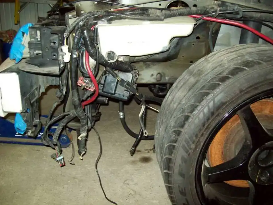

Car now has all the wiring harnesses on but not all plugged in and some still need to be extended.
I moved the fuse block to where it will be hidden in the fender, and I've spent a good deal of my time hiding wires and running everything so it is hidden or out of site within the stock length of the harness, except for a few.

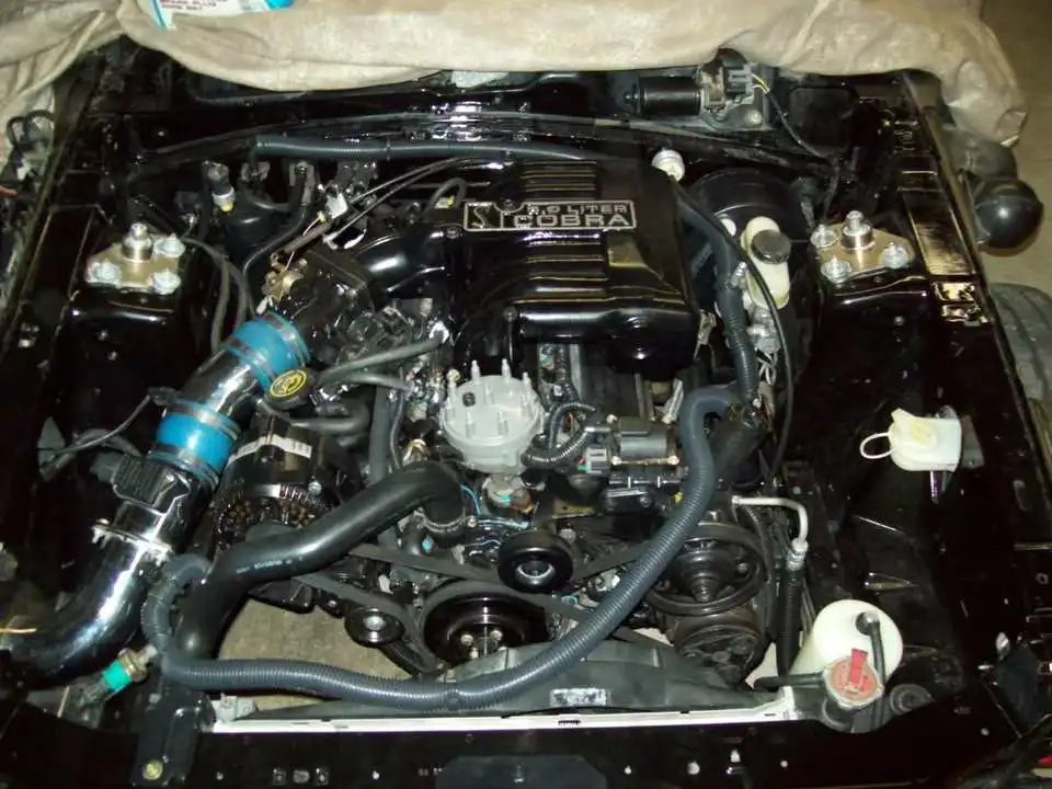

Been awhile since I've done a update, the car is almost ready to start. (Seems like I've been saying that for awhile now...)
Here is the pic of the engine bay now, most everything has been hid or routed as cleanly as possible.
Only issues I currently have is locating the plastic fuel clip for the return line. (Have one coming in the mail which I am hoping is correct.)
And the starter will not work via the key, I have to bypass everything and hit the starter relay and it turns over just fine. (Gonna do some research about this probably make another thread.)

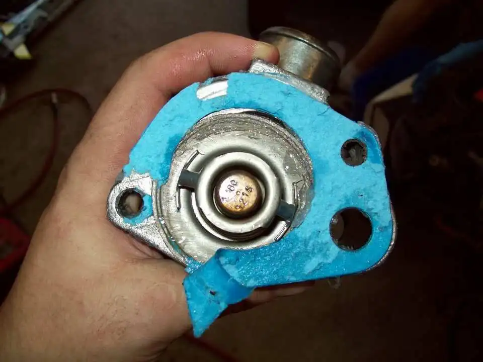

Finally got the fuel clip I needed. So I was able to start the car and run it for a bit, ended up having a leak because the thermostat wasn't in right. (It slid down, what I get for rushing installing it.)
So today I was able to pick up another t-stat gasket and run it longer. Got the timing set @ 14 degrees and the car starts up first time every time no problem, idles great at 800~ rpm with a nice little lope.

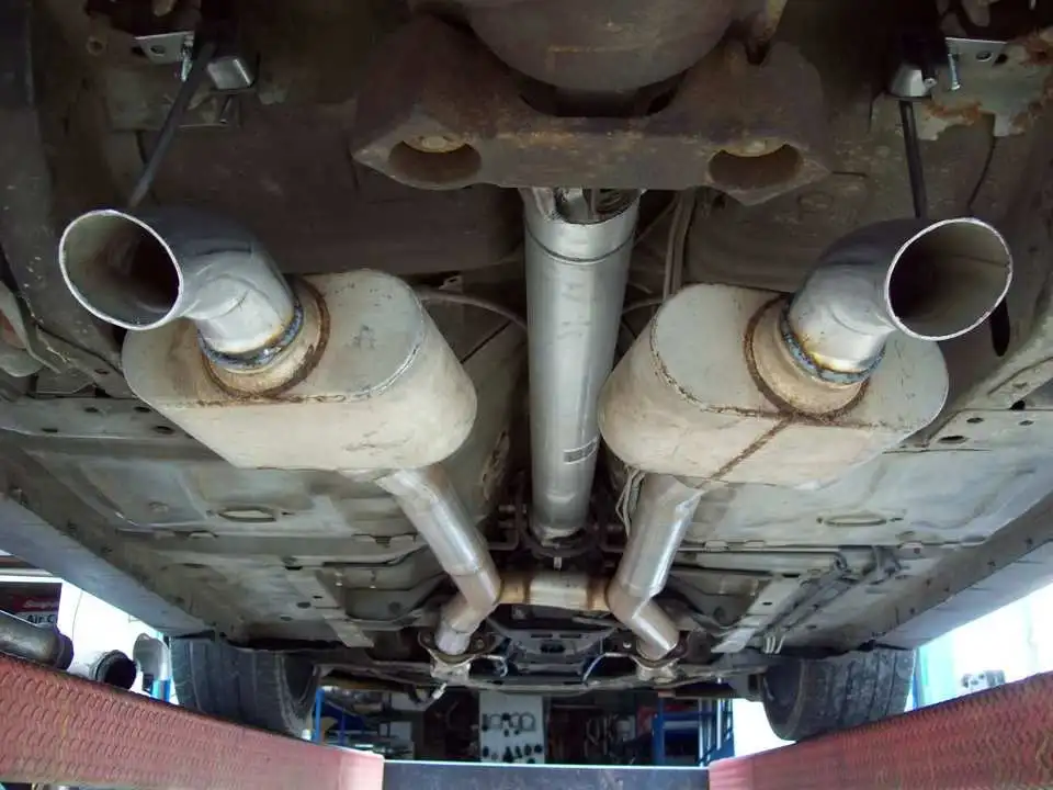

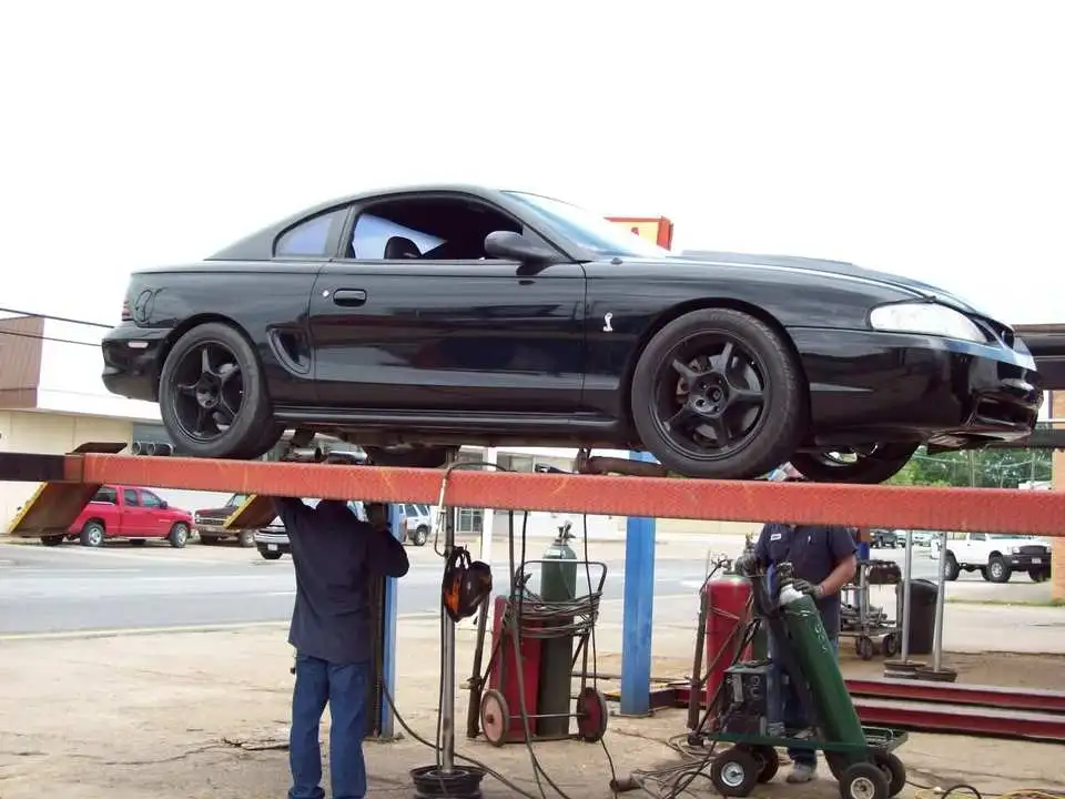

Been awhile since the last update. Today I finally got the car out of the storage and to the muffler shop. Then spent the rest of the day cruising around trying to get the clutch broke in.
Yes it is the A typical Mustang exhaust. Longtubes, H-pipe, 1 chamber flows and turn downs. My previous cars have always been pretty mild when it came to exhaust so I wanted to give something a bit louder a try since this isn't a daily.

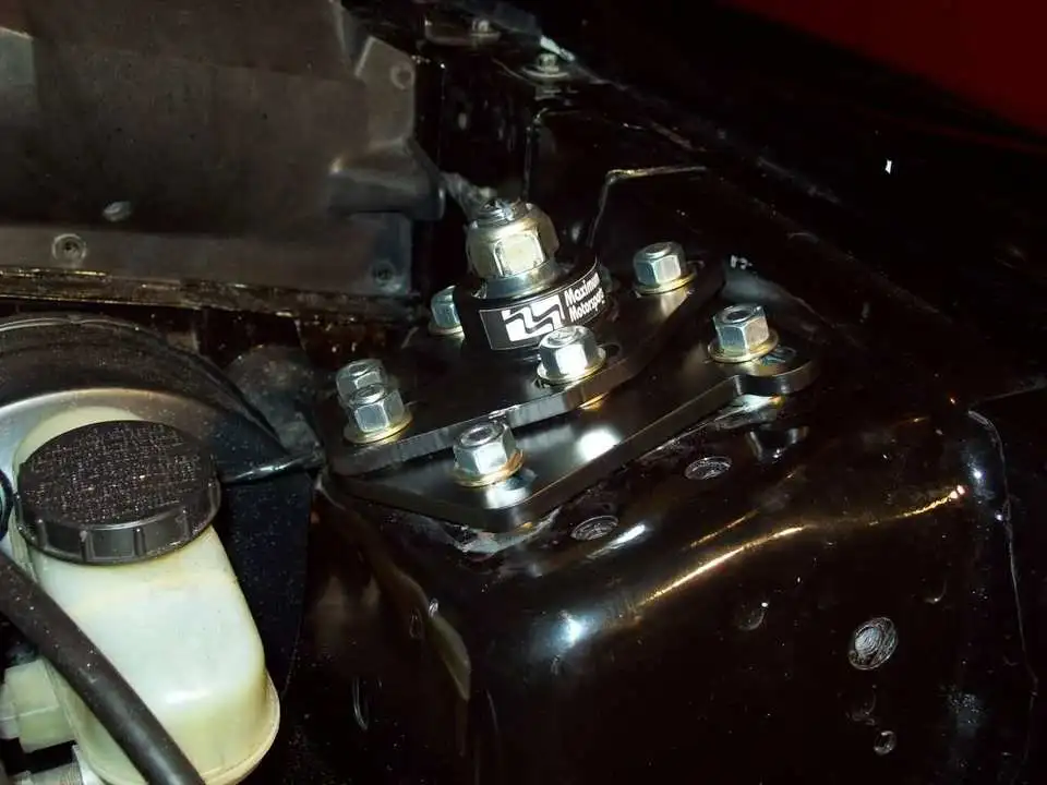

Tried to get the car aligned Wednesday only to find out that the camber plates where "maxed out" this was a little odd but I just assumed it was because the car was so low and they where only 3 bolt plates. Turns out the camber plates that where on the car where installed a bit wrong, think they where backwards/upside down. I went ahead and picked up some MM 4 bolt plates and got it aligned today it drives so much better. Great thing is when the car was put up on the rack the camber/caster was near perfect how we set it up in my garage, just needed toe dialed in.
