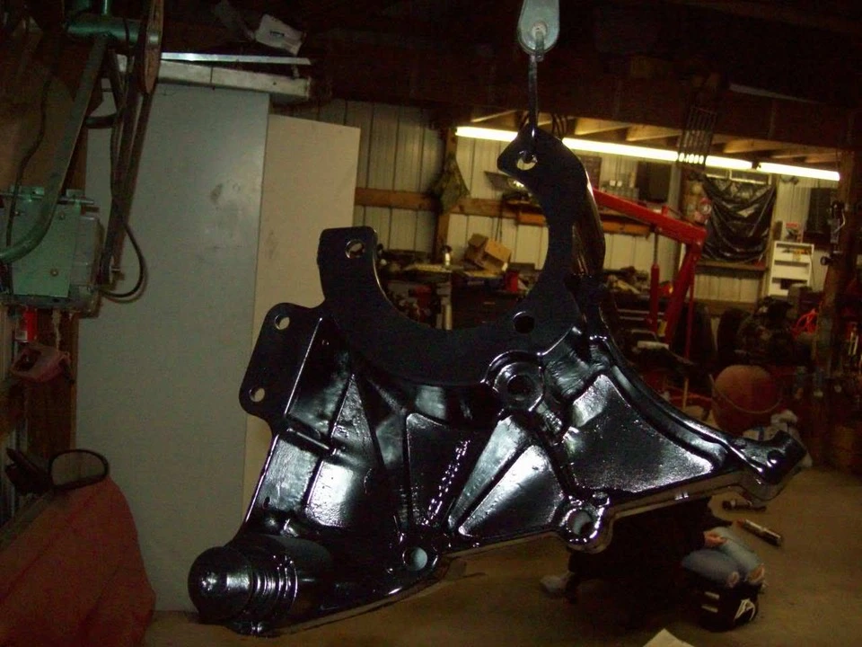

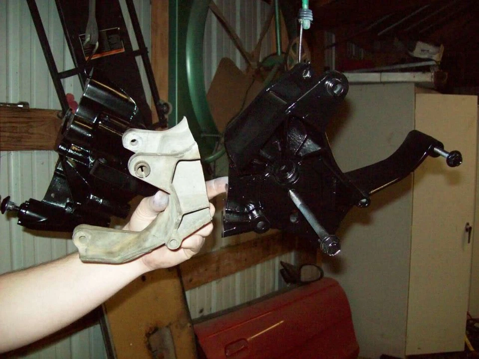

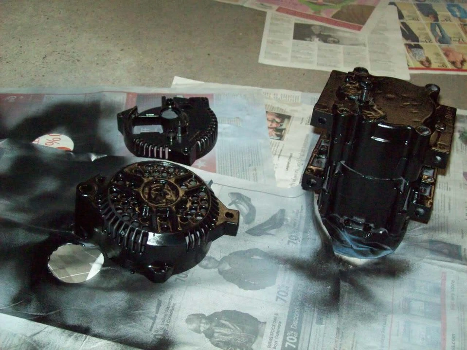

I wire wheeled all the accessories today, and also cut down the bracket that has the alternator on it by snipping off the bits for the smog pump. Will get some pics up sometime after tomorrow when I go back to do more work. :)

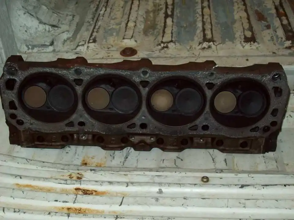

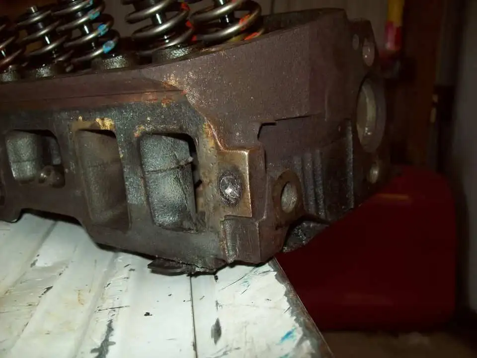

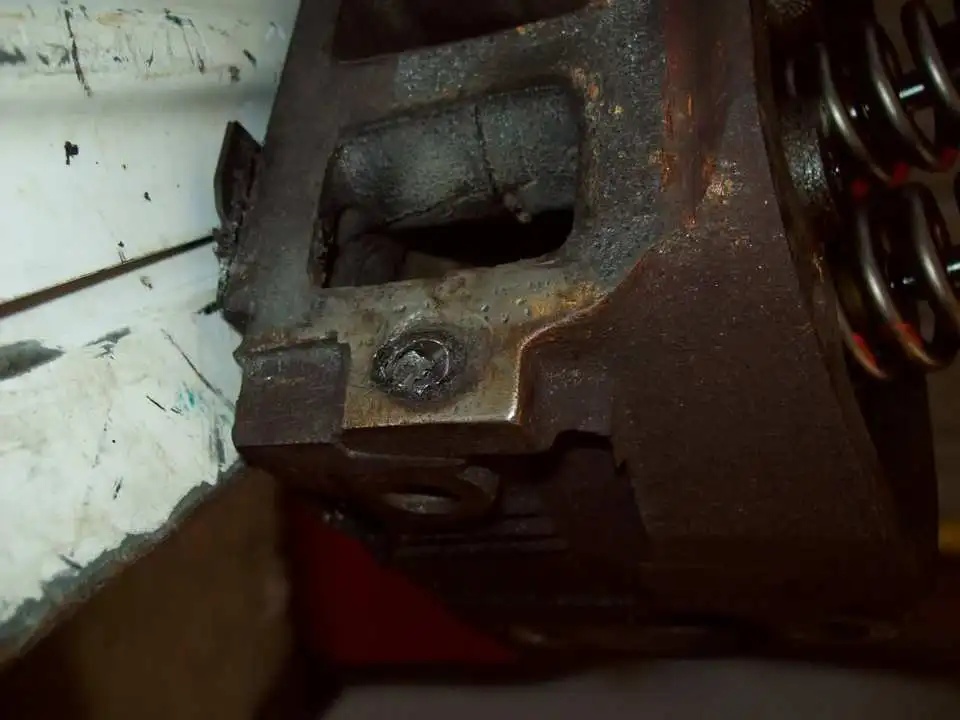

Had to take a step backwards sadly. Had a stuck intake bolt that I've been unable to remove, so today I took the heads off the motor and took the head to the machine shop. The guys at the machine shop aren't sure they can fix it but I will know by tomorrow. Hopefully it will be fixable since I'd rather not buy another head.
If the heads are salvageable I am going to have them rebuilt and a valve job done just to freshen them up.

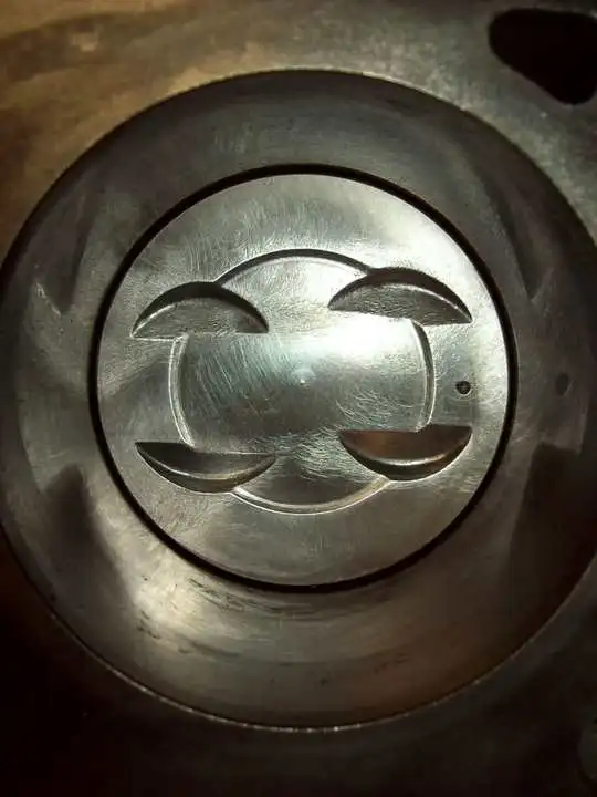

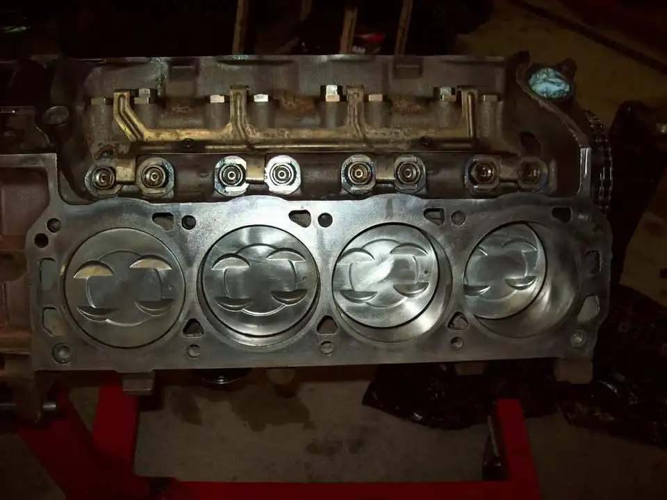

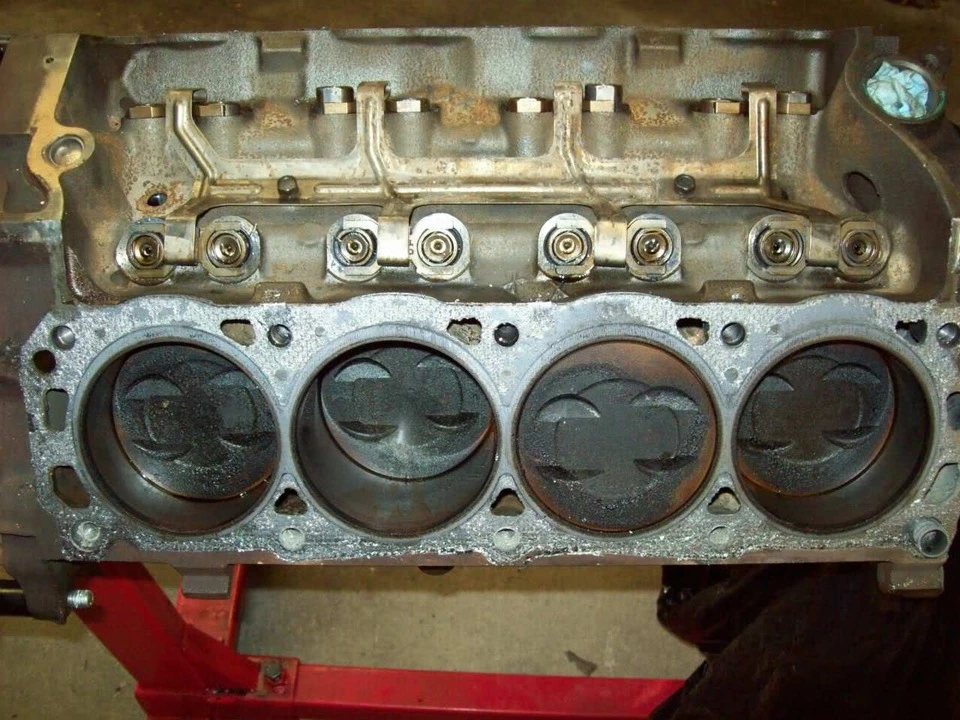

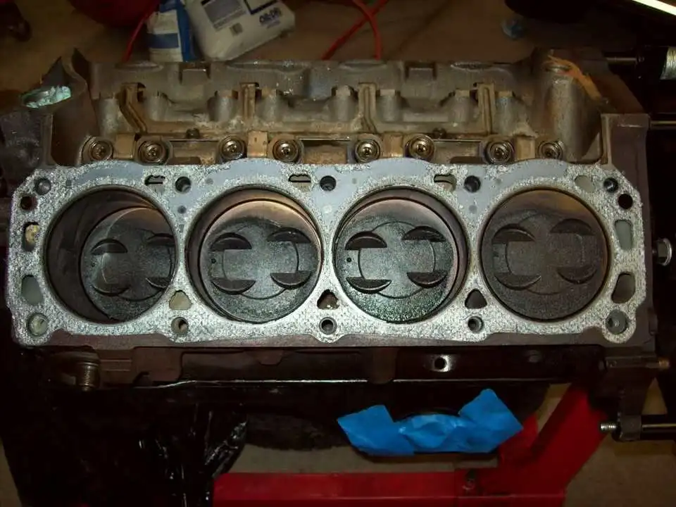

The cylinders and pistons look to be in good shape, still has crosshatching on the cylinder walls.

Also cut down my alternator bracket, no need for the smog pump bracket anymore.

they should be able to extract it. if not they can always drill it out and helicoli it i would think.
I really hope so. I don't want to track down another set of heads, and it is really hard to justify spending money on stock heads when aftermarket heads tend to be a lot better. (Plus I have a cam that matches my stock heads so It kind of irks me to change heads and never even use that cam...)

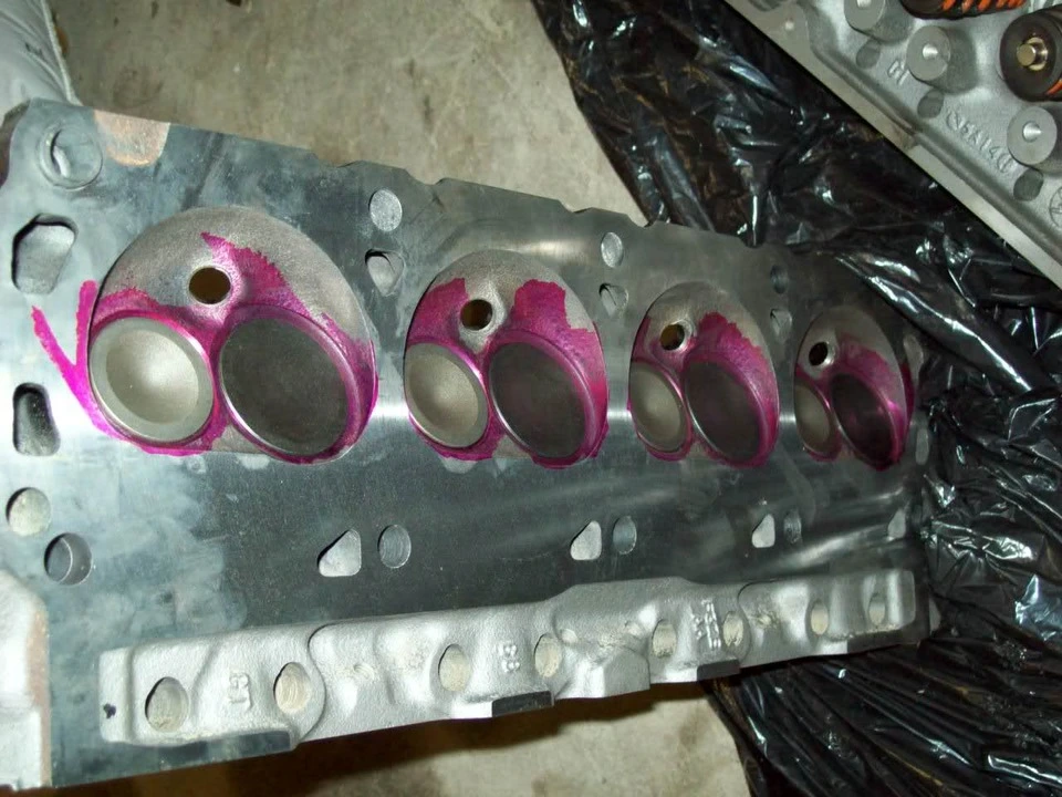

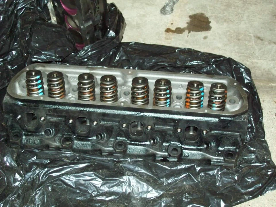

I got the heads back last week, but I had to wait on some headgaskets to get shipped out.
They look all shiny and new now, I ended up having them rebuilt for good measure. The 1 hole that was a problem is only slightly buggered up but I plan to put some studs in and it will no longer be a issue at all.
Cleaned up the pistons, head gasket surface, and the cylinders also.

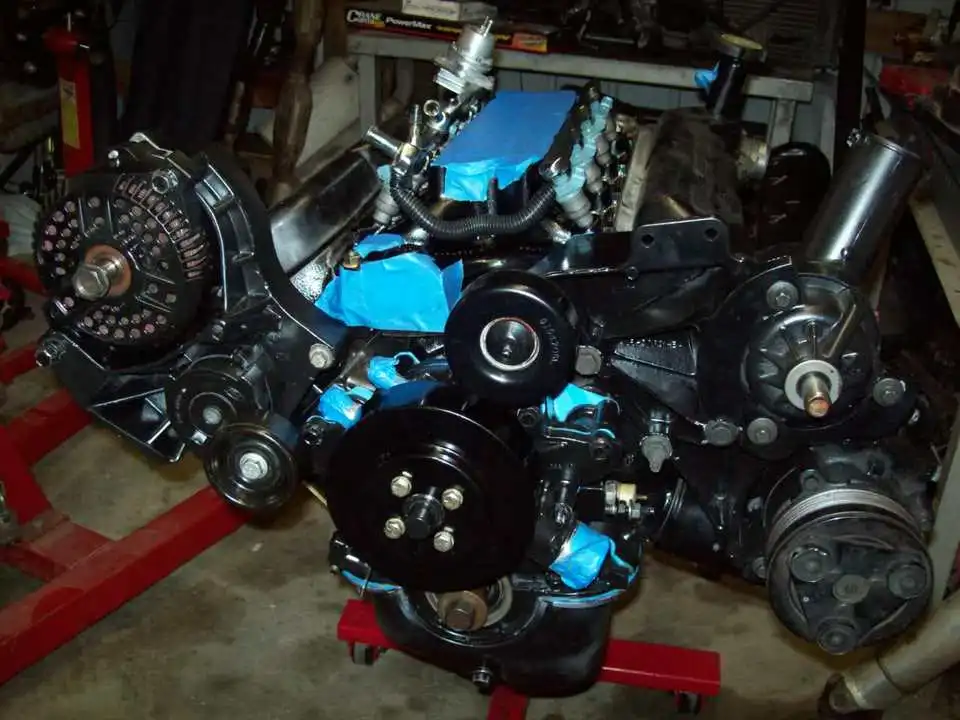

Front brackets and accessories are on now.
Still need intake, but have to order new bolts or studs and wait for it to get back from powdercoater.
Still need oil pan, but I am going to wait until I can change the rear main seal and it needs paint also.
Still need motor mounts, but I've misplaced the bolts trip to hardware store is in order.

What did you use to cut the Alternator/Smog pump bracket?
I was going to remove mine and do the same thing you did but not sure what to use to get a clean cut.

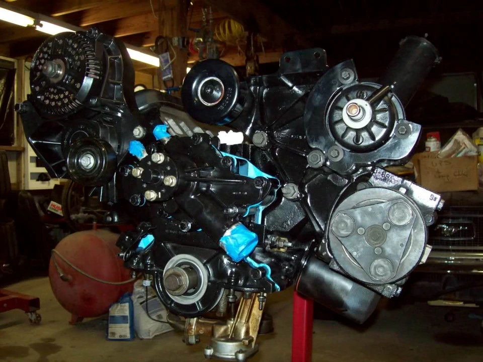

The motor has come along a little, almost complete. Mostly waiting on my powder coater to get me my Valve Covers and upper intake now.

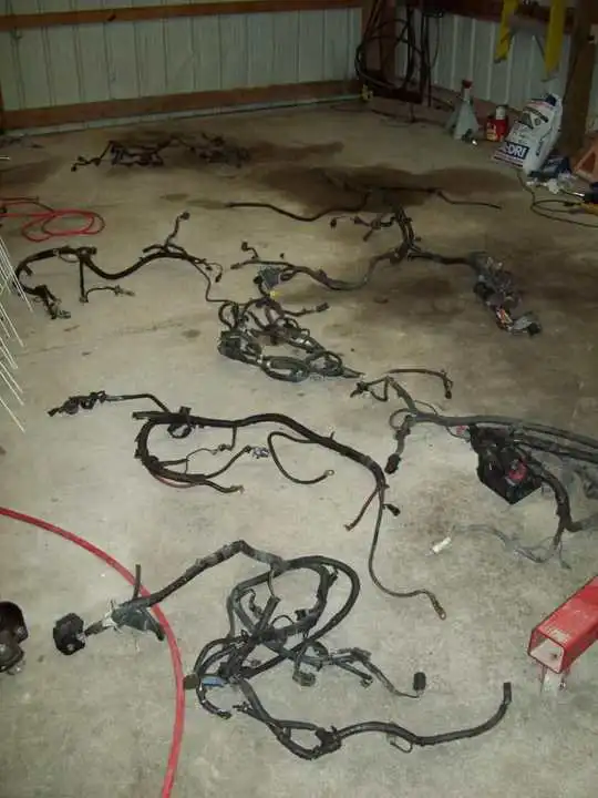

Spent some time sorting out which harnesses I want to use. (I have 2 sets) And started cleaning/cutting up the one I wanted to use plan to put some new loom on the engine harness since it was kinda dry rotted and covered in oil.

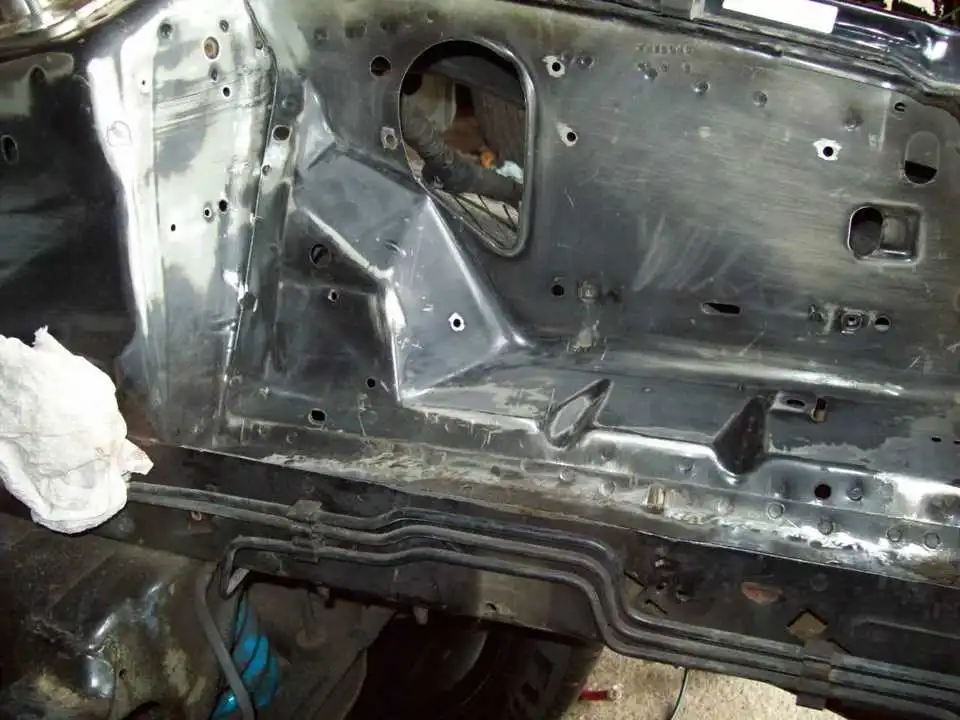

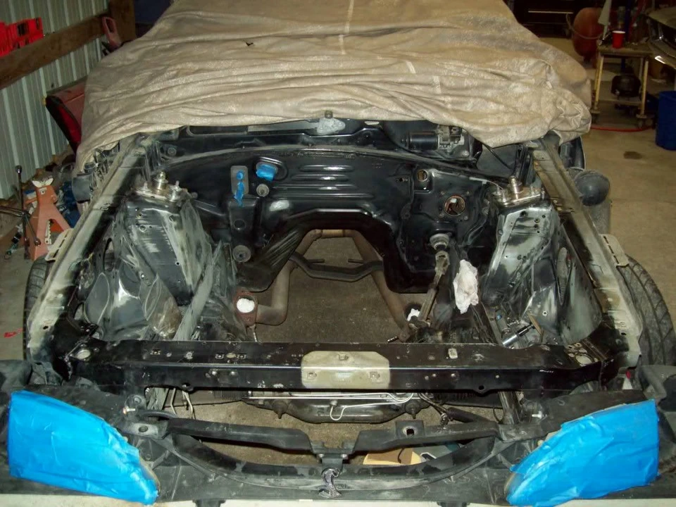

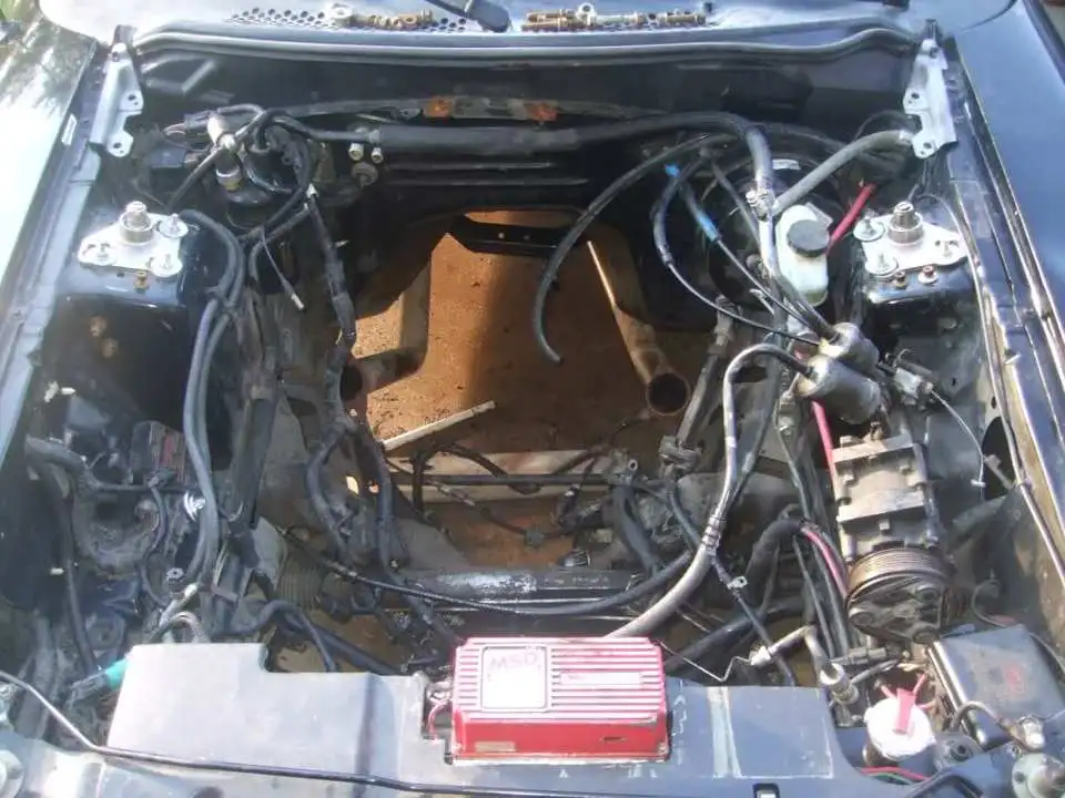

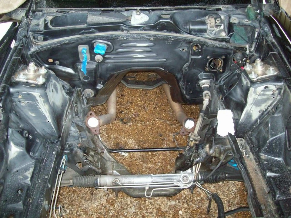

Been working on the engine bay, I already have the paint just need to get the body work part out of the way. Here is a before and where I am at now more or less.
Hopefully I can get the engine bay knocked out in a timely manner... :shrug:

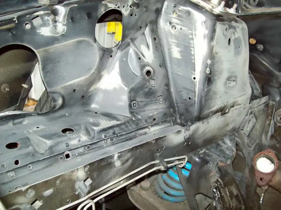

Most of the sanding is done, tomorrow I will be doing the filler and finish sanding a few spots.
Went ahead and took the fenders/bumper off so I can work easier, planning to hide some wires anyhow so guess I needed to be done...
