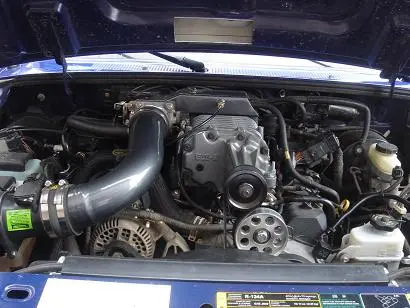

All together now

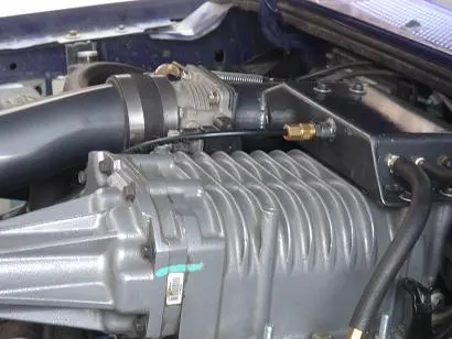

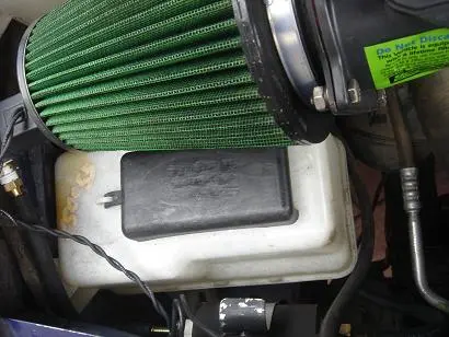

pump, solenoid, resevoir, and a rice filter... kidding, the only filter to buy, We're Goin' Green!

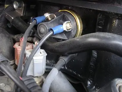

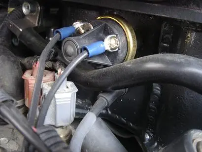

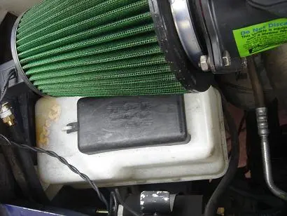

Pressure sensative switch for methanol injection
Boost and fuel pressure gauges. Peaks around 13psi.

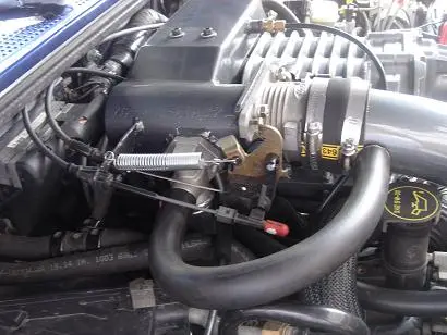

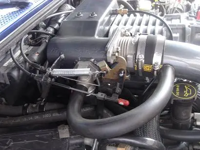

Mustang IAC retro fitted for our use of the Mustang TB

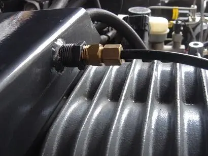

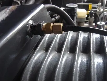

A little juice at 4psi does the engine good

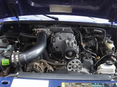

My favorite picture

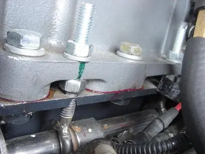

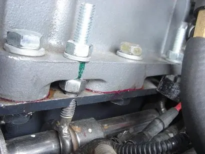

Rays rail mount system. Genious.

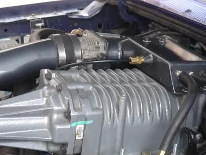

Let me know what you guys think. Im very proud to be the driver of one of the only M112 Rangers in the country, I know of only 1, maybe 2 or 3 others. Its not an easy task to accomplish. Since the base of the blower is wider than the fuel rails, the blower must sit to high that it clears the rails, while still clearing the hood. the new hoods dont dome as much, an M112 would never fit, we even had to notch the hood for clearance.
