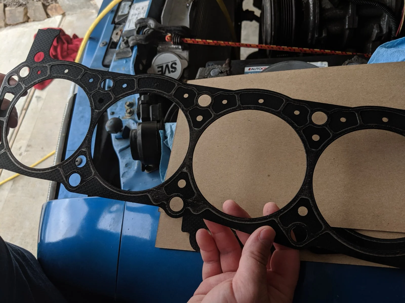

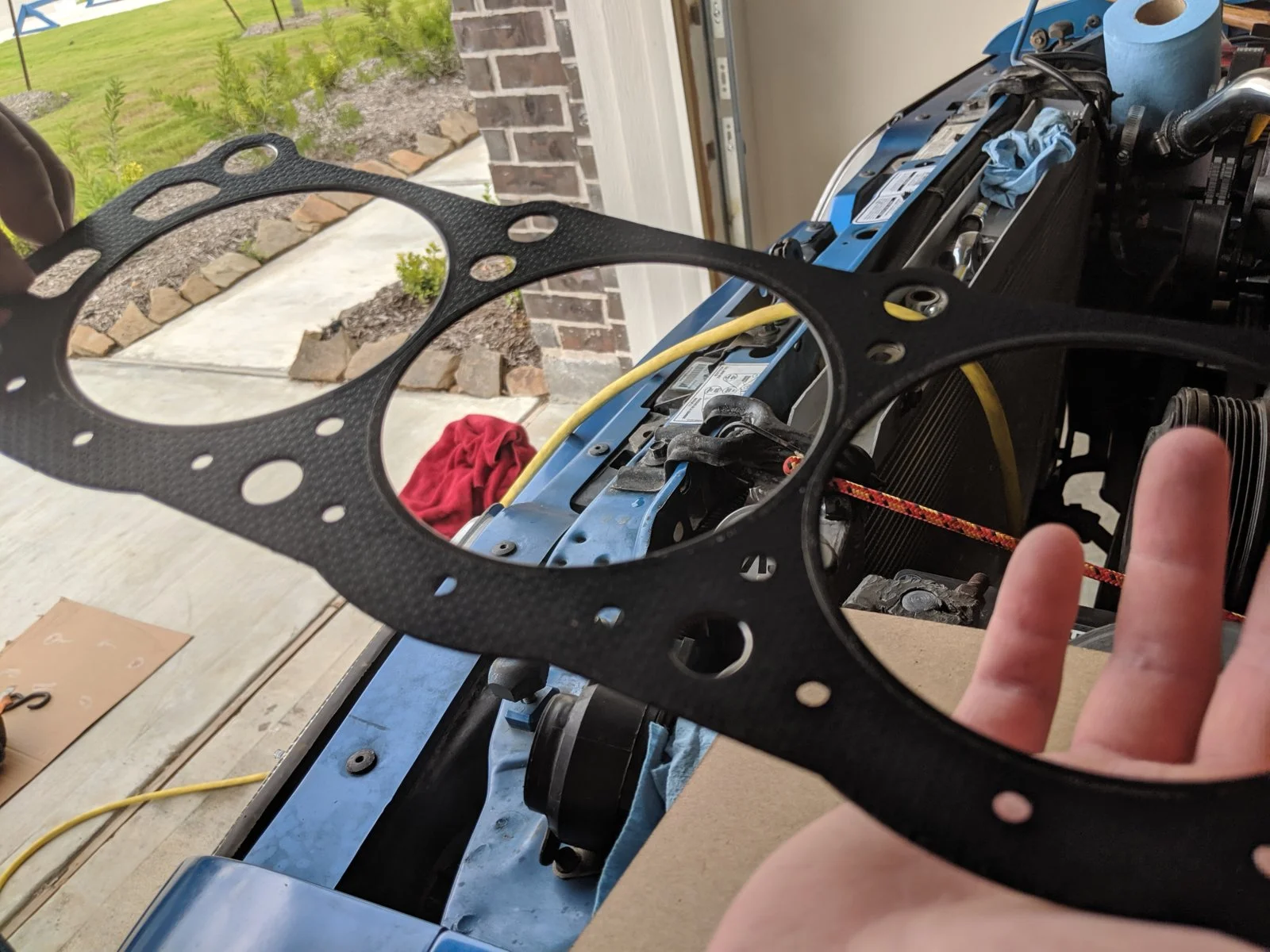

What is the top and bottom of a head gasket
They are supposed to be the same. That’s why when they’re on each side correctly, it looks like one is upside down. But they’re not. Don’t look at which side is facing up. Just make sure the water jacket holes are in the back on both sides. Just like the dude in the video shows. And if they’re marked “front” keep that to the front. The word “front” will be facing up on one side, and facing down on the other.

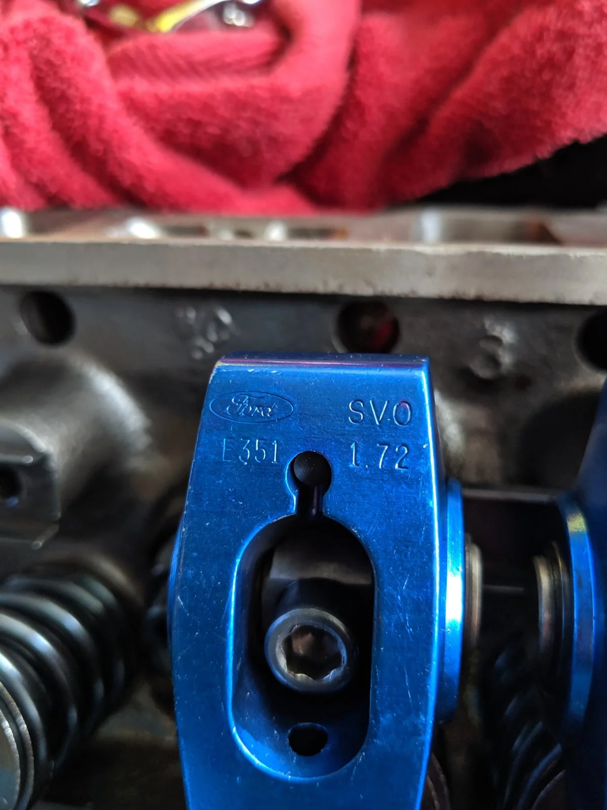

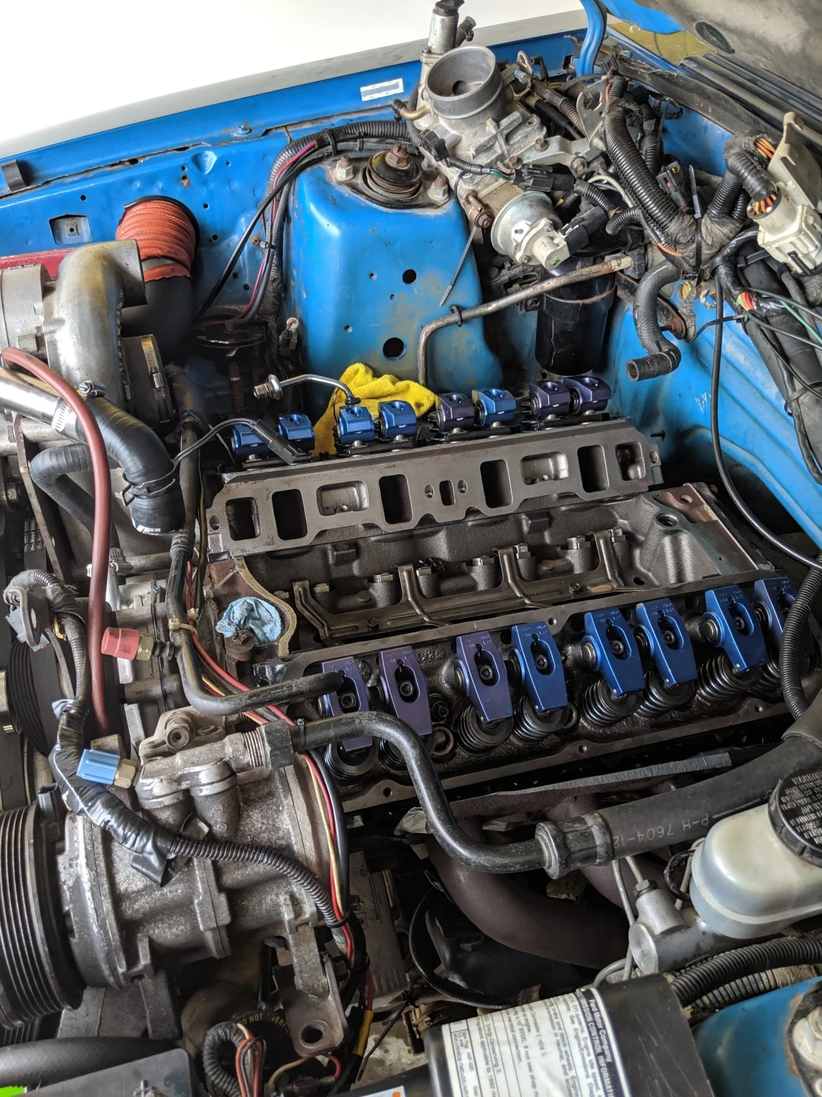

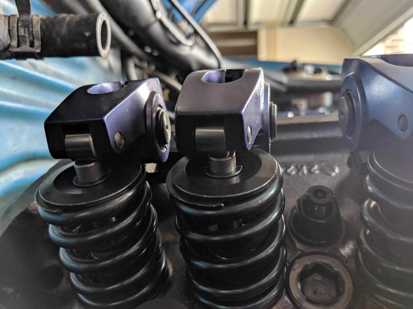

Two of the rocker arms are not square with the valve so I'm gunna loosen them up when I set the rods in and try and straighten them out.
This is how the passenger head is for reference.
And now begins trying to figure out how to properly set the valve lash.
So far I gather that you tighten down on the rocker arm stuff when that cylinder is at TDC. Then keep going until the push rod stops spinning, then tighten down 3/4 turn past that

I'm stumped....I've triple checked. The intake push rod is still spinning and there is a smidge of lash I guess you would call it. As in after I tighten the rocker snugged down, there is still a small gap between the roller pin and top of valve. I can not get it to stop.

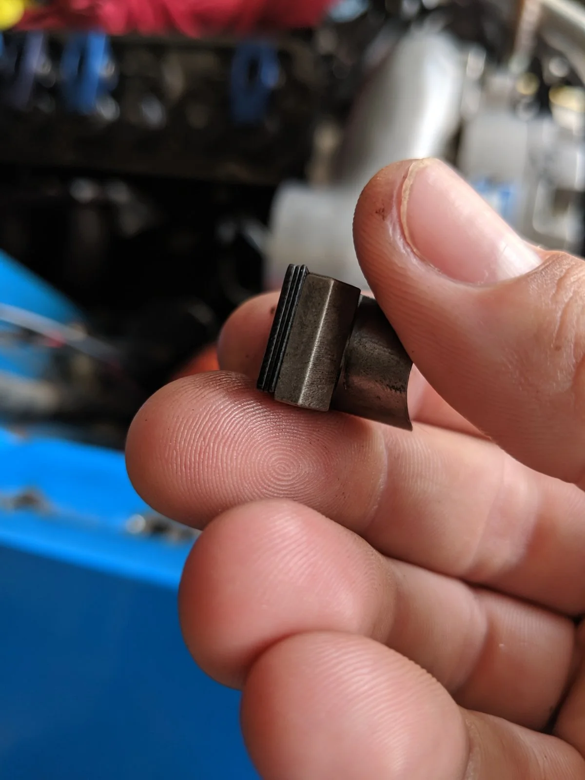

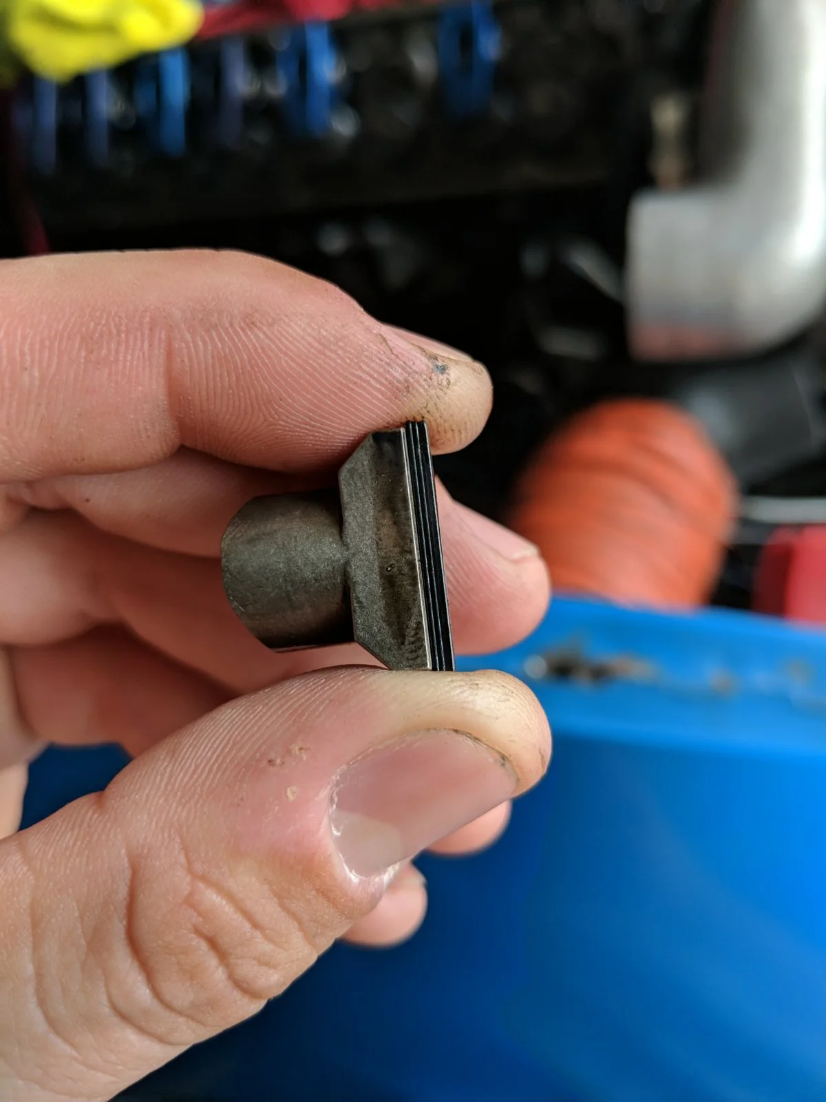

I notice there are shims under a little silver pedestal. If memory's serves me right, I see numbers of .030" and .060". I have mixture of both. Every rocker arm seems to have a different assortment of them but the first picture is shim stack on exhaust side.
Second is intake. Do I need to remove shims to get the lash out?

This just hit me....but are GT40 heads apart of a 351 engine?
Rockers are E351...
And would machining these heads require me to use more shims if they removed material
Whole new ball game now. I thought you were working with stud mount adjustable rockers. Those are pedestals you have in your hand. Completely different setup.
Did you gather these parts or was this a functioning assembly to begin with? Im trying to make sure you have all the right compatible parts.
