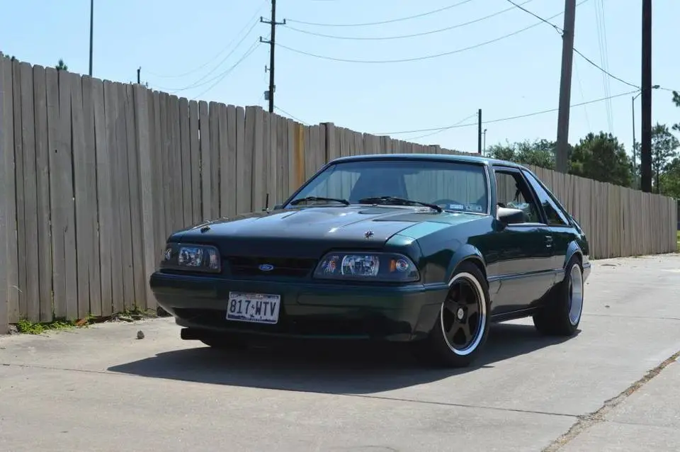

So the work has commenced! I took off the carbon fiber hood, and replaced it with the stock hood.
I can live with the scratches and dings on the hood till I get a paint job which is like a year or two away.
Before:
After:
Now I have to fix the leaky radiator, and get seats. Will update thread as i move along.
Don't worry guys... the headlights are on the list. Pretty low on the list right now, but I do plan on replacing them at some point.

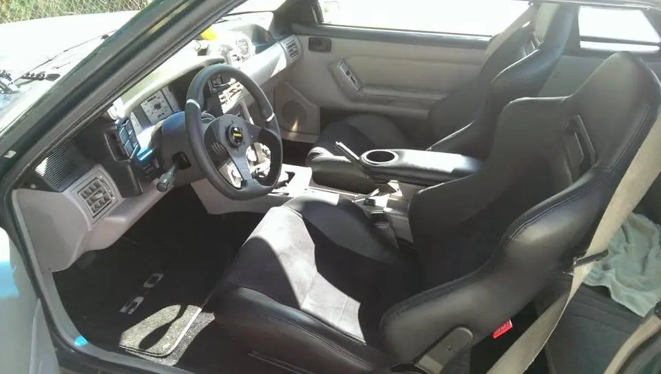

So I just installed a new steering wheel, I think it looks awesome and will match my new seats pretty well. One problem though, when driving down the road the steering wheel is off center to the right, guess an alignment is the only fix?
Pulling off the stock steering wheel was fun, would have loved to install the seats, but american muscle didn't include any hardware for the seat brackets..... so these will have to wait to be installed till later

Sharp car, brand and size of rims/tires? I've got same headlights on mine, they suck p/o hacked the wire job and the fitment is crap.
Sorry I didn't reply sooner, missed your question. The rims are 17x8 and 17x10.5 with 235/45 in front and 275/45 in the back.
I know what you're talking about with the wire hacking on the headlights. Poked around and saw the original wiring cut, so I'm putting that off for a while.
Yeah, definitely better off with those seats than what I have, hahaha. How do you like those? I would like to get something similar since I dont have the money for Kirkeys right now
How do you like the new Steering wheel? Does the airbag light come on?

The airbag light did come on,no beeping though. Still have to find a way to turn it off.
I just installed the seats, and I like them, they are pretty stiff and don't have much cushion, but the are comfortable. They feel sturdy and solid.

As far as the wheel being off center, if the old wheel was centered properly, then you were a few splines off when you mounted it. You can either pull it back off and try again, or loosen the tie rods and center it that way

Pull the airbag fuse or the bulb in dash. Only thing is I've seen aftermarket wheels on 90+ cars and I don't like that huge gap between the wheel and the column, plus I want to keep the airbag for safety,insurance reasons and CC. The only guy I know who made brackets for the CC stopped making them years ago. Guess you can either fab up a bracket or mount the CC switches in the dash or console. Other option is to swap in a 89 or older column as they don't have airbags and the connections are easier for the horn . Plus you can get tilt.
