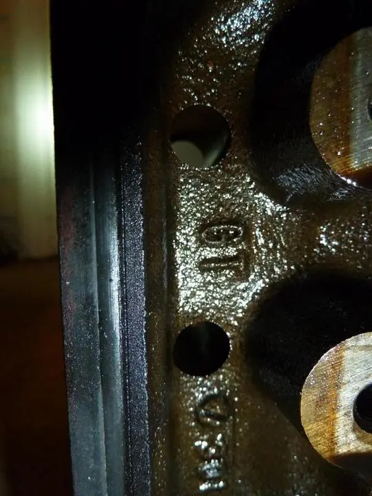

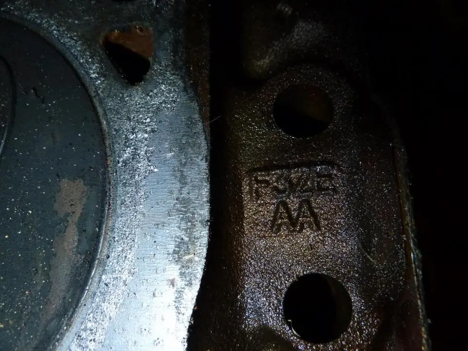

Can you do me a favor and list the part number for the head and tell me if it has thermactor ports? This is more for my own knowlege
Casting # F3ZE
AA
These are the real GT40's. Found only on Cobras and 96 Explorer only. (From what I've heard)
I don't know what thermactor ports are. Do you mean the smog tube connections? If thermactor ports are the smog tube holes, then no, they don't have them.

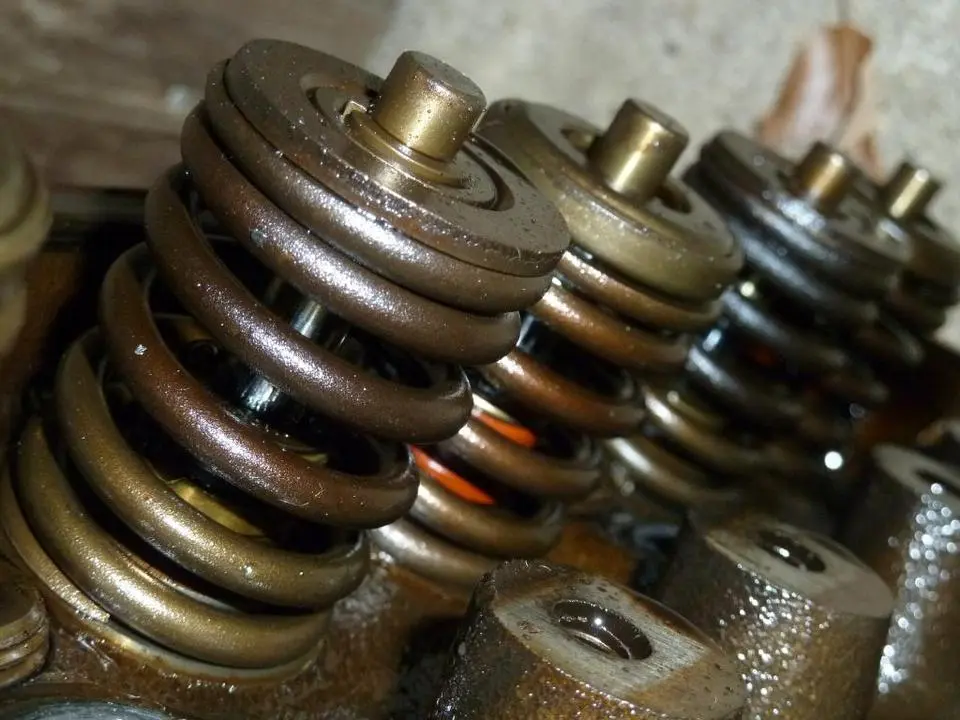

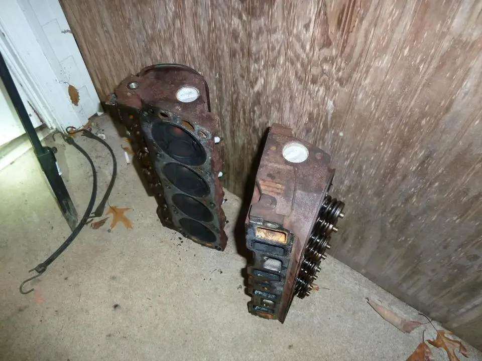

Heads look decent. 134k was on the ticker. The valve tips show no wear. None of the valves are stuck. Valve faces have good margin at edge so I doubt the valves or seats have ever had a re-grind. After I clean the valves and seats, if they look good enough, I may just lap them with valve grinding compound.
