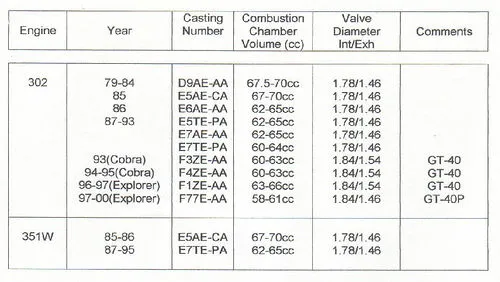

Chart shows the larger chamber volume of the 96 explorer GT40 heads when compared to the 92 E7's
Interesting, this chart says my F3ZE-AA's are from 93 Cobra. I wonder if the head I got are not original to the '96 Explorer I took them from.
Casting # F3ZE

These are the real GT40's. Found only on Cobras and 96 Explorer only. (From what I've heard)
I don't know what thermactor ports are. Do you mean the smog tube connections? If thermactor ports are the smog tube holes, then no, they don't have them.
Yes, the smog tube connections. There are a few versions of the GT-40 head. You are correct that that head is found on the 96 explorer and Cobra, but it should be a 94-95 Cobra head. the 1993 Cobra WILL have the thermactor bumps.
