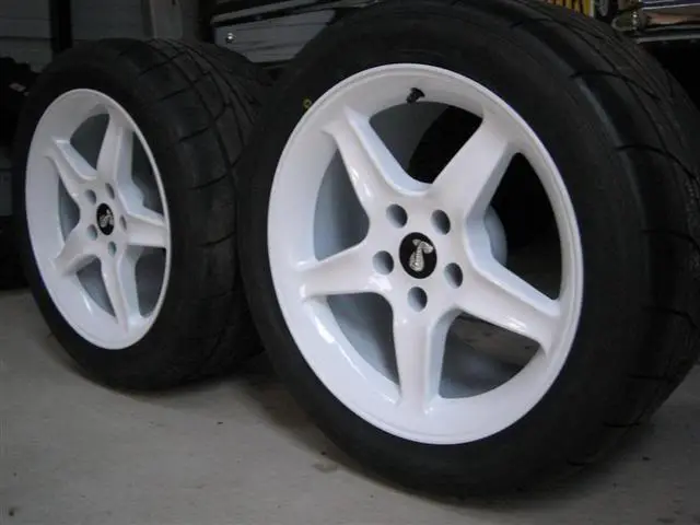

i have 17x10.5 Cobra R's on mine and i run a nitto nt555r 315/35/17 i put some pics below..
old pic of them on my car.. keep in mind my car isnt lowered :(
pic of when they were just mounted..
maybe that will help a lil, if not oh well!! :)
