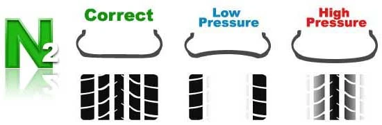

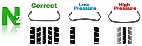

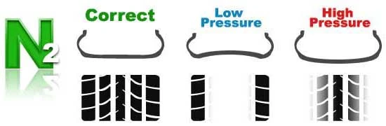

...and stop letting air out of your street tires. That only makes matters worse. Run them properly inflated.
You are incorrect. Always take air out of the rears, even street tires with stiffer side walls. But he is running drag radials.
OP, practice is your best bet. Learning how to slip a clutch on drag radials will help you out a lot. You don't need a tune at this point but it might help with advancing the timing a bit. Most 2v's run good with standard bolt ons. Practice. Practice. Practice.
This is what I'm referring to:
I saw no mention that his tires were DRs before posting that. o_O
I still tend to agree more with your line of thinking than the 'let air out' side. Because of the weight transfer to the rear tires, I understanding letting some air out so that that low pressure then becomes the proper pressure with the extra weight load. I feel that that's relative to how much power the car is making and the corresponding weight transfer. The 275 radial racers around here run at least 13-14 psi, and that's with a LOT of weight transfer. Also, the stiffer the sidewall, the less air that needs to be taken out. FWIW, I've never run less than 25 psi in my Nittos, and have never had problems on a track with any kind of decent prep at all.
