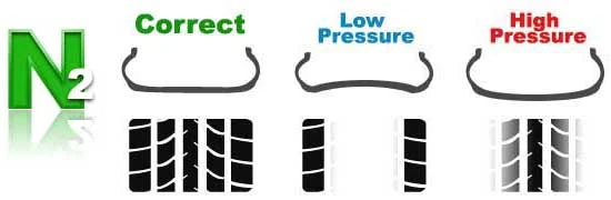

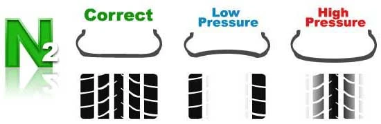

This is what I'm referring to:
I saw no mention that his tires were DRs before posting that. o_O
Doesn't matter. I like your 6-7 year old illustration though. Stiff sidewalls will still benefit from a lower psi on a sticky track.
What difference does it make how old the photo is? :shrug: Fact is people the make mistake all the time of deflating radial tires to the point where 60 foot time suffer as a result. Granted, I didn't see mention that OP was running DRs initially and yeah, I get it that they're tires designed for that sort of thing. The point is that every redneck with 100 HP seems to go out and try to run street tires like they're a set of Mickey Thompsons. Deflate a set of street radials to the point of the second image in the pic above and you're pissing in the wind.
You'd get more traction from an all season tire by siping the tire than you would from letting half the pressure out of it.
What difference does it make how old the photo is? :shrug: Fact is people the make mistake all the time of deflating radial tires to the point where 60 foot time suffer as a result. Granted, I didn't see mention that OP was running DRs initially and yeah, I get it that they're tires designed for that sort of thing. The point is that every redneck with 100 HP seems to go out and try to run street tires like they're a set of Mickey Thompsons. Deflate a set of street radials to the point of the second image in the pic above and you're ****ing in the wind.
Meh, I guess our 2 extensive racing backgrounds on both street tires and also drag radials differs. I know what works for me and what I have done setting ET records, so to each their own.
