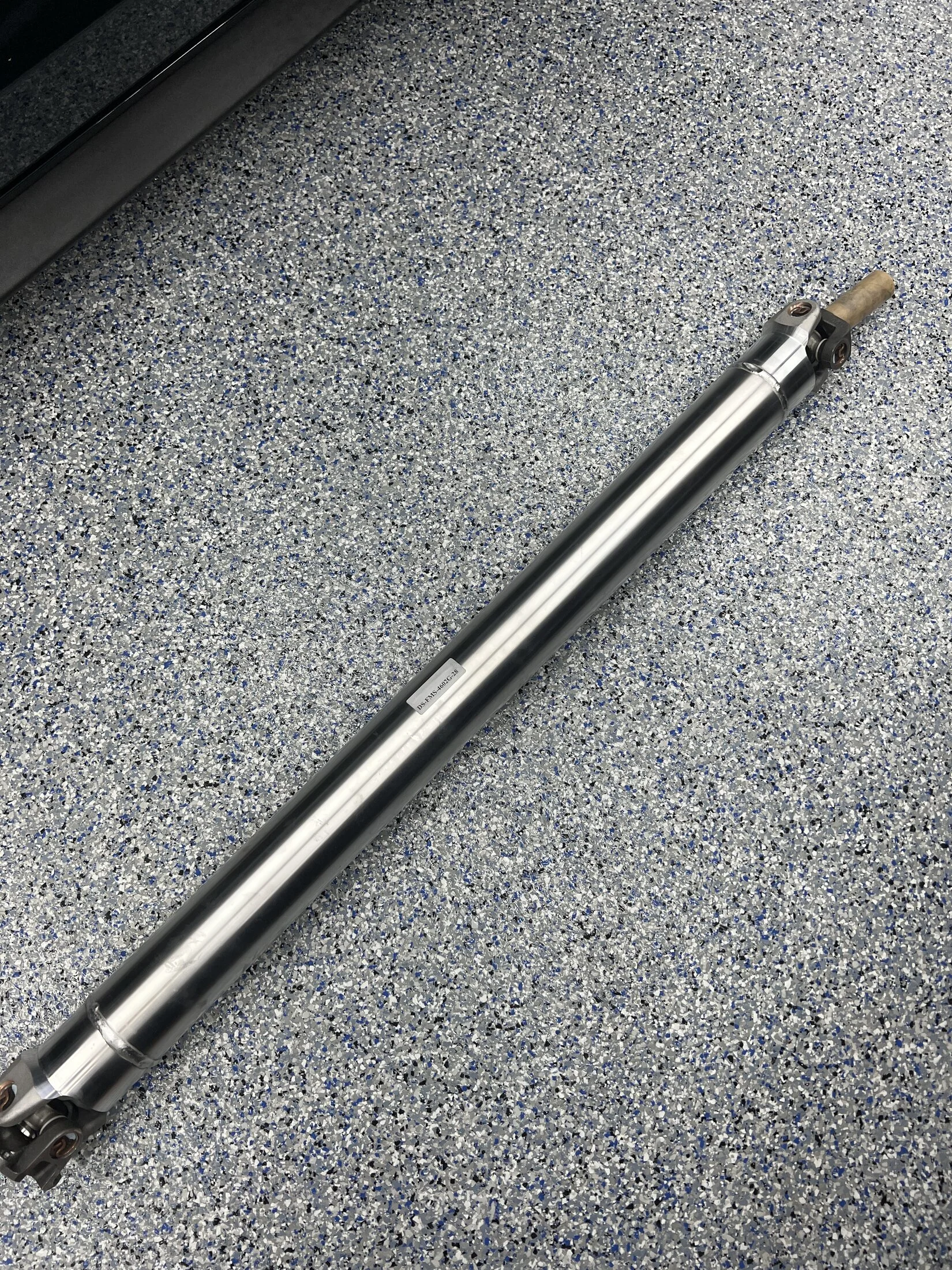

For everyone wondering yes the summit racing driveshaft is just a repackaged ford racing shaft. I’ll be putting it in tonight.

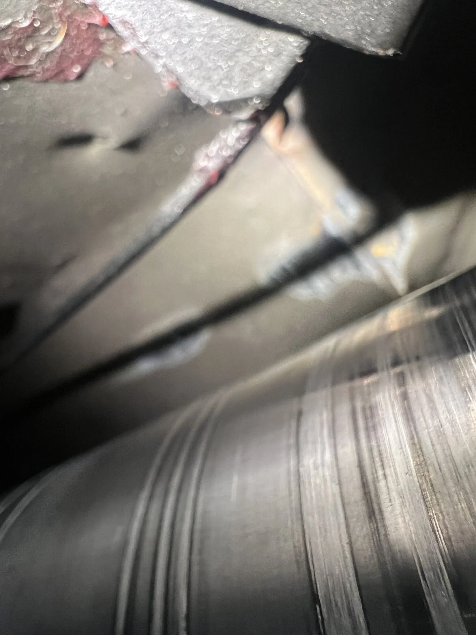

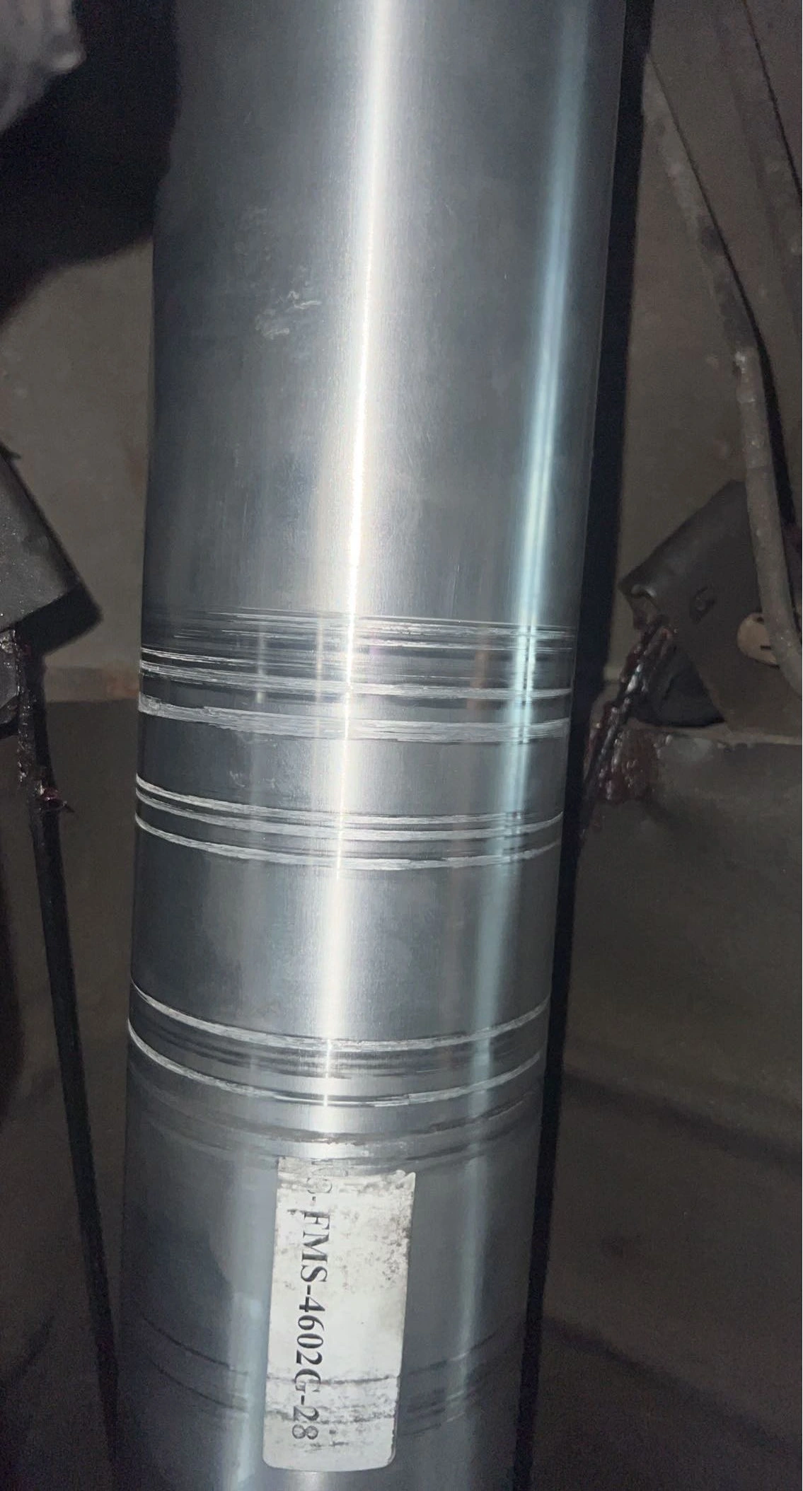

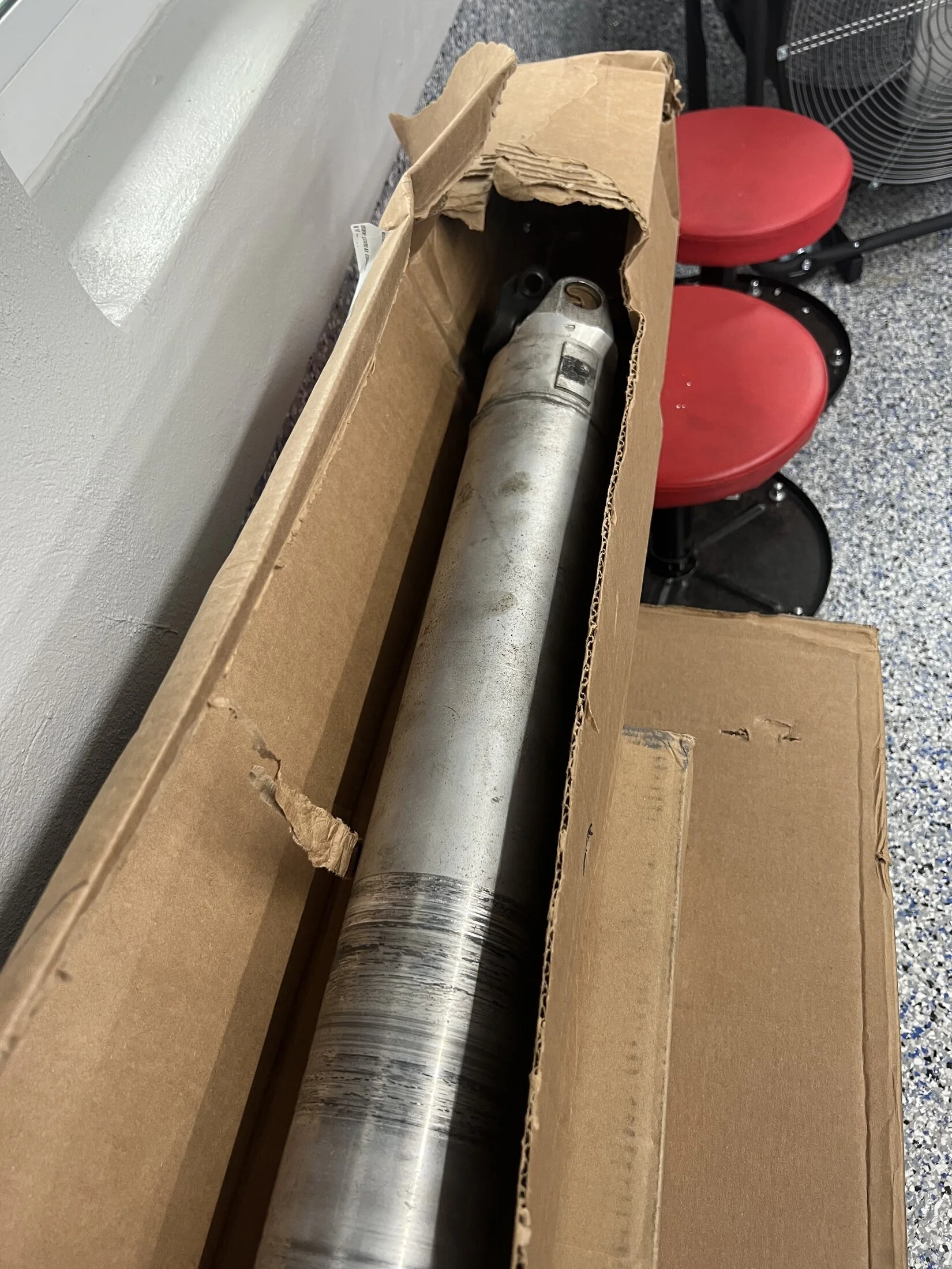

Got the driveshaft in last night, fixed the rattles. After the first drive I noticed the driveshaft got some scoring on it from the e brake cables, my old DS had this as well. Is this something to be concerned about or is it harmless?
As you can see in the pictures my old driveshaft had been in the car for who knows how long and the scoring never got any worse than minor surface scraping so I think it’ll be fine but let me know.

Rebuild the old one, then have it balanced, without rerouting the e brake system for.more clearance all most every fox body will have that issue with the 3.5" shaft. I think it was 93 when they changed the routing design of it a bit.
My 93 scrapes the FMS aluminum DS but the car has coil overs and is fairly low. You have to really compress the suspension to get it to scrape.
Check and see if the bracket that the rear ebrake cables snap into isn’t bent up or has pulled the spot welds.

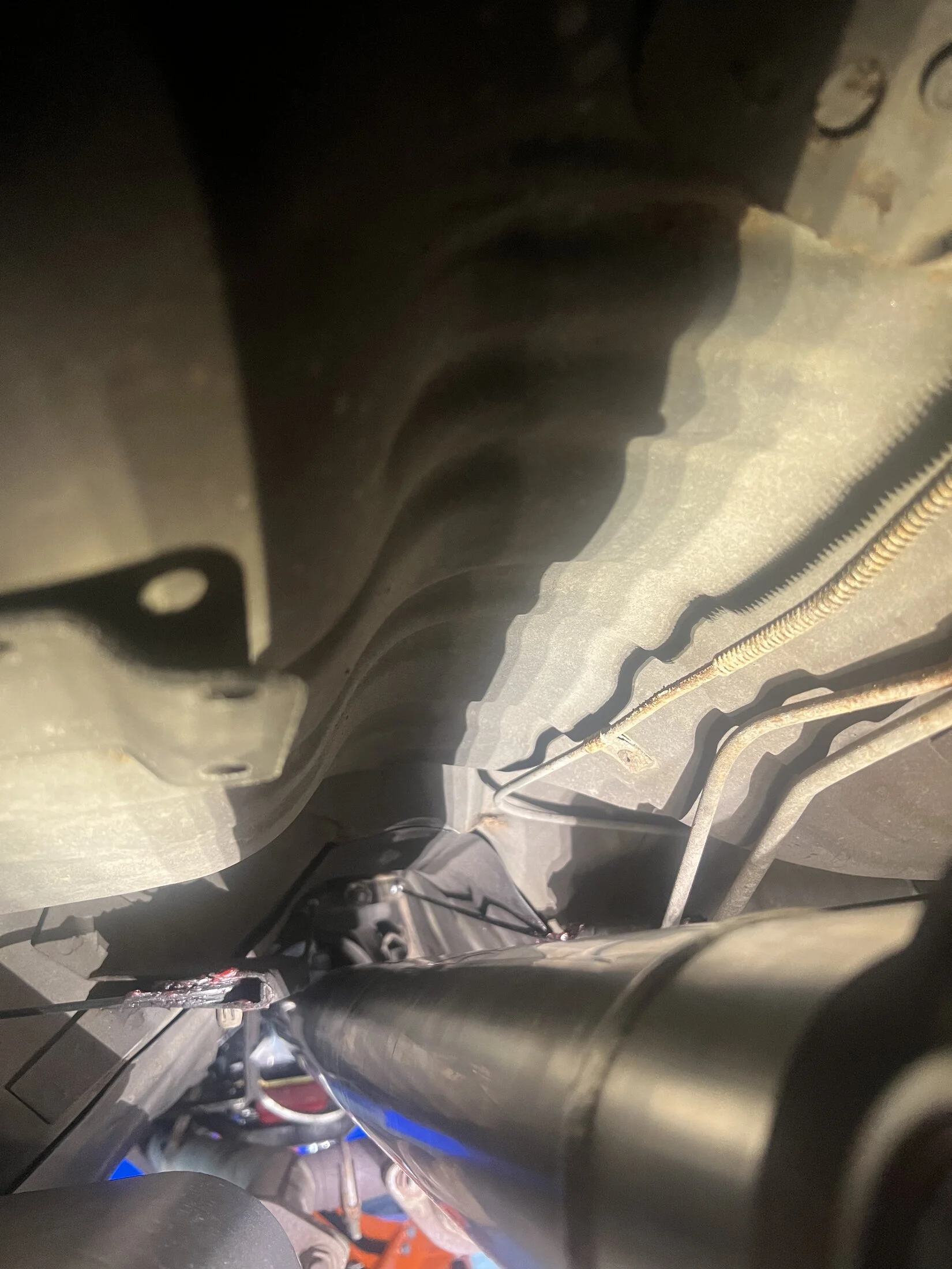

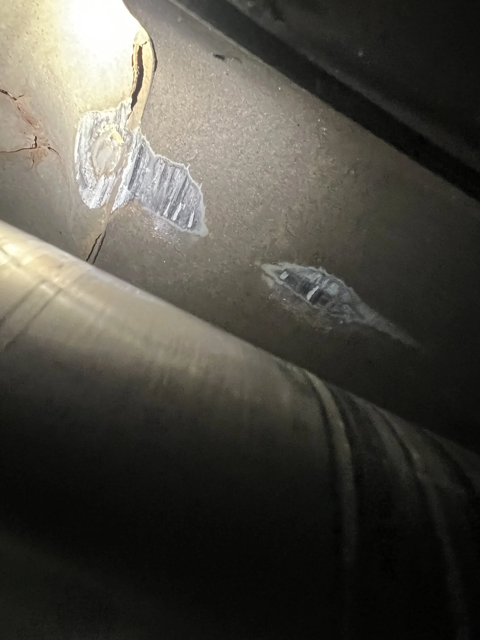

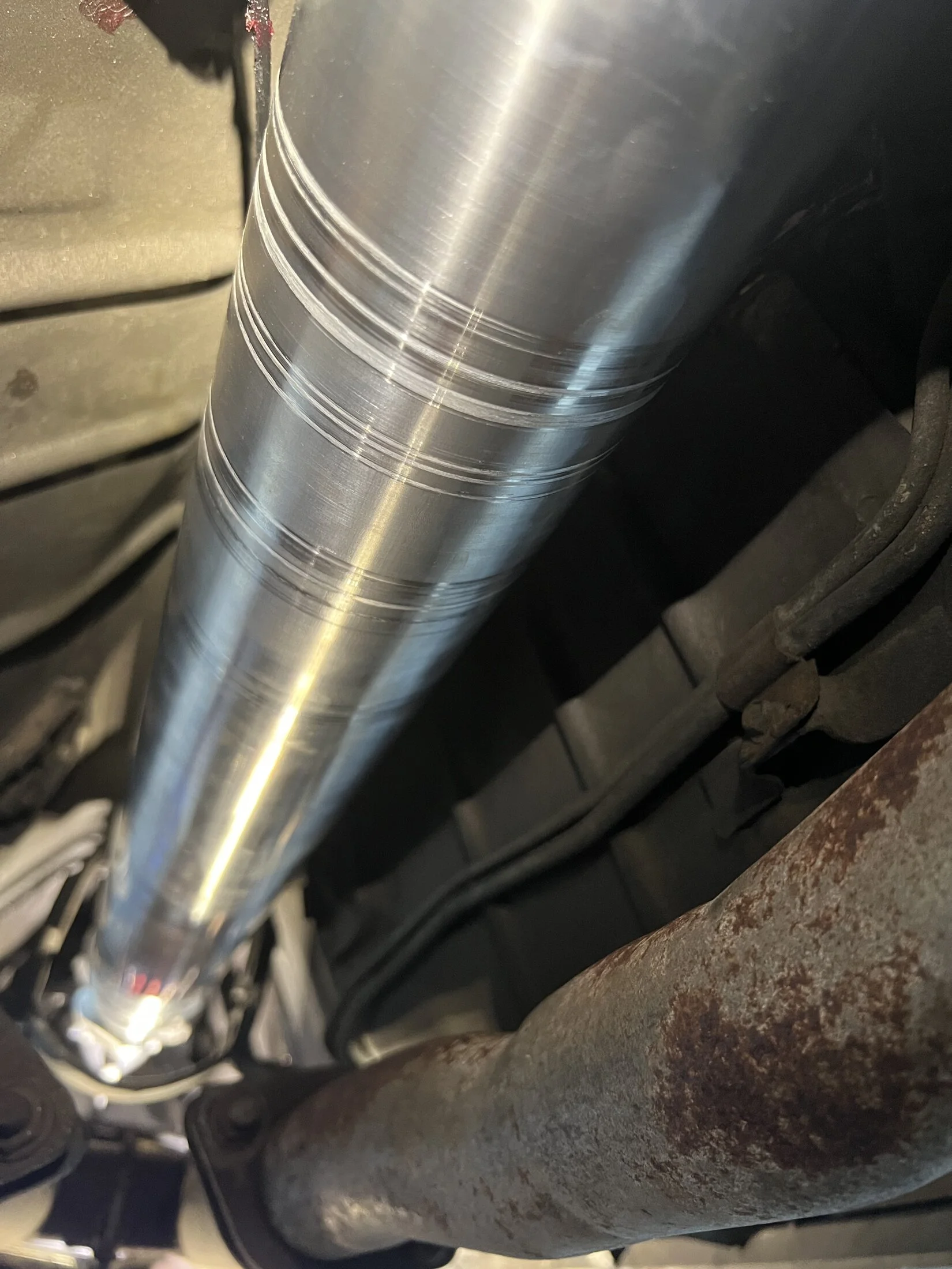

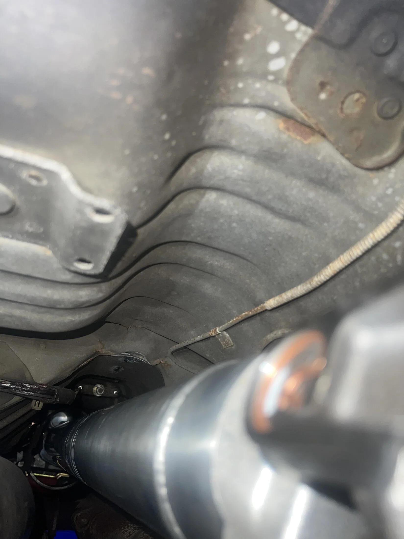

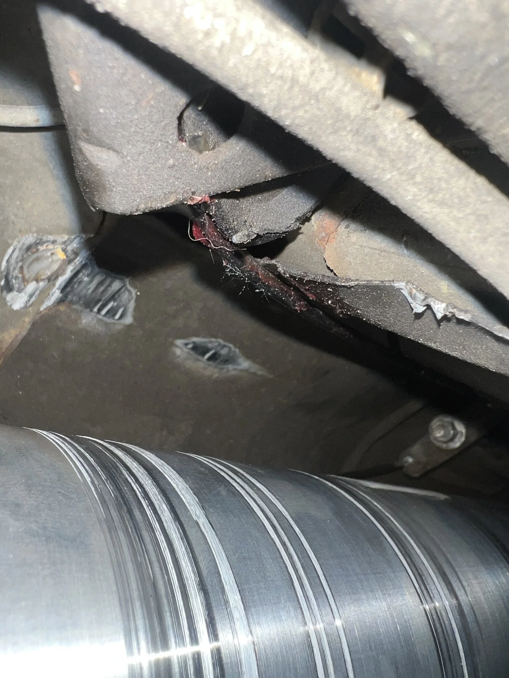

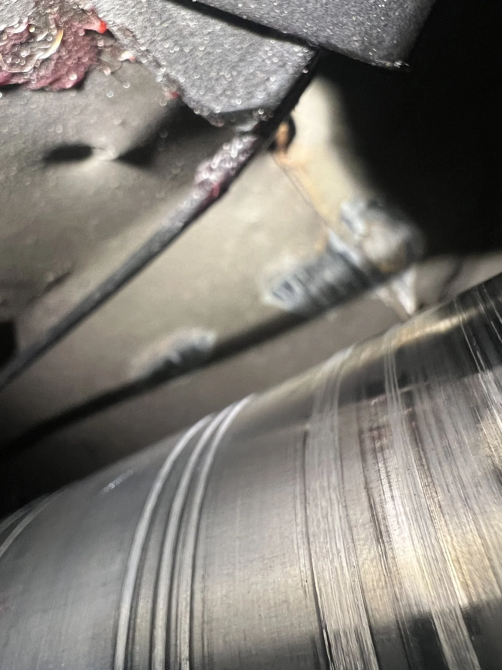

So I took a look at it today. For whatever reason my car does not have that e brake cable bracket. Maybe when they did the 5 lug disc brake swap they didn’t put it. Regardless it looks like the e brake cables are not rubbing.
It’s actually rubbing on my floor pan. Check out the pics below. I made another forum post for this if anyone has any suggestions.

Put a shorter trans mount in, it will move the trans side of you driveshaft further from the floor.

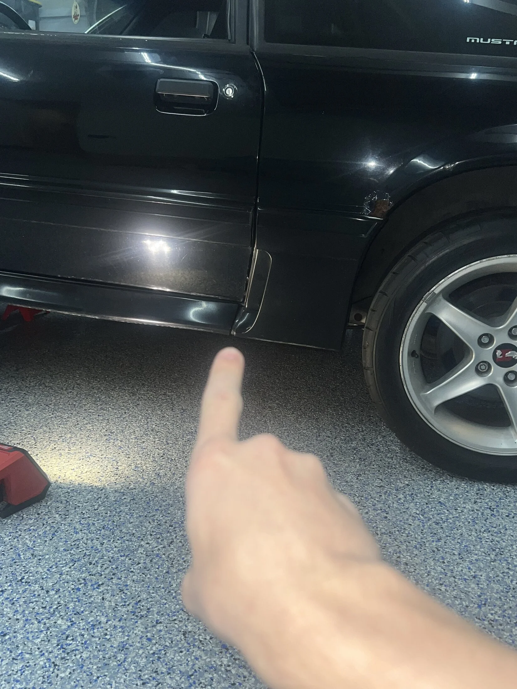

How much have you lowered the rear?
The car has H&R sport springs. This is how it sits right now. About a two finger gap all the way around.
Are there any short poly trans mounts out there?
So is it just me or does it look like there has been a piece of sheet metal added over where the DS is hitting? Almost like a DS blew up and they patched the floor.
I had H&R Super Sports on my Coupe with 245/40R17’s on all four corners and never bottomed out there. What shocks are on the car?
I had a pinion angle issue and swapped the mount called for on a Fox (Prothane 6-1604) for a 6-1608 mount. It is about an inch shorter. If I remember right I had to modify where it mounts to the trans, but it lowered the rear of my trans quite a bit - I actually had to shim it up to get the angle within range.
