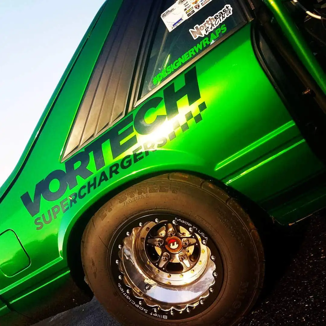

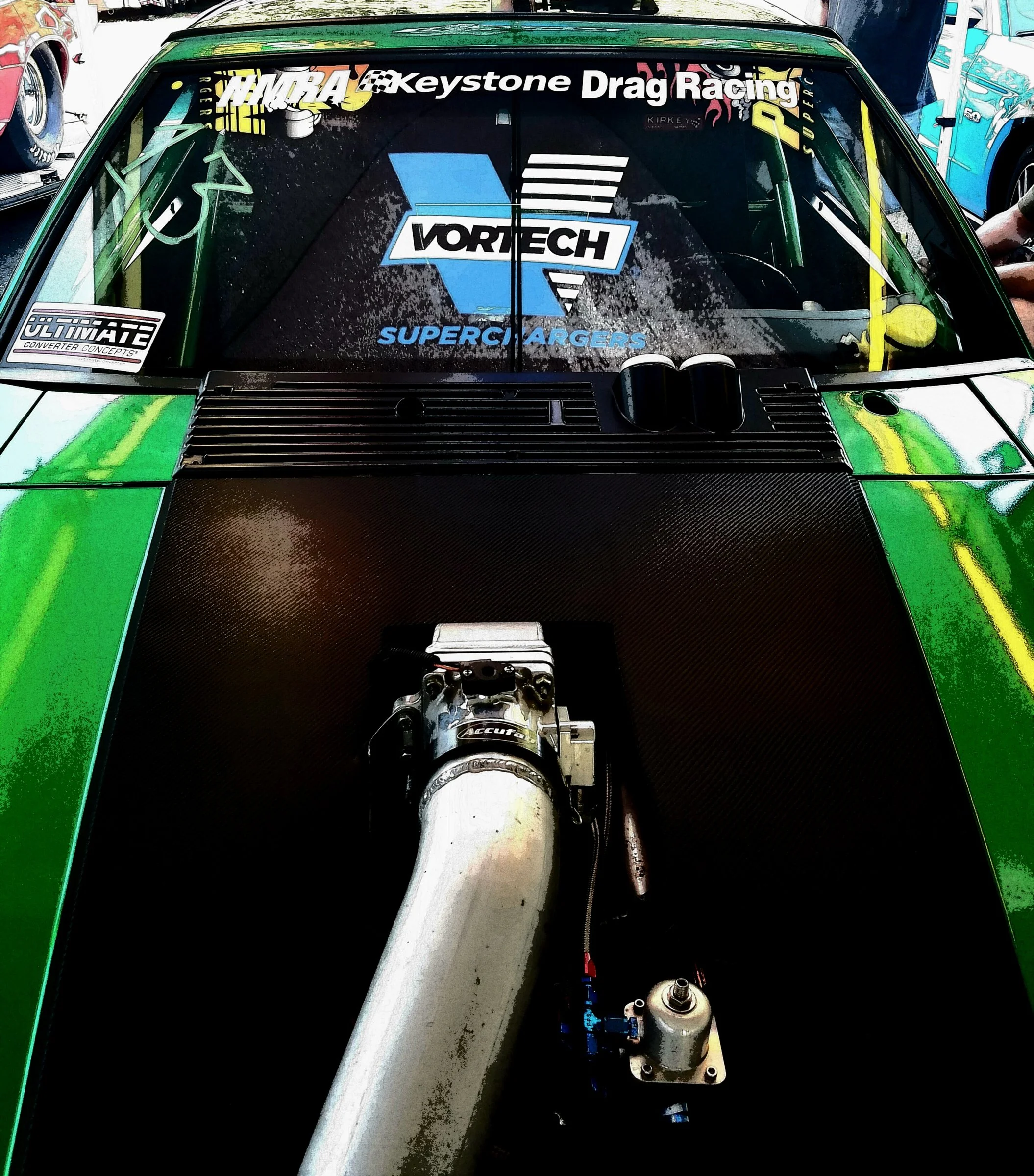

Well...yeah!For the record... I am totally biased, but I like to go fast. That's why I choose Vortech
irate:
Well...yeah!
With slightly more than 400rwhp! Lmao
