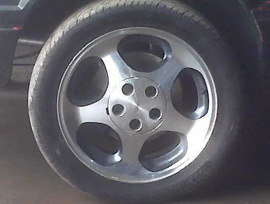

I just installed SVO brakes and axles in my turbo coupe housing and installed it in my notch. with the 94-97 cobra wheels and 275/40/17 tires the tire edge is right inline with the edge of the wheel well. I have a solid 2 inches on the inside of the tire to the wheel well.
Here is a picture...

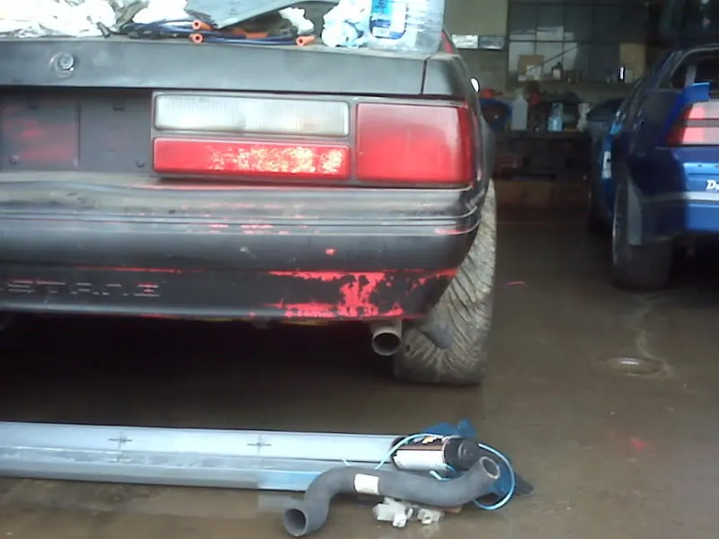

hey guys sorry for waking up a old thread but figured id ask in this one rather than start another
ive got a set of 265-50-15 on the rear sitting on a 15x9 weld wheel....i need to put the quads back on as they were taken off when i bought the car...
do you think they will fit? im in need of tires shortly and probably will be getting 255's...but for the meantime i need to minimize this wheelhop!
ive attached a pic so you could get an idea of the offset...
http://www.stangnet.com/mustang-forums/841430-my-stang.html
