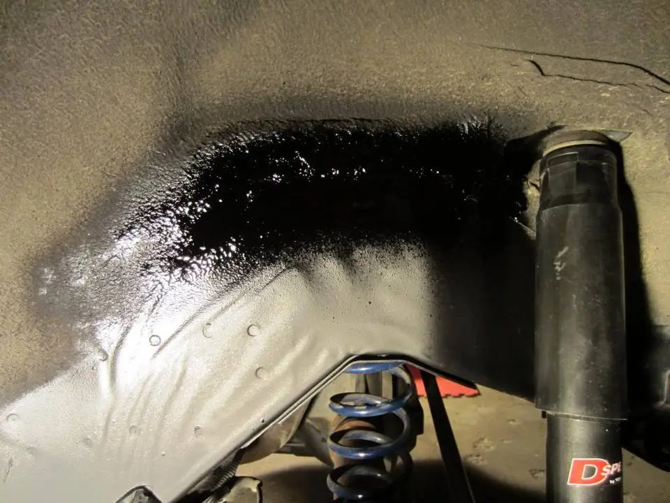

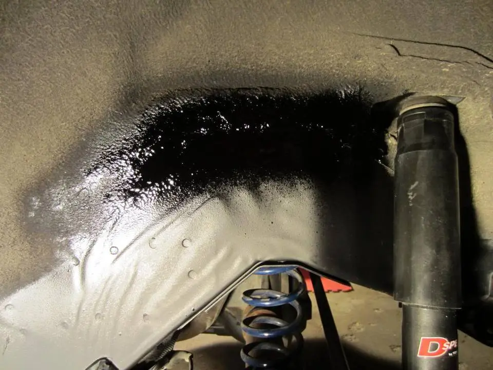

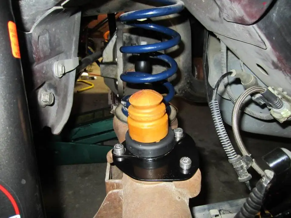

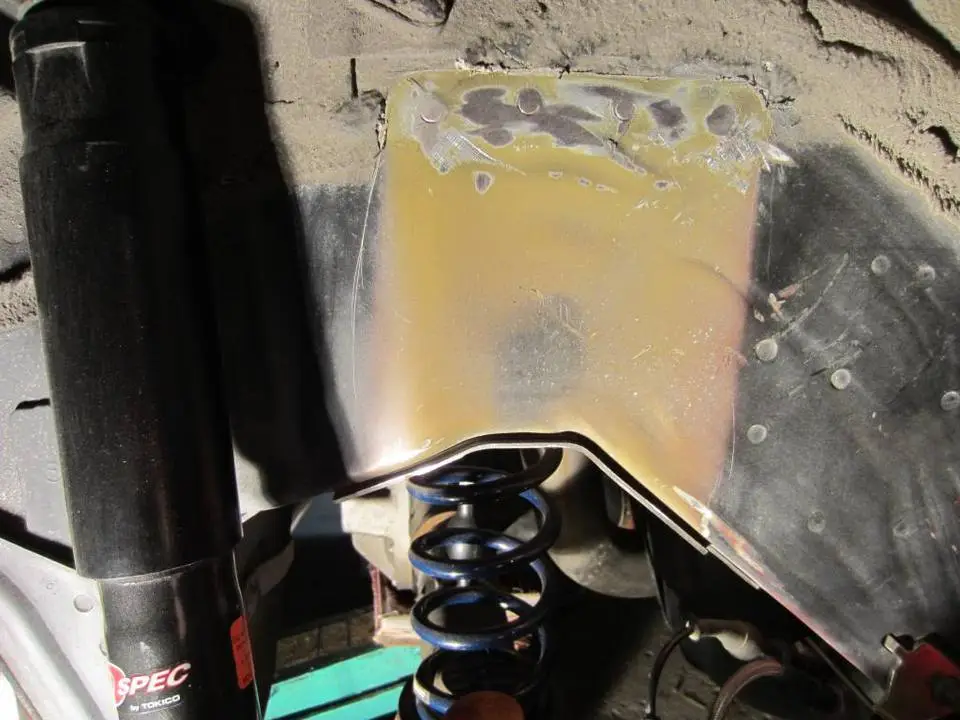

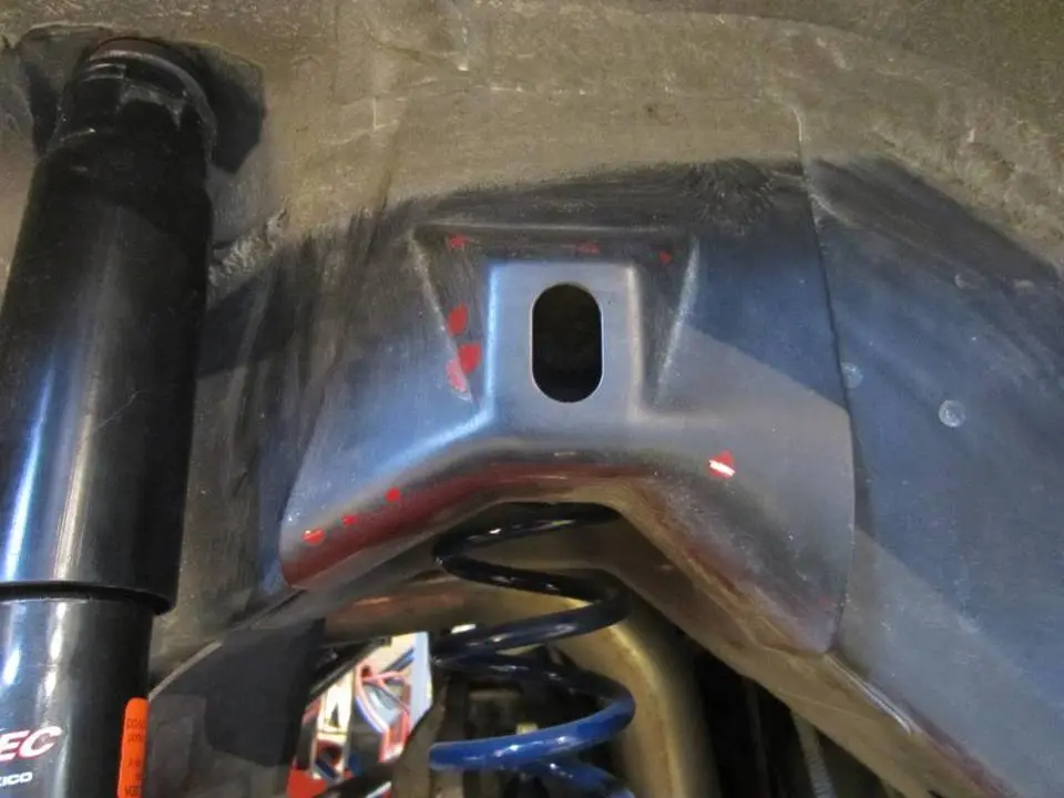

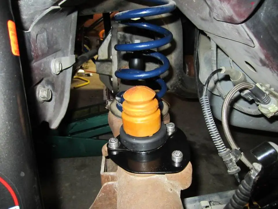

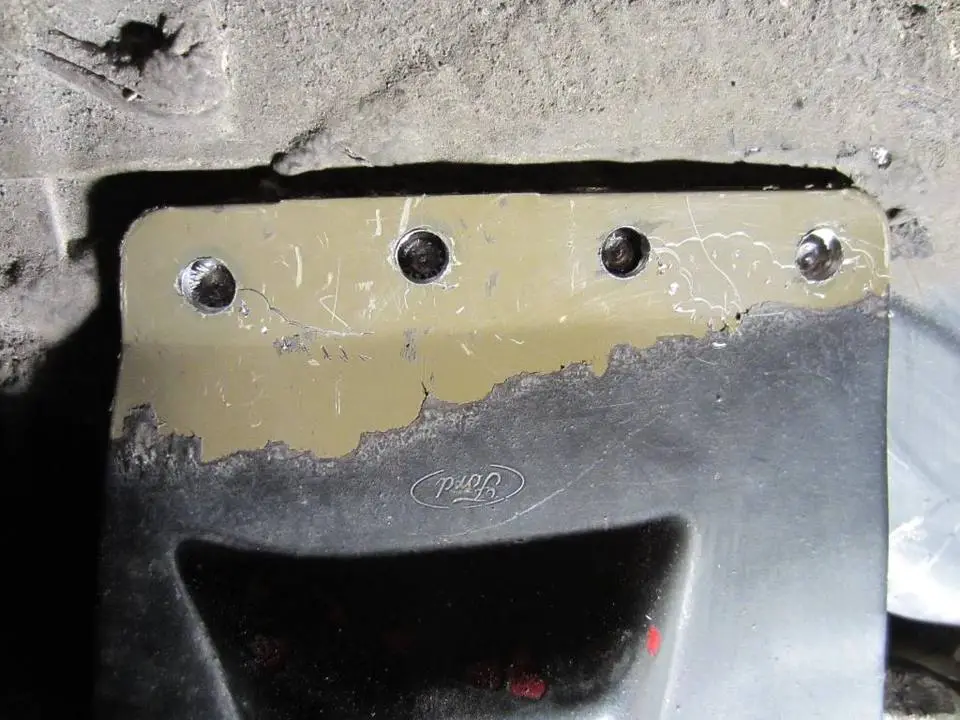

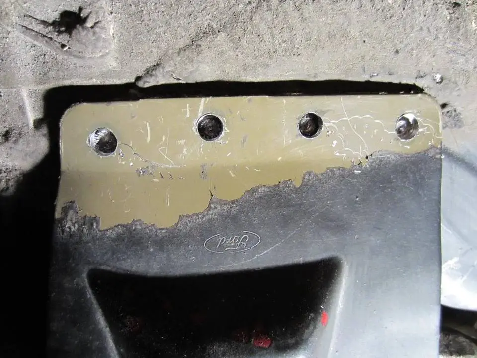

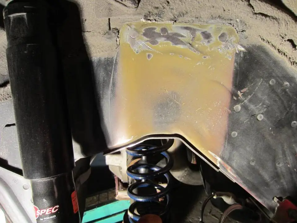

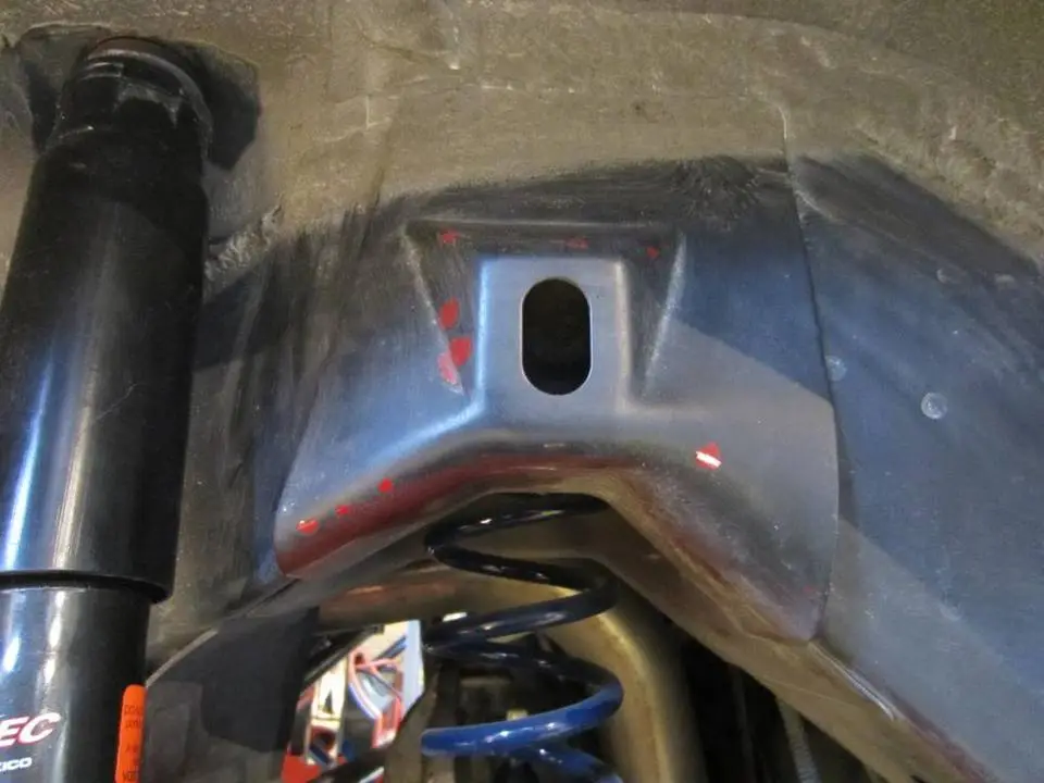

Removed the OEM frame rail bump stop and made up a plate to relocate the bump stop on the axle housing to under the frame rail.
