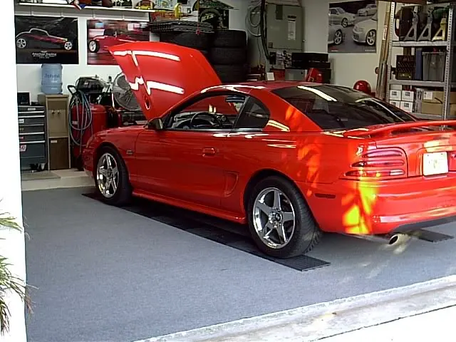

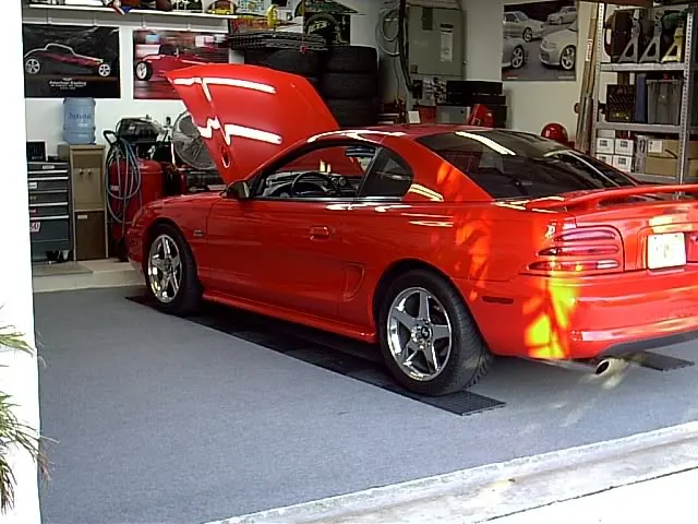

Actually the QA1 has two mounting spots. I used the closest one foward. It will drop the car down a bit. The front of my car is slammed. I'm only like 2 inches from the fender. I'm only using FRPP C springs which is 1 inch front, 7/8th in the back.
I'll get a better pic of the front tomorrow.
