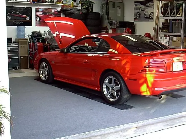

Actually the QA1 has two mounting spots. I used the closest one foward. It will drop the car down a bit. The front of my car is slammed. I'm only like 2 inches from the fender. I'm only using FRPP C springs which is 1 inch front, 7/8th in the back.

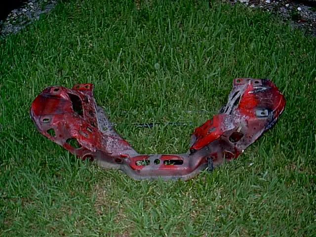

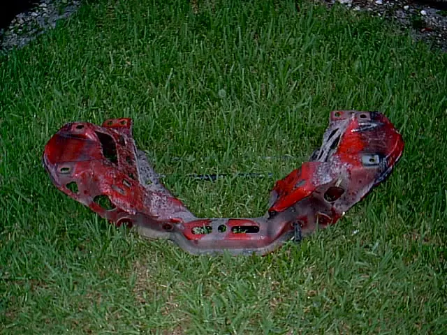

Stock heavy bulky ass thing. Know how much crap I found in that thing? Sockets, drill bits, screwdrivers, spark plug......(which all added weight)

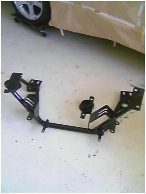

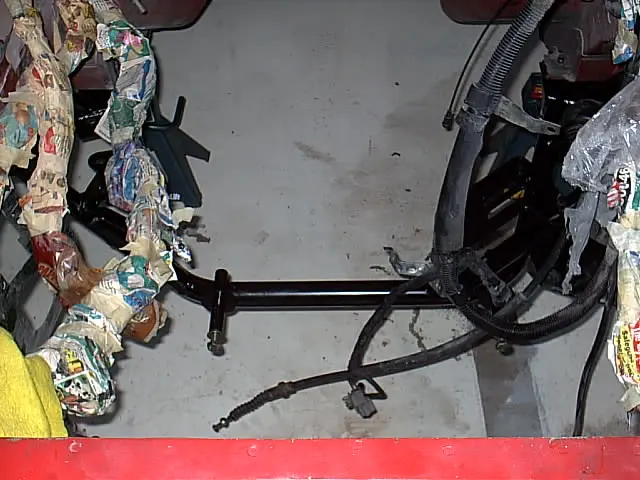

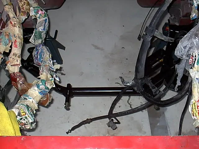

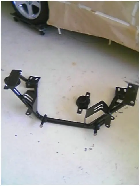

K member, Stange adjustable struts and modified stock A arms.

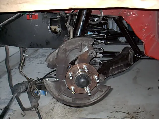

With the motor removed we had the stock K out and QA1 installed in about 10 minutes. The stock A-Arms had to modified with a grinder so that really was the longest part for me. Those switching to tubular A arms should be about another 2 minutes to install.
Here is a tip. If using the stock motor mounts you must grind off the tabs at the bottom of them. I forgot and had to pull the motor back up and grind them down.

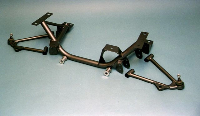

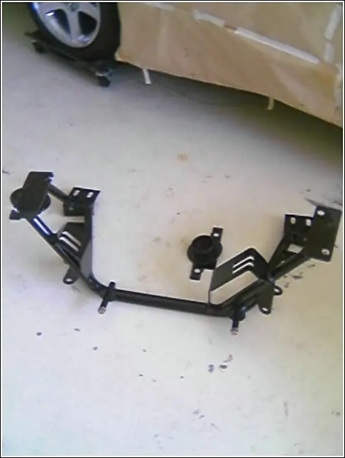

That's not what Im talking about, but it doesn't matter anyways because I just found the Griggs k-member only has two mounting holes on the 96+ parts. This is what I was talking about, see where the control arm bolts to the k-member, there's two mounting holes there.
nmcgrawj, Im not sure about the drop rack, but the spring perches are what you need if you're not installing coil overs.

Ok, now I see what your talking about. Since I reused my stock A arms I'm not familiar with that.
I do know that my car was never that low before so the K did bring the nose down some. There is no way that I would want it any lower then it is. I already have to crawl over speed bumps with the drop and LT headers.
nmcgrawj, the 03 A arms will still have to be modified to fit (grinder action). The PA unit is nice. I was originally going with that one but my buddy ordered one and it was beat to hell. Not all the PA ones are like that but it scared me enough. I remember Paul had an install issue with his. The AJE is also a great K. Most of them if used with regular spings will come with spring perches so you can use stock A arms (or 03 Cobra's). Just need to specify that when ordering it. The $219 price is excellent for that QA1. I paid close to that.
