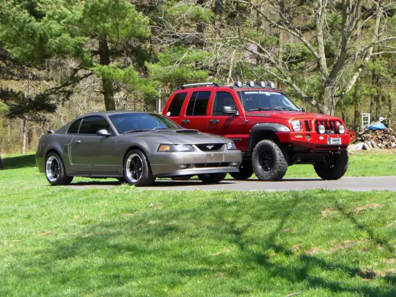

I have 10.5x17 back 9x17 front.. 315/35/17 rear and 275 front.. hardly rubs on front (def not enough to do anything about it).. doesnt rub at all on rear. on my 2001 GT.. lowered an unknown amount but more then 1.5in i'd say.
