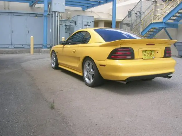

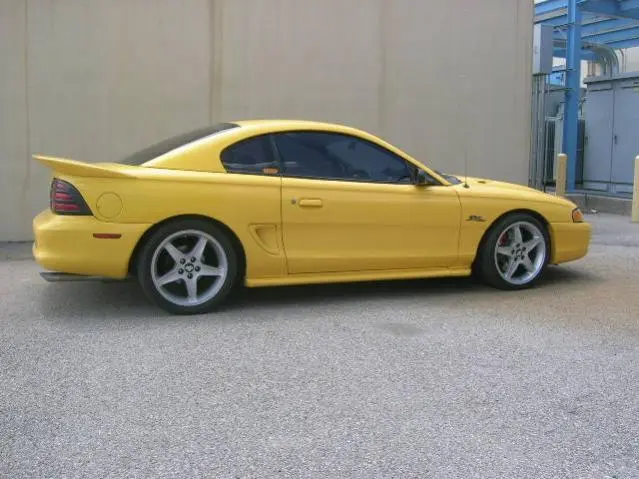

The 275 I think are way to wide on the front. I have 255/35/18 and when I get new tires Im gonna put 245/35/18. Also my car is droped 2 inches.
That set up should work, I wish some others would comment on this. 18 inche tire are not that pricey a 275/35/18 you can get for around 200 bucks. Thanks for the comment on my car. I also installed a granatelli kmember, a arms and coil overs, and I love it.
