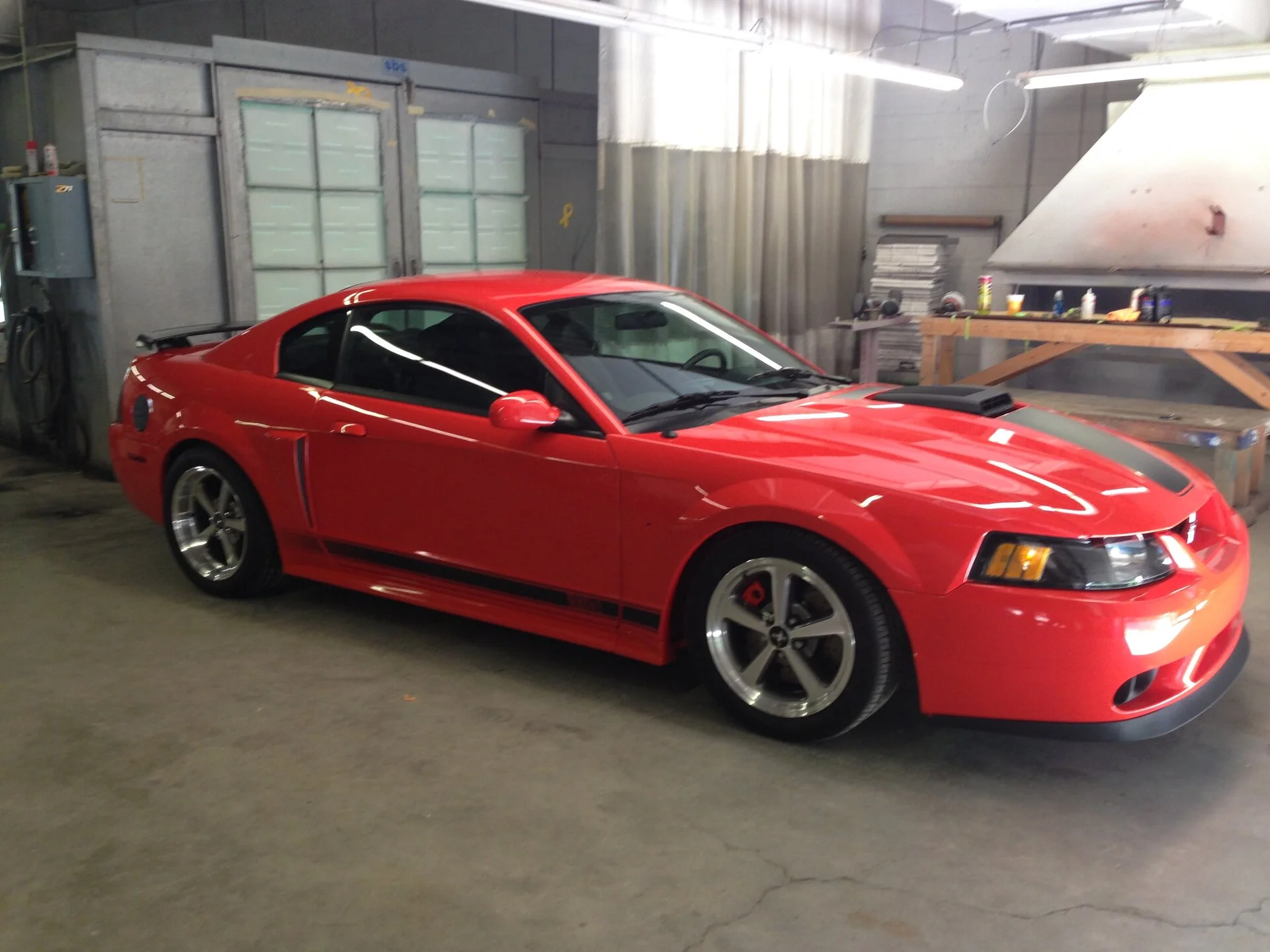

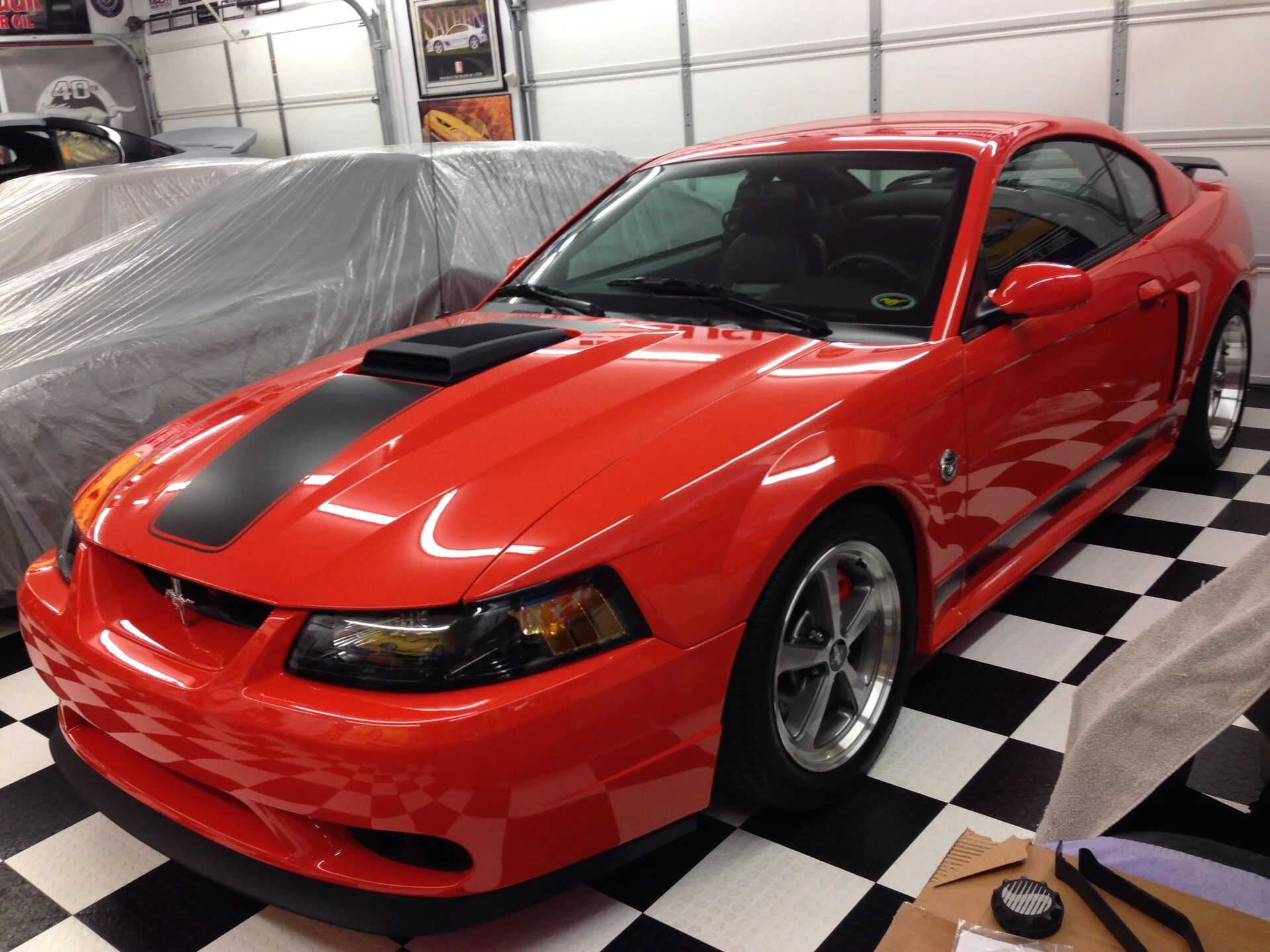

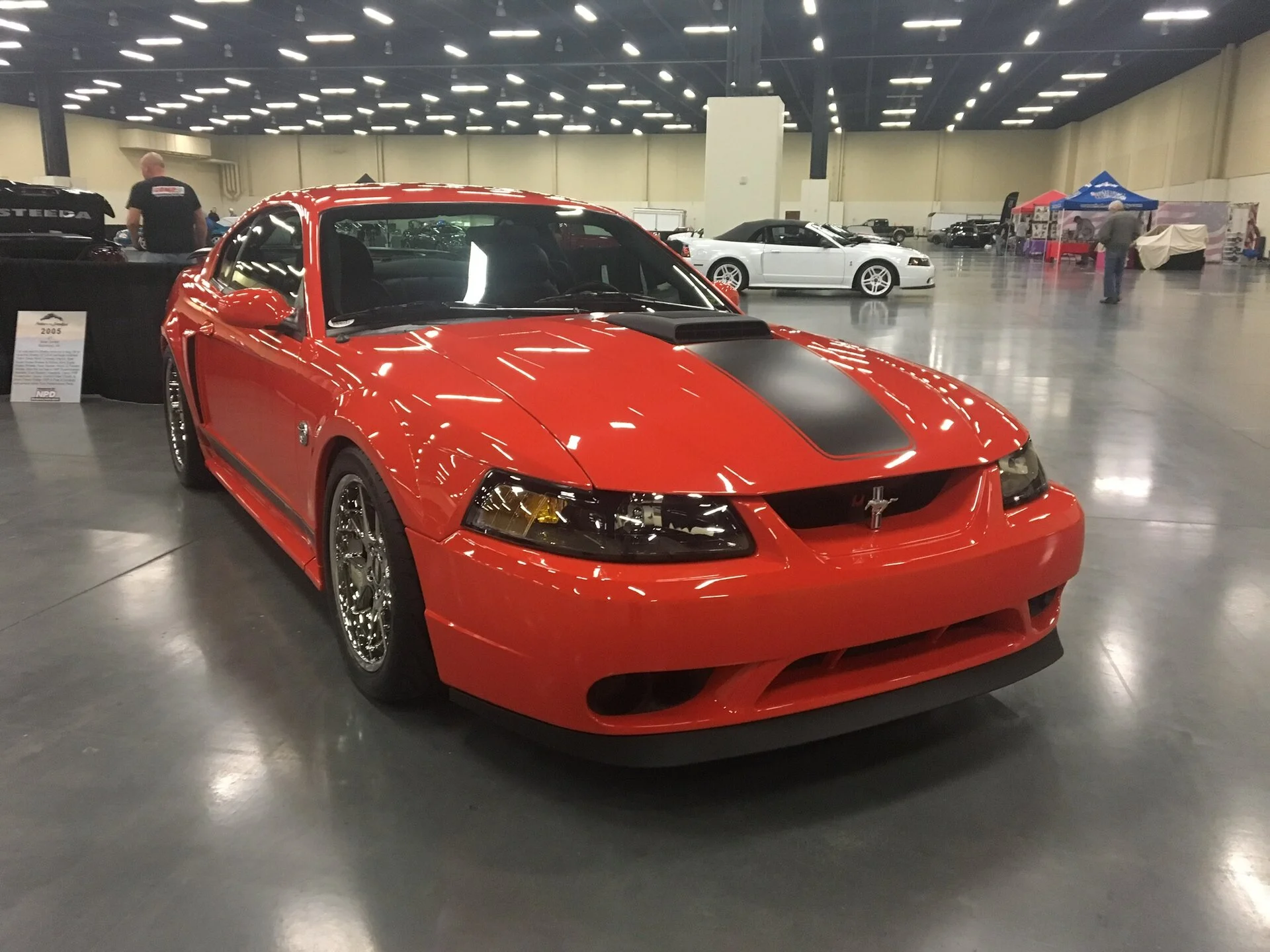

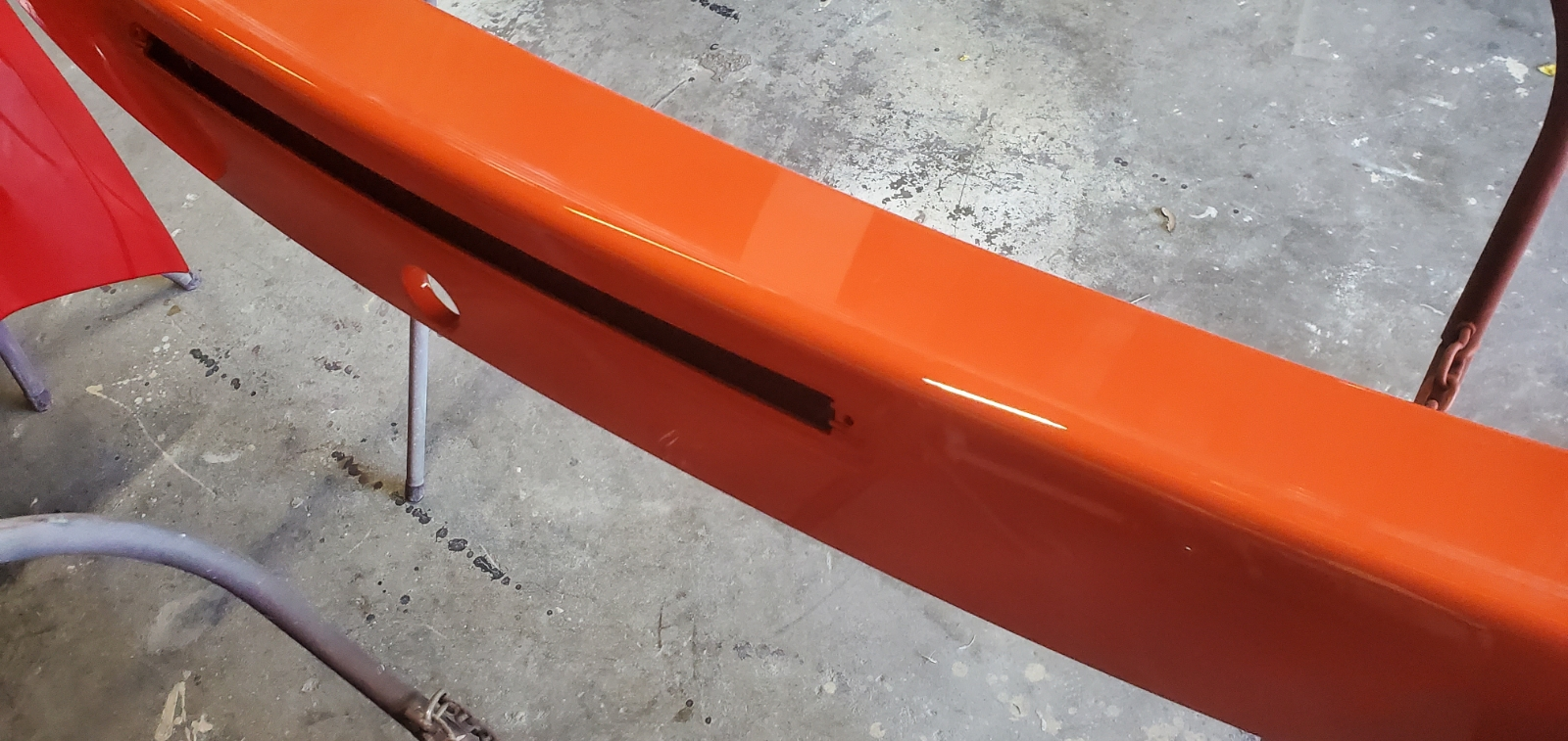

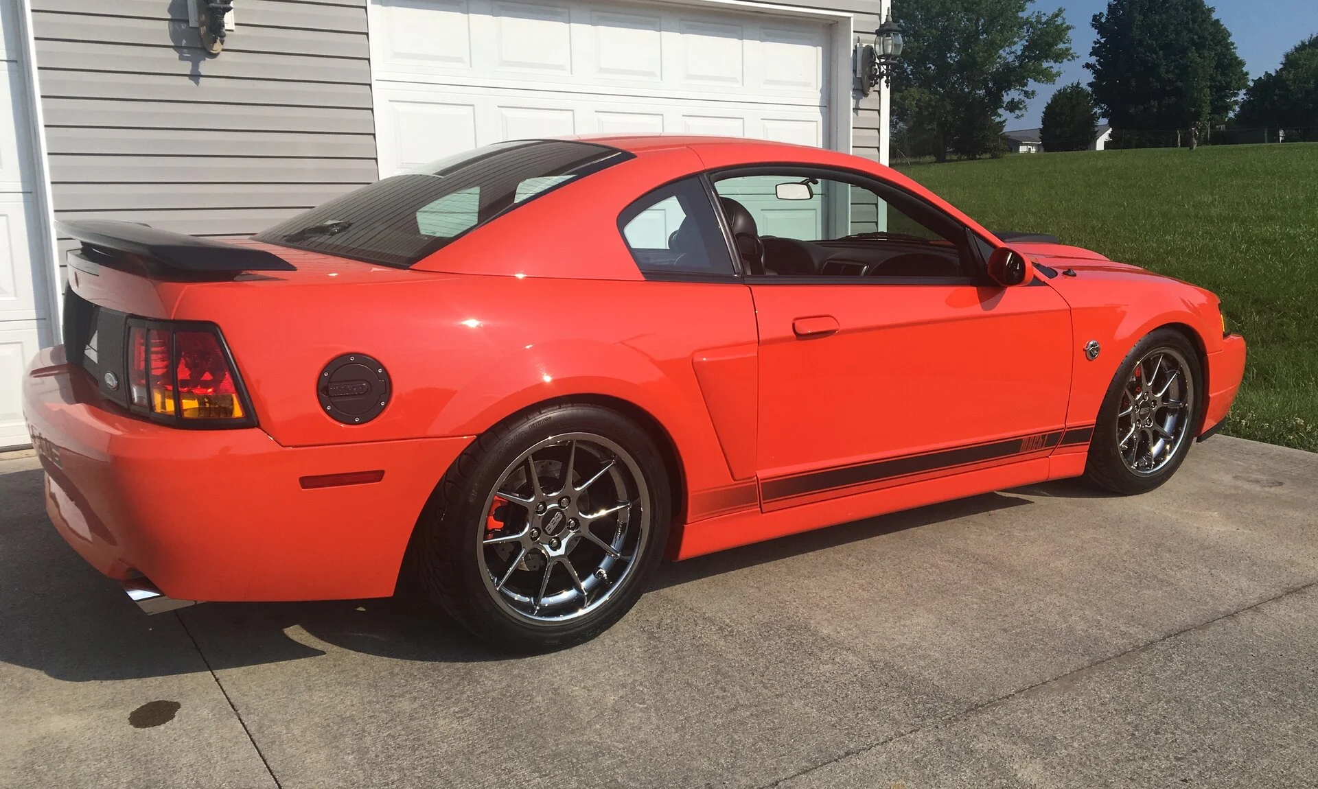

Paint work done. For now

95steedamustang said:
The 99/01 cobra bumper fits the mach hood perfectly. But I like to make my own versions of how they should have come anyway.
This totally makes sense to me because that's what Ford did when they created the Mach and the Bullit.
For the most part, the extra aesthetics were arbitrary shelf-grabs until somebody said, "Yep... That'll do".

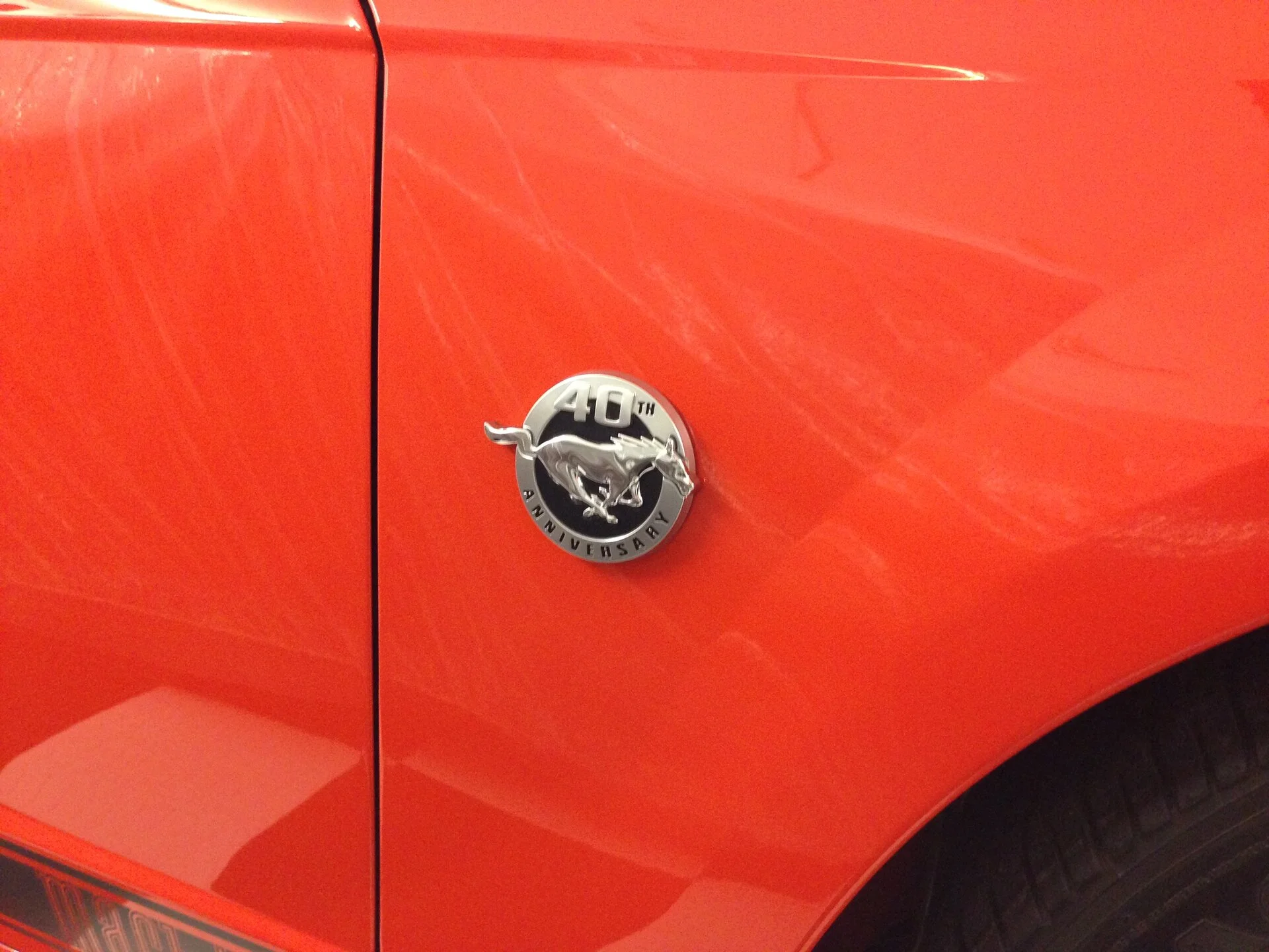

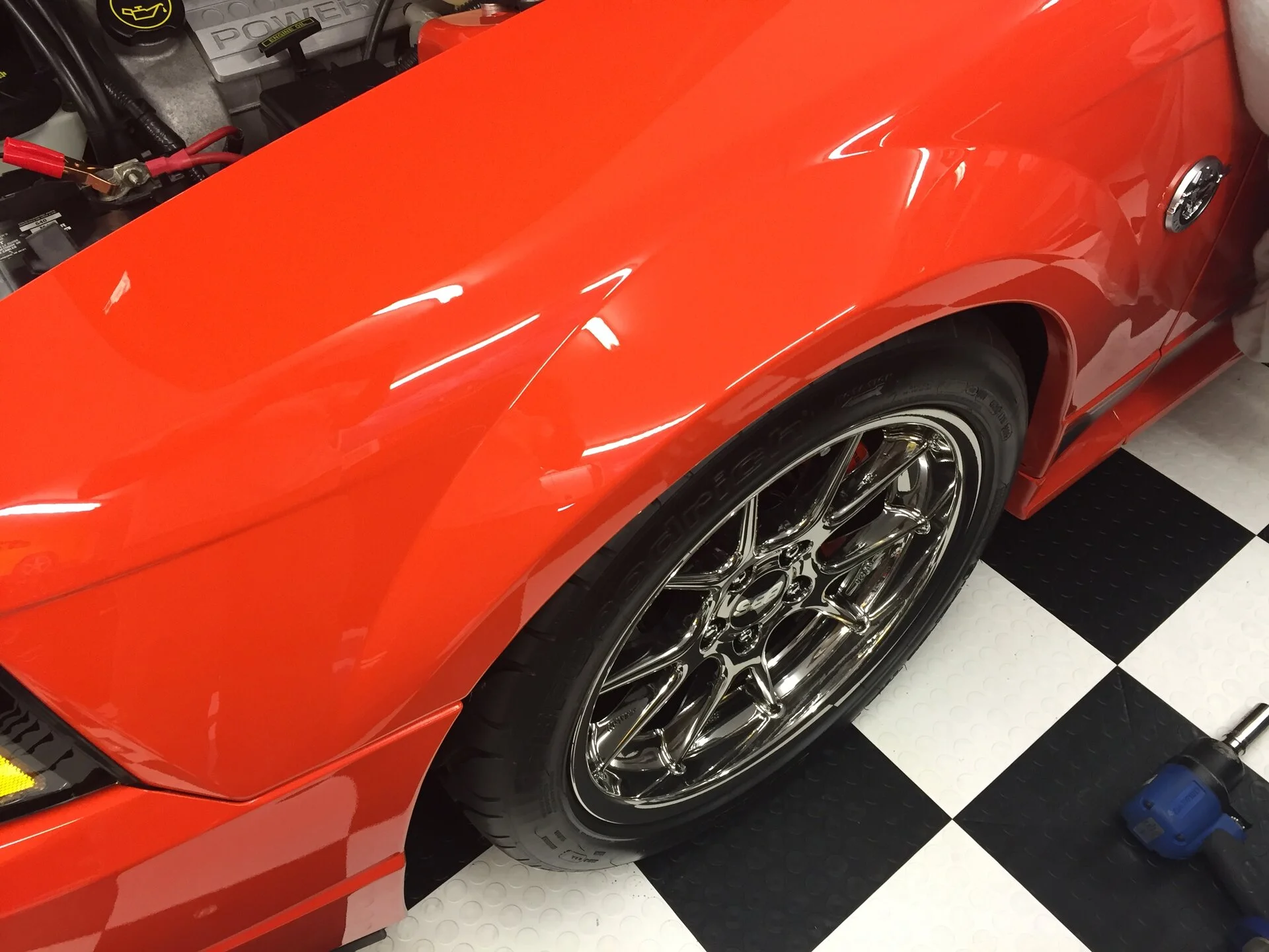

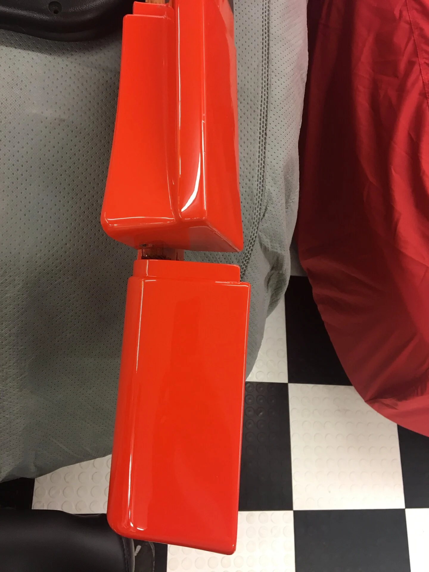

NOS Fender emblem. All
Cleaned up and buffed/polished out.

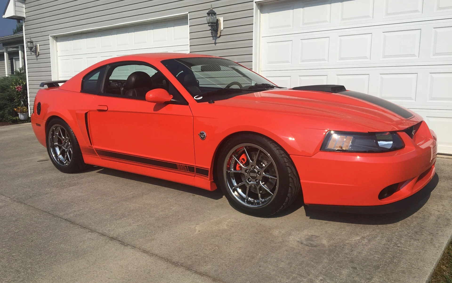

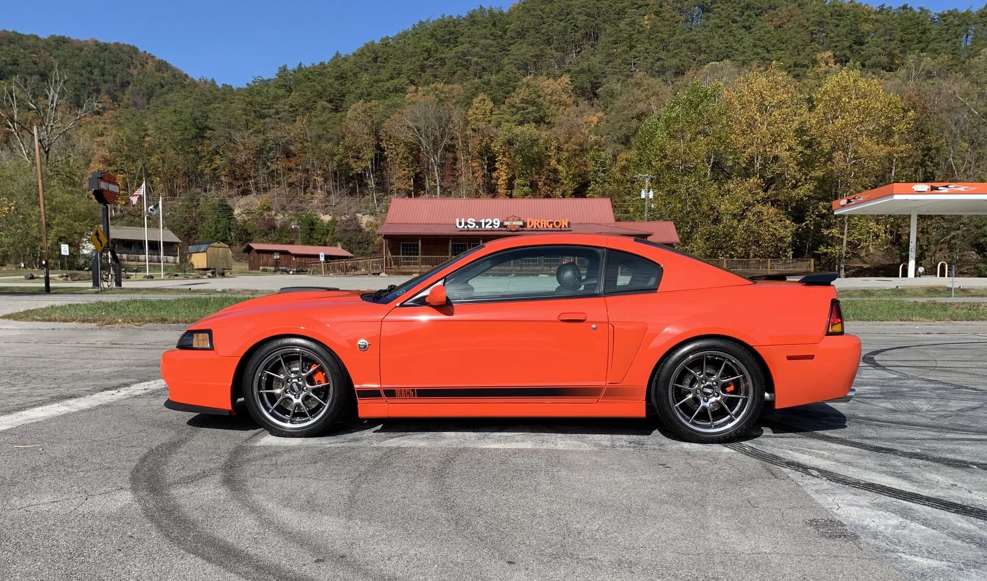

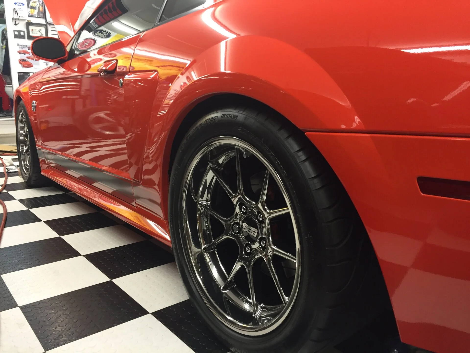

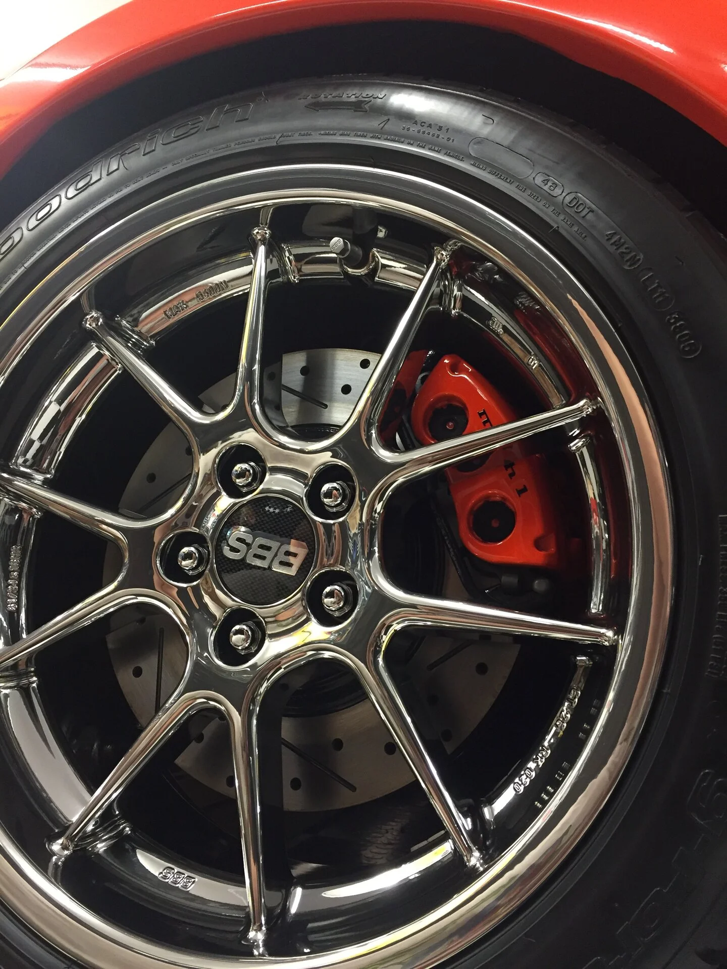

This was the first set of BBS RK plasmas I acquired. They came from California and were on a low mile CO mach 1 that the owner was selling. Seems only right to marry them to my Mach.

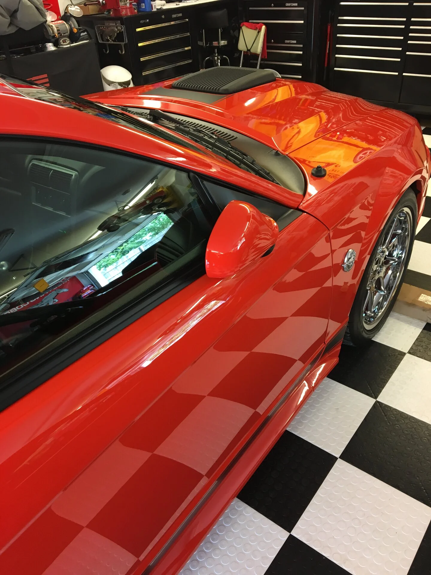

  • #45

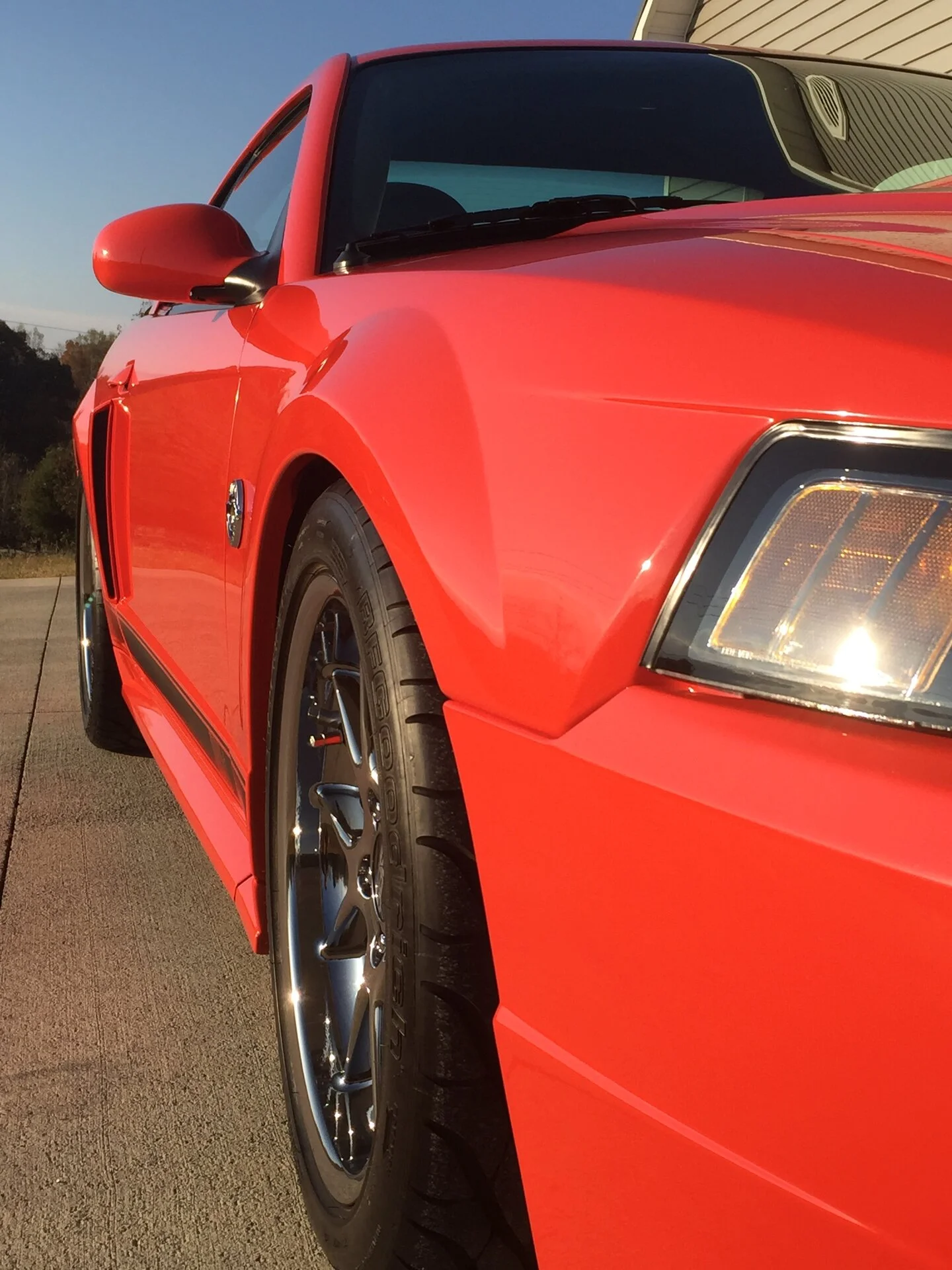

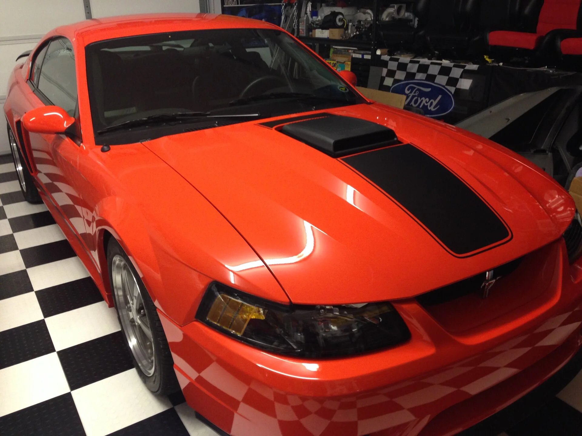

Final polish on the new paint.

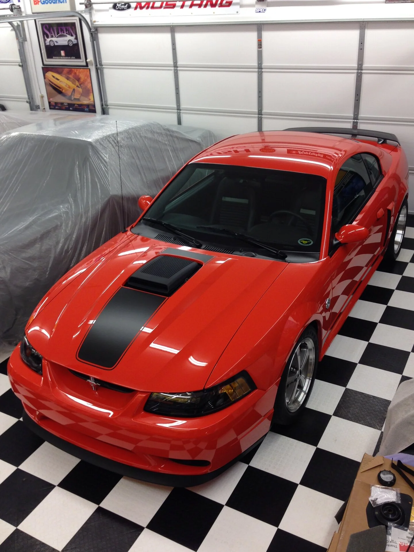

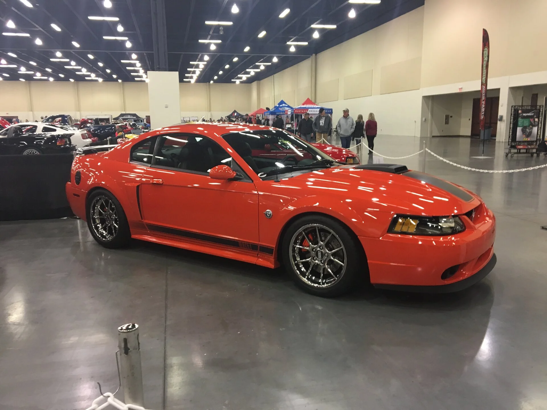

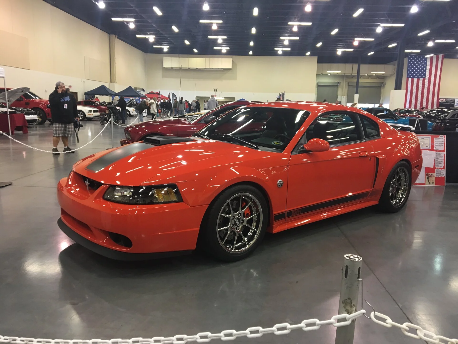

Show time for the Mach.

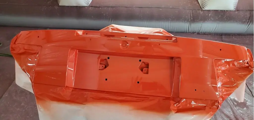

  • #47

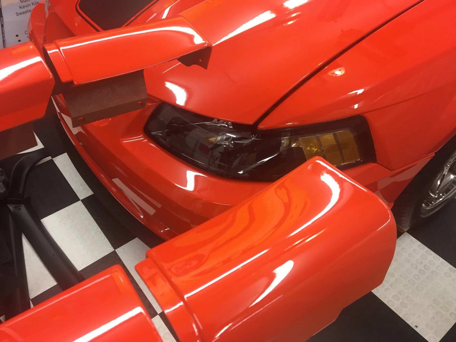

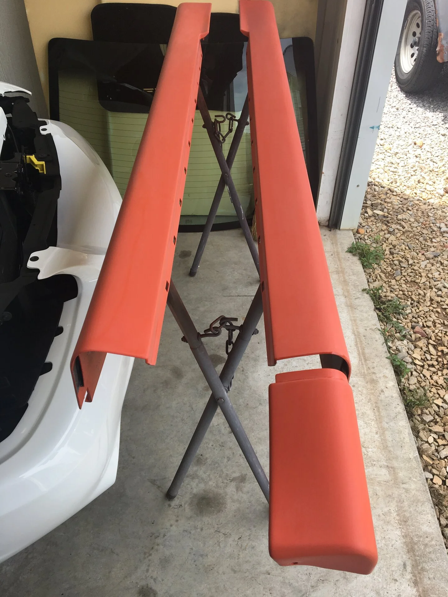

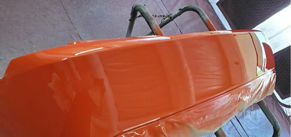

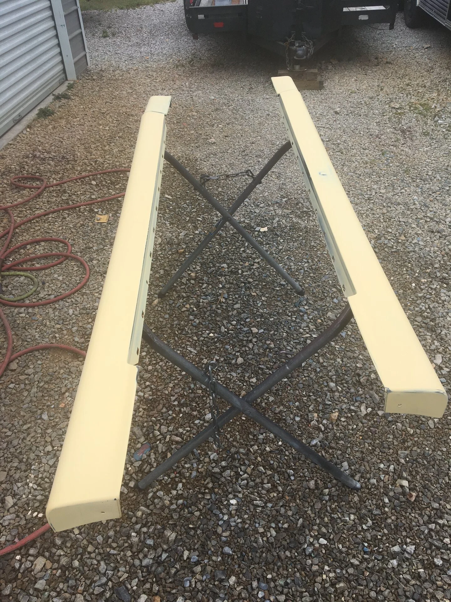

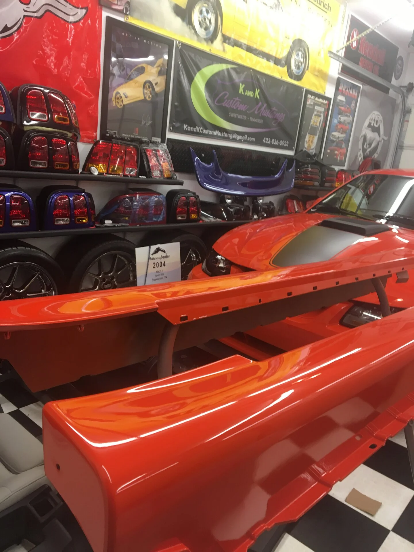

Time to do some more paintwork on some cobra side skirts.

Do you color sanding then clearcoat?
Probably not because you are that good, but thought I would ask
Reactions: 95steedamustang
95steedamustang
I tend to be on the ocd side…
SN Certified Technician
Apr 22, 2009
3,141
6,209
174
East TN
Jun 24, 2021
#49
  • Jun 24, 2021
  • #49
I do build on my clear. So I do base and then 5-6 coats of clear. Block the clear down flat then 3-4 wet smooth coats. Block and cut with 8 grades of paper, then buff and polish.

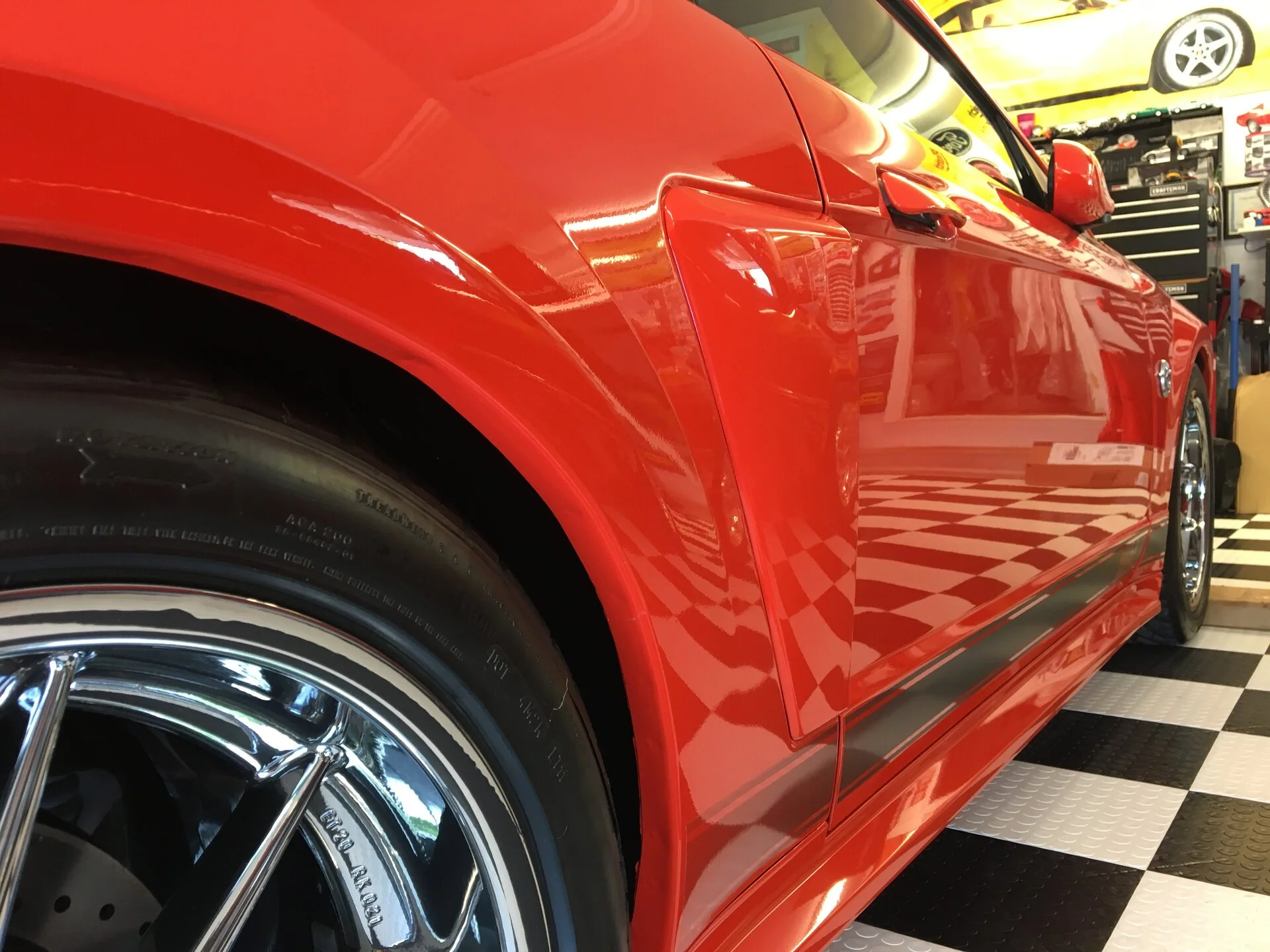

  • #53

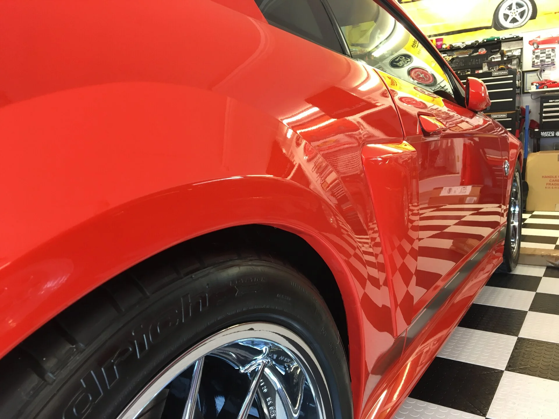

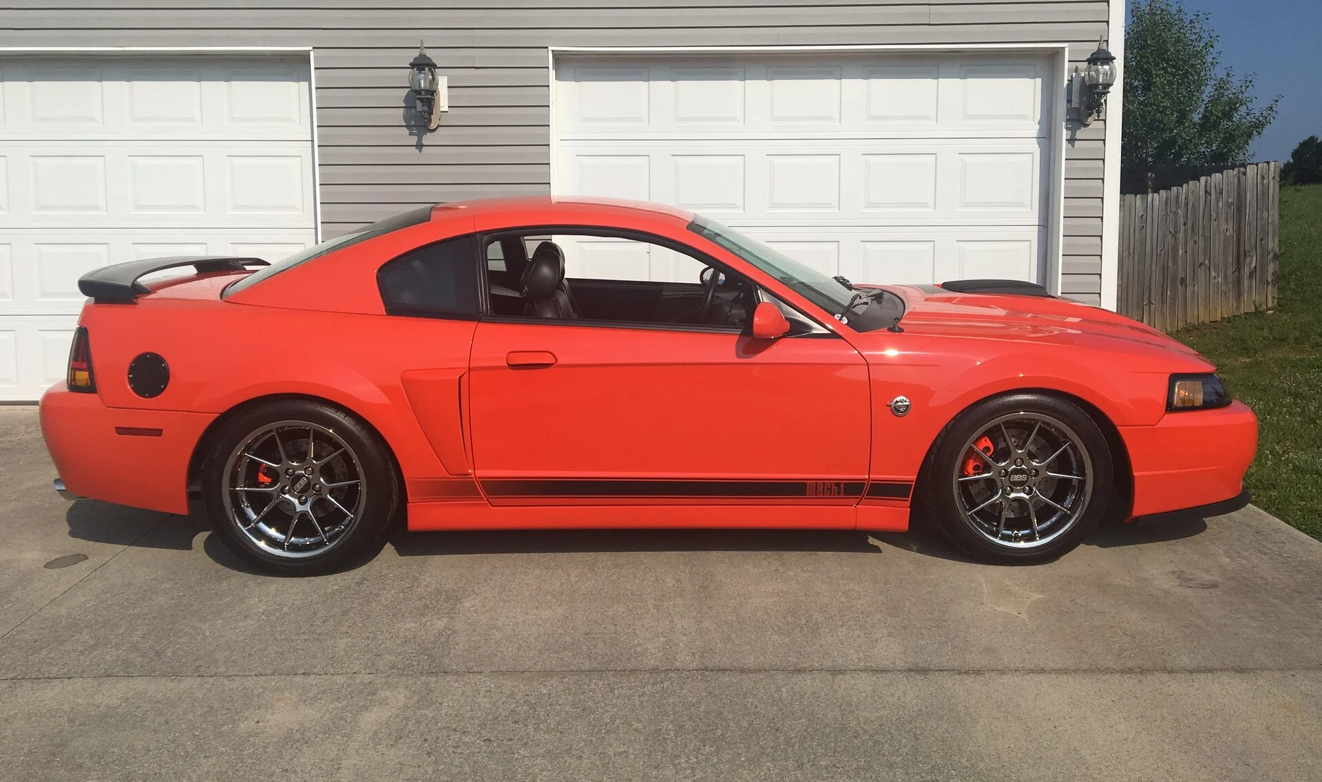

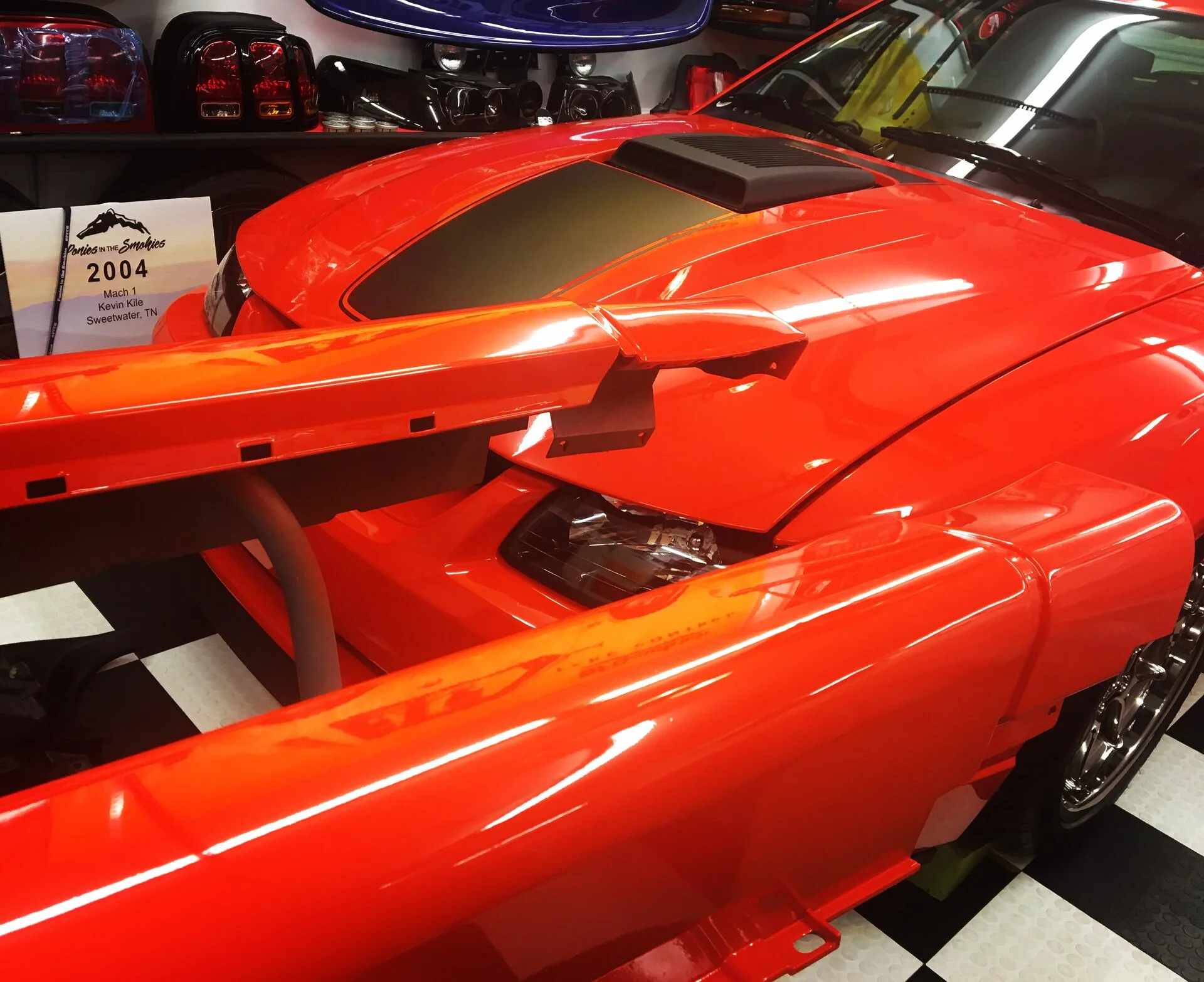

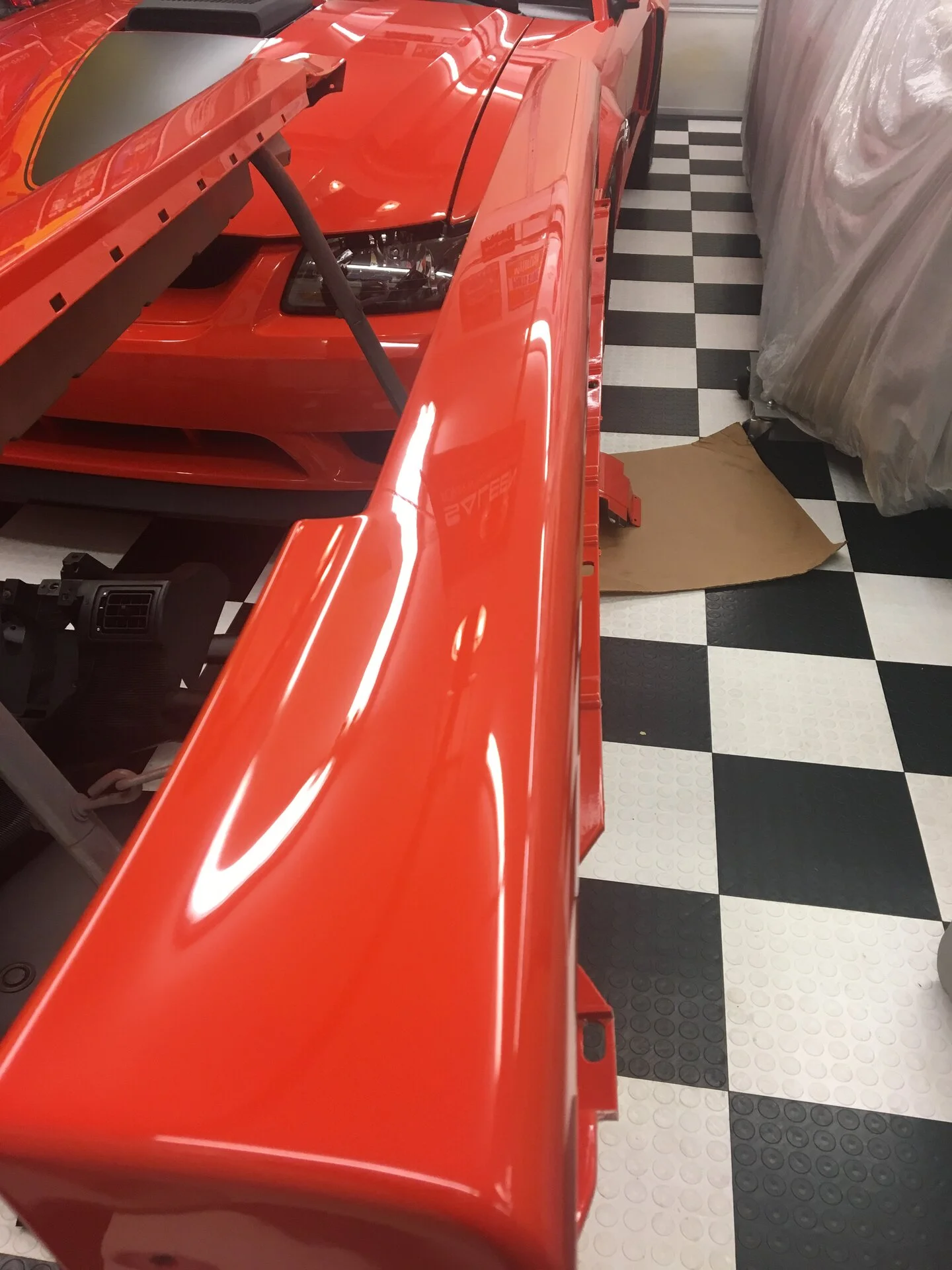

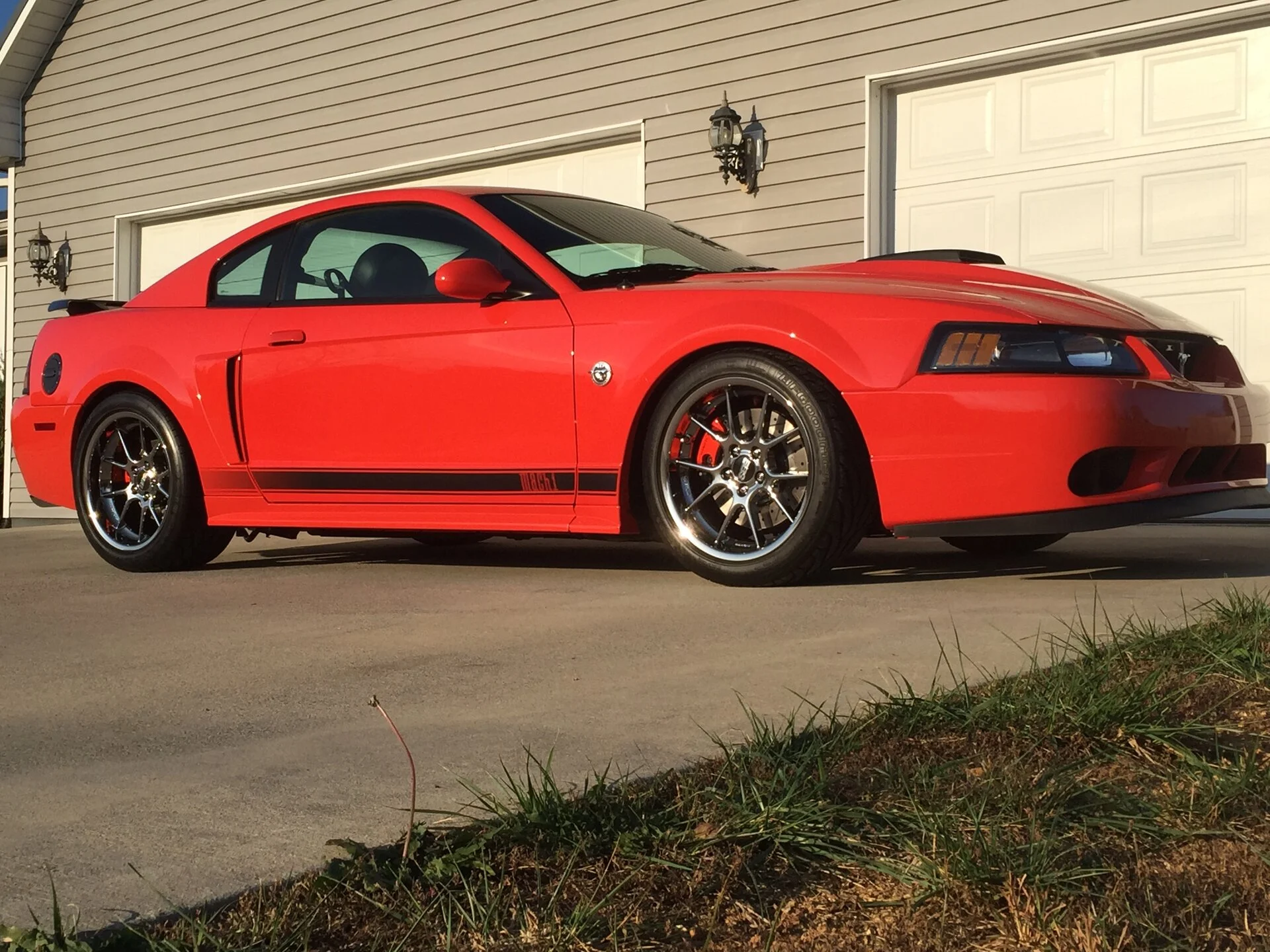

cobra side skirts installed.

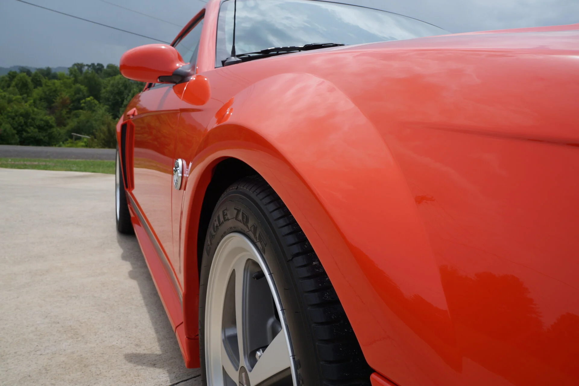

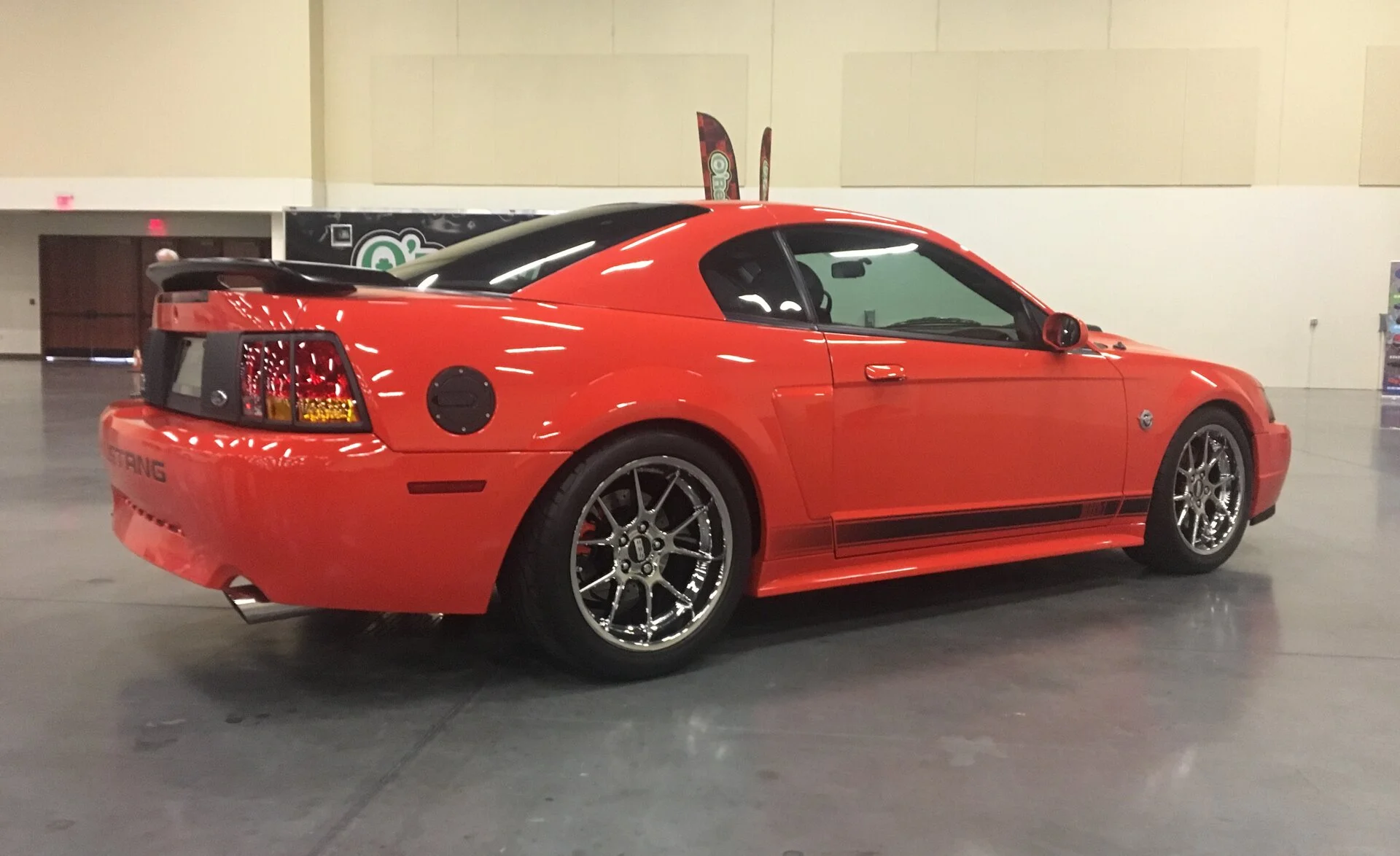

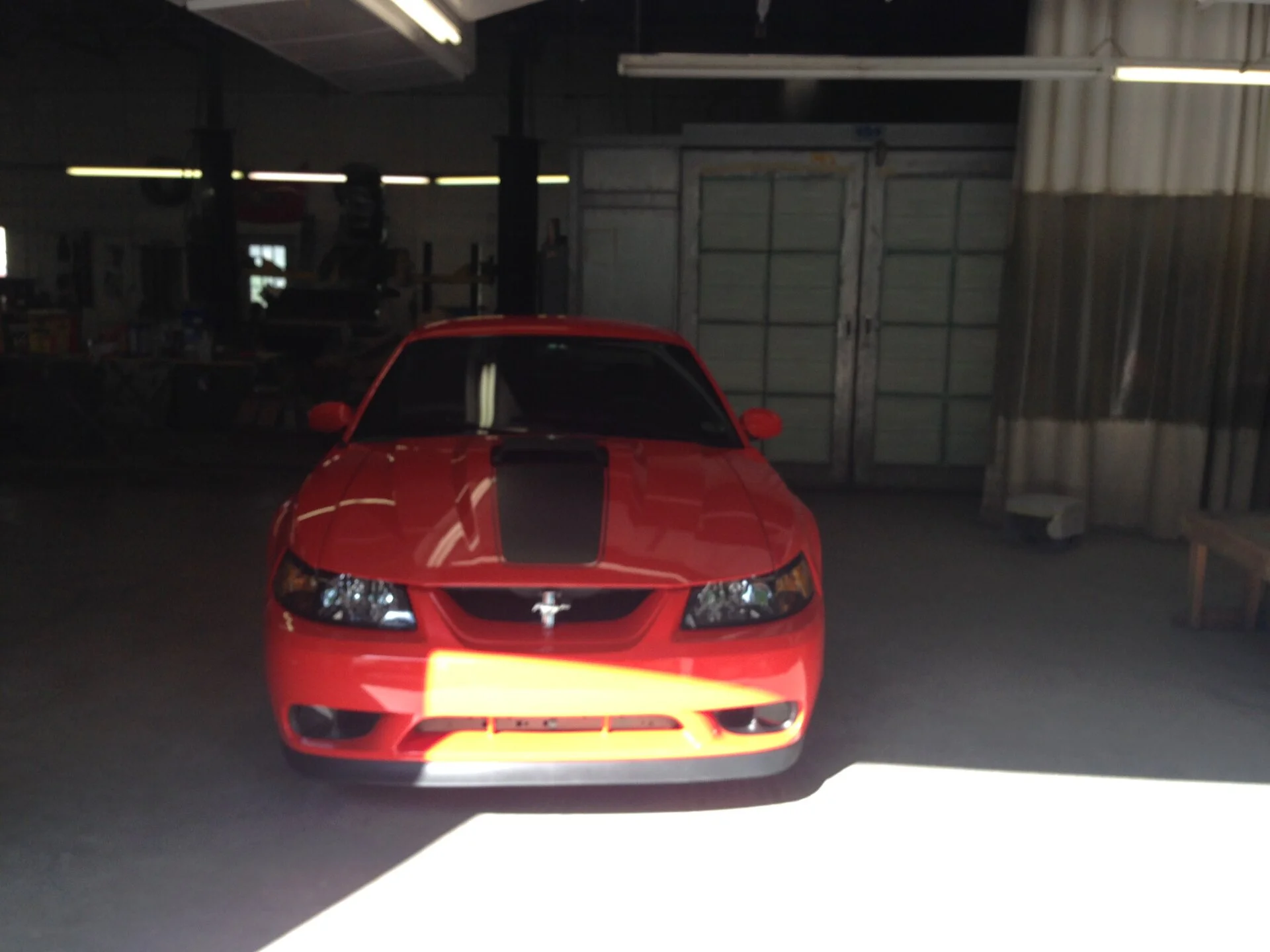

No shows this time….only go.

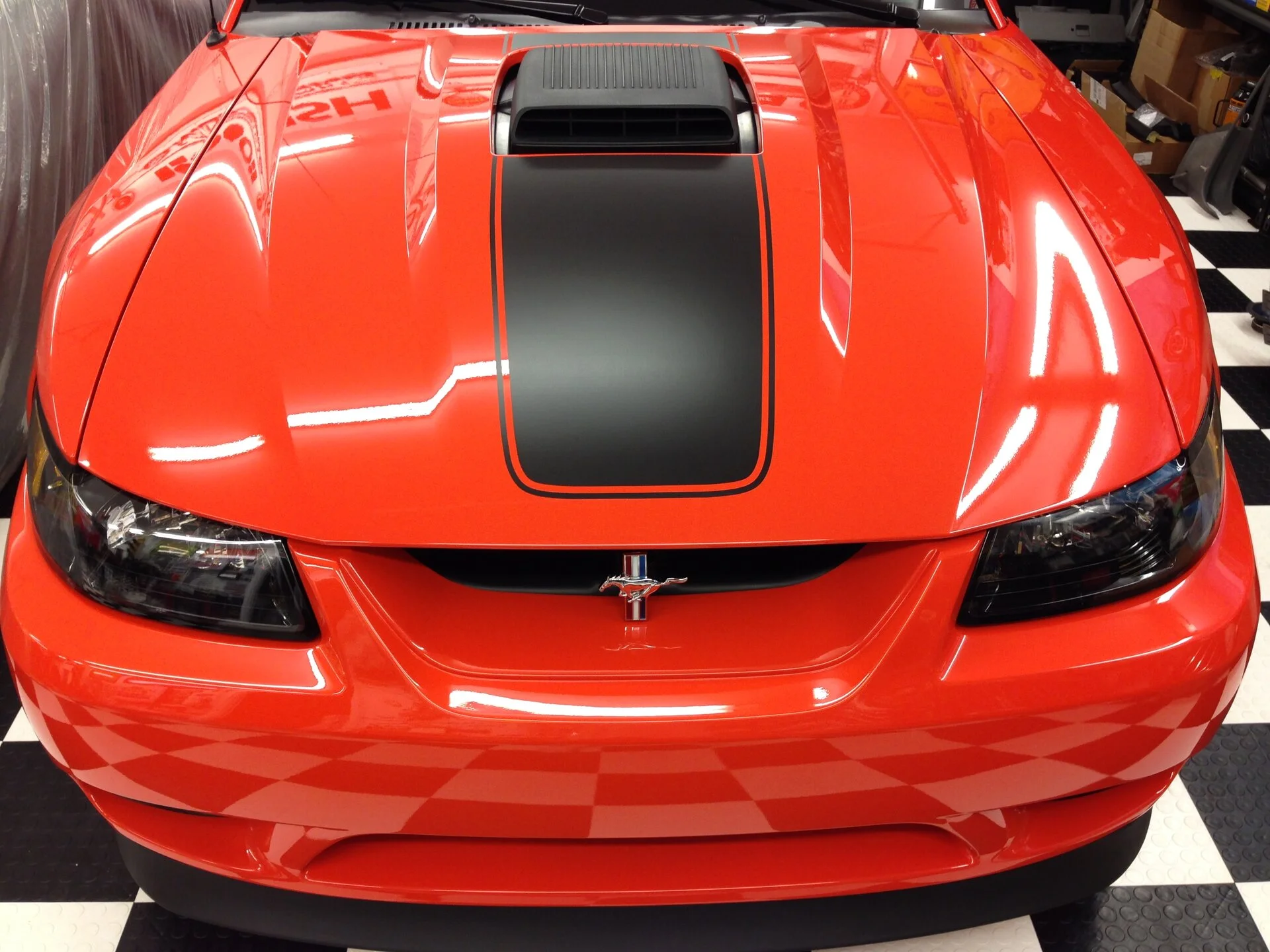

Next phase. Hate the regular mustang bumper.
So time to shave a Cobra one.

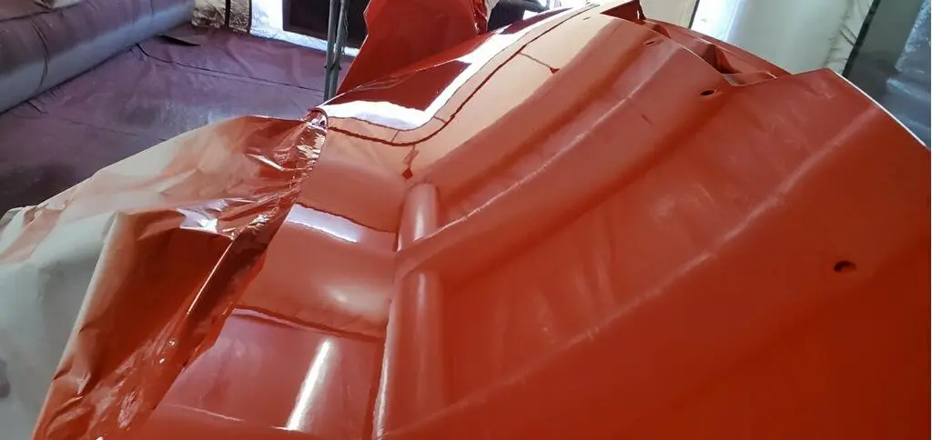

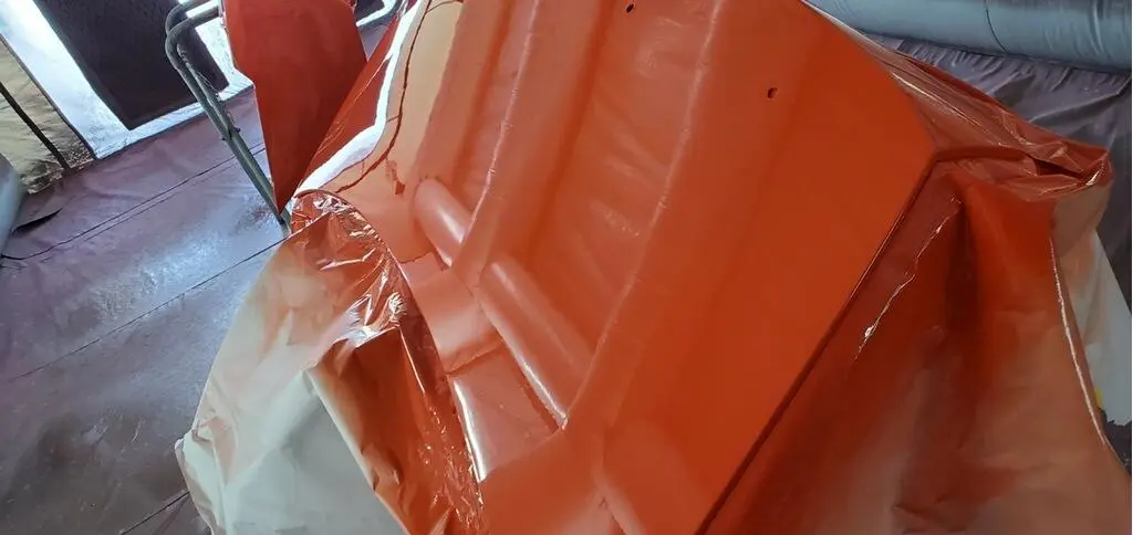

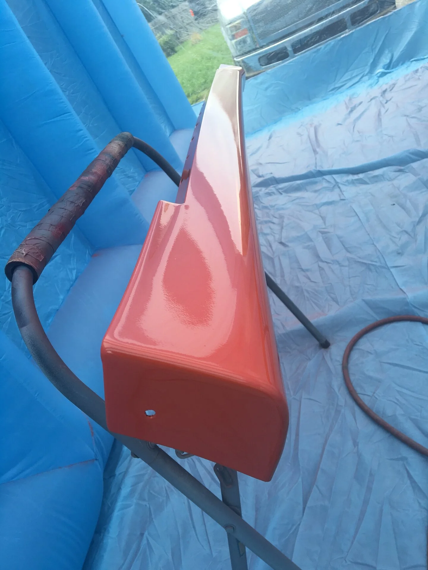

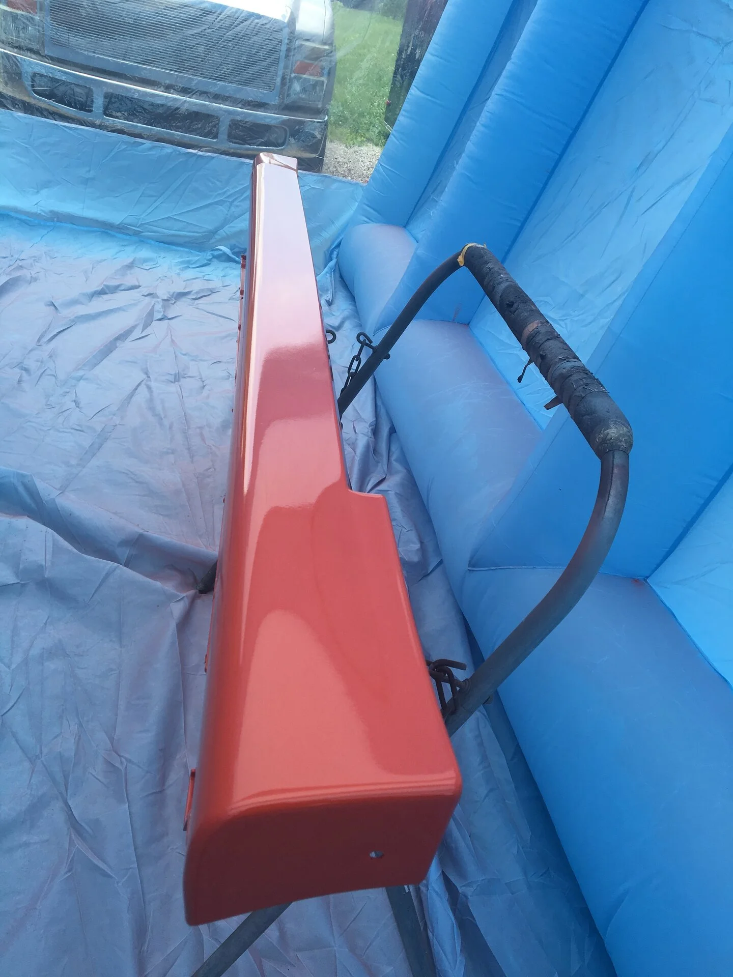

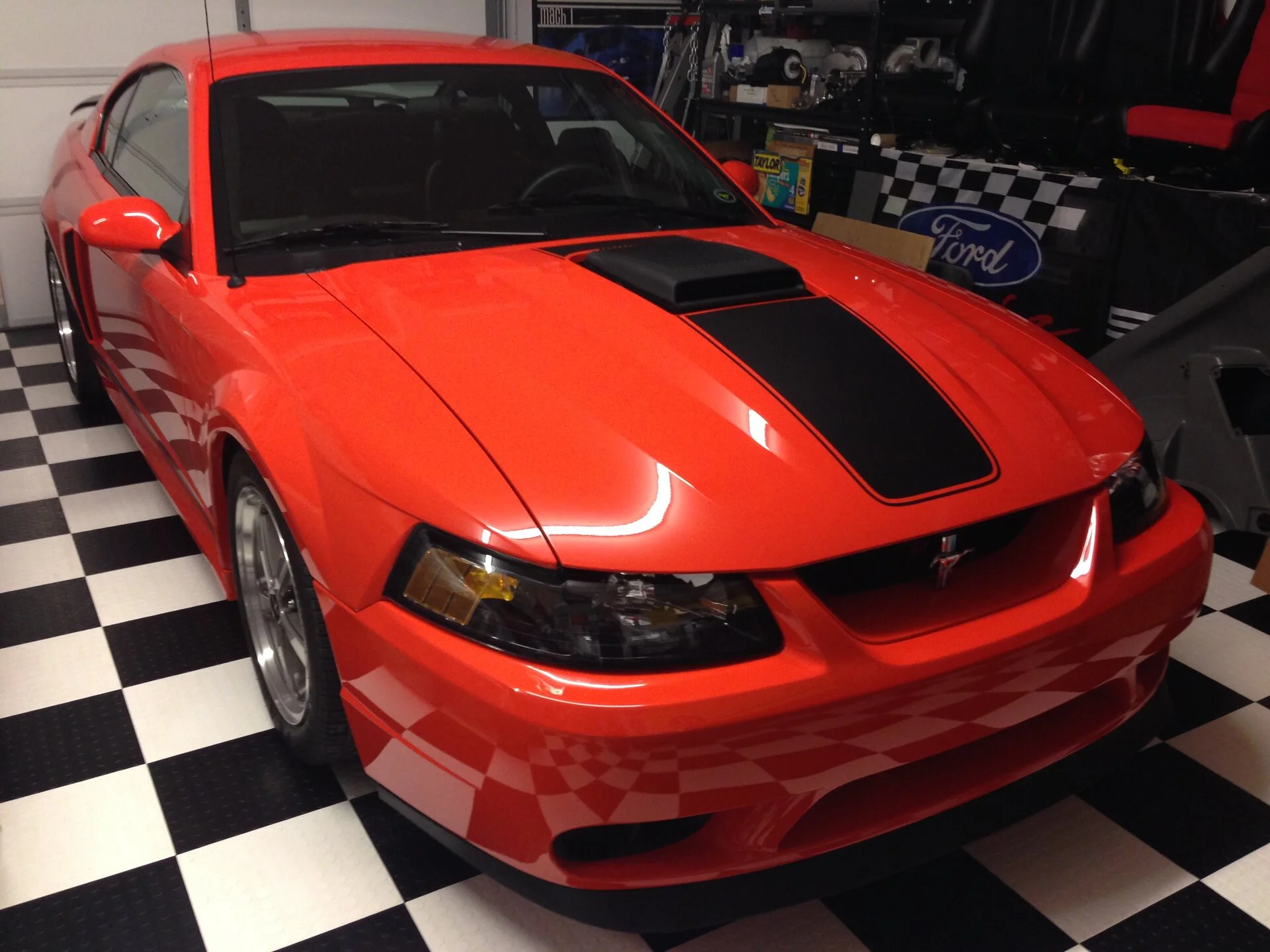

Paint time again. I also did a 04 cobra trunk and spoiler but I Think I’ll keep the stock mach trunk and spoiler for now. But if I want to switch for a while. I can

Ahhhhhh!!! I hate your paint jobs!!!
I'm looking at the deck lid and I'm like WTF???
I expanded it and it's a reflection of like an inflatable room.
Tell me, can you shave your face in your reflection on a full moon light?
Those paint jobs must glow at night,
