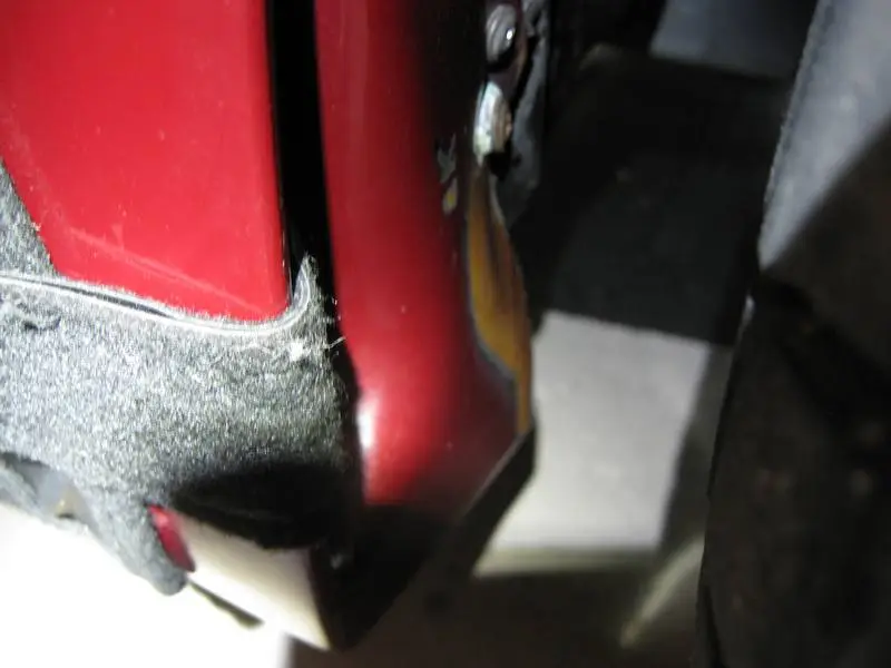

You're not paying attention to what I said.
I am the original owner of this car.
It is well known that the early Fox body GT's rub the front part of the fender skits.
Mine still has the scars to show it.
This happened before modifications of any kind.
For all you doubters, here's the proof.
Steering rack limiters might fix this, they weren't available until many years later when Ford started using them at the factory, along with modifications to the skirt geometry.
