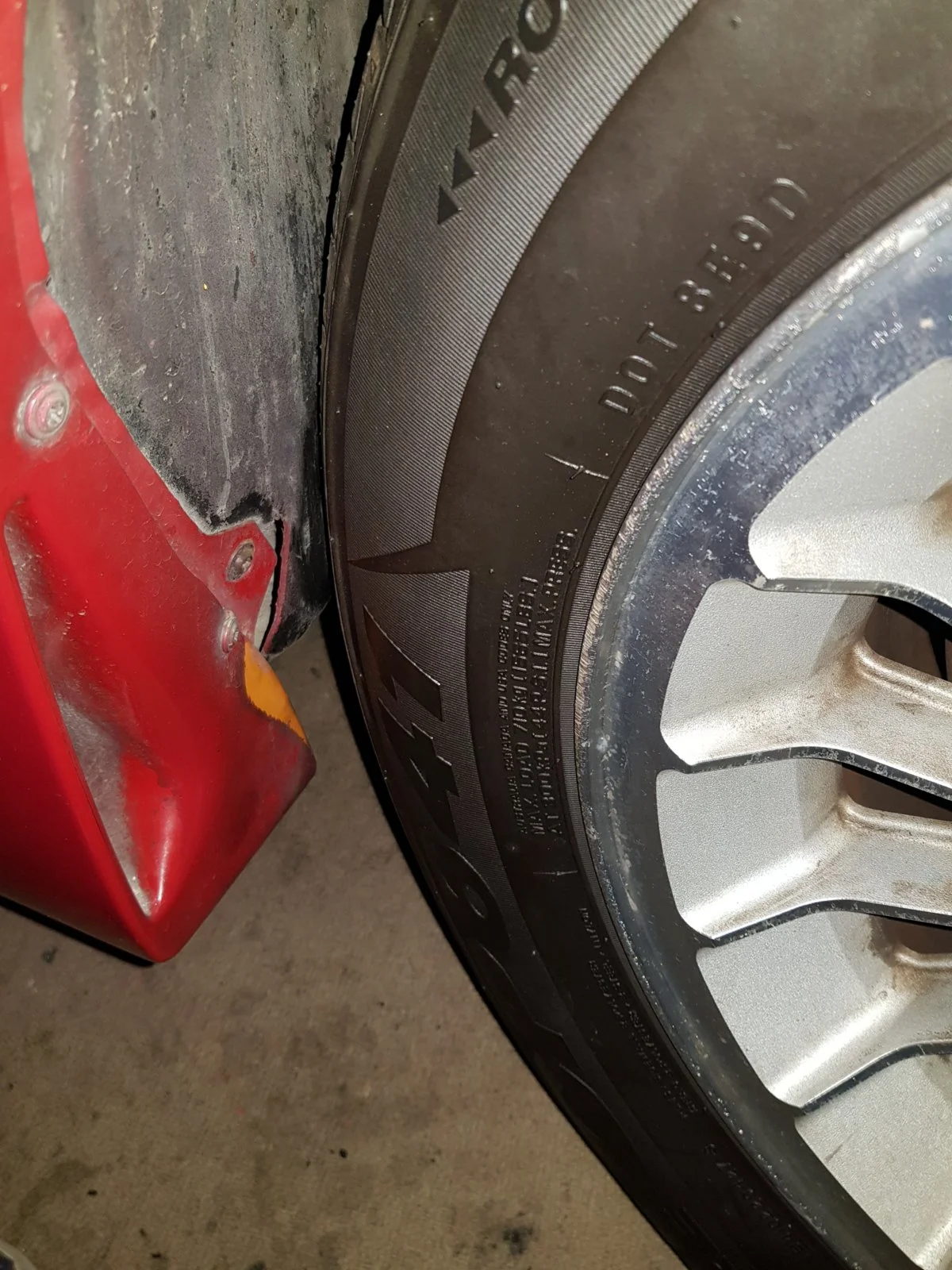

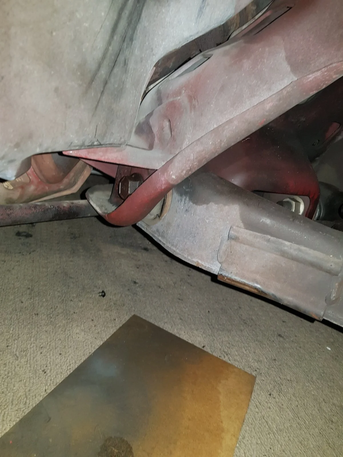

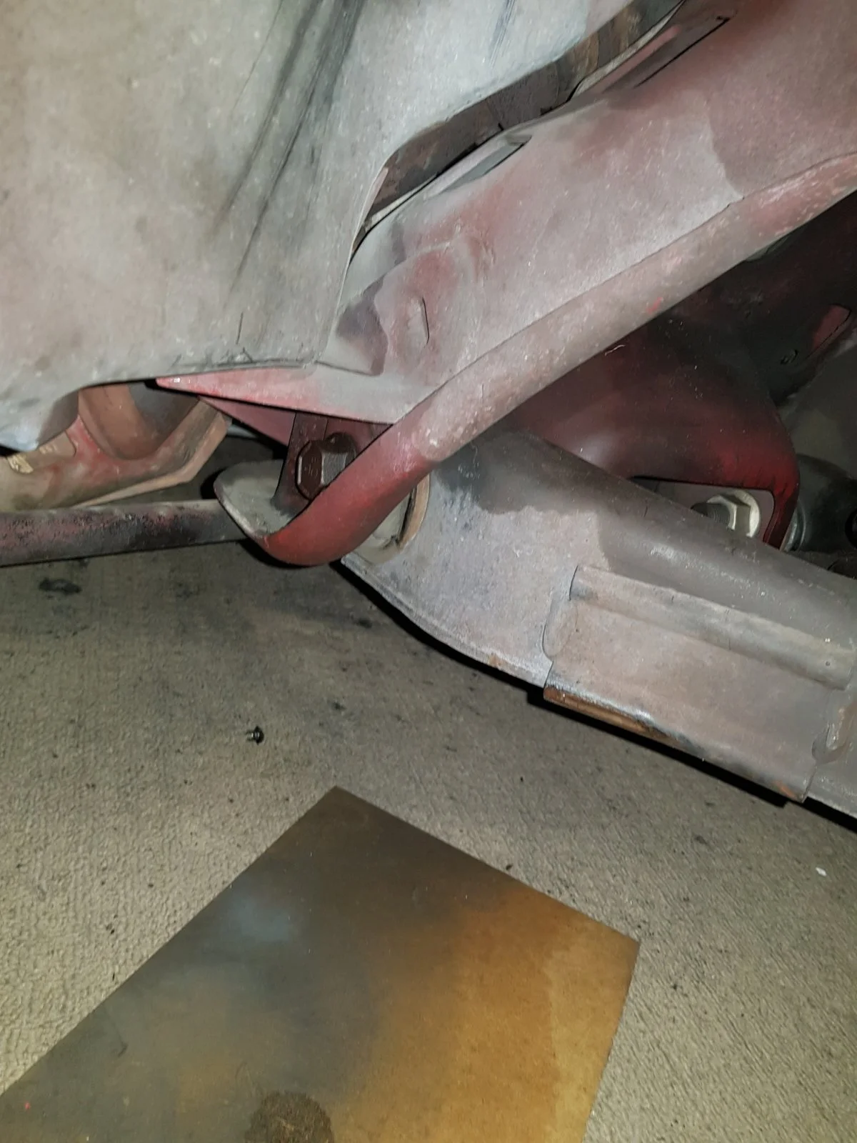

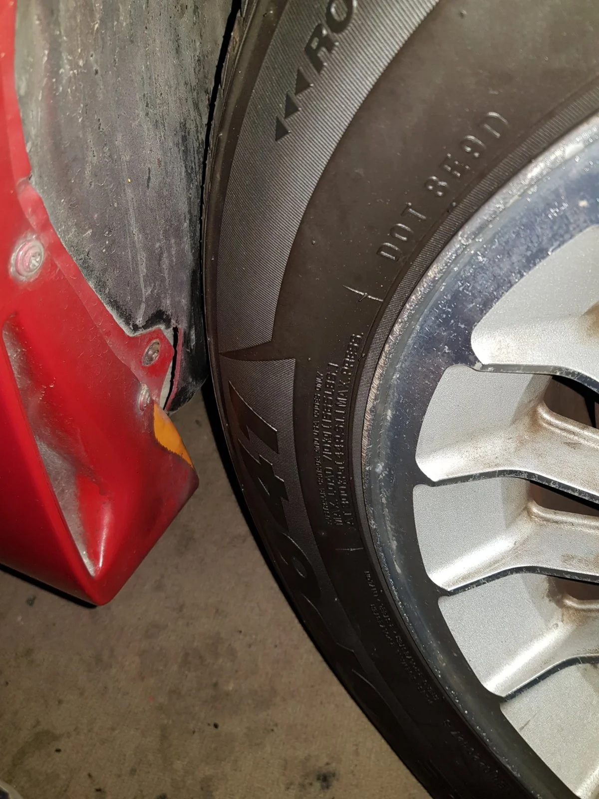

The tires rub against the inner fender, the plastic holding and the control arm. Here are some pics, it is basically the same on both sides of the car. Not sure if the control arm put comes across ok but it is 'shiny' where it rubs. Also, the inner fender plastic is just beside the plastic holding where it is rubbing. Looking at it now I see an alignment isn't going to fix it.

Here are some pics. It is on the plastic m olding as well...but you can perhaps see in the pic the shiny part of the control arm where they rub as well. Also the plastic inner fender near where the body moulding is rubbing as well.

...Only the control arm rub raises my eyebrow. The other rub I would agree is typical
I agree, mine never rubbed the control arm. The other rub looks exactly like mine.
